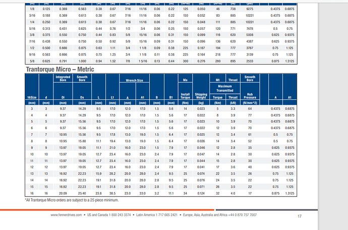

keyless locking bushings. anyone use them?
https://www.fennerdrives.com/trantorque/_/Trantorque-Mini-8mm/?s=ZnwyMzEyLDIzMTg%3D
how to figure the torque output of the motor? i dont think its hard math but dont know it and hoping someone will post it. not much surface area to hold with an interference fit but maybe good enough.
i hate keyways and grub screws!!!

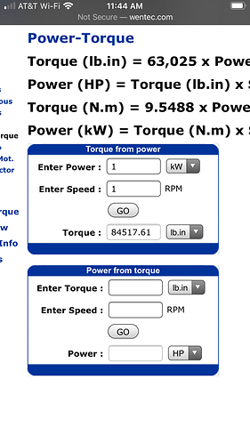

http://wentec.com/unipower/calculators/power_torque.asp
You enter RPM and Watt and you obtain Torque with this tool. For more accurate result you want to consider effective Watt output with heat losses.

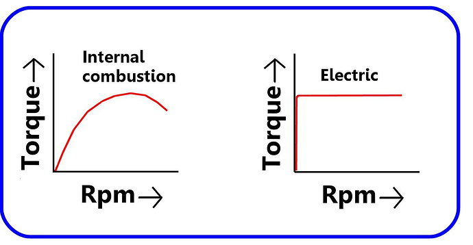

Im confused on such a calculator but maybe since an electric vehicle I can input the maximum speed and the the torque will be the same torque output at all speed? I think so. Big assumption though
Yea that’s what I assume too :sweat_smile: when I put max watts and max rpm together I get more realistic values even with 1:1 ratio (hub or DD rpm).
IIRC apart from increasing losses the torque output theoretically remains the same from 0 to max RPM in electrical brushless motor
You can also convert in Nm if you prefer

so consistent torque through all rpm or drop with speed? if given consistent current
Yeah, constant torque if you have enough voltage to push the needed current through the motor windings, the higher the speed the greater the back EMF, so more voltage is needed

What do you want to know? The coupler you linked is more than enough, rated at 41Nm. None of our motors can push that
file:///C:/Users/strip/Downloads/Full%20Catalog_2020-004.pdf
actually plan for a bike but thanks for your info and i su
ck at math . does 17nm
and then i’ll be adding a 9.5:1 gear ratio!! so multiply by 9.5 im guessing. will use a jackshaft so the second belt will hit this torque to the wheel
sorry the 12mm shaft. thats what it will go on. it does 17nm
and on an 8mm shaft will stay put up to 14nm. you guys should get one
