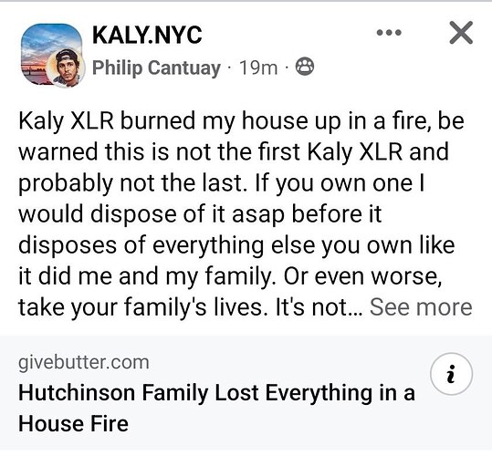

KALY-XLR Ernesto new creation.
Not this for sure
Not entirely sure that hooking up a pair of servos to the pwm is what I would call ‘innovative’ either.
Self reporting as an arsonist, basically
Among us reference?
It could be if you want it to
24v?? Wow, I’m guessing because his 18s charger was like ‘no way’. This is a vendor nightmare. At least he’s essentially taking responsibility, and absolving Ernesto. God only knows how many other ‘Kaly burned my xxx down’ scenarios are similar. Someone needs to make a battery management system, management system, that can disconnect the BMS completely when the cells are balanced.
“But to me that meant, I probably know better than anyone else anyway, its not my fault the next guy burned his house down”
What a tool…
