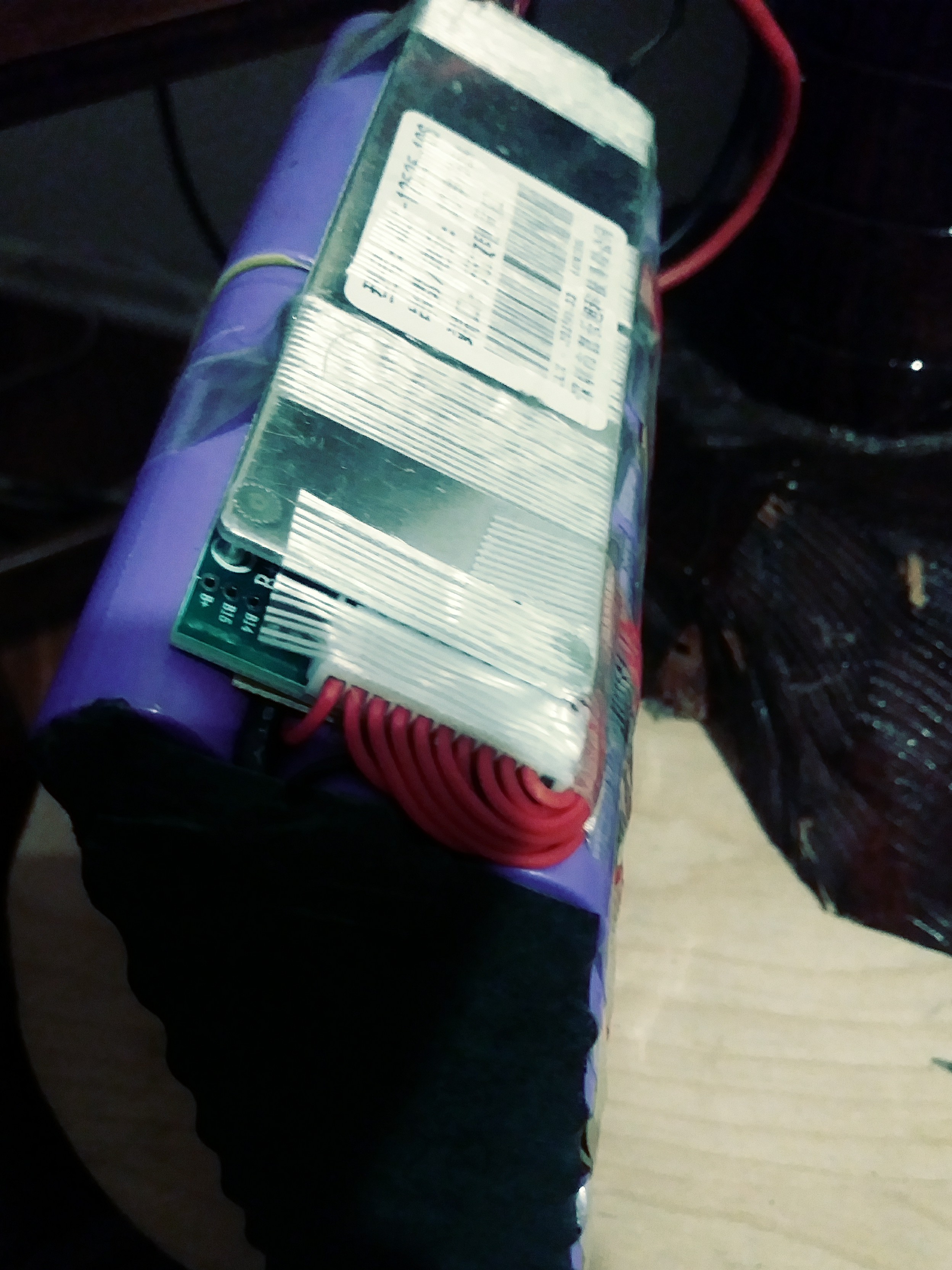

Ripped off the heat-shrink
The battery is a tank…
It’s solid… No insulation between Pgroups…expected…balance wires all routed acceptably

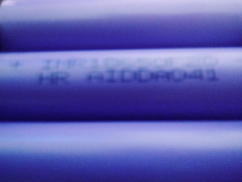

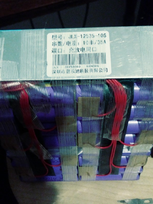

Cheezy ass knock of IMR18650F20 cells… I “assume” that makes them 20 amp crap cells… Limited to 1/2 spec 10amps per cell I hypothesize i have a 50 amp pack and a crappy 35amp BMS… gotta bypass that…
Cells seem balanced well enuff for government work…
NO… I’m not going to look at the welds the nickel…nada tostada… Just bypass the BMS and then let this crap float charge to check balance…
It’s even built with smallish 14guage mains… No fucks given… Nope k00k… Bypass the BMS then shrink wrap it back up…
The mains look acceptable the generic xt60 looks ok… No melting burns or anything scary… I would expect anything really bad being limited to 35amps discharge…

Those yumcha packs have about a 1/4 the current capacity. I bought 2 off DHgate.com for a cheap scooter build it’s a fucking scooter so not wasting Samsung or lg on it. 10S3P
9000mah (20 amp output bought 2 to run in parralel) the scooter motor maxes out at 15 and. They were varicore. Even in parallel they sagged my Nana’s tits, so I pulled the pack apart to capicity test the cells in my littokala charger they were infact 1600mah 18650 2 amp capable. I Put them in my crap cell box. They look alot like those cells above.

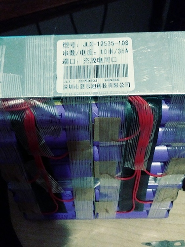

I know I said I wouldn’t look at the welds and nickel under the sticky fish paper… but I lied…
yup as suspected… grim
I think for science even after I bypass the 35amp BMS. I’m still going to run 35amp battery max and check it… dial up the amps slowly and see if I can get this bitch to draw 60amps burst…
