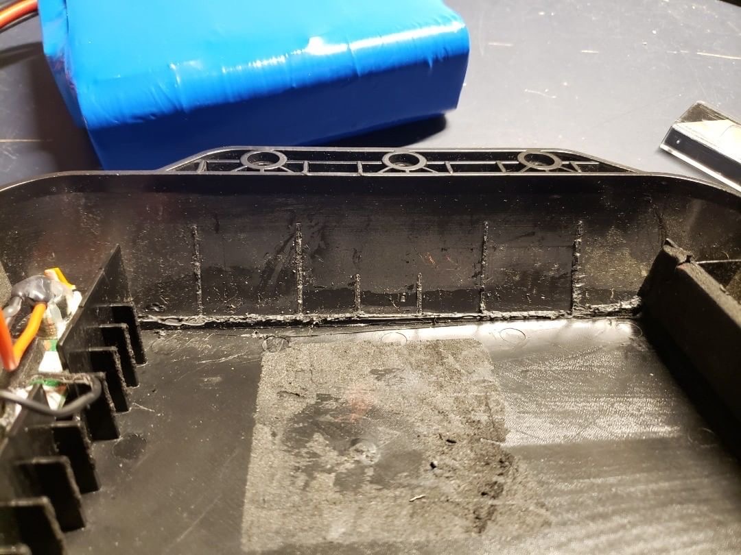

@Skyart P42A’s are too large. Gotta cut the housing internally to fit them.
Nah 10s2p p42a should fit nicely, have you tried? Their ER battery is 10s2p 40t
I speak from experience homie, I’ve probably built 25 of them with P42A since last summer. 40T will squeeze P42A won’t.
Haha! Right on homie, thanks for the tip! Yeah I had to do that to one too. Was able to fit 10s4p 18650
That’s in me daily. Pair of snips or dikes and it’s an EZ cut, not sweat. It did blow my mind when I realized that tho .7mm times 5 was gonna make a difference, crazy.
Dang bro. Killer, love that you are doing so many of these. Plenty of meepo out there that need upgrading! Maybe once those molice m50a cells come down in price it will be an even bigger upgrade!
