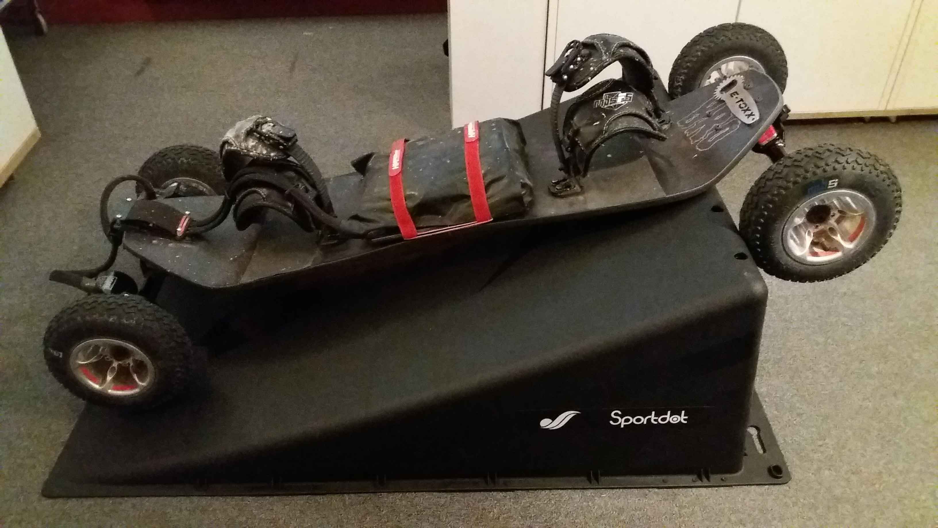

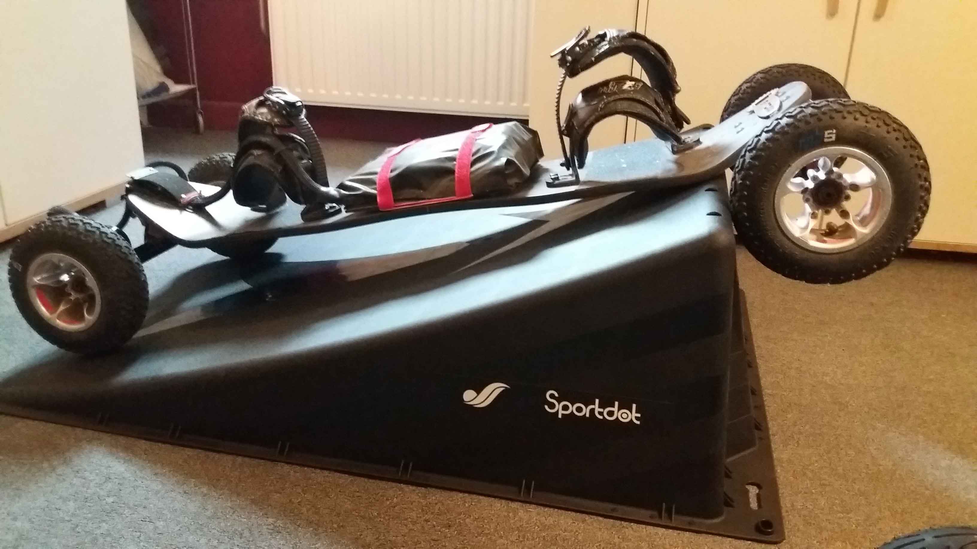

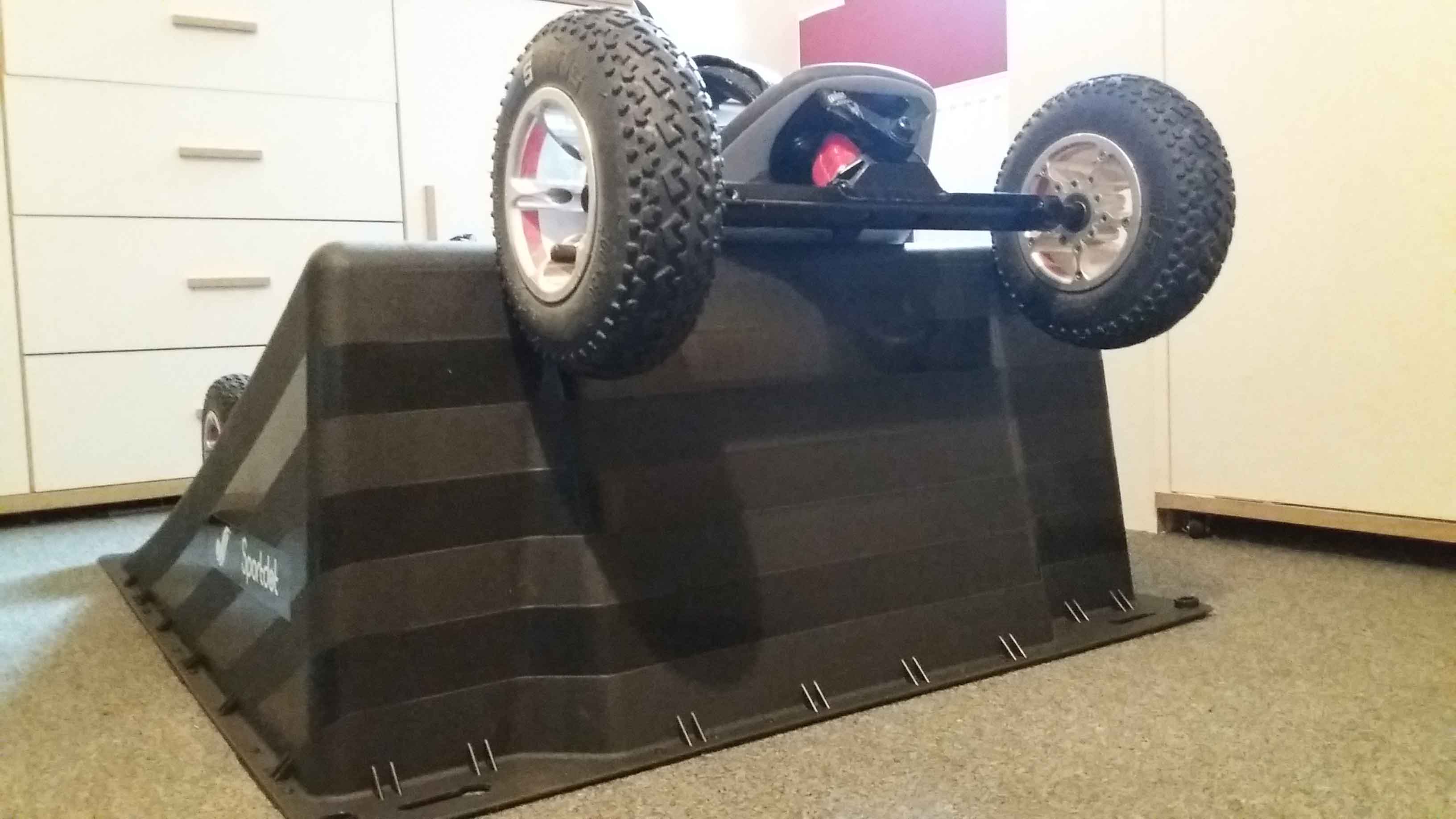

I received the ramp but could only shoot some shitty pics before work today
First of all it’s damn light, I can lift it with 1 finger and definitely don’t need to mount wheels, I’m sure it’s easy to hold during riding. The weight is 4.5kg. It’s not that rigid and definitely needs some extra work to be reliable. I was even afraid to stand on it because it bends. I’m thinking about a wooden frame on bottom or something plus some support in the middle area. Otherwise it would crack if the ramp is not laying on a perfectly flat surface.
Carbon fibre :muscle:

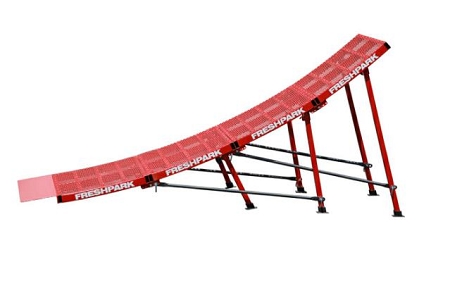

Also I am thinking about building a bigger portable ramp out of wood. The idea was to use a foldable framework combined with a stiff curved wood. So let’s say the wood is 12mm thick and 2m long and only supported on 2 points. Any idea how much reinforcement (fibre) is needed so it doesn’t bend or crack?

Carbon fibre would be perfect to strengthen that ramp while keeping the weight to a minimum :ok_hand:

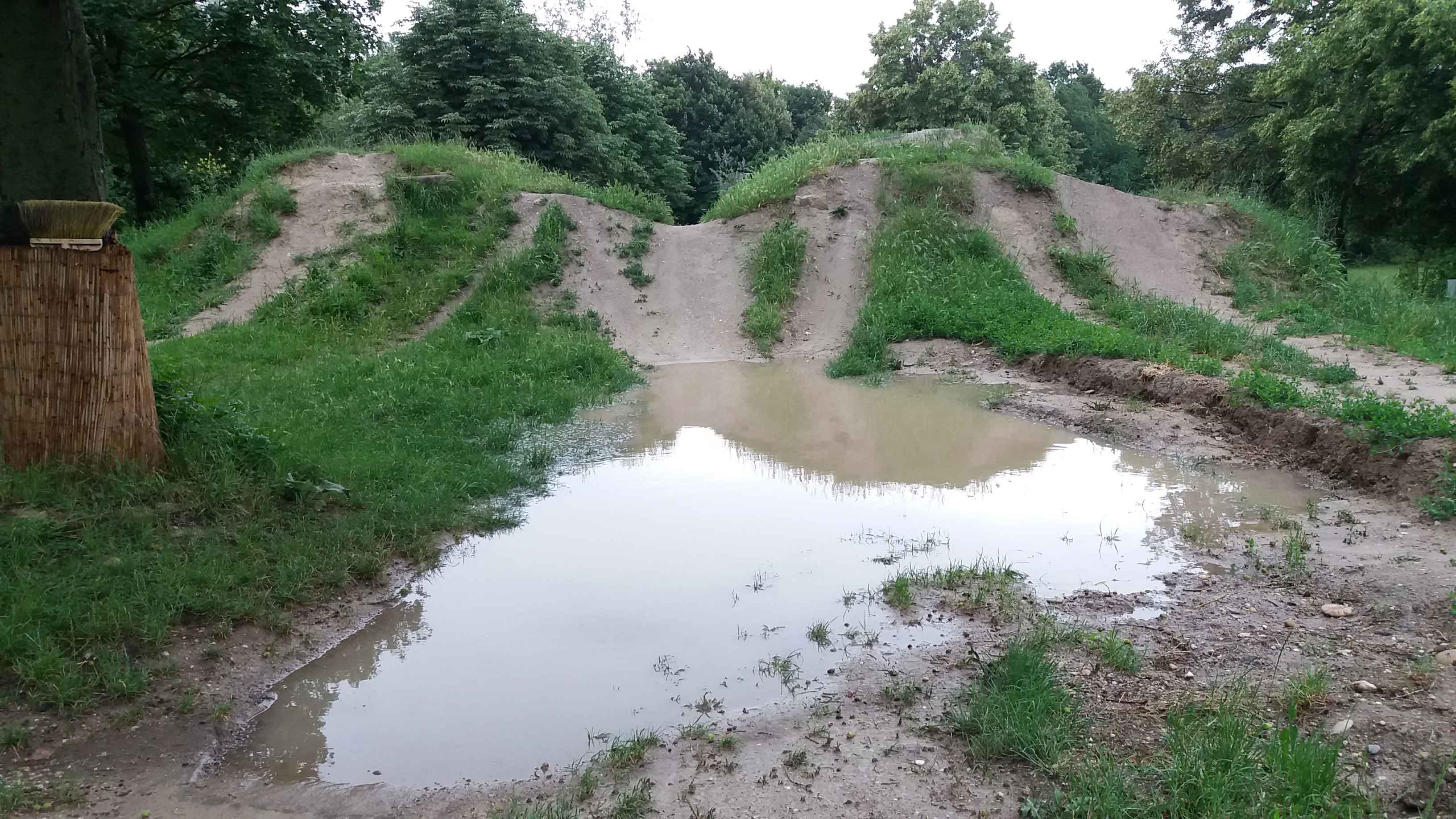

Just visited dirt park after work to check conditions there after weeks of raining, it’s even worse than I thought. Damn no idea how long it takes until this massive lake is gone :face_with_raised_eyebrow:

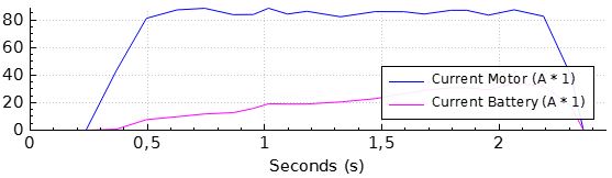

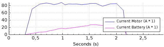

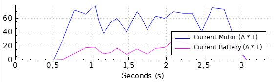

Finally I could work on the promised video about full throttle forward vs. reverse. I spent the last hours and it was a PIA to find the according data in the Vesc-Tool log. Everytime you zoom in the time resets to zero, it is a nightmare. I have to get a metr pro. Moreover the screen shots were too small for the video and I had no nerves to redo it so here the video without data.
Full throttle forward (2 examples)
1-24
2-15

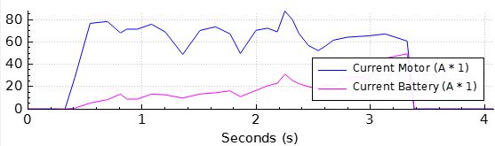

Full throttle reverse (2 examples)
2-42
2-00
As you can see the curves look different, reverse is quite jumpy. But the amps are about the same even a bit less in reverse.
In the video reverse doesn’t look faster. It could be that the burnouts are because of too much weight on the rear foot. Also on acceleration the weight automatically shifts to the rear foot where no drivetrain is :thinking: Also riding switch feels different. I’m not sure anymore if there is really more power in reverse.
But then why @glyphiks experiences this with 4WD :thinking: I mean the shifted weight on the rear foot makes no difference in reverse with 4WD. I’m confused :crazy_face:
Most likely there is no power difference between forward and reverse. You just have more grip when going forward thanks to favourable weight transfer that puts more contact pressure between the tires and the road.
No there is a definite power difference.
My board will do wheelies in reverse no problems. It has the power it should have.
In forward it is sluggish off the line.
I tried both uphill on grass cos its the only way i can stay on the board at full throttle from takeoff, and the difference was clear as day
It might be worth switching the remote for a different one and seeing if it does the same. (just throwing some ideas out there)
I’ve tried it with a different hoyt puck and it was the same. Same receiver, but i doubt that would make a difference

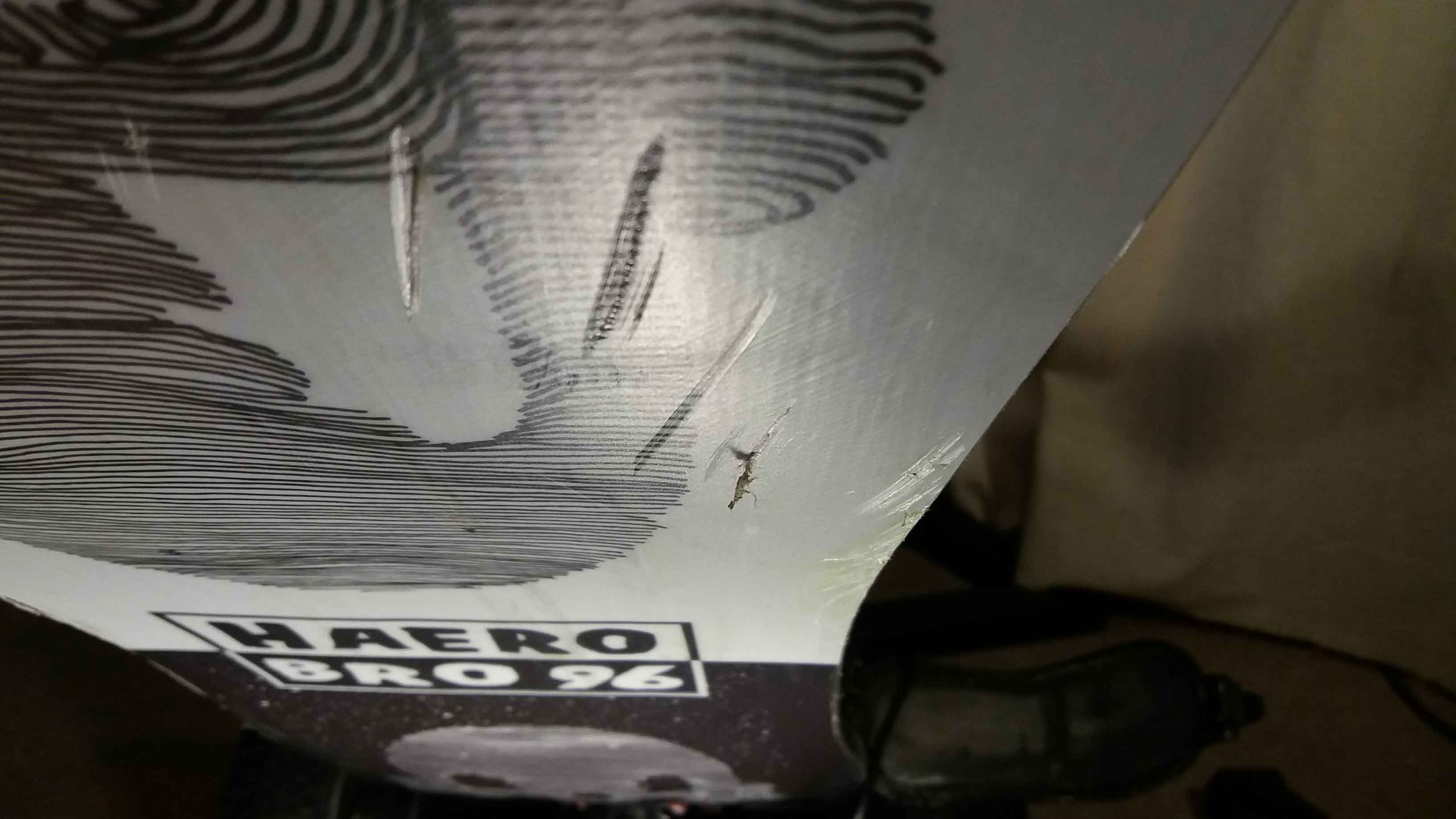

I have some marks from skate park
the edges :crazy_face:
