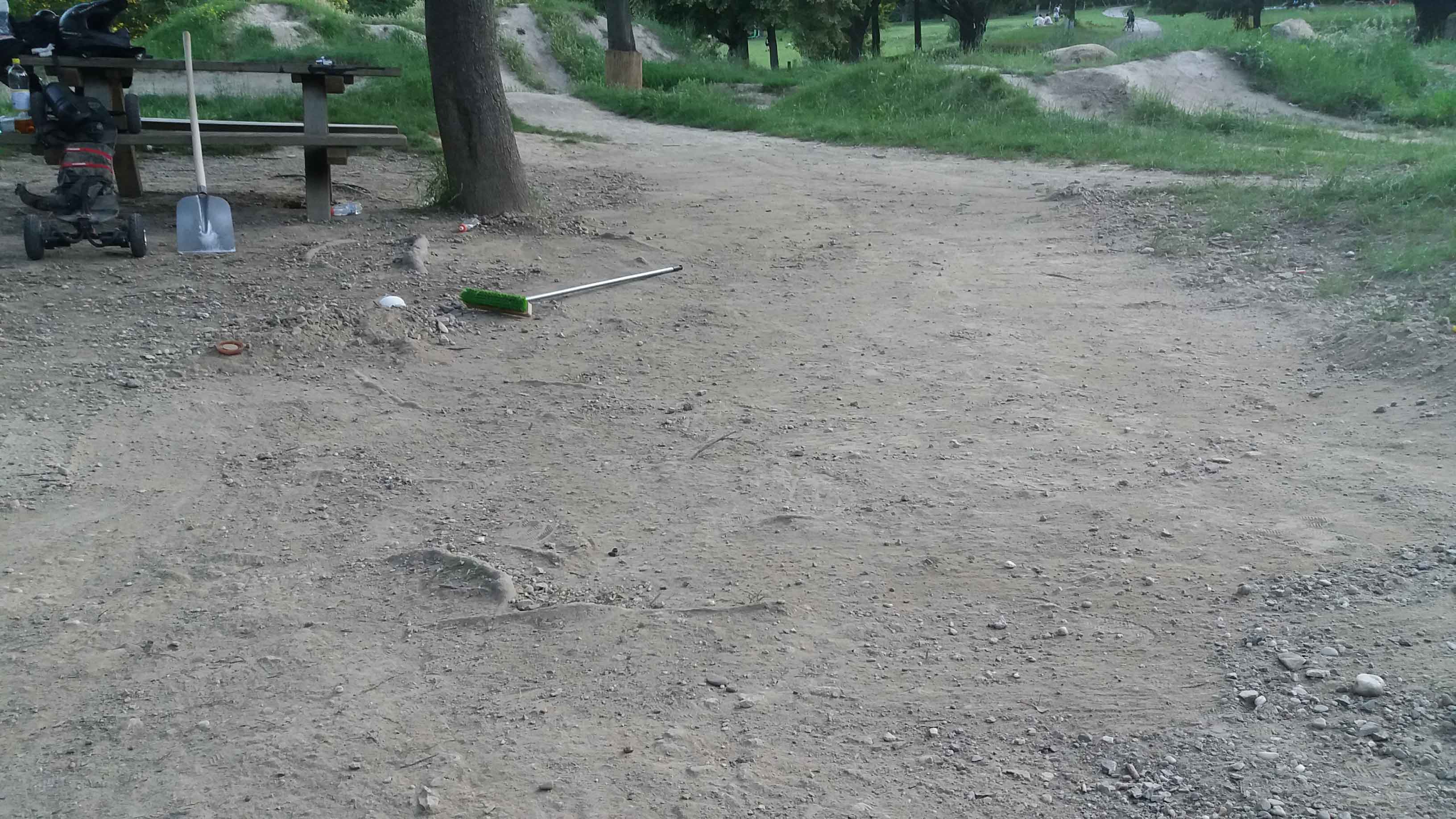

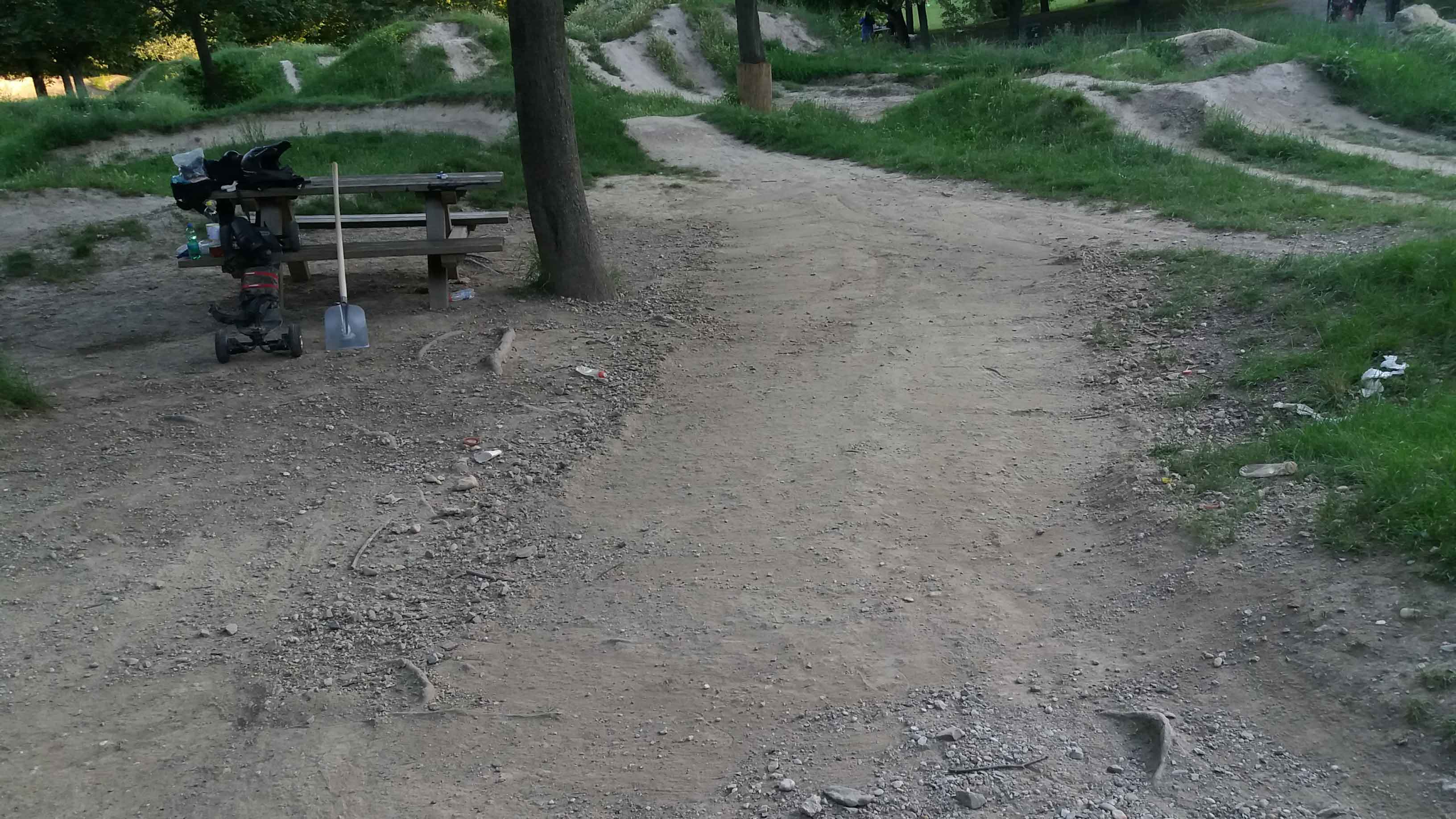

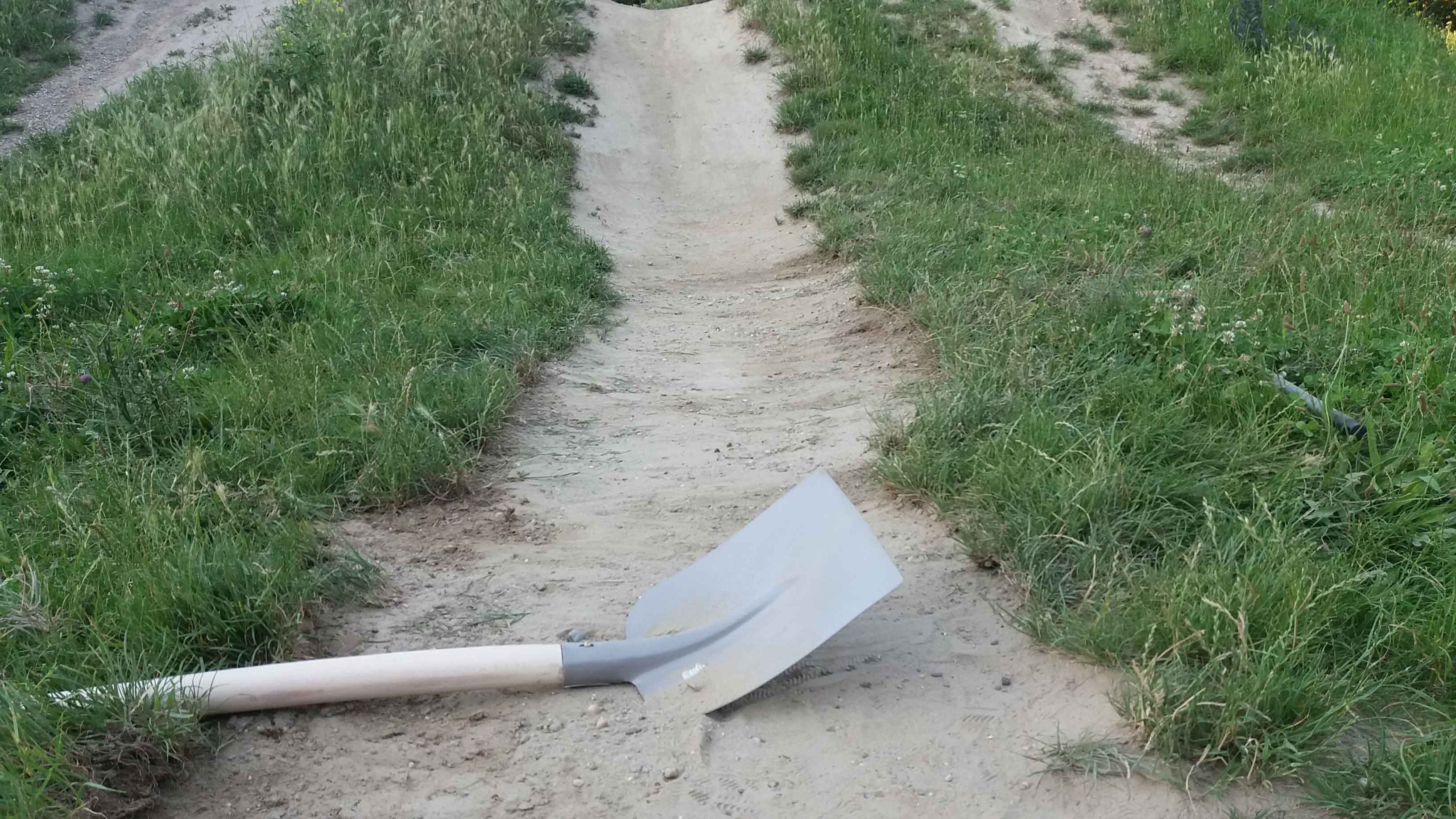

I got addicted to dirt park and had another 2 sessions today. After the first session I finally bought a new shovel and a genius broom because the dirt park needs some work and nobody does it.

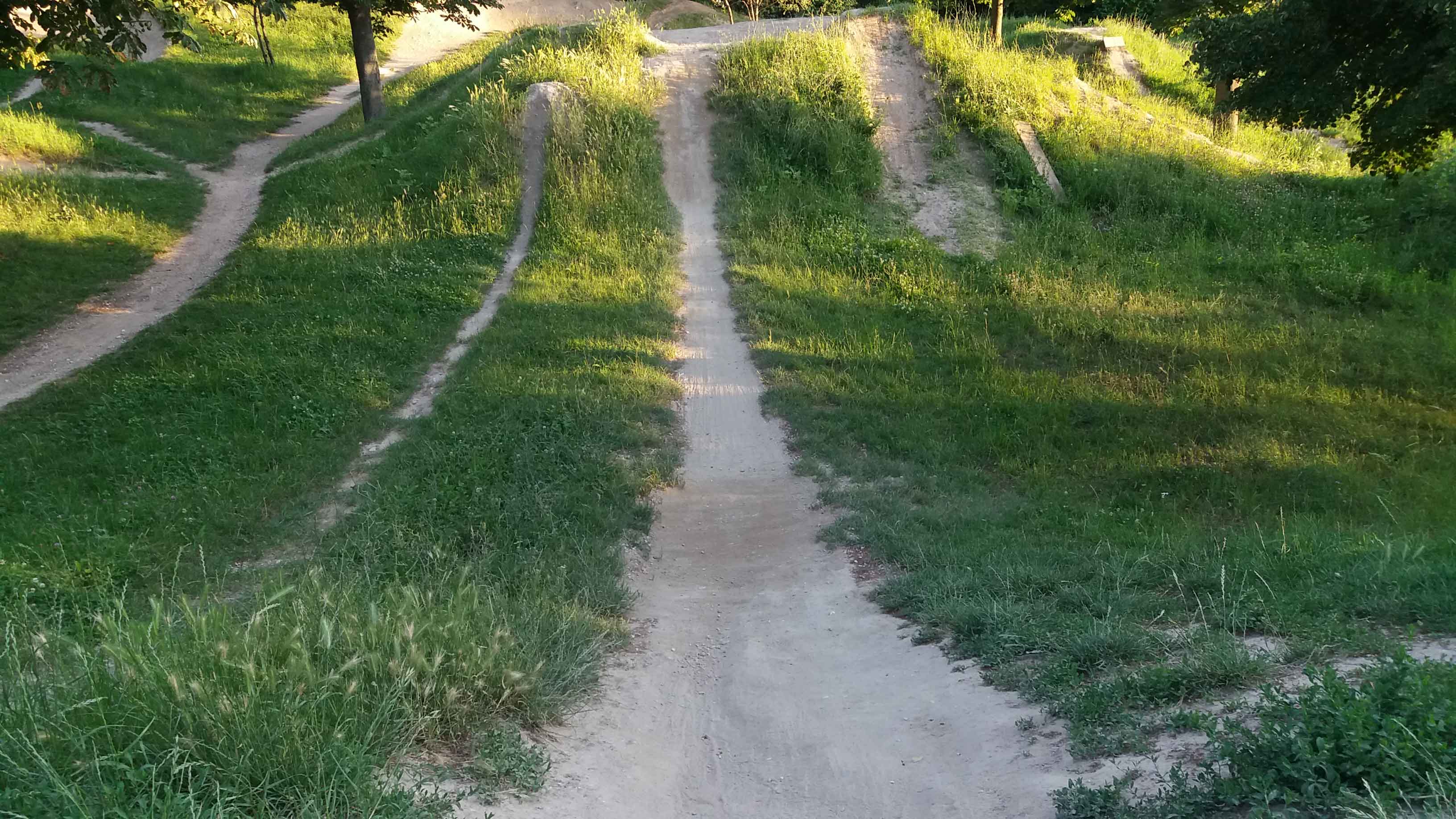

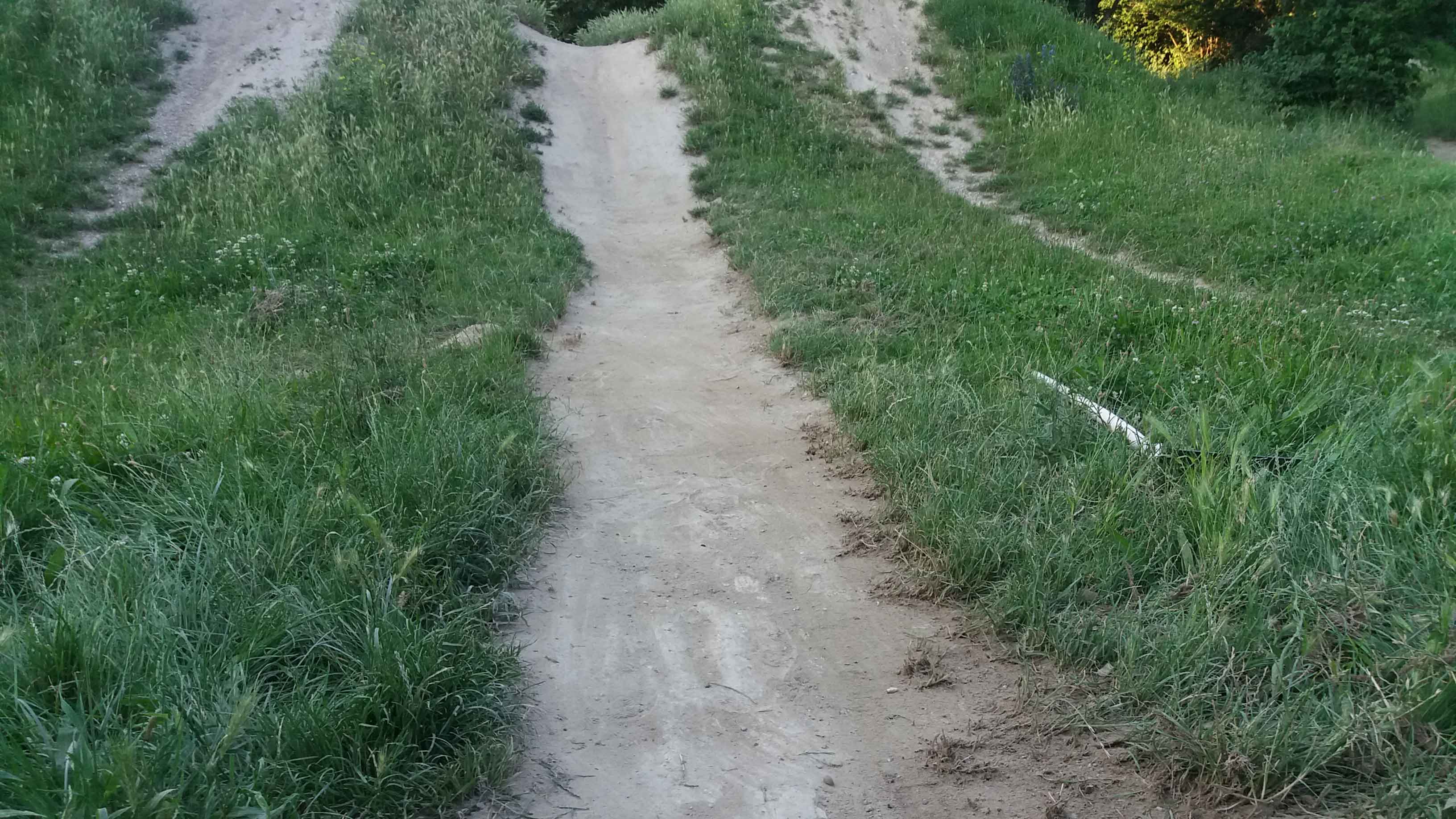

The main problems are many small rocks and too narrow trails. It’s fine for bikes but I need wider trails than this:
I started to work on the roll-in first and removed the grass, some dirt and bigger stones
From top of the hill

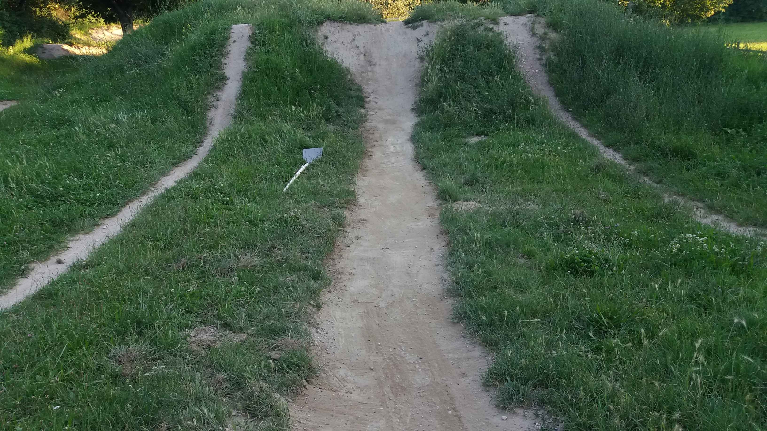

Now it’s much safer for me when starting on the roll-inn like bikes. On the pic above you see the set-up jump which is then followed by 3 main jumps. The area before main jump 1 is alright but after that everything needs work.

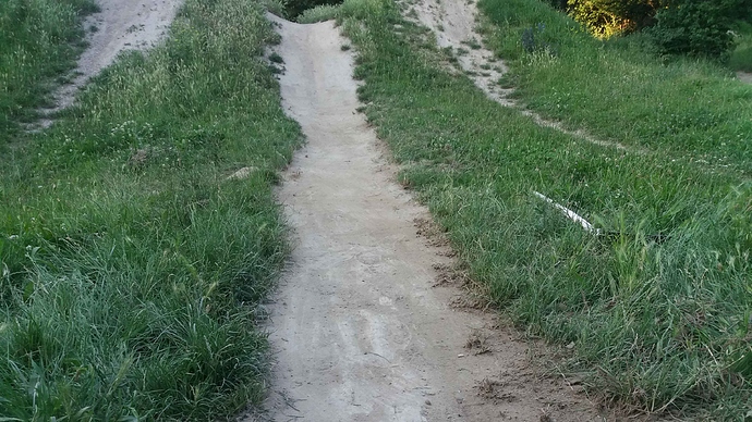

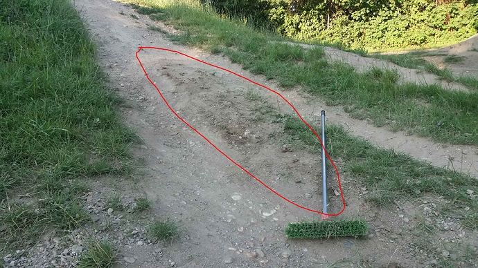

Removed a lot of grass and stones to widen the path, here the landing zone of jump 1.
This is main jump 2 and my personal favorite.
Now it is wide enough to concentrate on the jump and not on the path before when some wheels roll on grass and the other on dirt.

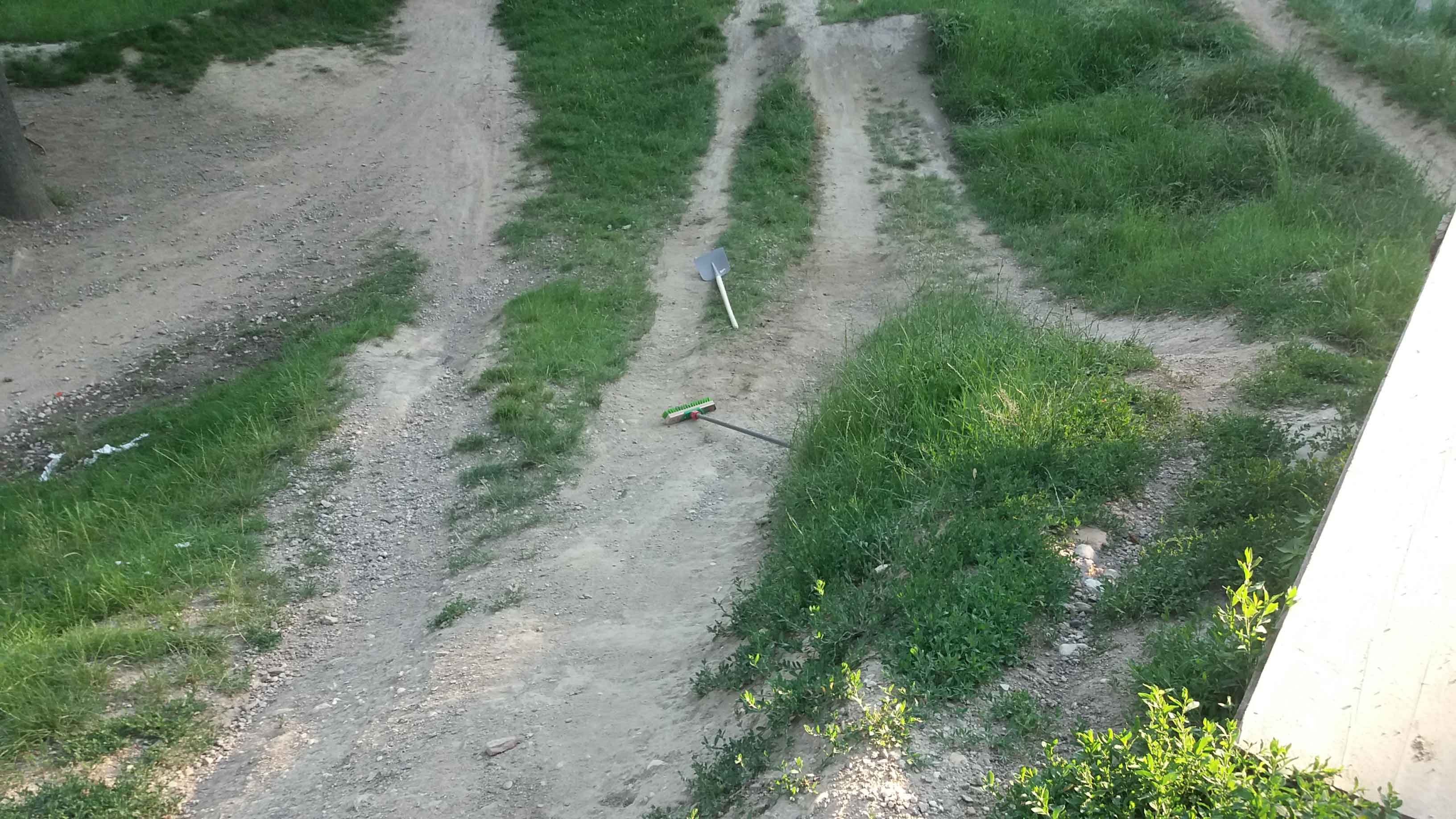

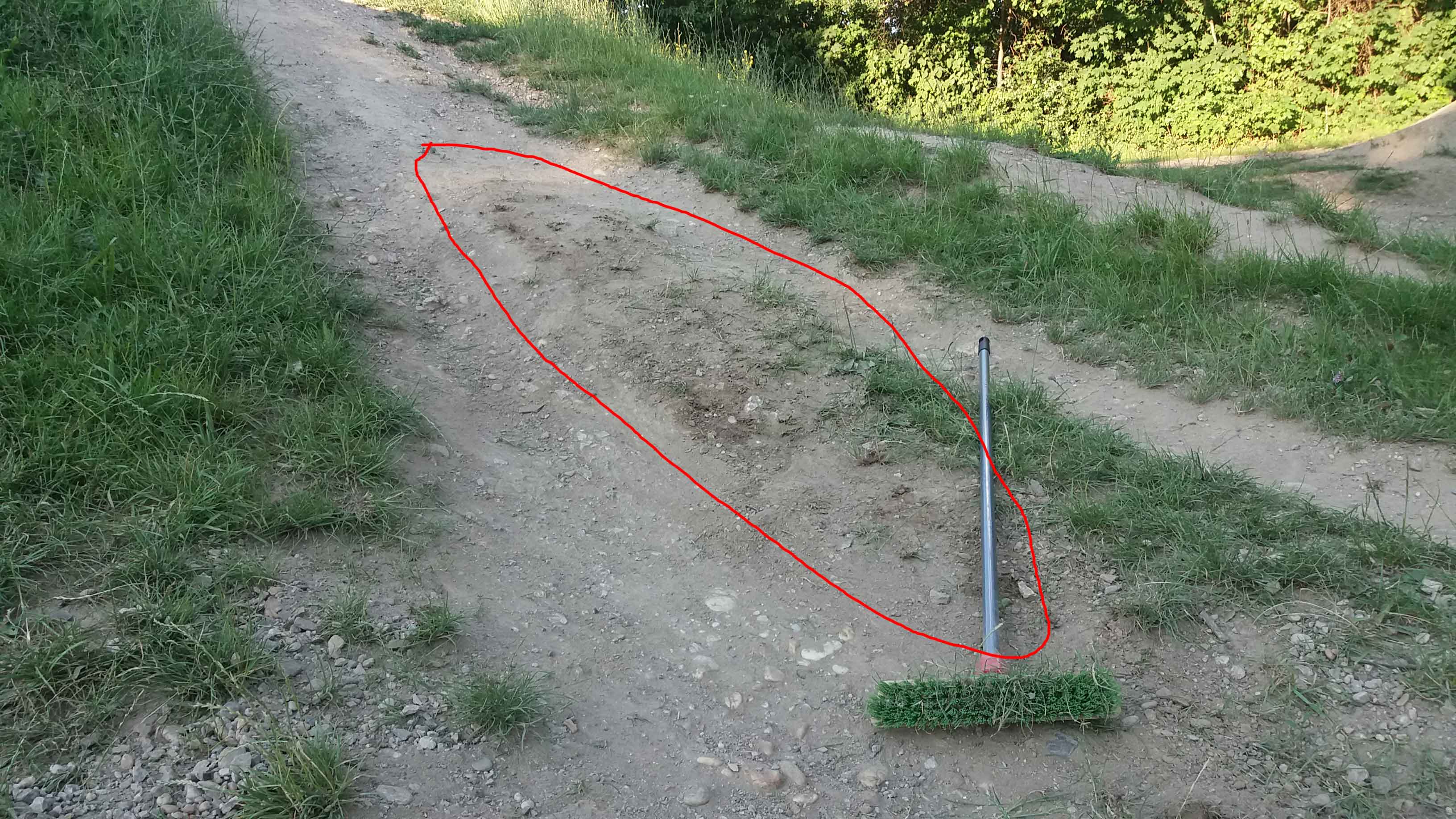

The trail between main jump 2 and 3 is very narrow and needs massive work but had not enough time and power today.

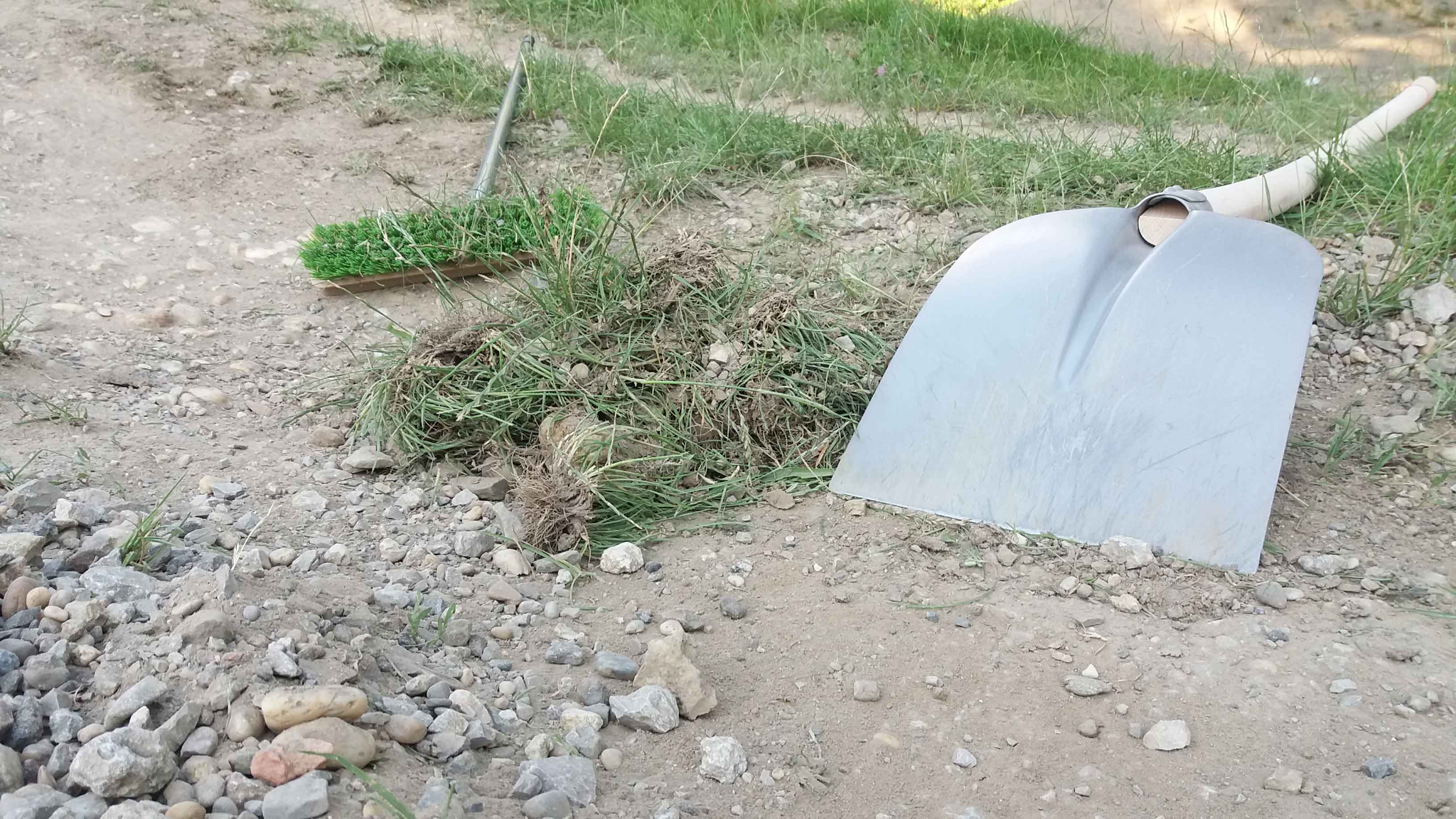

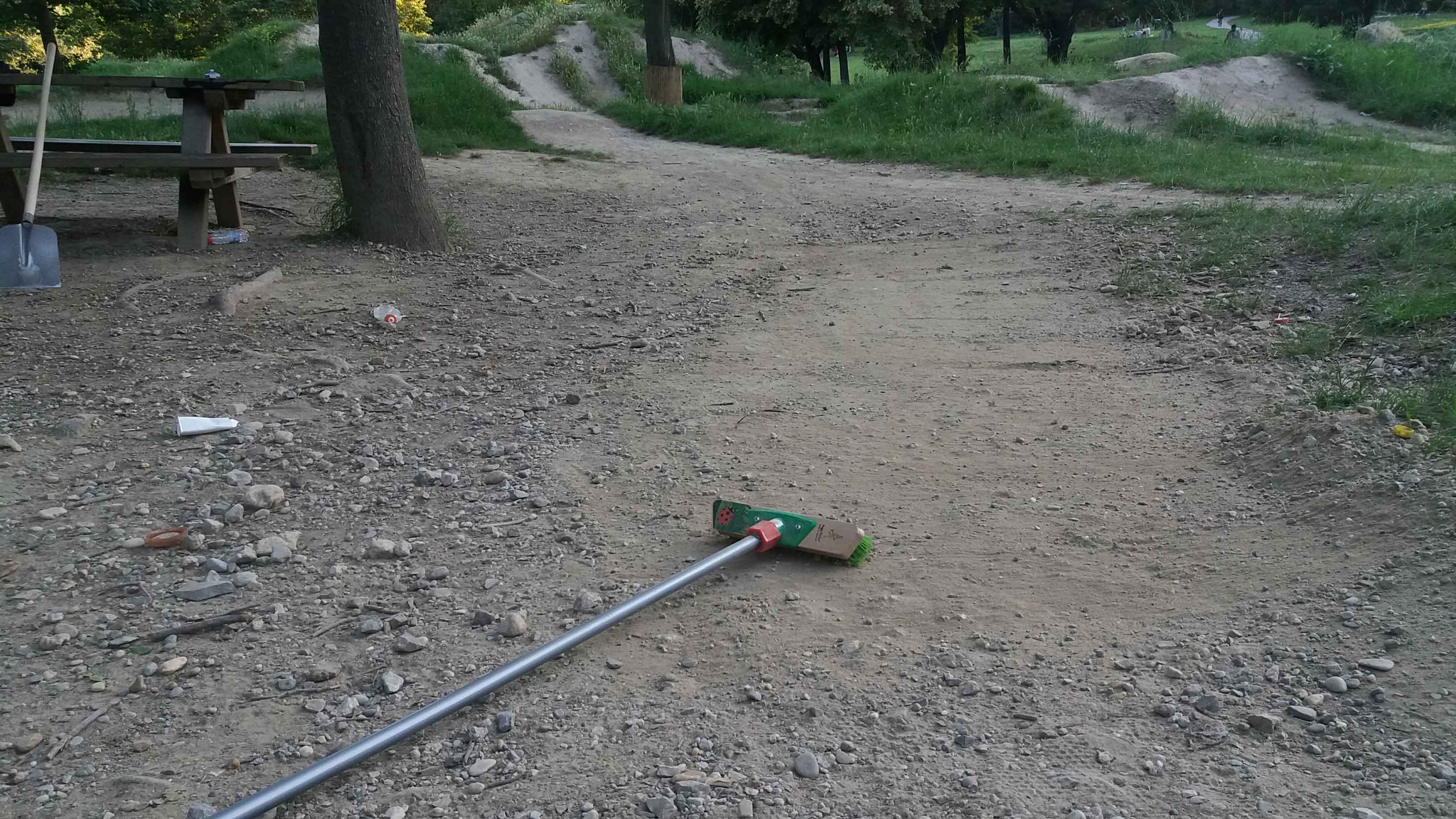

Then I started to remove all this annoying stones and rocks in the entrance area which I have to cross everytime.
Much better :ok_hand:
This broom is the shit! I mean it’s still hard work but quite fast. It is exactly made to sweep stones and works really perfect. Then it was time to finally ride and jump.

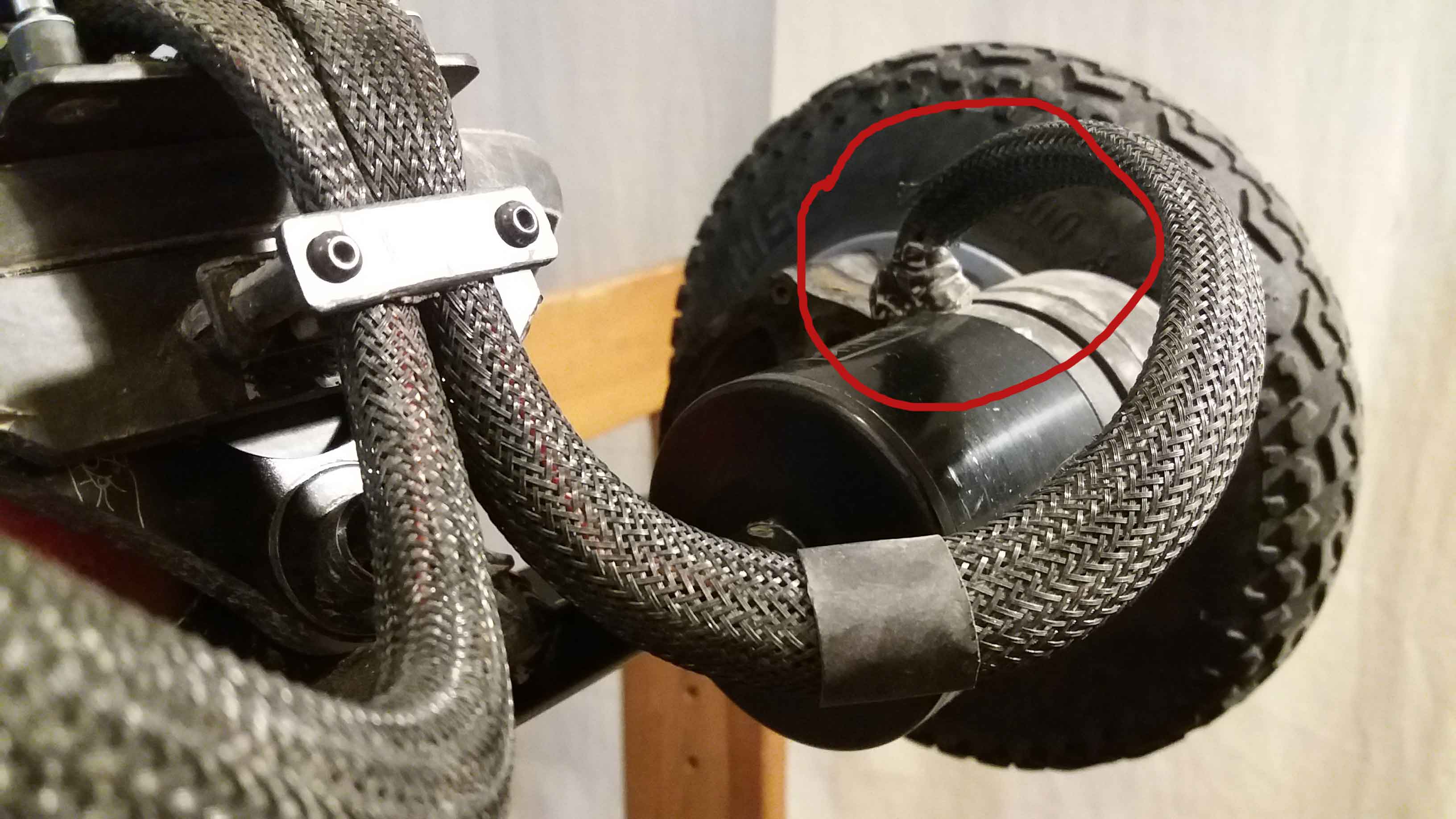

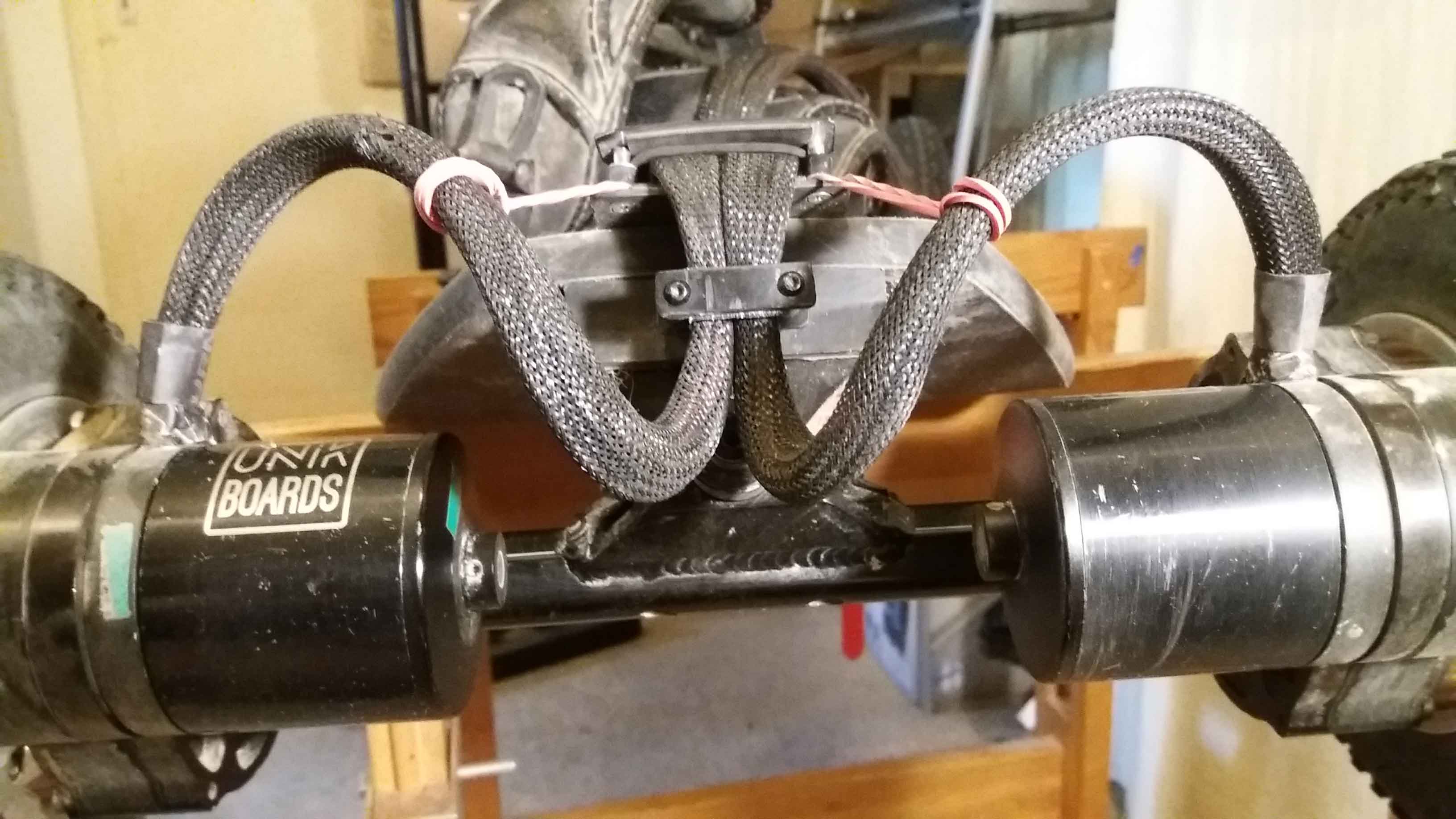

I had some sessions but couldn’t ride as much as I wanted. Often the dirt park was too muddy or I had other problems like a slimy flat or loose motor gear.

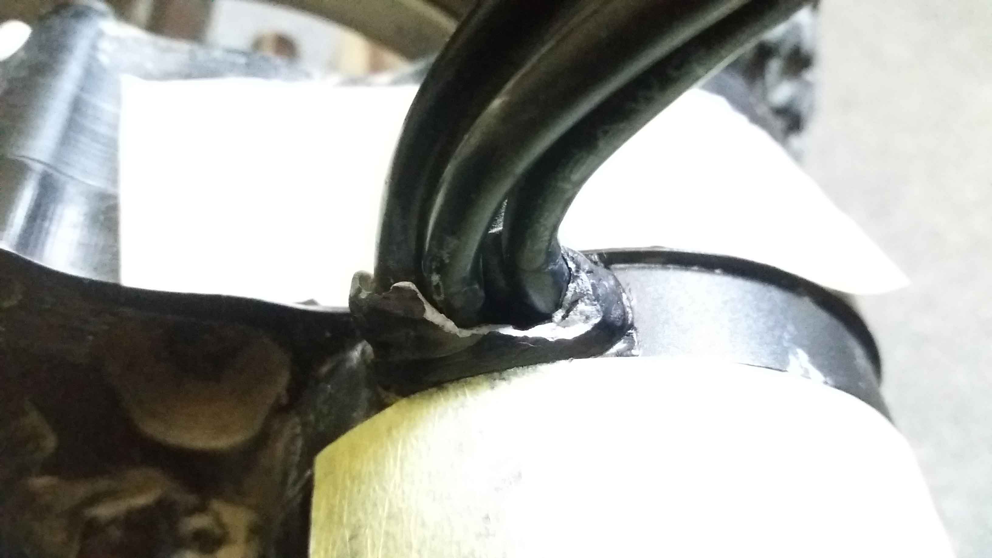

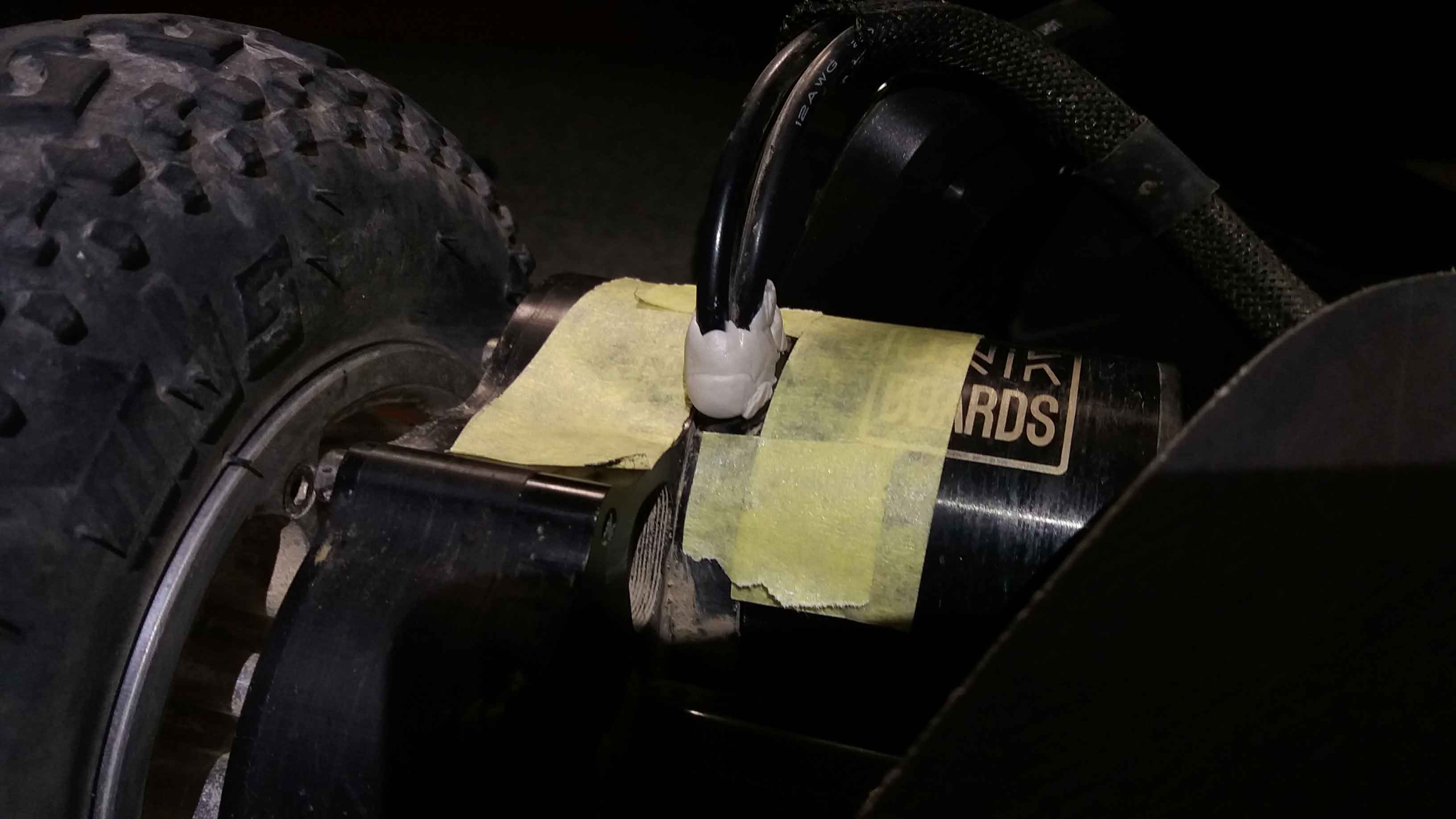

I got issues with the motor wire managment. The vibrations from riding/jumping is even to much for the epoxy, it broke on both motors.
So once again
I realized the wires bounce around like crazy and there is a lot of strain, also the wires bend down which is not good.
My professional method to support the wires are rubber bands for now but it works :laughing:

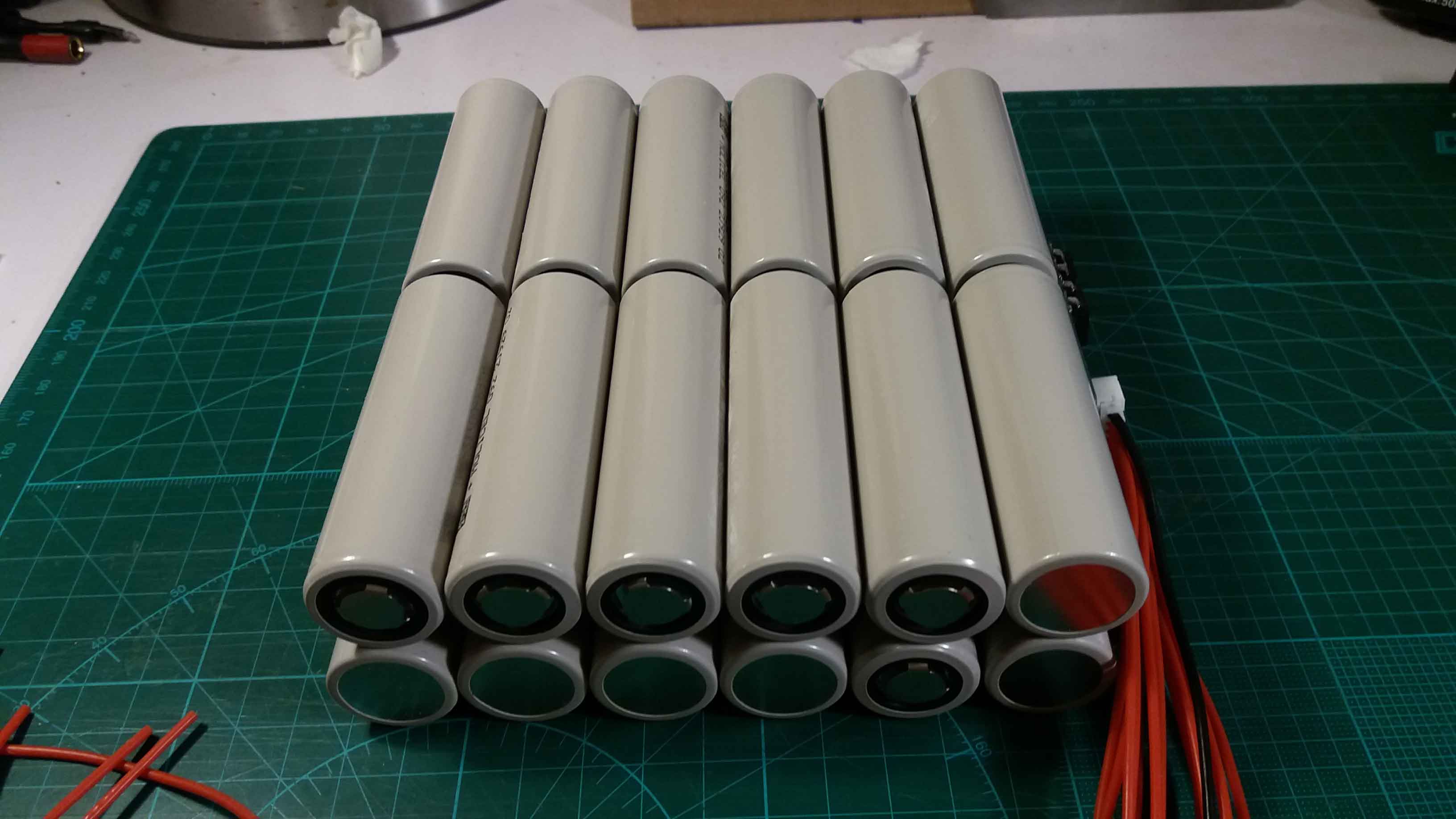

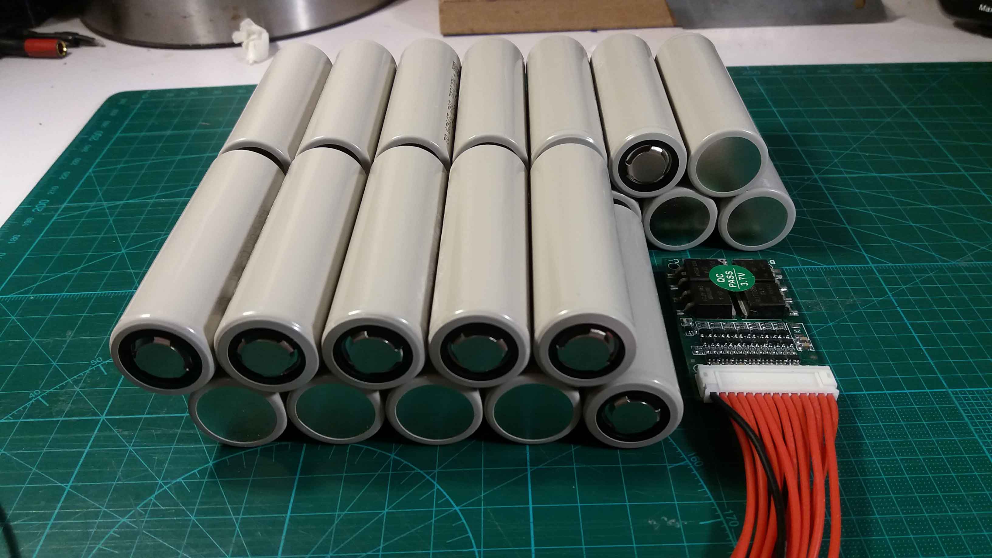

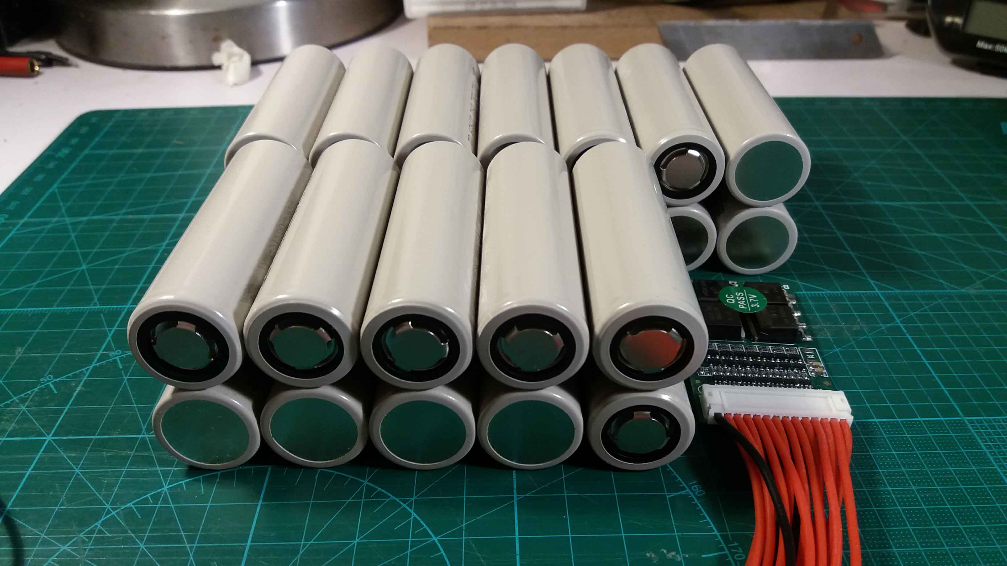

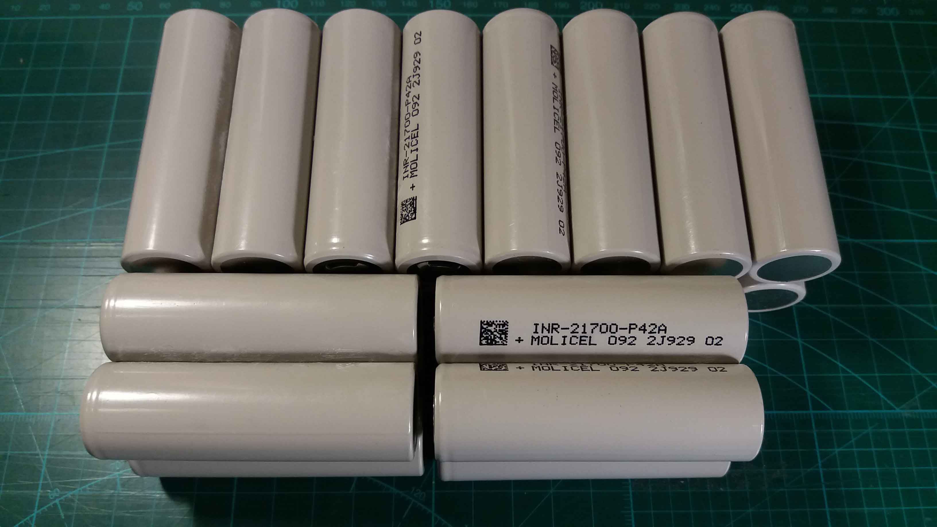

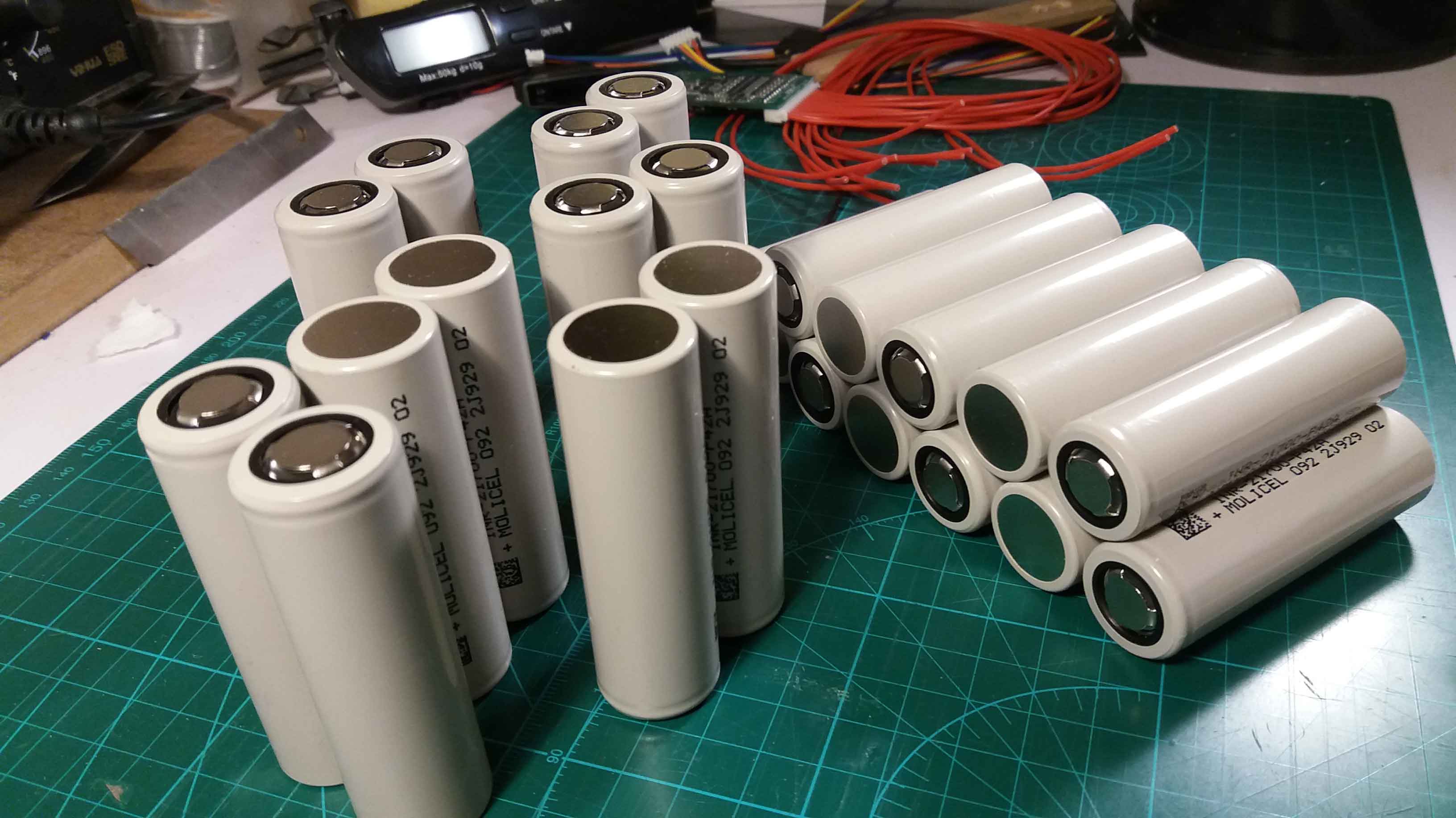

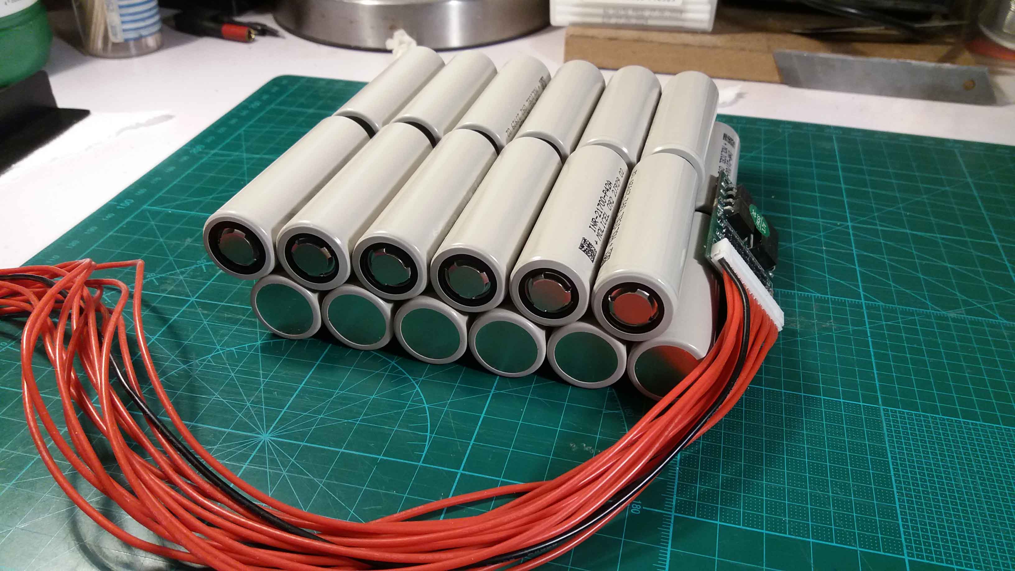

I am working on a 12s2p with 21700 Molicel P42A cells. If the voltage sag is not too horrible I’ll build a second pack for swapping. I expect about 5V voltage sag at 50 battery amps.
I bought 2 cheap very small charge only BMS. The disadvantage is that there is no balancing but at least charging stops when the first cell reaches 4.2V. Need to check cell voltages from time to time.
Now I need to decide between 5 options how to lay the 24 cells (ignore the battery poles)
1
2
3
4
5 (if I’m funny)
The good thing is that I could build a 3p or even 4p in the future which has the same width and length, just higher. I haven’t decide on the best way to swap battery packs but maybe velcro.
