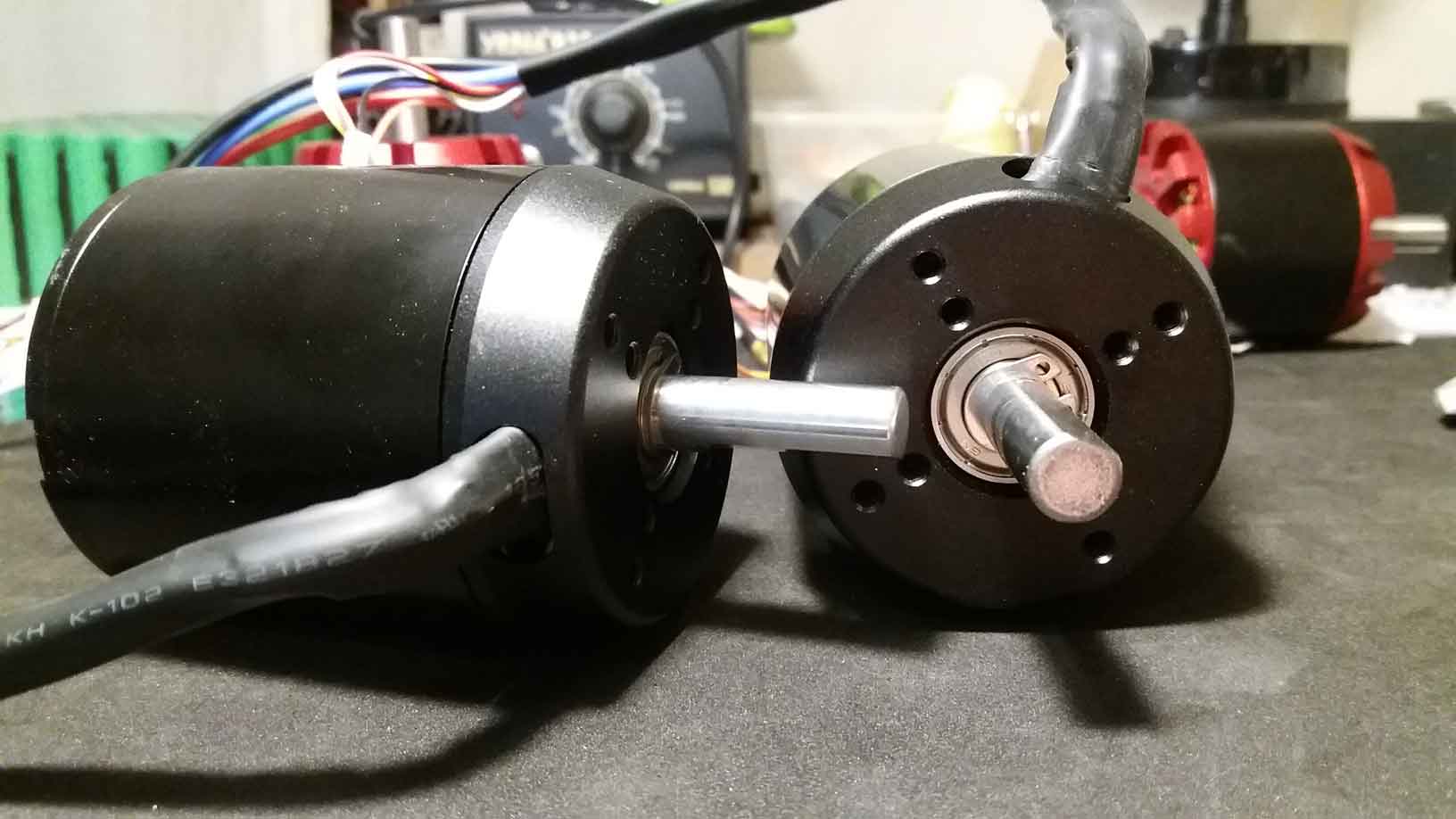

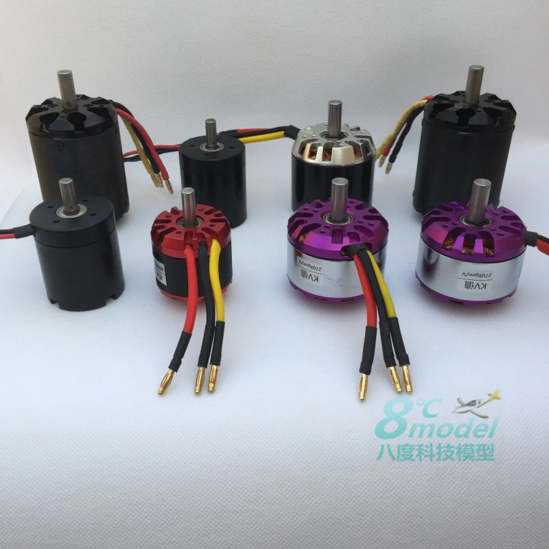

Oh please no and yes I have this beautiful motors in 6384 200kv
Exquisite loose windings :ok_hand:
Perfect spacing between magnets :ok_hand:
and these motors are loud!
After destroying too much so called “premium motors” I also ordered cheap ones. They send it via DHL so I had to pay customs plus other fees. In the end I had shitty motors for the price of a “premium” motor :ok_hand:

I remember seeing these pictures just couldnt link these to the same motor.

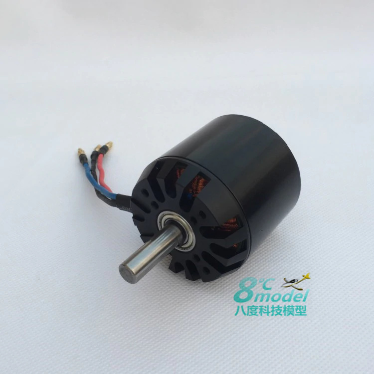

Actually there are 2 can designs for these, if not even 3, if we count the flipsky one with side openings on the can.
I think these 4 hole ones are shitty indeed.
The motor I have on hand has multiple openings and resemble something maytech offered a while ago and longhairedboy might have had in a few batches long time ago.
(example)
Speaking about motors, from what ive seen here and elsewhere (endless sphere)
Flispky seems to have really shitty ones even if they charge quite a bit more than others… If im not mistaken endlessphere guy received seized motor right from the flipsky

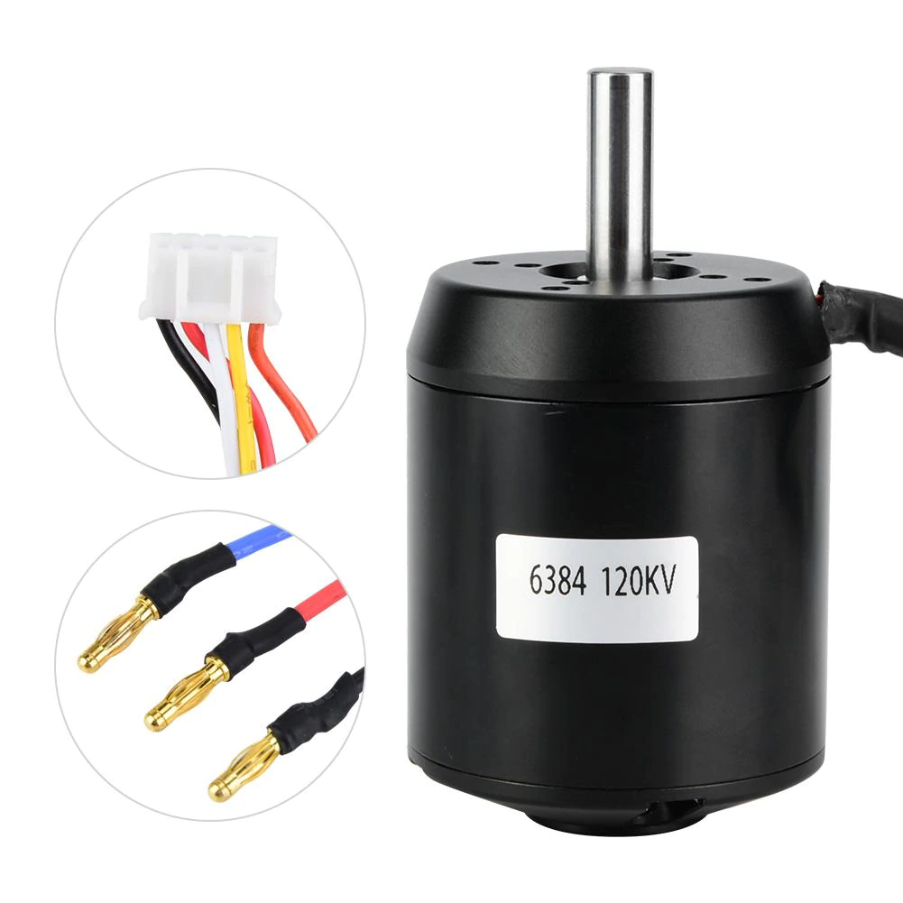

This one’s the 120kv one, though wiring look doesnt convince me and I would think 2-3-4x times before ordering, otherwise seems very much like what u have.
‘China motor market’ … havent ordered from him but has multiple options, some looks like cheapest there is, something like hobbyking had a while ago…
Im not sure what bioboards has but maybe they have something better?
Otherwise seems like custom batch is the only way to go then, with factory where there is good quality control and not - slap and sell

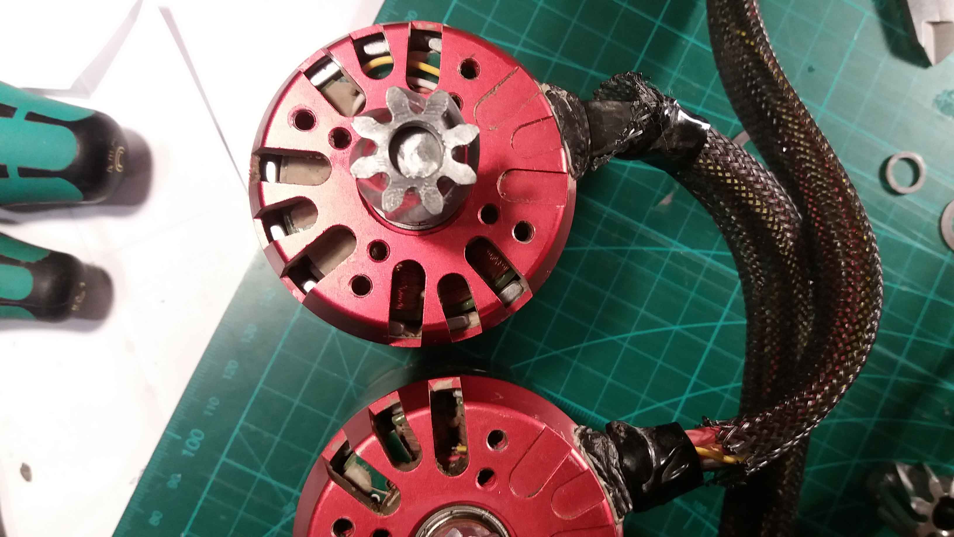

From pics it’s hard to tell if the windings are loose. They are glued with transparent I guess epoxy.
Just as an example this looks loose but it is not. I found loose windings just beside but not these which stick out
The only way to find loose windings (or at least how I do it) is with a toothpick. I try to wiggle/move every strand I can reach.

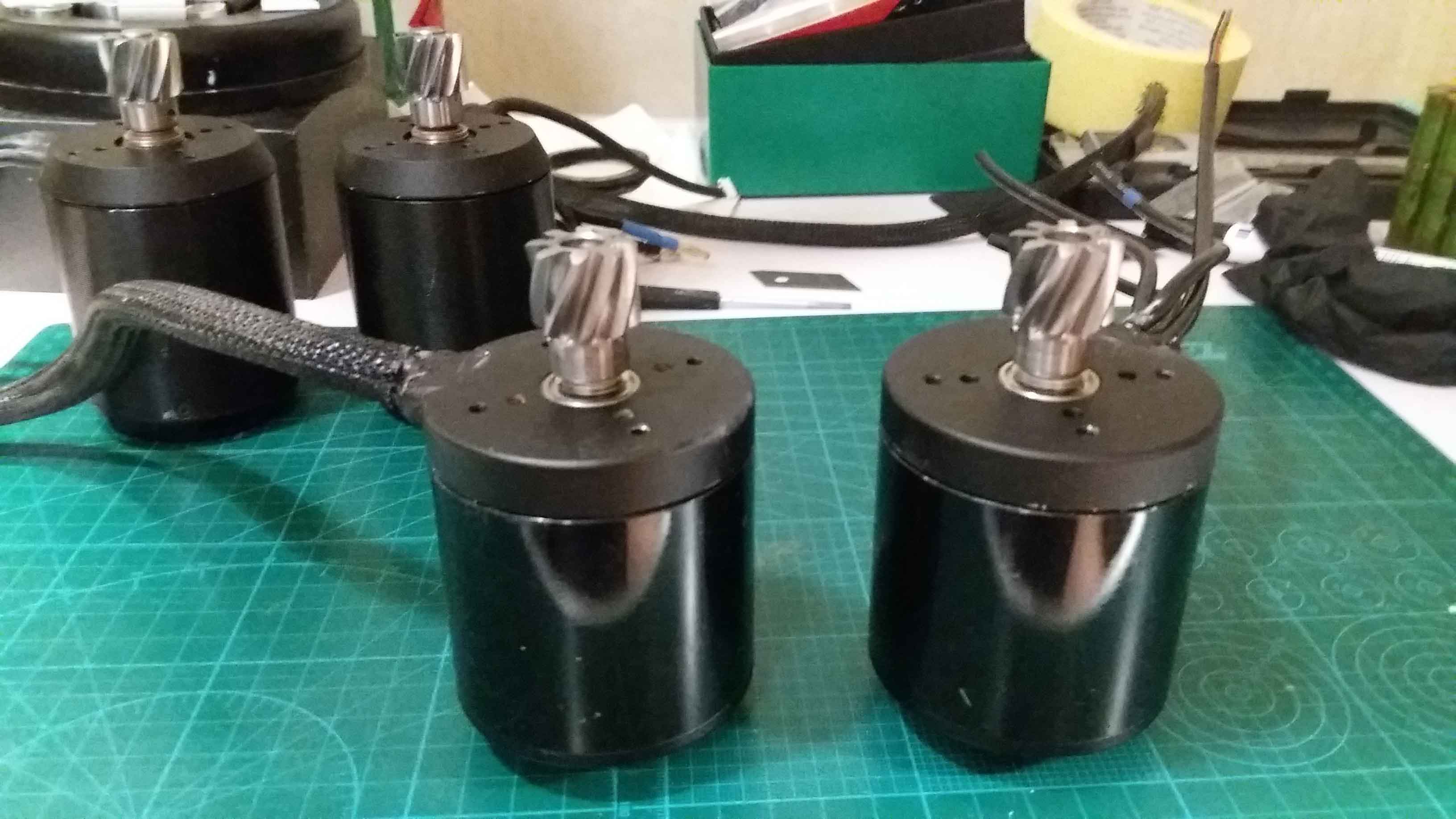

I switch to 149kv Maytech’s which I had at home. I battle hardened them to have them longer than just a few weeks.
I had several Maytech’s with internal shorts so it was important to secure the cables inside and outside that they can’t move.

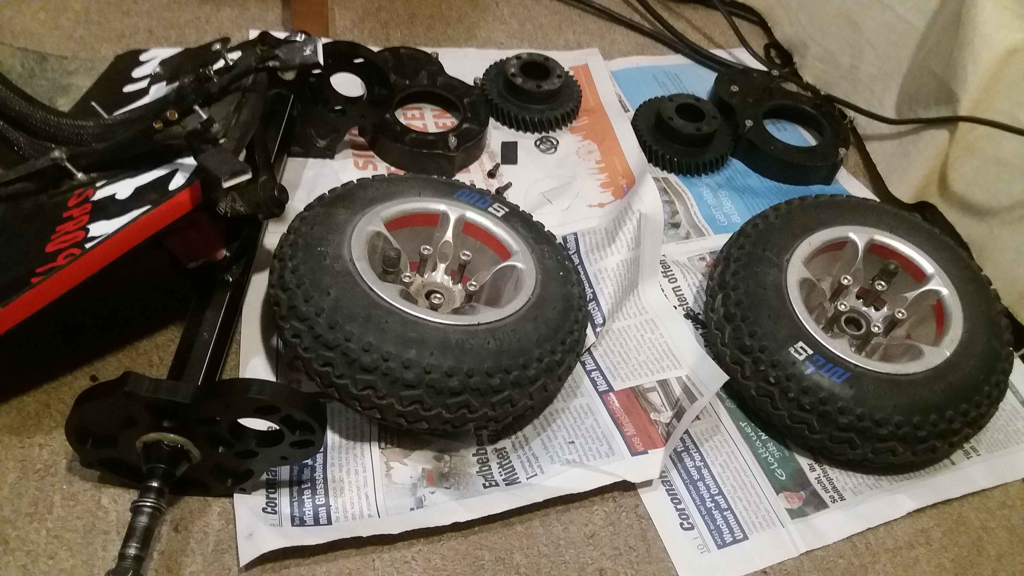

I needed new helicals with 8mm bore.which I received and glued last week.
I want to ride I mean jump again within the next days. Need to solder the motor wires and sensor extensions first.

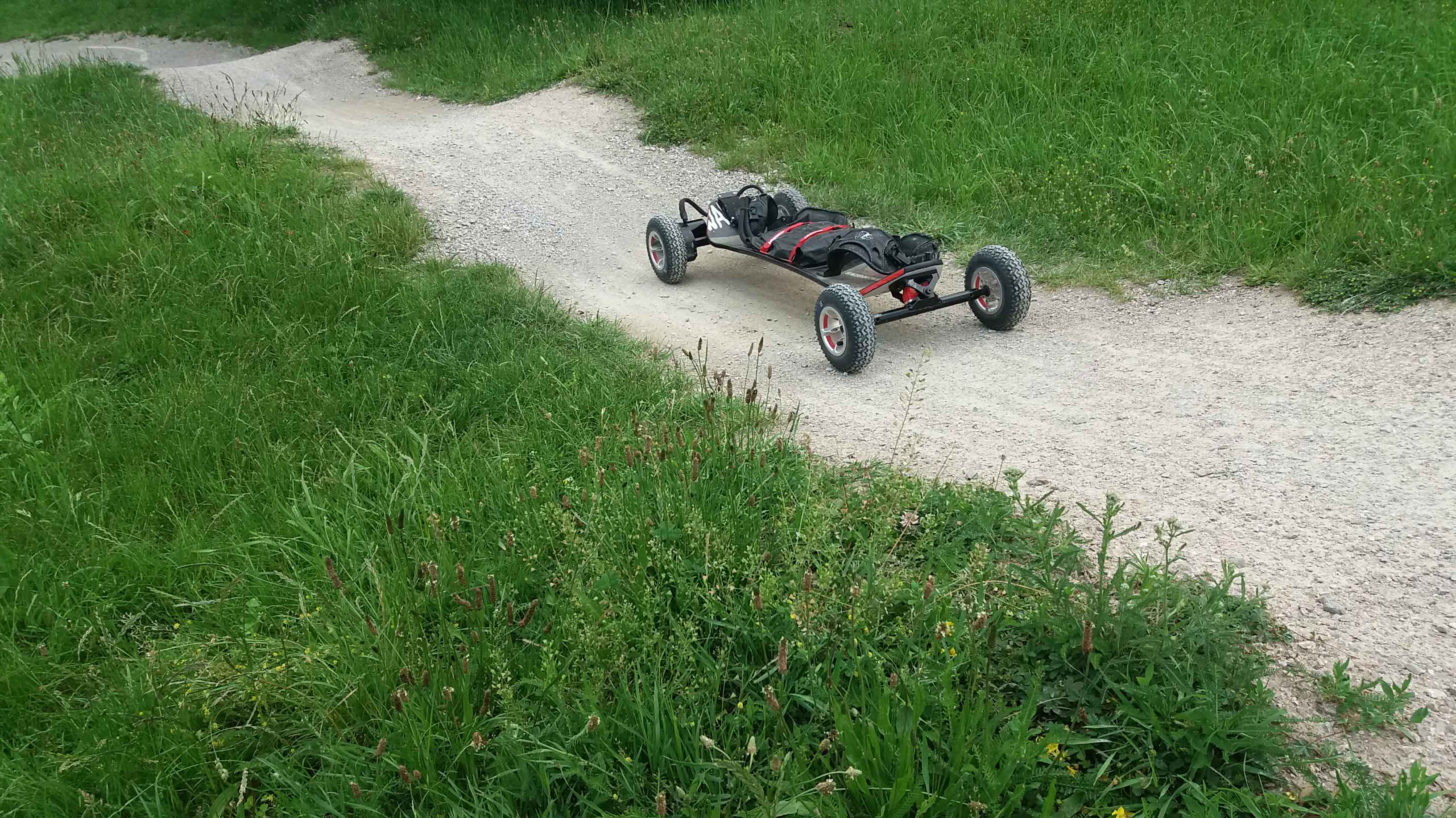

Oops, one month later but finally I had my first ride today after a while.

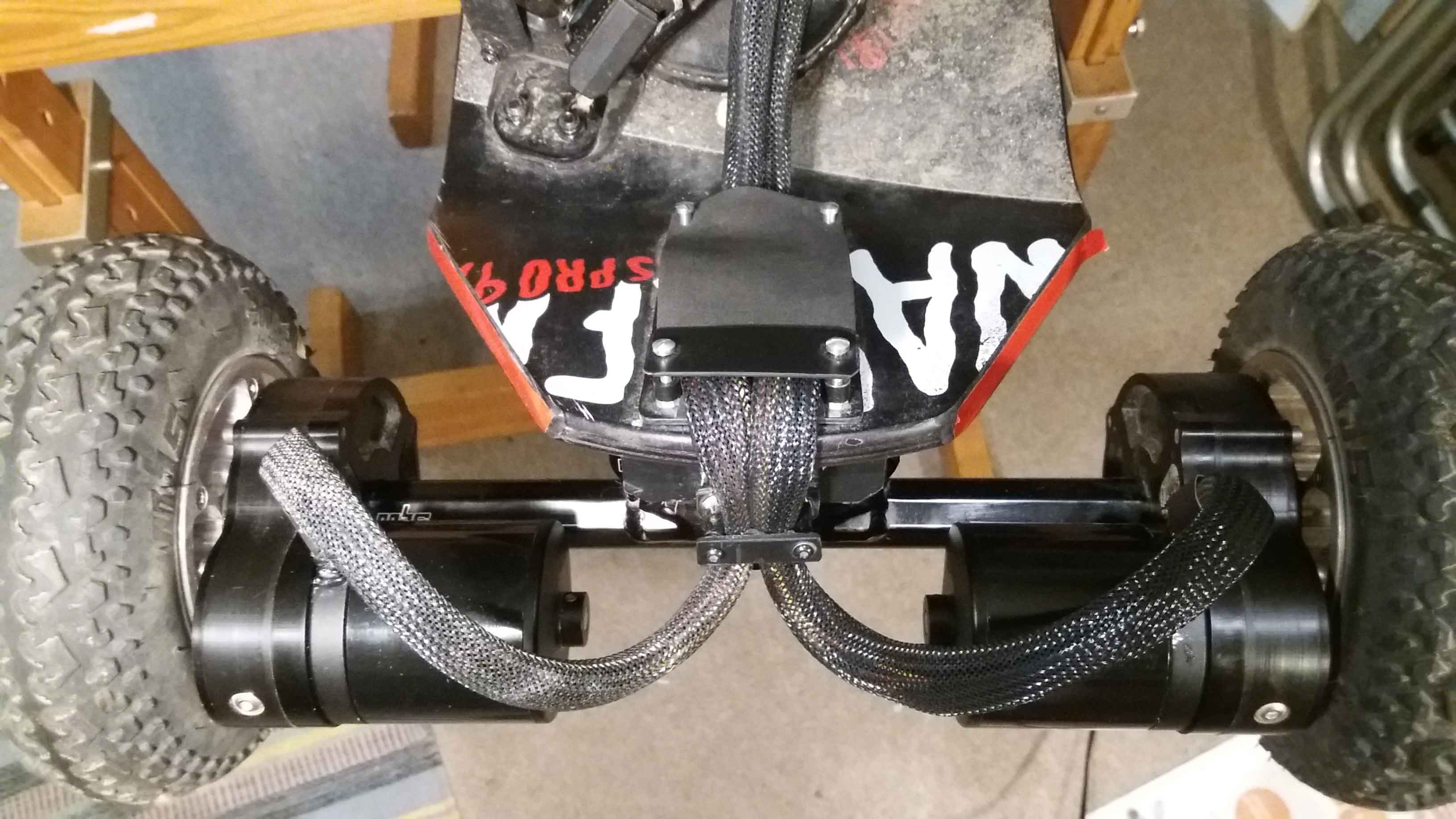

I filed and sanded the hanger to hopefully prevent mount shifting

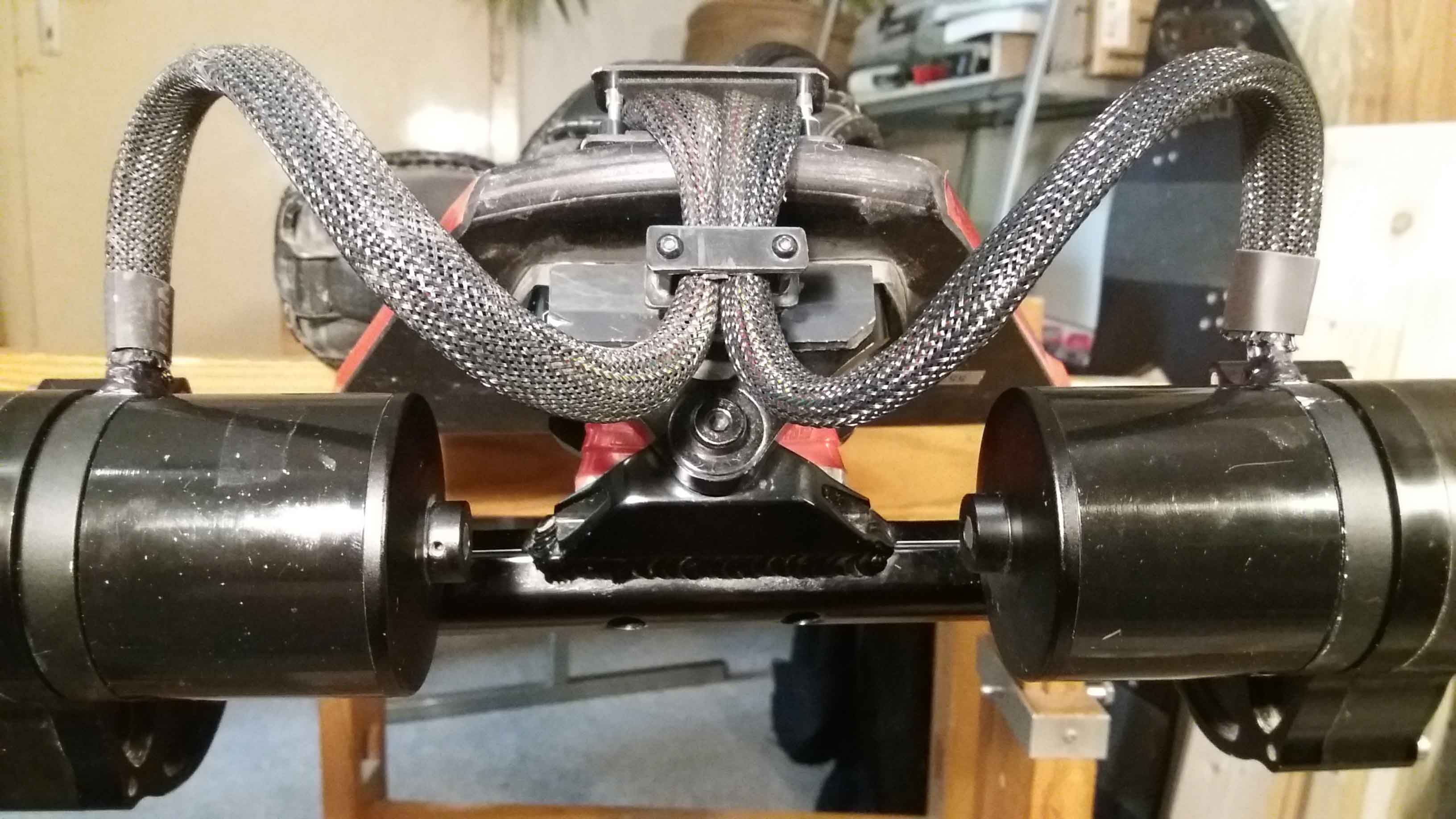

Then installed cable management and strain relief mounted to the baseplate.

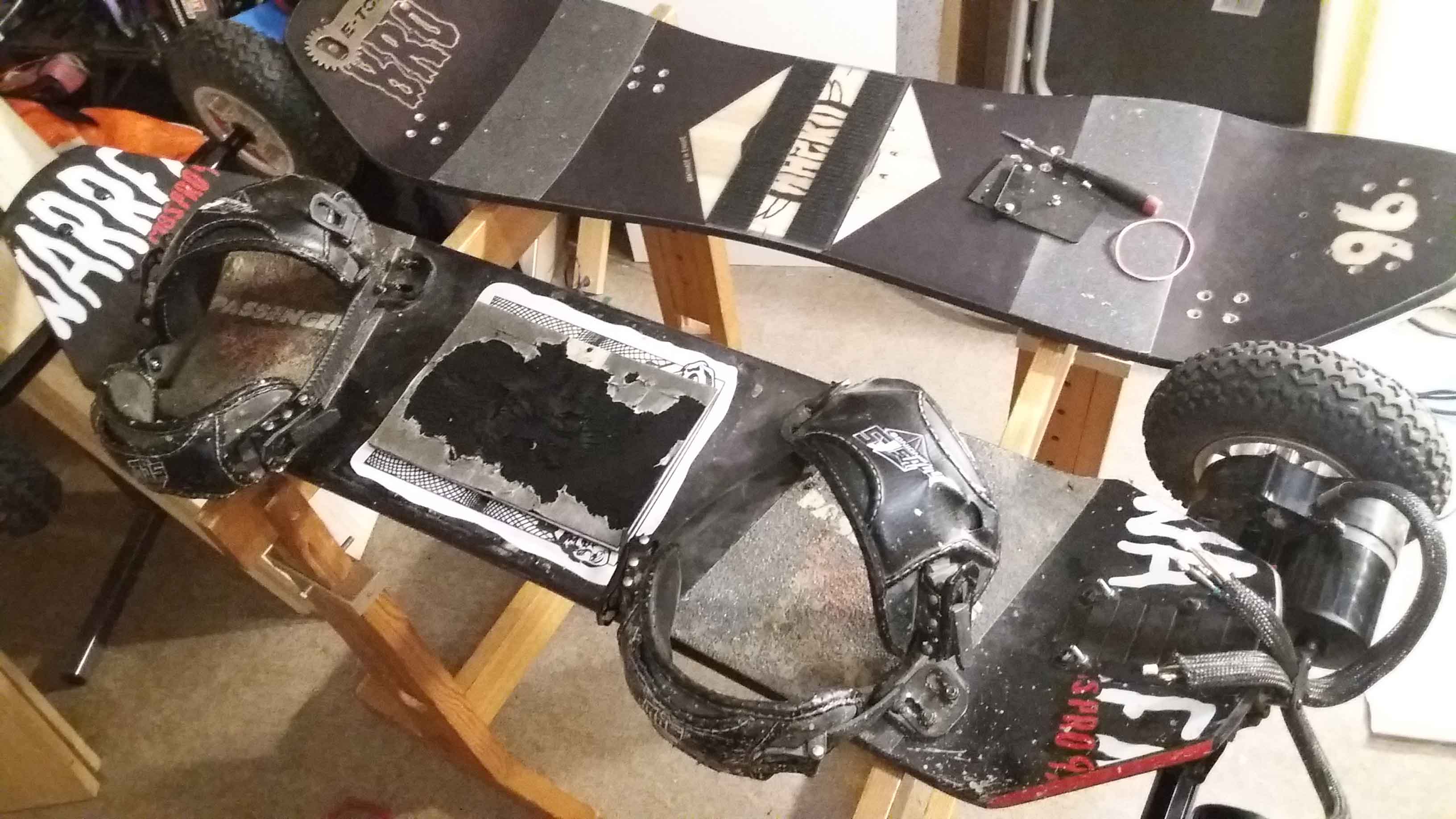

It’s time for the Bro, started to disassemble the board already.

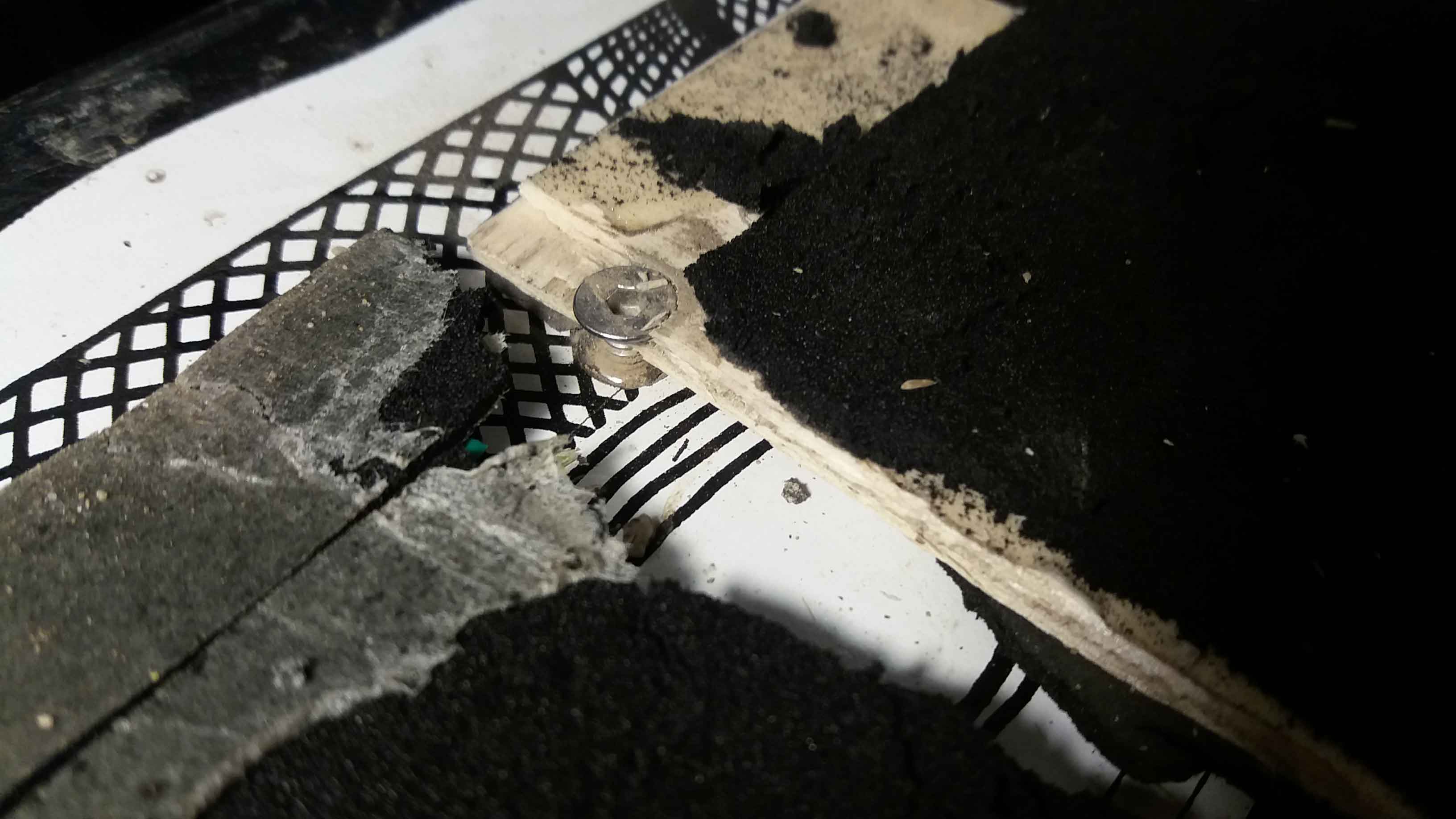

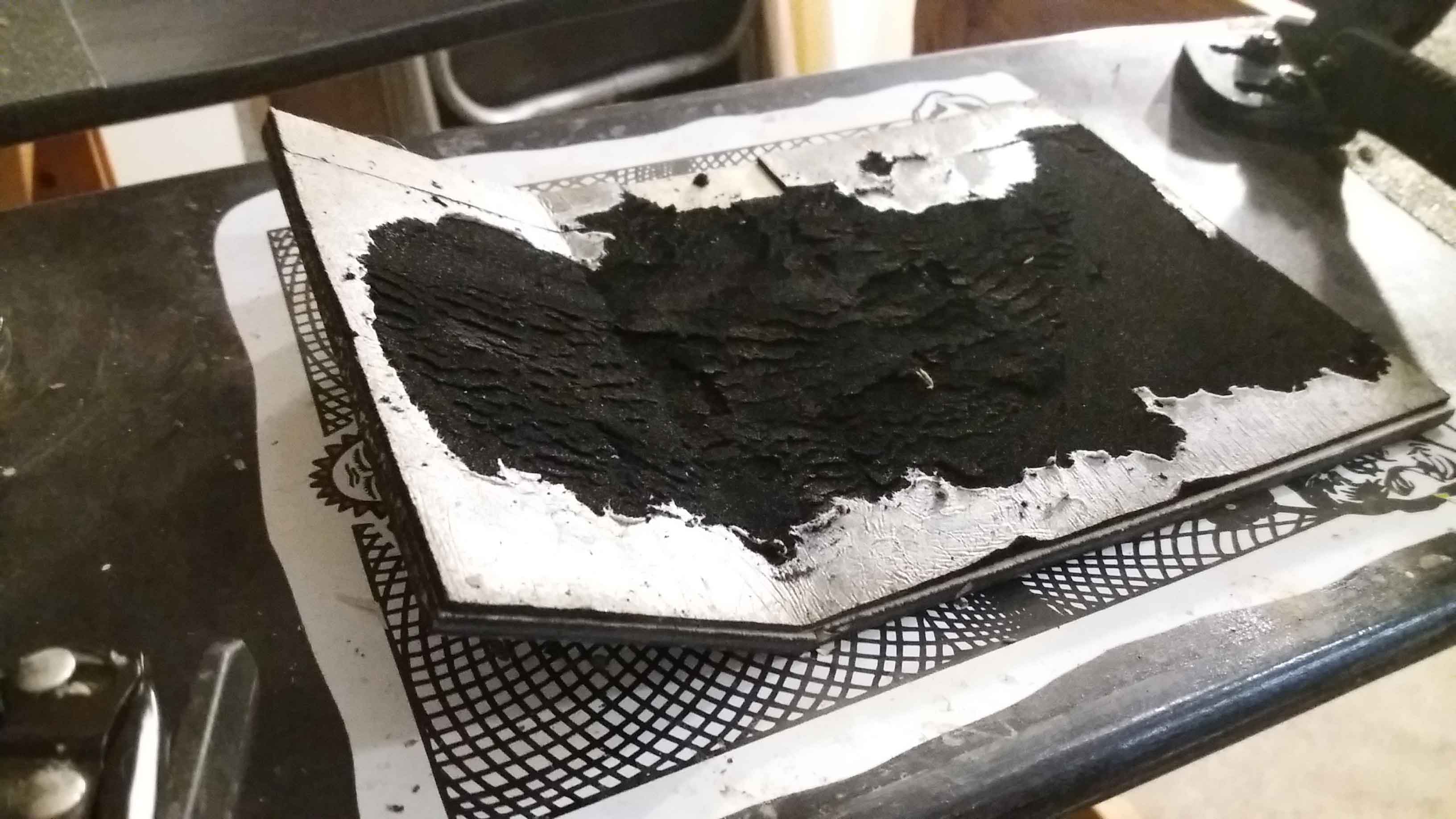

Oops the wood broke :man_shrugging:
