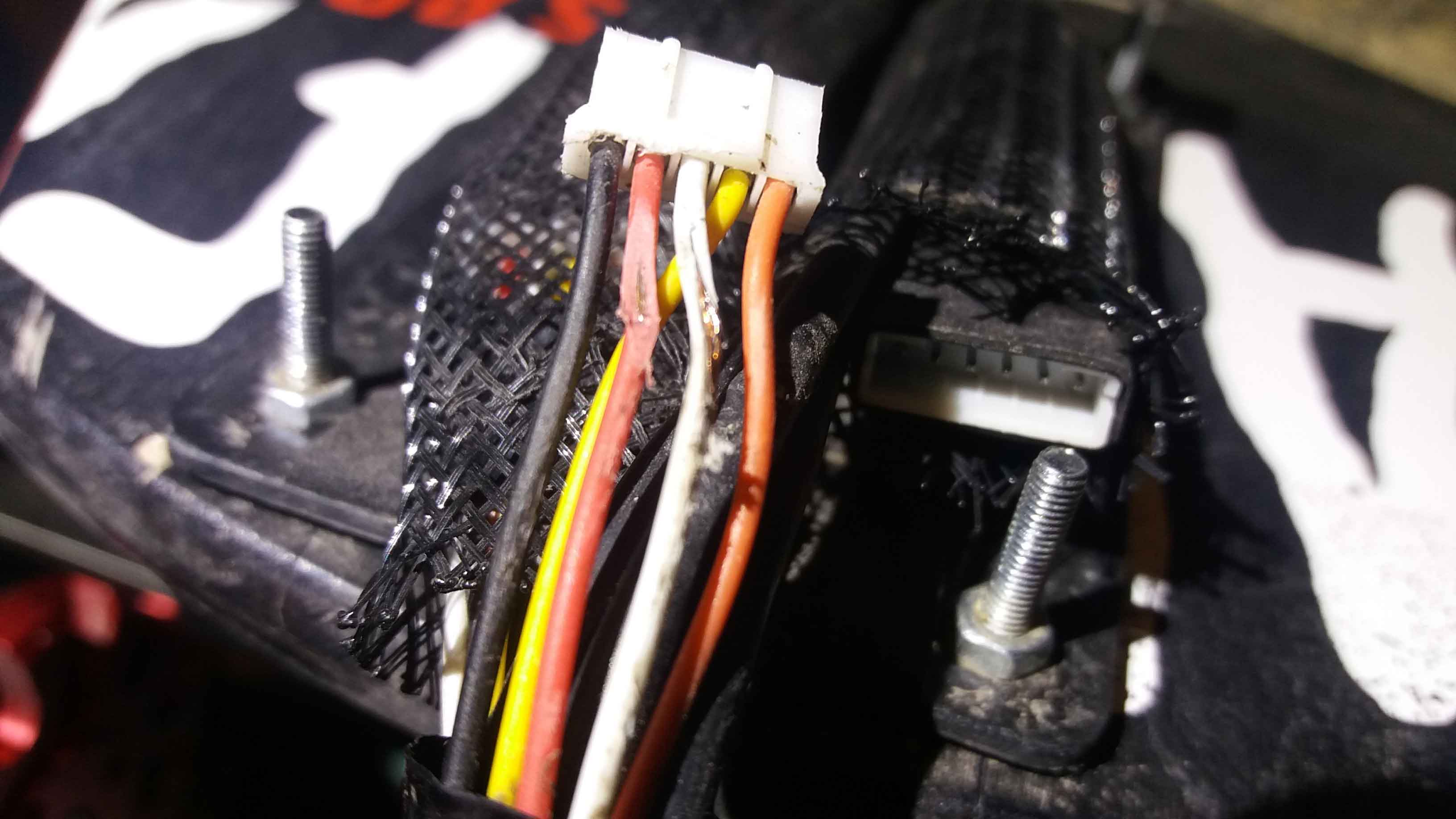

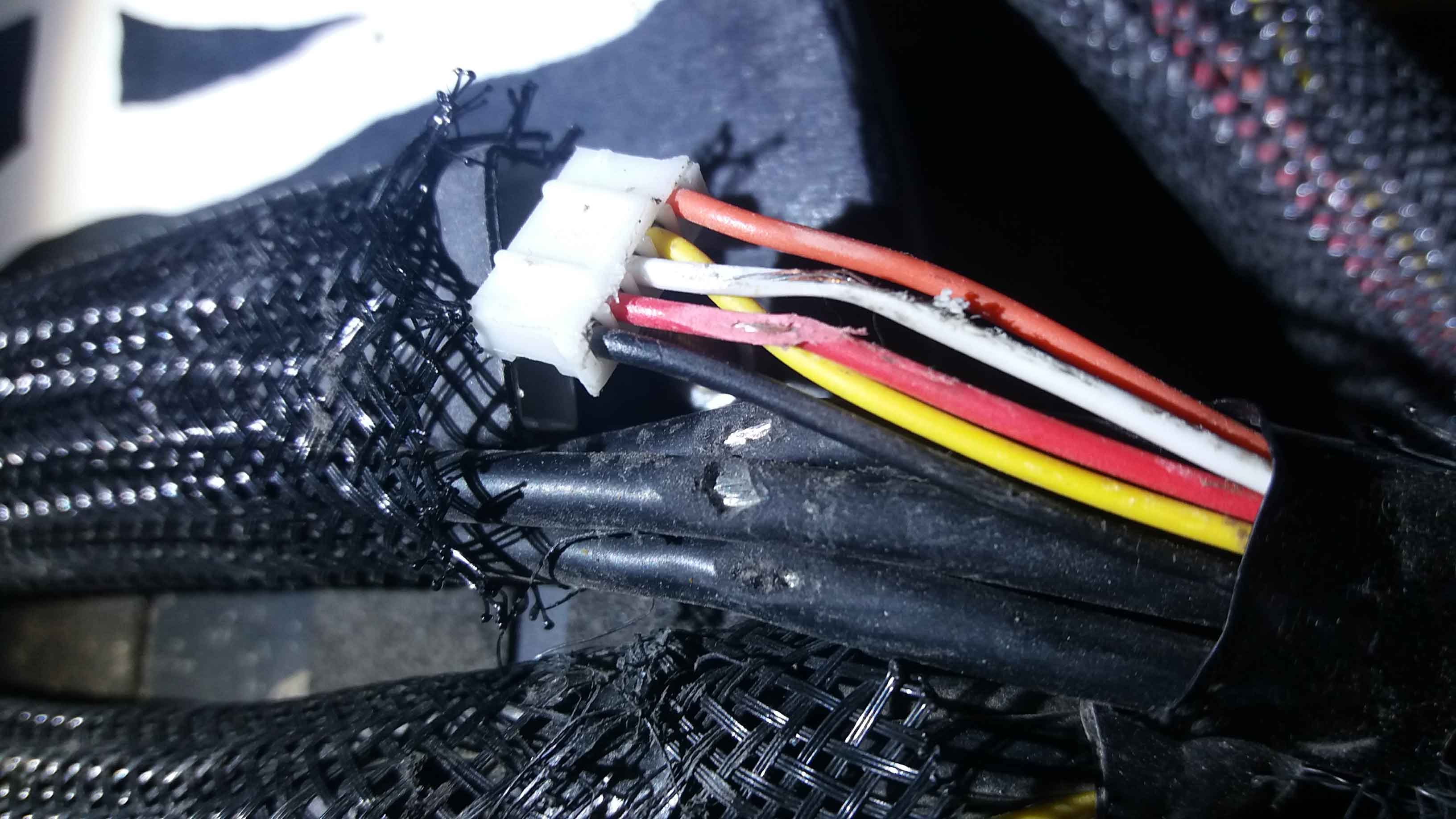

I stripped almost every cable :flushed:
The problem is that I didn’t use stand offs on the bolts that’s why the wires getting squeezed on impacts.
Lesson learned.

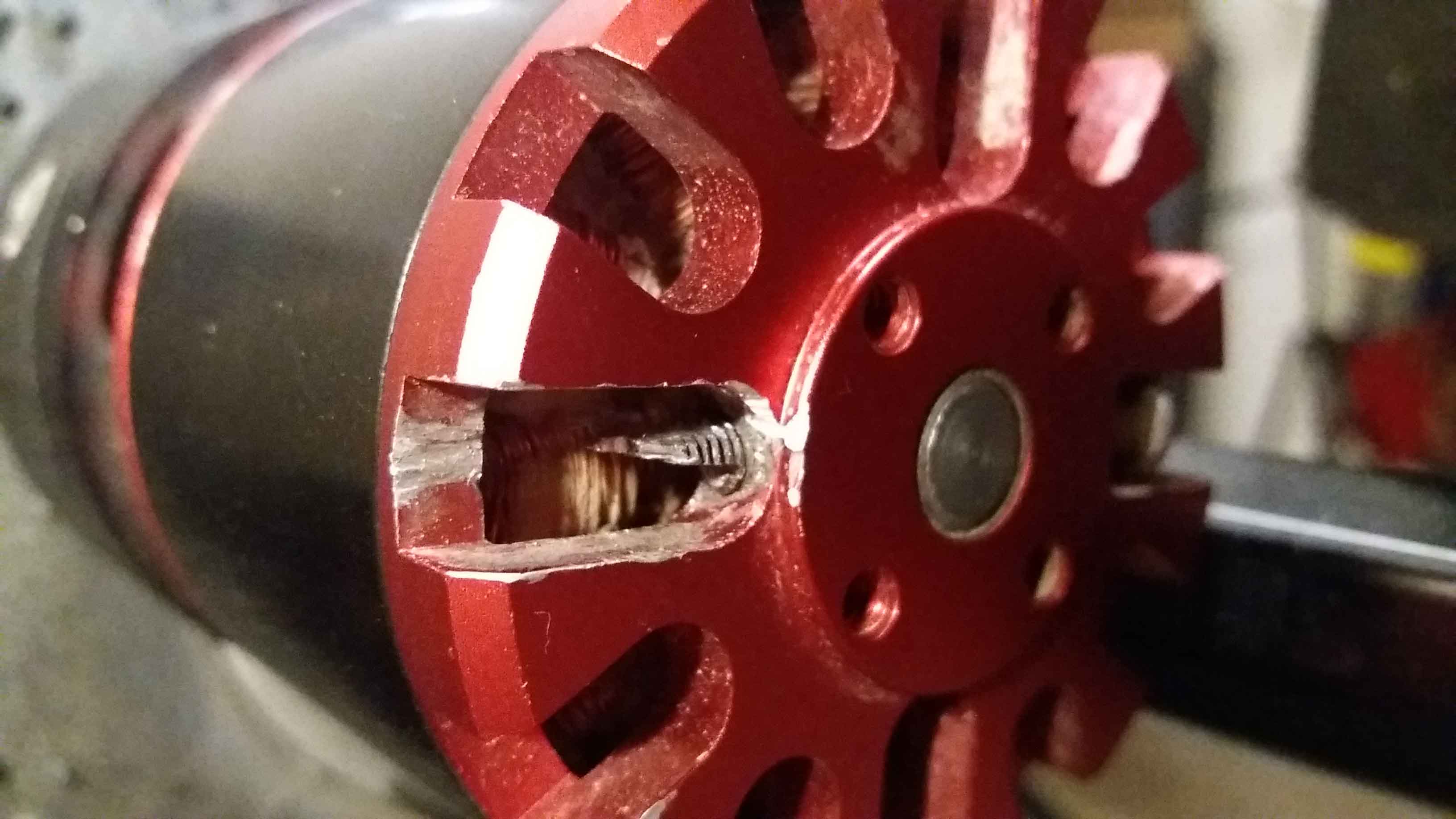

My bigger problem is one motor, the shaft shifted inward and i can’t fix it because of the stripped bolt. I already glued the shaft 2 times :man_shrugging:

I was riding and after doing several burn outs in reverse within a short time one side died. The motor was just shaking but not rotating, only the other side. The cables are fine and both fsescs have normal led’s and react to PPM input. Well then I shot a video but the behaviour changed. Now the motor doesn’t shake/cog anymore (just one small twitch) and the other motor spins very slow. I have to investigate further.
Normally I would suspect the hall sensor wires but I fixed them and it happened while doing burn outs :man_shrugging:

I have to fix things all the time which sucks and is a never ending story. But to see it positive, I like that I can fix most things because I built it. Also meanwhile I can feel the difference if just 1 hall sensor cable is fucked up or more, or if it’s the phase wire or whatever. Learning by doing.
The fsesc and motor is fine but I killed the hall sensor :face_with_raised_eyebrow:
Maybe the fsesc sent some voltage spikes when doing burnouts which would be bad. I have no other explanation.
The motors are shit anyway so unfortunately I need new motors :roll_eyes:
I liked the 6364 size, more power than 6355 but lighter than 6374. I see no chance to get a 6364 in 150-170kv and 10mm shaft somewhere. I guess the only alternative right now is an APS style 6374 in170kv. 6355 would be lighter but a bit lame, have to think about it.
