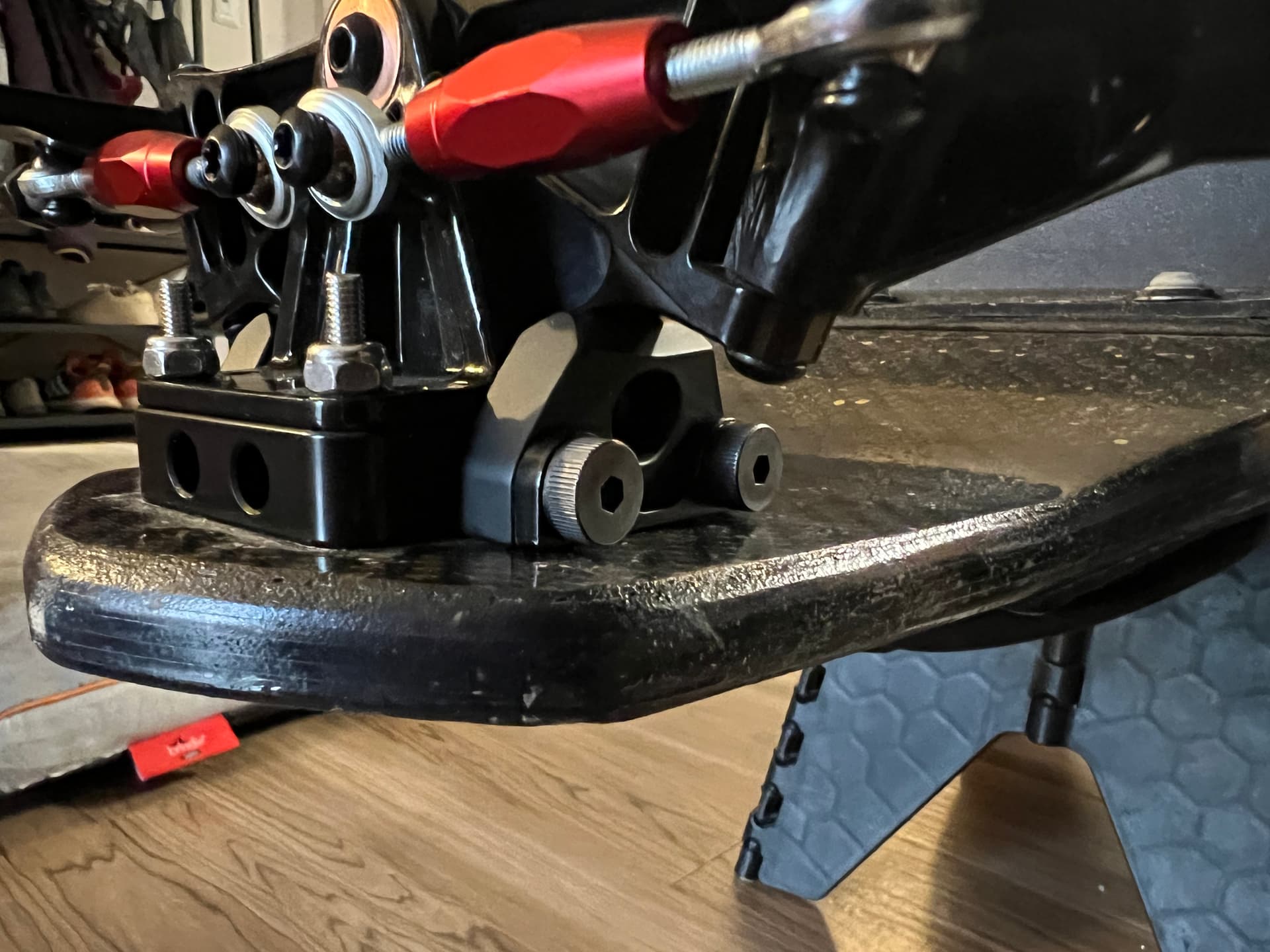

So, like @Avi i got the prototype rebound adapters as well. Took them out for a 18 mile ride and it felt much better relative to your traditional trucks. I generally ride Krank riptide bushings so am used to high rebound, and this was closer to that feeling. Only one duro right now as these are prototypes.
Downside of my ride today is that I thought maybe by moving the arms in I’d put them into ā€œcarvyā€ mode. But seems they were already in that mode, because my feet are sore from trying to turn. The ride was stable af at speed though.
I need to move the arm thingies back, and print the recommended +10-15 degree riser to try and get more turn out of these. I think it’s the no rebound aspect of the trucks which make them feel loose and initiate turns easily, but in terms of actual turning angle not much right now.
Here’s in stable mode, and I’m 200lbs:

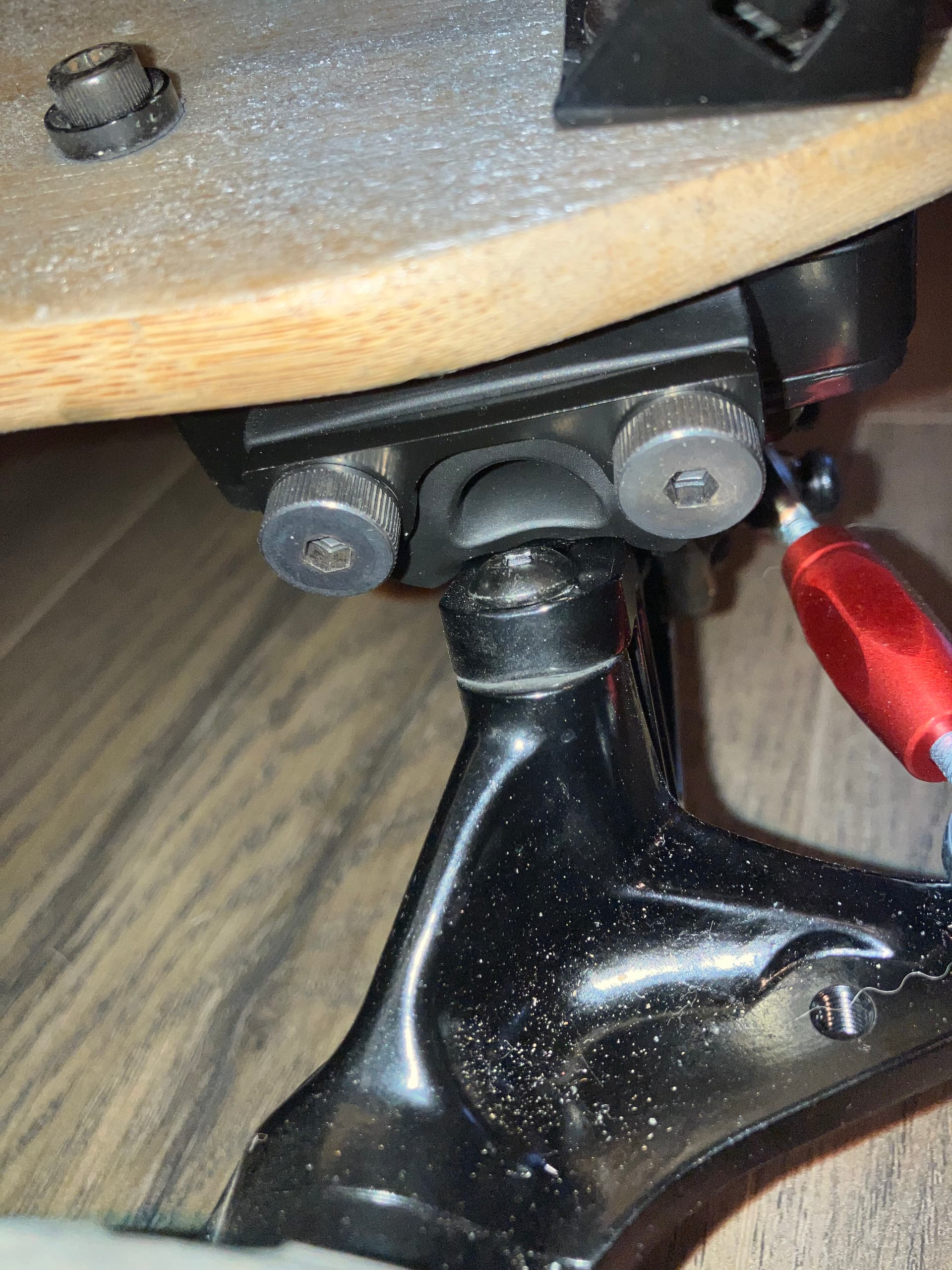

The lack of turning with rebound adapter is because the bushing gets caught and can’t compress any more. Juma is looking into alternative designs for the bushings to address the issue.

Yeah this all makes sense, but even without rebound I was surprised by how wide I had to make u turns vs my RKPs. Hoping more angle will help with tighter turns, but not so sure because of the rebound adapter as you’ve pointed out. And I wouldn’t ride without the rebound.
This is also why I mention duro, given a choice I’d go with a softer one.
