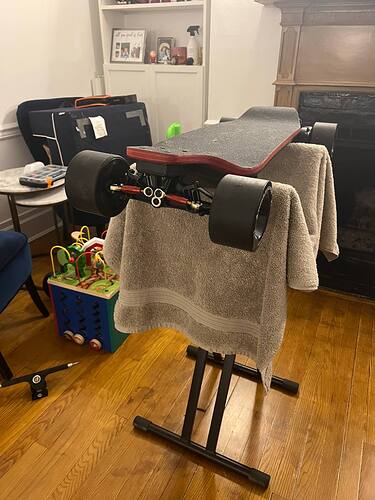

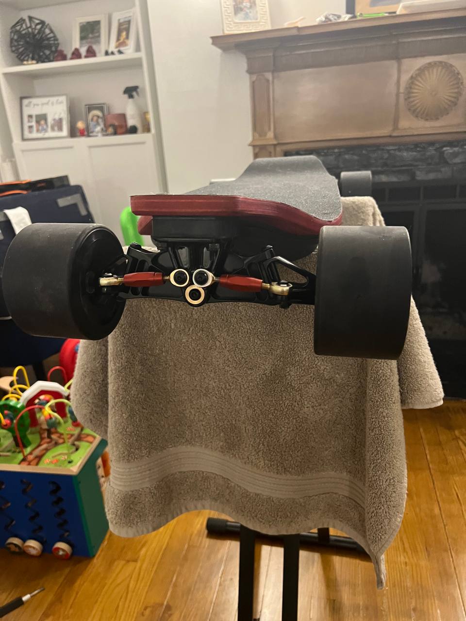

i’ll let you guys know how they are :eyes:
pretty cool, very turny, excited to take it outside

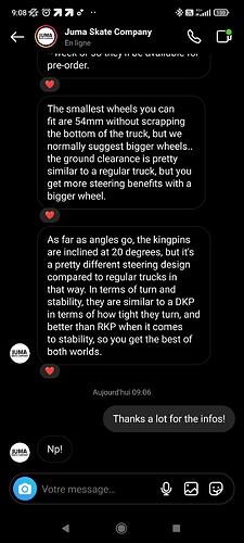

Quick infos to add to the pot about minimum wheel size / clearance and stock angle of the kingpin :

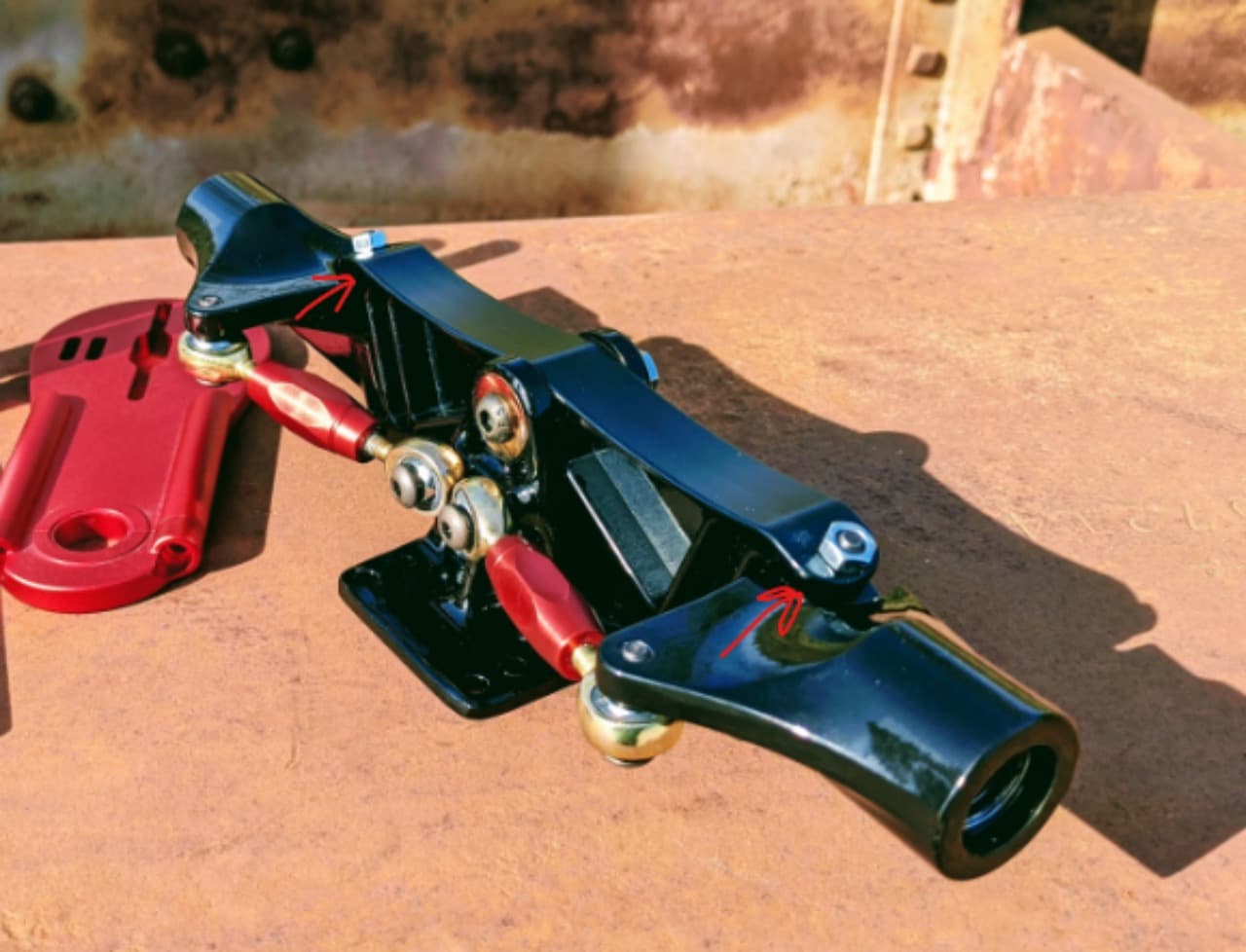

I’m kinda concerned about these bolts having shear loads caused by the weight of the rider and road impacts on the wheel/axle. At worst it’s like channels trucks, but with lever and at two places.
