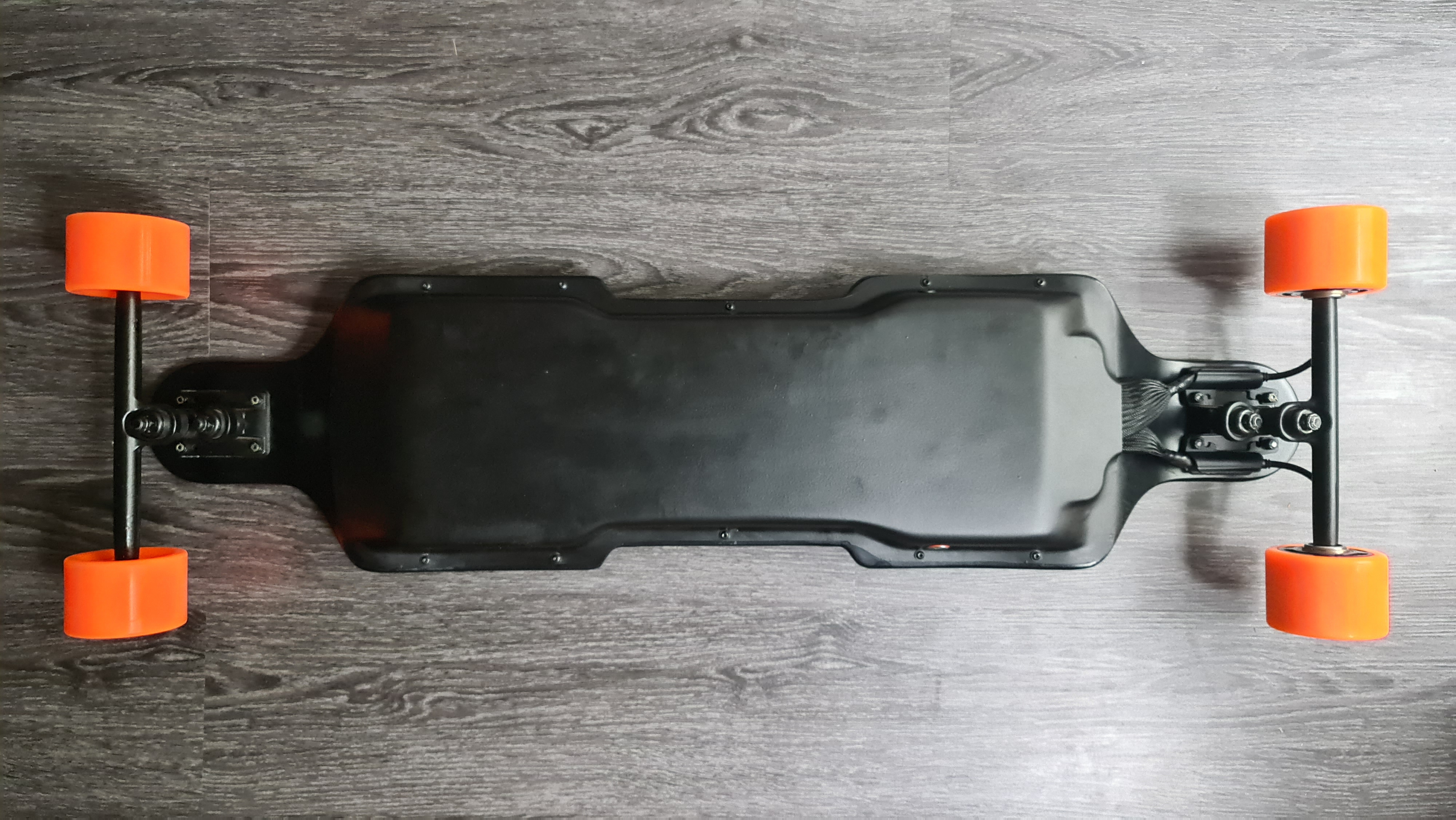

Deck: Manta Pro - good size, nice shape, great flex, high comfort
Grip tape: Dope Grip - thick foam, increases food grip and comfort, awesome look
Enclosure: BB GFK - great quality, adds the right amount of stiffness to the deck
Trucks: 220mm DKP - fun, carvy, increases the clearance and the wheel base, no wheel bite with super loose setup.
Wheels: Orangatang Caguama 85mm 80a - grippy, not to soft for sliding, not to hard for nice comfort, good looking
Motors: Loaded - best quality, powerful, easy to install
ESC: VESC 6 - powerful, customizable
Telemetry monitoring: Metr Pro - best ESK8 data tool hands down
BMS: Bestech/Daly 12S charge only - balancing function, reliable
Battery: 12S2P 21700 40T (12S4P 50E optional) - powerful, reliable, great power/capacity/weight ratio 30-80km of range
Remote: MT V2/FS VX2 PRO - all telemetry data on screen, nice feeling
Charger: 12S 2-5A passive cooled - fast and quiet charging
Mounting hardware: Stainless steel hex screws in black
Yet there are some points which aren’t perfect yet.
  1. Due to the huge drop down and the relative small wheels the clearance is just 35mm w/o load and w/o risers. We could gain 5mm with risers but if you stand on the board you will lose more than 5mm. I personally rather prefer 50-60mm of clearance.
  2. Loaded hubs do not have hall and temp sensors yet. So you need to push start your board and you also don’t get all telemetry data.
  3. No optional bigger sleeves. It would be nice to be able to offer 100mm wheels or so as well.

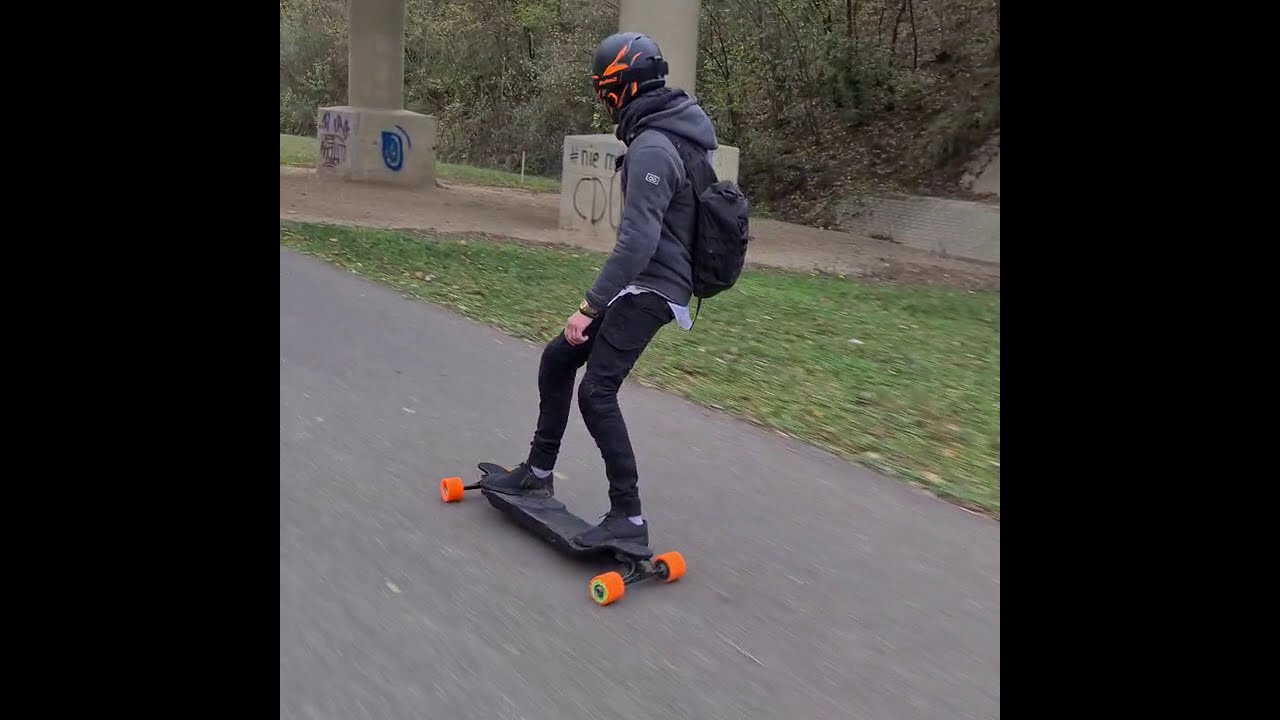

We changed some settings and fine tuned the trucks.
I think it still could have a little more clearance, but the ride is awesome and unbelievable carvy.
First video is online :call_me_hand:t2:
