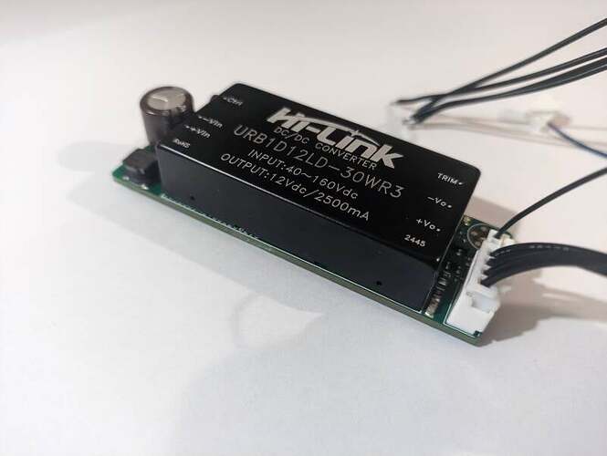

40V - 160V Input, 12V output, 30w DC-DC modules are here.

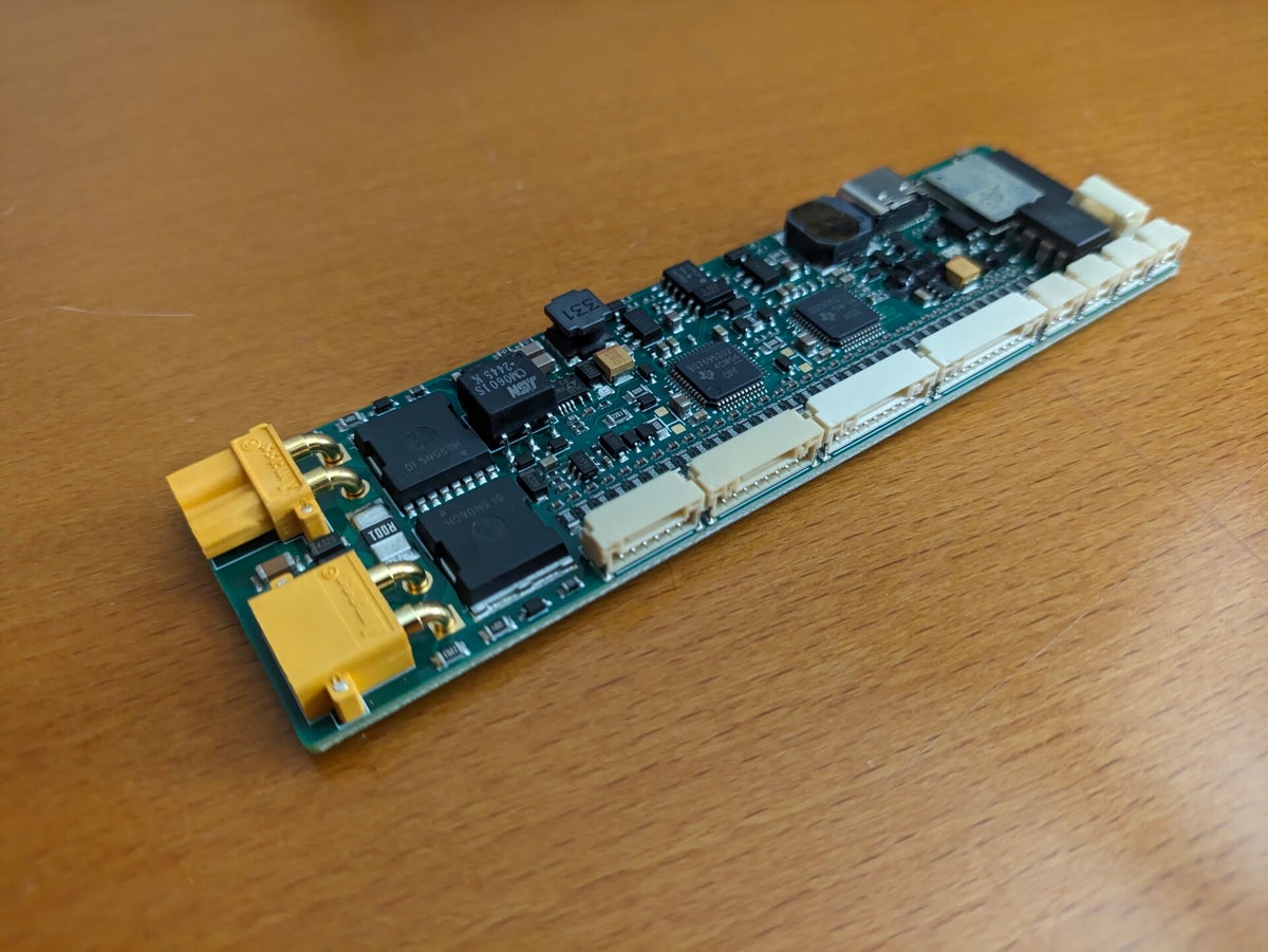

BMS dimensions: 110mm * 32mm
Voltage: up to 32s (134V)

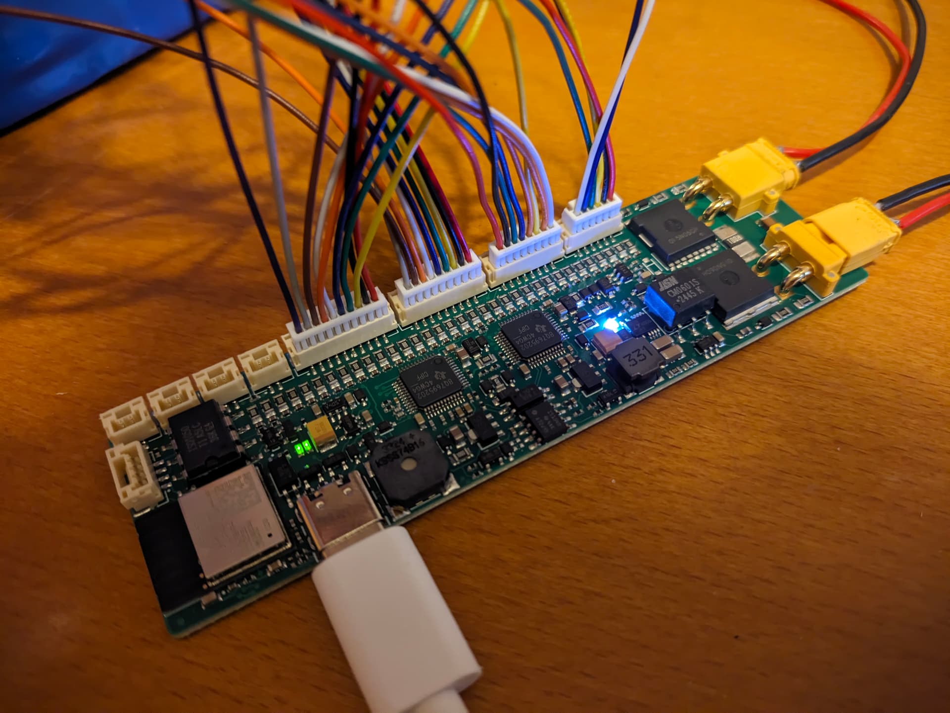

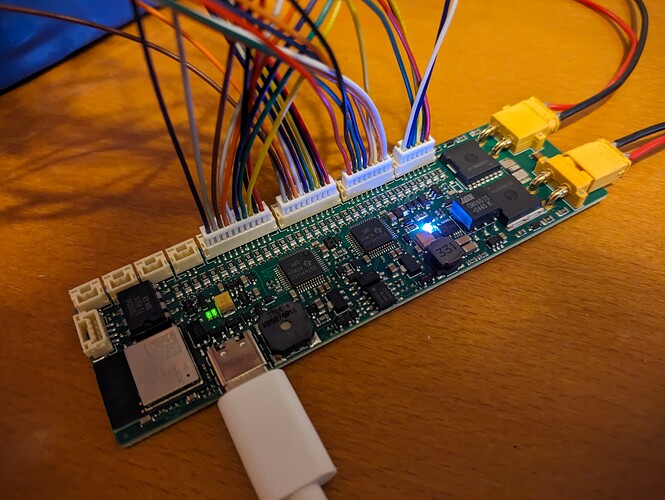

Managed to make a prototype that works.:partying_face:

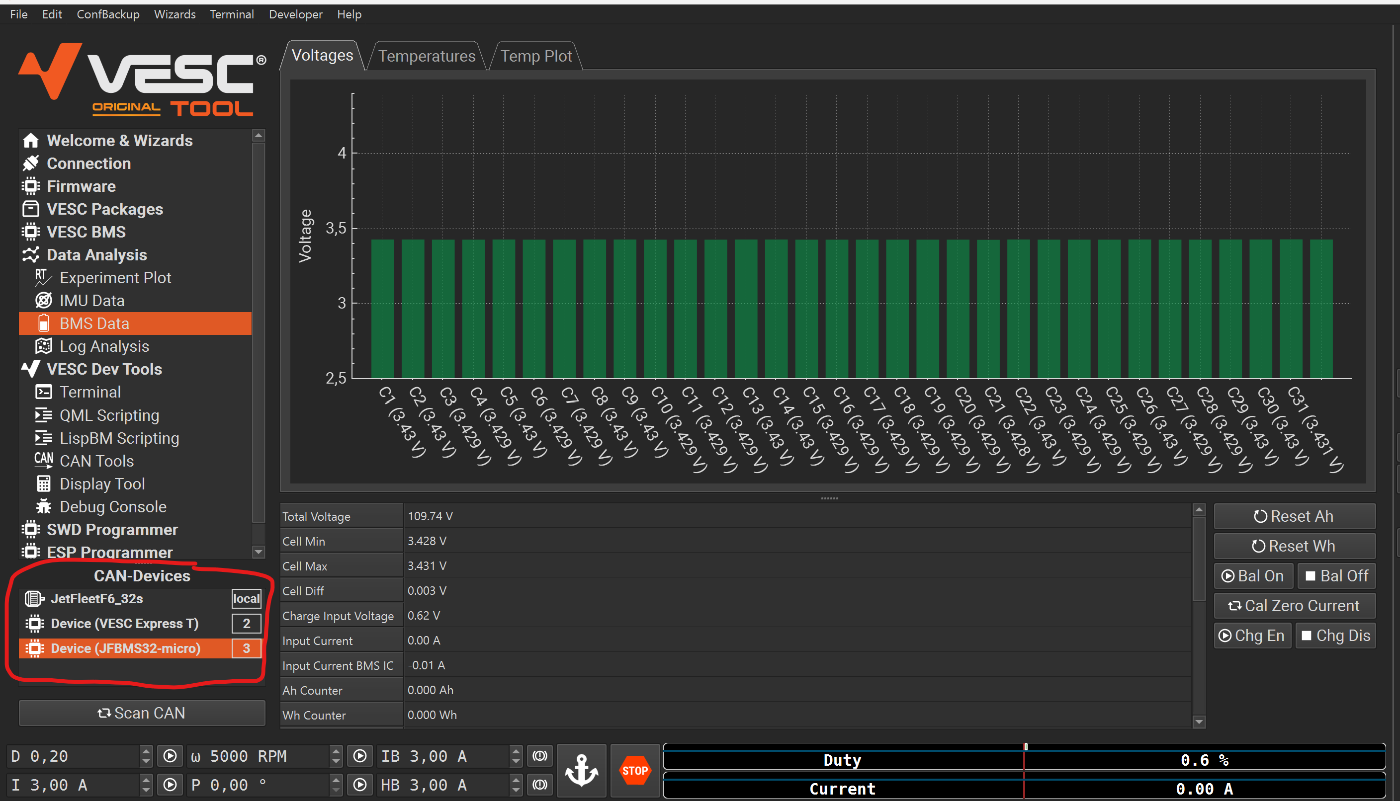

Okay but when TF did VESCTool go from blue to orange? And with a now logo 0.o
Few days ago in beta version.
We finally succeeded — the BMS is working flawlessly and has entered the beta testing stage. This BMS has the potential to become the ultimate BMS for ESK8 VESC systems due to its compact dimensions and wide range of functionalities. It can work from 4s up to 32s battery.
Awesome! It is charge only right?
