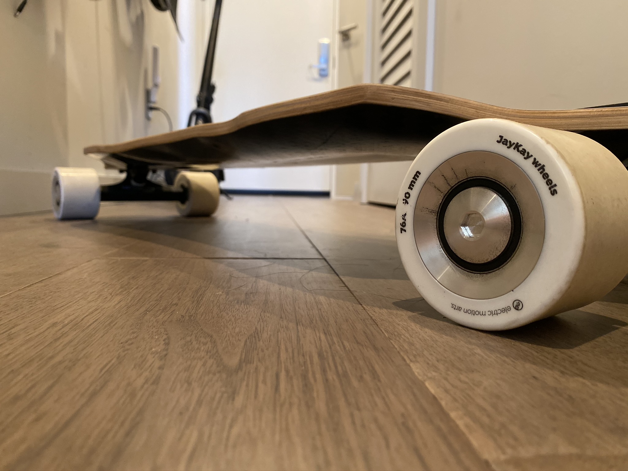

Jaykay Numbers, please discuss
They do get very hot. But the trucks also tell me they’re overheating on the remote
It would be cool if you could easily swap out the batteries once they show age. There’s only 8. I’m thinking like a flashlight lol. They use welded batteries right now?
Yeah that is a good point, would be reasonably cheap to swap.
Maybe swapping on the fly too? That would be nice
I guess they’re already connected to an esc and can’t be simply connected to a vesc and the vesc tool. That would be the revealer of electrical resistance per phase and the real kv and could figure the heat produced per ft/lb of torque and Ultimately how efficient they are
Pretty sure they have iron behind the windings and can’t be called coreless or iron-less. I think I read they’re claiming a mix between slotted and slotless and essentially have recessed stator teeth.
Sounds like a battery killer having the batteries contained in what is essentially the motor‘s heatsink. Possibly dangerous if no temp shutdown is on it.
Is there something positive in that trucks by your opinion? For who is made? How you see future of that kind of invention?
then again maybe they insulate well between the batteries and the aluminum hanger. i like integration of parts and maybe its not the risk it seems.

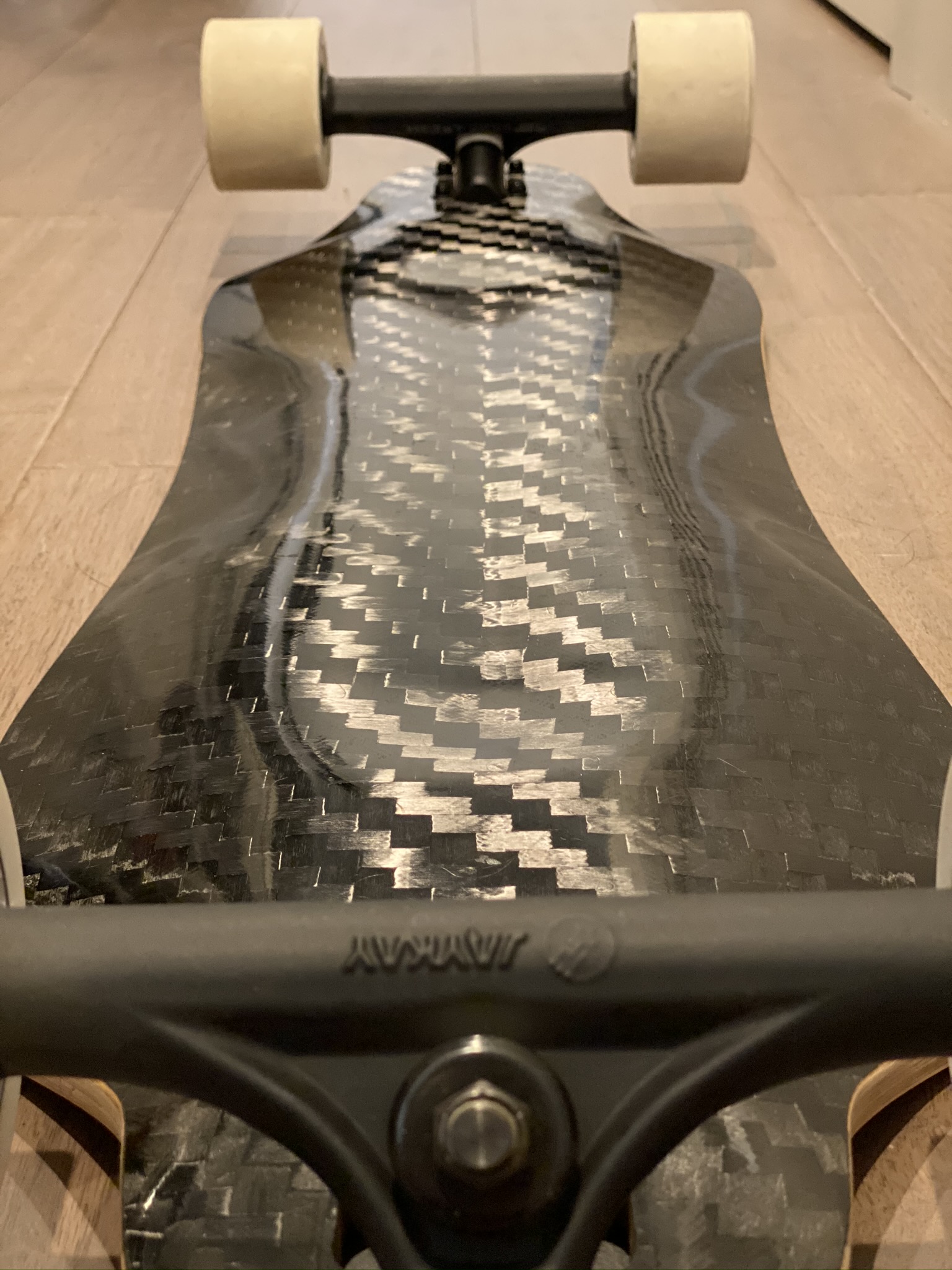

is the hanger still strong being hollow? i guess its steel at least. big diameter and hollow vs a standard cast in axle i wonder how it compares
how is the motor held together? i see no bolts. just interference fitted?
Depending on speed the trucks switch between 2S2P and 4S1P for better efficiency.

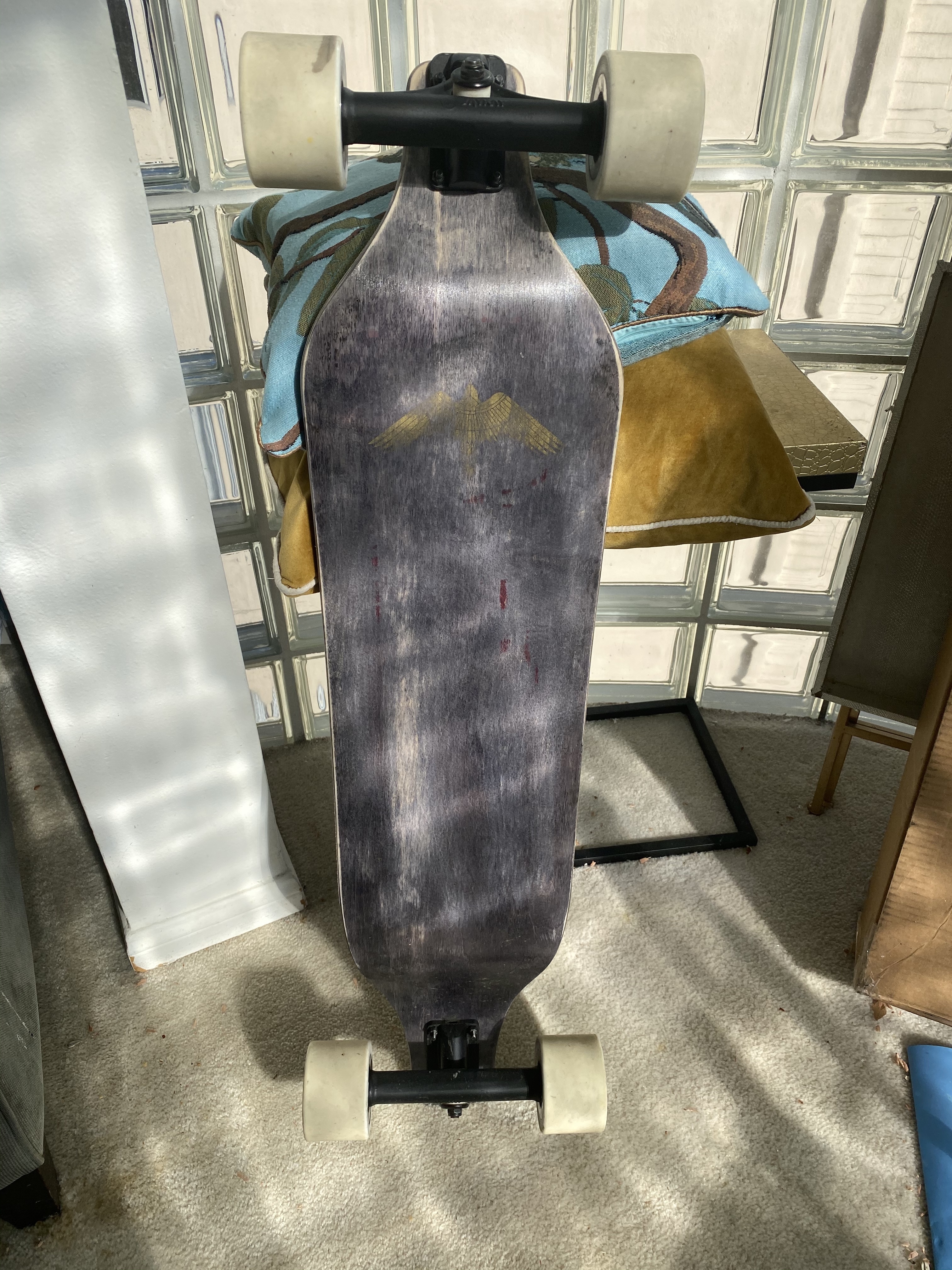

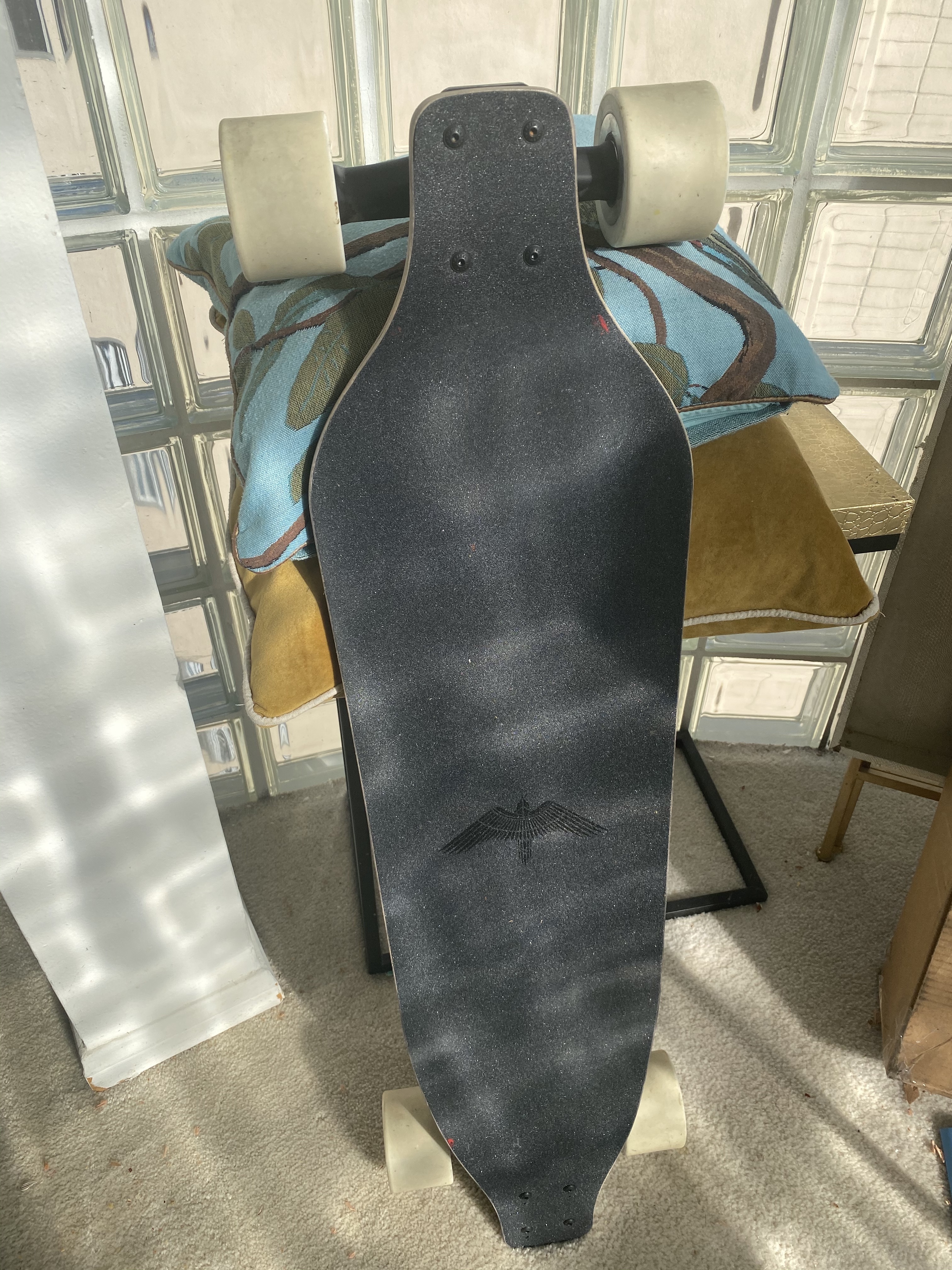

That deck! :star_struck: What is it?
TD Longboards Liberty freeride. This one is to my knowledge the very last one sold into private hands :yum:

Those TD German guys were making amazing decks . Too bad they disappeared
This comes up on Google as tech deck… Surely it can’t be?

Lol it’s not a techdeck. That’s how rare this deck is :yum: https://www.instagram.com/p/uyGIJXI2Rq/?igshid=xzzxttt5k5fg
