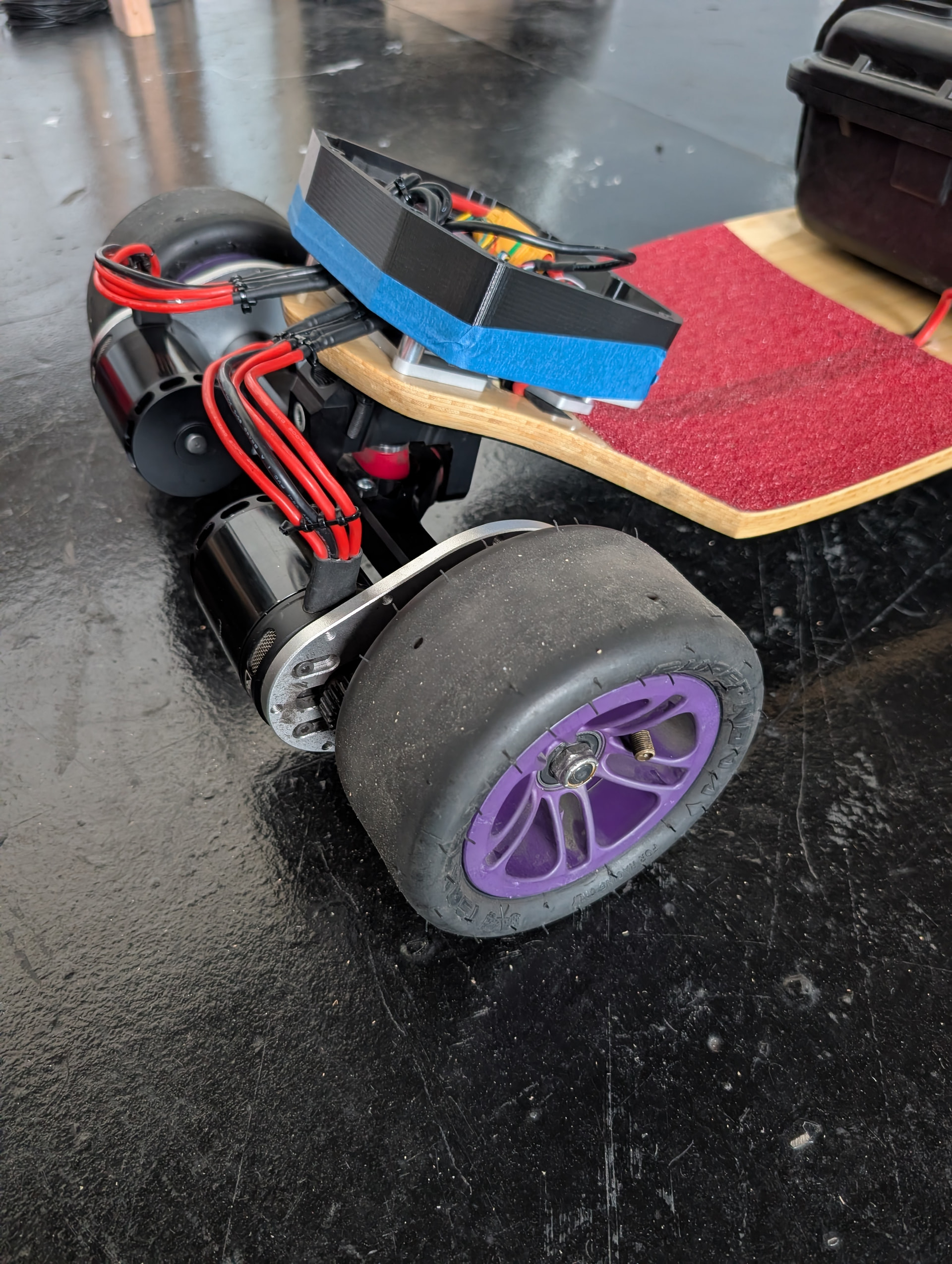

pics with wheels pls.

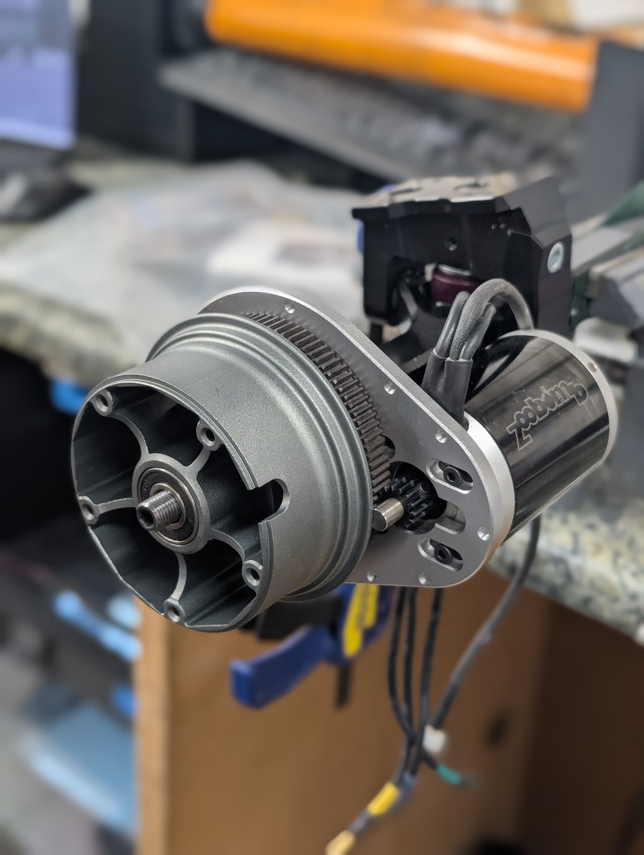

I gotta get my hands on a motor with a cut shaft. I really don’t wanna cut the shaft off a zoobomb motor bc of the circlip groove
Can you add a motor spacer
Yeah I can design one.
Could these work like open gears with regular motor mounts?
I think so! But you’d need some short mounts
Do you think TItos 61-80 short Mounts may work?
With 25T pinion gears and up, probably. That’s the point where the CC distance crosses 60mm, according to this calculator

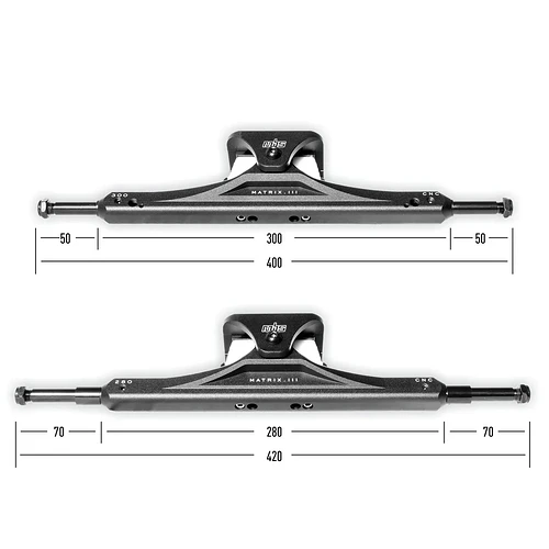

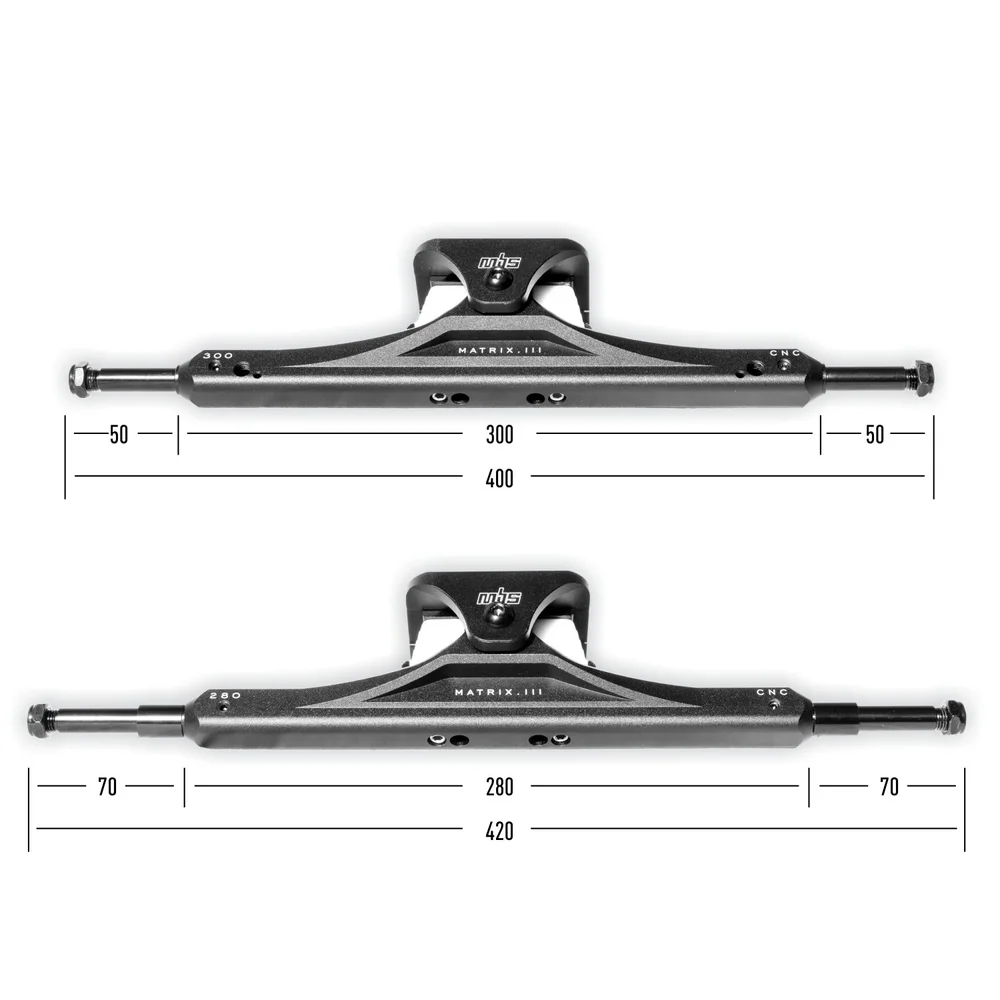

How much axle space do you need to run these with Rockstar XL?
On Matrix III for example could they work with the 50mm axles or do you have to have the 70?
I’ll look into that for you

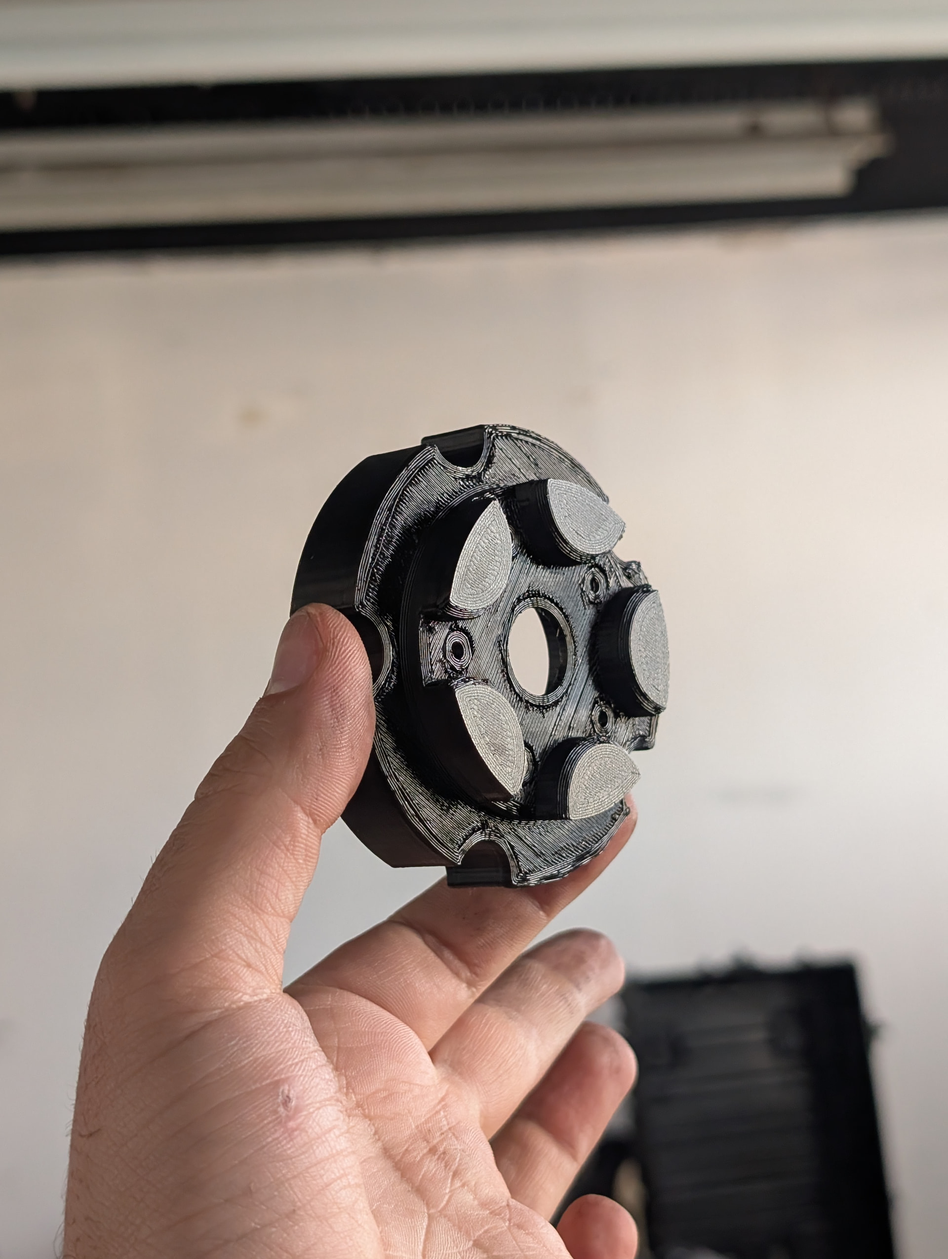

Now compatible with hubba hubs
Nice. That is a welcome addition.
I think Hubbas are great wheels and a great value.
I bet 70% or more of the people here have a set…

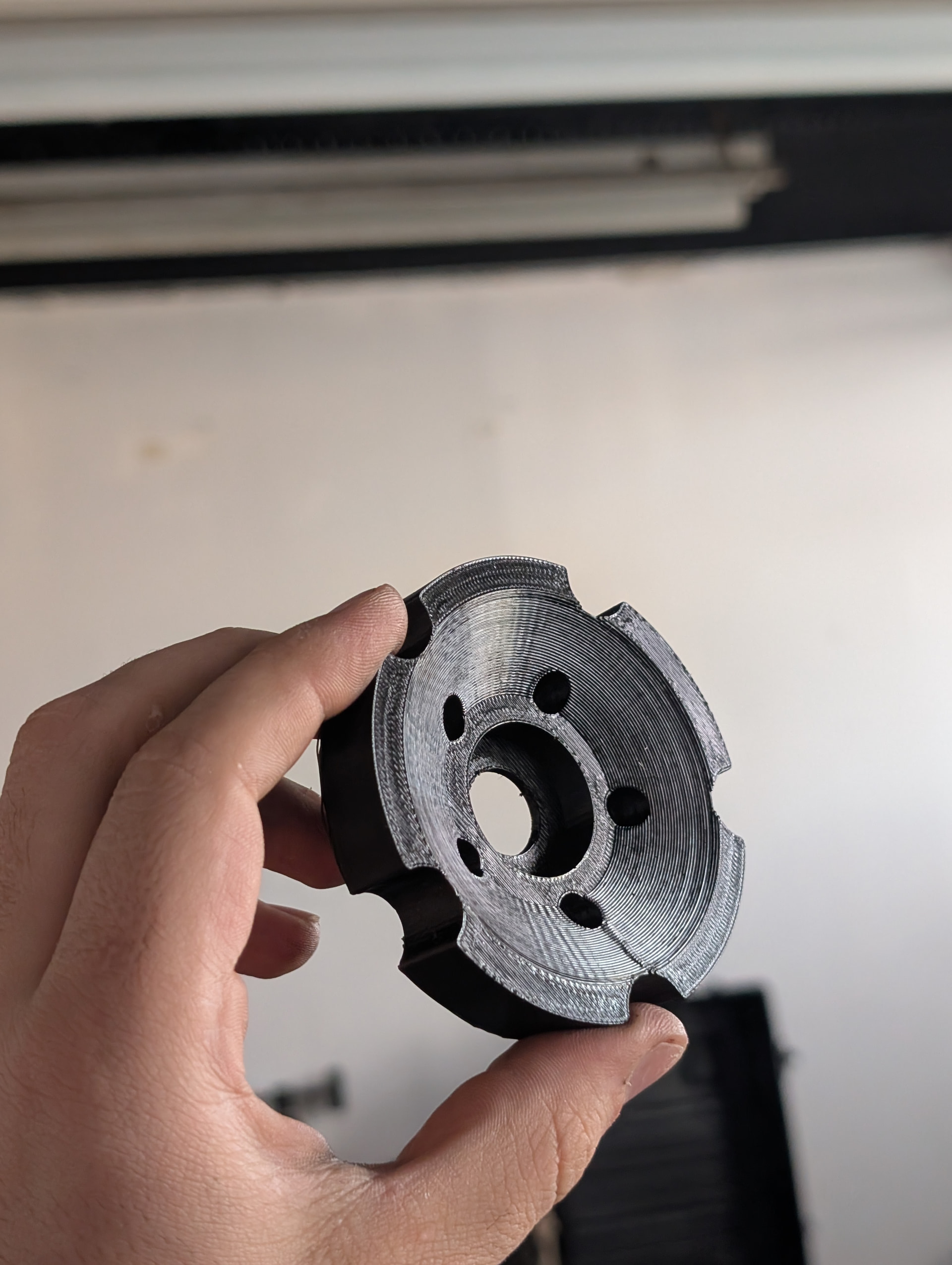

Ooo I like this, the adapter is connect to the spur gear?
Yes and has it’s own bearing
