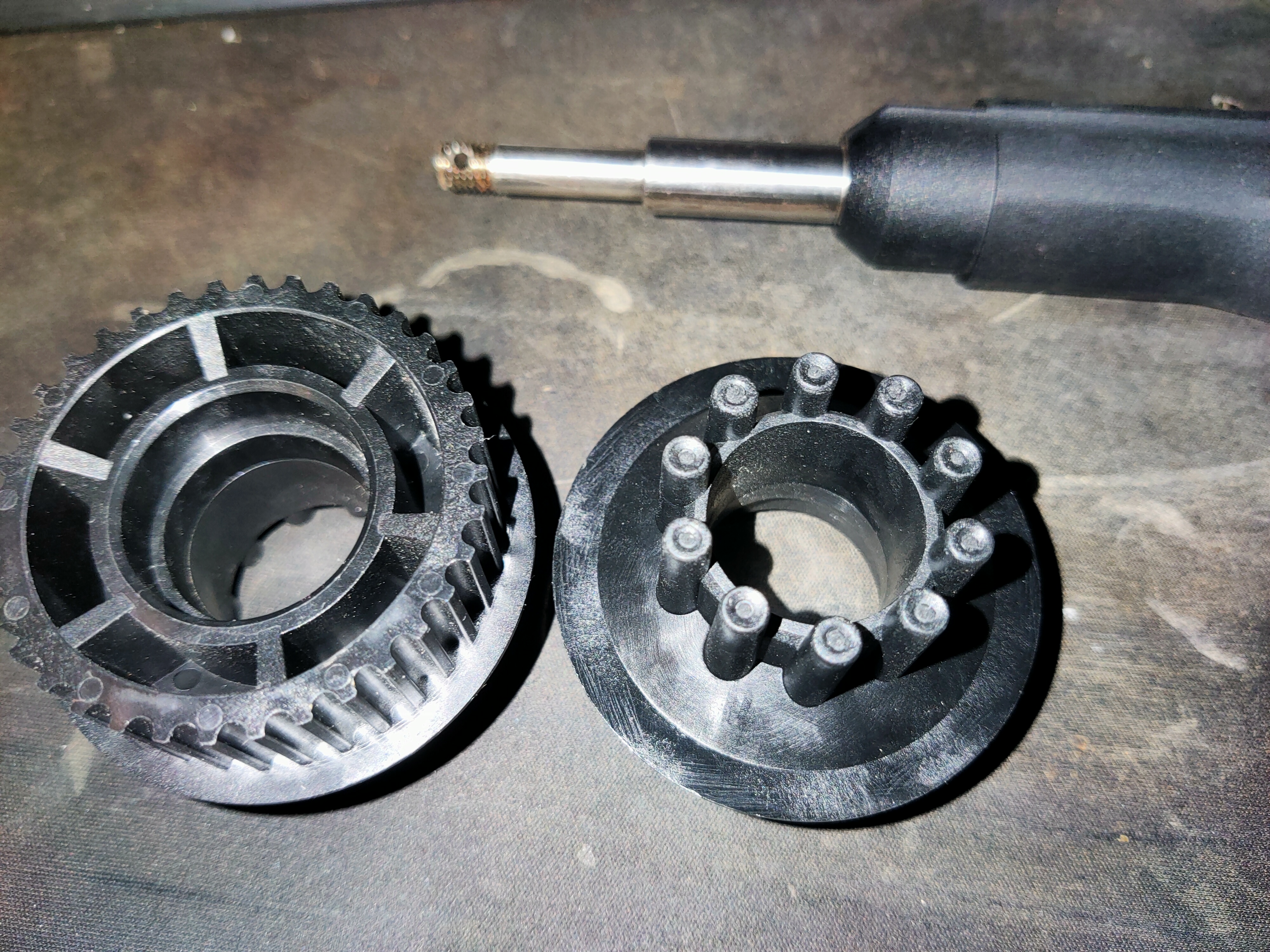

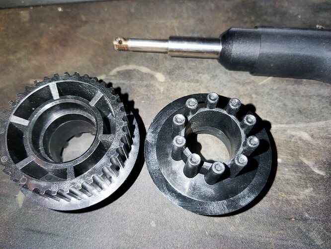

With the huge width of clouds is it plausible to have most people running pressfit with a bearing? Or is the preferred option to run a floating pressfit that isn’t really supported by anything (what I’ll be doing as a stopgap)
I’ve been running mine with a modified set of Haggyboard pulleys that feature an integrated bearing. I’ve only ever used them with my Kahuas, though.
Edited because I am stoopid.
Do you mean a bearing or am I misreading sorry. And by only used them with your Kahuas do you mean only used clouds in general, or only this pulley setup? Last one because haggy doesn’t seem to be doing business so I can’t find up to date info, do the kahuas have a standard axle or what
Sorry for being unclear. The pulley (showing my spare Kegel set as modded ABEC are on a build) is designed to work with a large bearing (seat shown below), which rides on the stepped up 10mm Haggy axle (below).

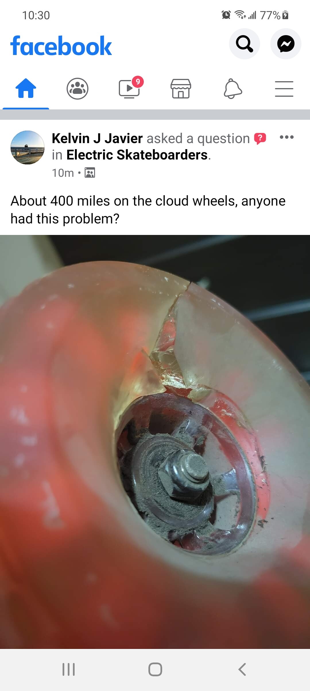

from The Facebook…
still made it 400 miles which is a ton of you ask me…
400 miles isn’t that much, I’m surprised it failed like that
