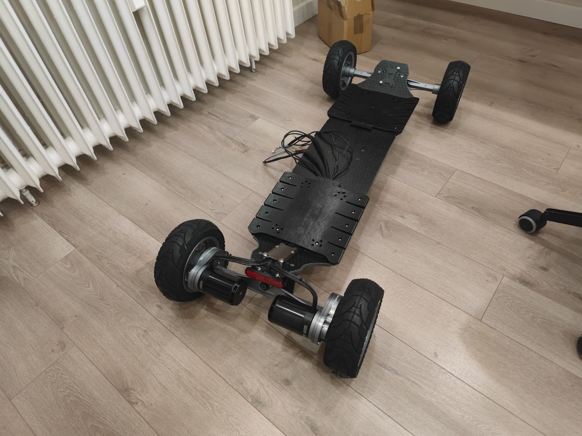

day 1 - trucks came
day 2 - it seems not all 8.5x3 tires are the same
(the distance should be 134mm. dammit!)

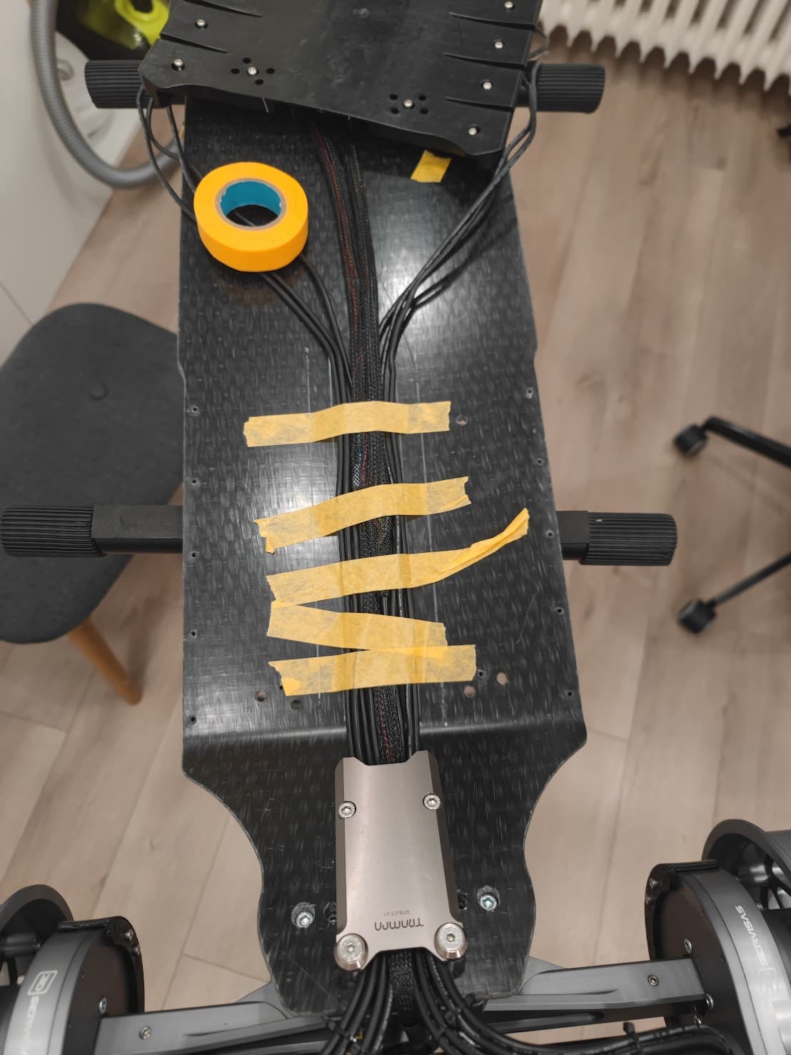

day 3 - crappy trampa parts and painful cable management
oh, and did I mention, that the holes in the deck are not precisely drilled? and that there were no holes for the dogbones? and that the front and back holes offset is different? (on one side, the truck baseplate peeks before the edge of the board, on the other its hidden)
day 4 - cable management nightmare and tail light, new tires

currently waiting for the battery. I’ve temporarily used 12S prototype case with the smaller ubox. at least I can test the mechanics.
top speed is a miserable 30kph, but its hella strong. unfortunatelly you cannot really notice it, as you reach top speed sooner than you feel the joy. it’s nice to have the sensors for once. HFI is cool and shit, but its still a hack compared to the sensors :smiley:
