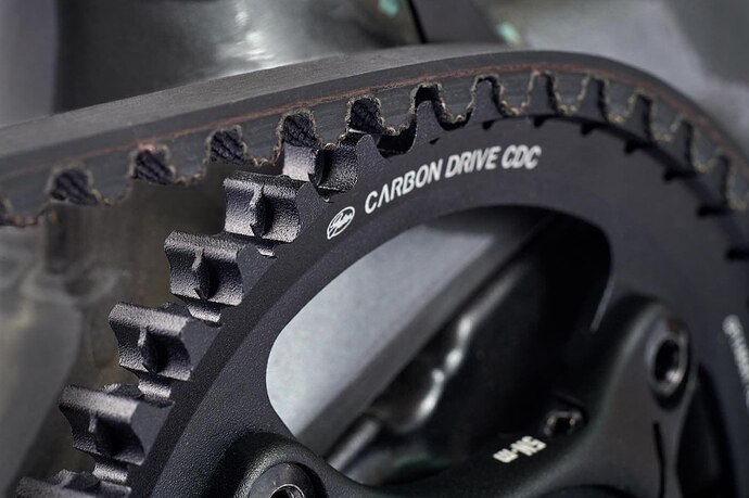

…self centering belts, you say?
delicious!
Cool, but herringbone is cooler!
I agree. A few ebike companies are doing some really cool things, moving from chains to belts and trying to eliminate all the downsides.
Biggest downside I see for belts on bikes is getting it on and around the chainstay. I’ve seen frames that are designed around the belt but otherwise I know people who will cut the frame n weld the belt in. Permanent. But the belts seem to last forever

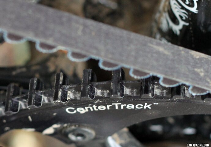

Newer version of gates centertrack. Supposedly has the added benefit of being nearly self cleaning when it comes to mud.
Theres a split belt drive system ive seen that doesnt require any frame mods, also, but reviews are kinda sucky and this threads bout belts not bikes.
Ebike I"m guessing? Very interesting
Ebike, as well as a pedal bike system, simply replaces the chains with belts.
Self centering sounds like being unable to easily tell there is misalignment. People already don’t carry spares without making them 2x more expensive
Also you can’t install your belts by spinning your wheels, you’d have to remove the idler or loosen the motor EVERY time, and on most of my belt drives the wheel covers the inner 2 motor mounting screws
