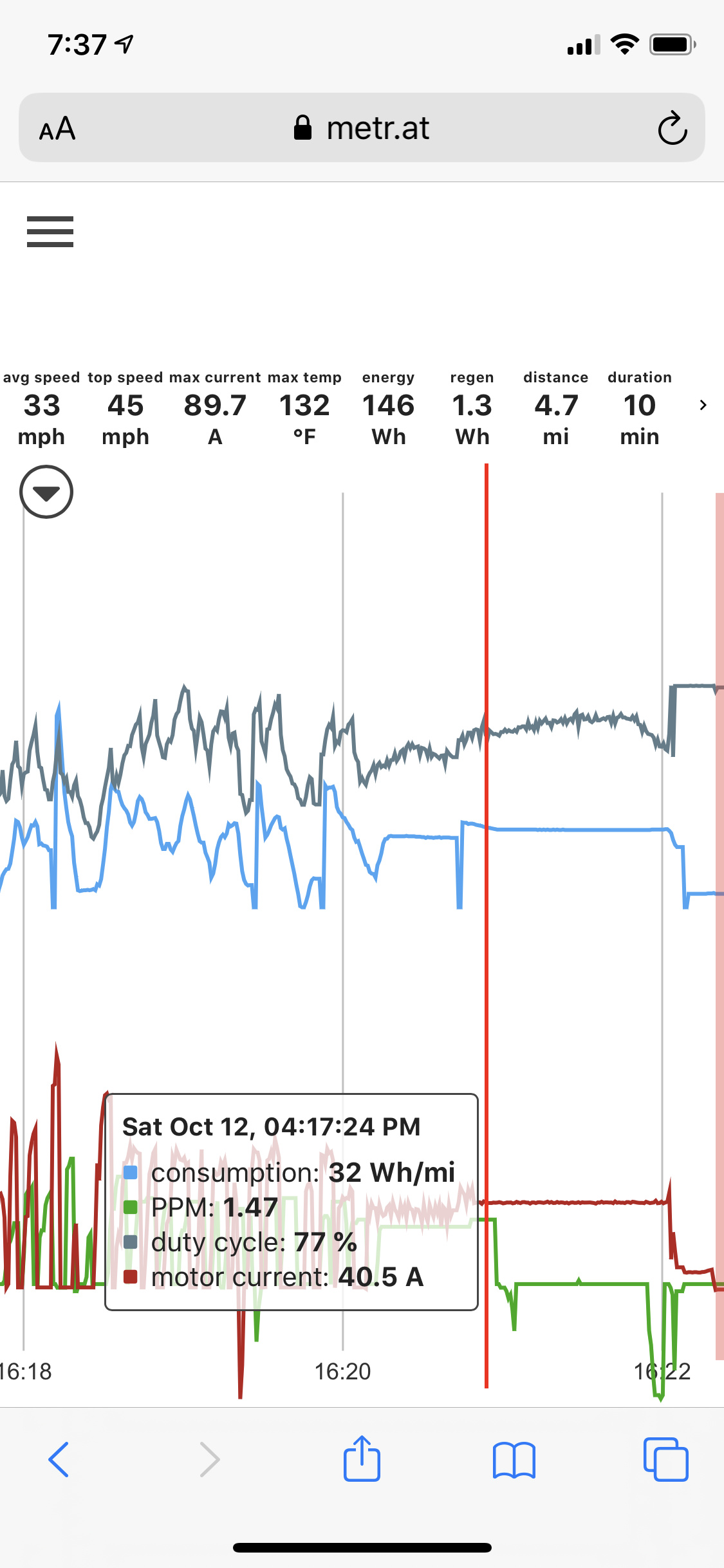

@Accrobrandon What is your setup? Metr module?
Metr also logs PPM data:
It looks to me that it was at idle PPM~=1.5
Sequence of events:
While passing bicyclist:
^ 14:17:18 Consumption momentarily drops to 0 wh/mi without associated drop in motor current
^ 14:17:21 motor current drops and locks at 40.4a
^14:17:22 “ppm” drops to 1.51, equivalent to the idle value on the rest of the chart, motor current stays locked at 40a, scale of ppm chart has changed from the rest of the graph
^ 14:17:24 “ppm” value dips to “1.47” which is a lower value than anywhere else on the graph till that point, motor current still locked at 40a, ppm chart takes on a different scale from the rest of the graph

Metr stats. The failure starts at 16:48:00
Real-time stats after failure
