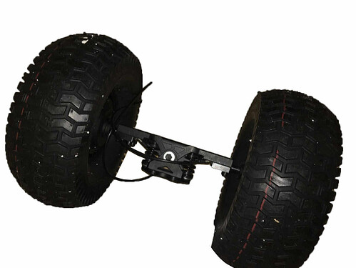

Anyway, they have 12mm steel axles. I’d go on a limb and say you won’t be able to snap them. They’re cloned MBS Matrix I, the design fits all the MBS stuff from that era and I think you’re getting say 70% of what you’d get with a vertigo truck. The mounts aren’t amazing, but on a budget I don’t think they’re bad at all. People have bent them but with the right belt tensioning and maybe a custom idler, I bet they’d hold fine.
What the heck are those wheels :rofl: :rofl: :rofl:
he’s compensating :wink:
I think they’re turf tires? like, for a mower? 18x9.5-8. They big.
They look insane mounted to this truck :laughing: And I have the feeling that someone is marketing this as a kit like this :rofl:
