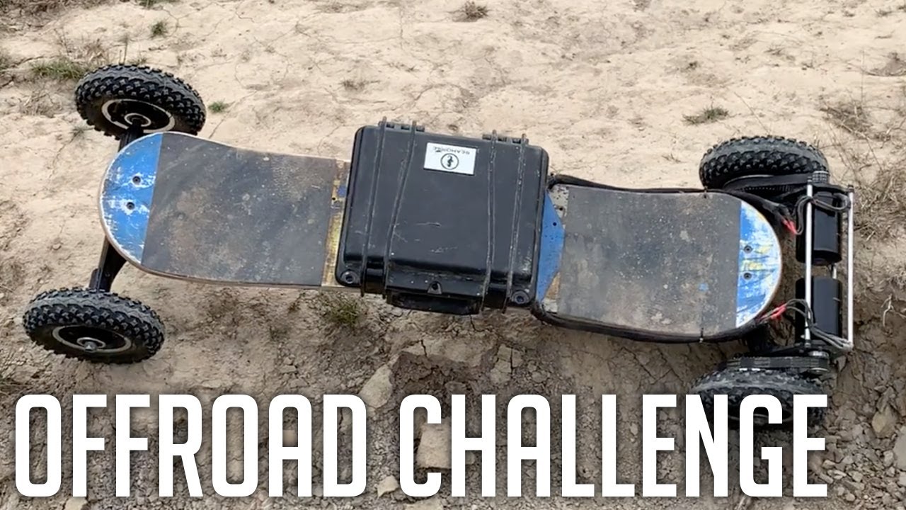

IMO, budget emtb is 100% possible and anyone saying “DIY is always more expensive than prebuilt” is just not telling the truth. Its only the case under like $600, and even then what you get for a prebuilt still has disadvantages not measurable in specs. You can do some really heavy offroading for about $1000 or so.
L-Faster matrix I clone trucks and mounts with flipsky 6374 140kv motors ($300)
Unity with active fan cooling if possible ($225)
12S LiPos ($200)
Pelican case ($30)
Silicone sealant, wires, connectors and shit ($50)
Mini or GT2B/RC remote ($13)
MTB Deck of your choice maybe a comp 95 ($100)
Bindings, extras etc $100
Total is like 1k$. It will do actual serious offroading (If you’re not especially heavy)
Example rides using a similar build costing about 1k
Its simply not true that you “need” a 63100 dual VESC6 gear driven trampa $3000 build to offroad. Its nicer on it, buts its not “impossible on a budget”

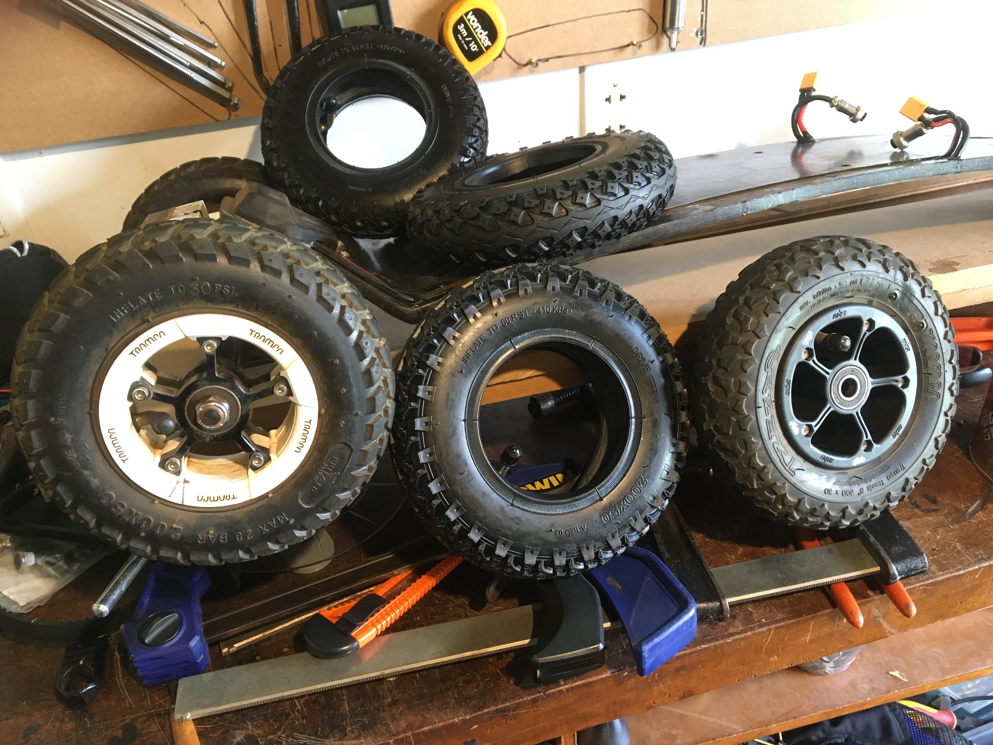

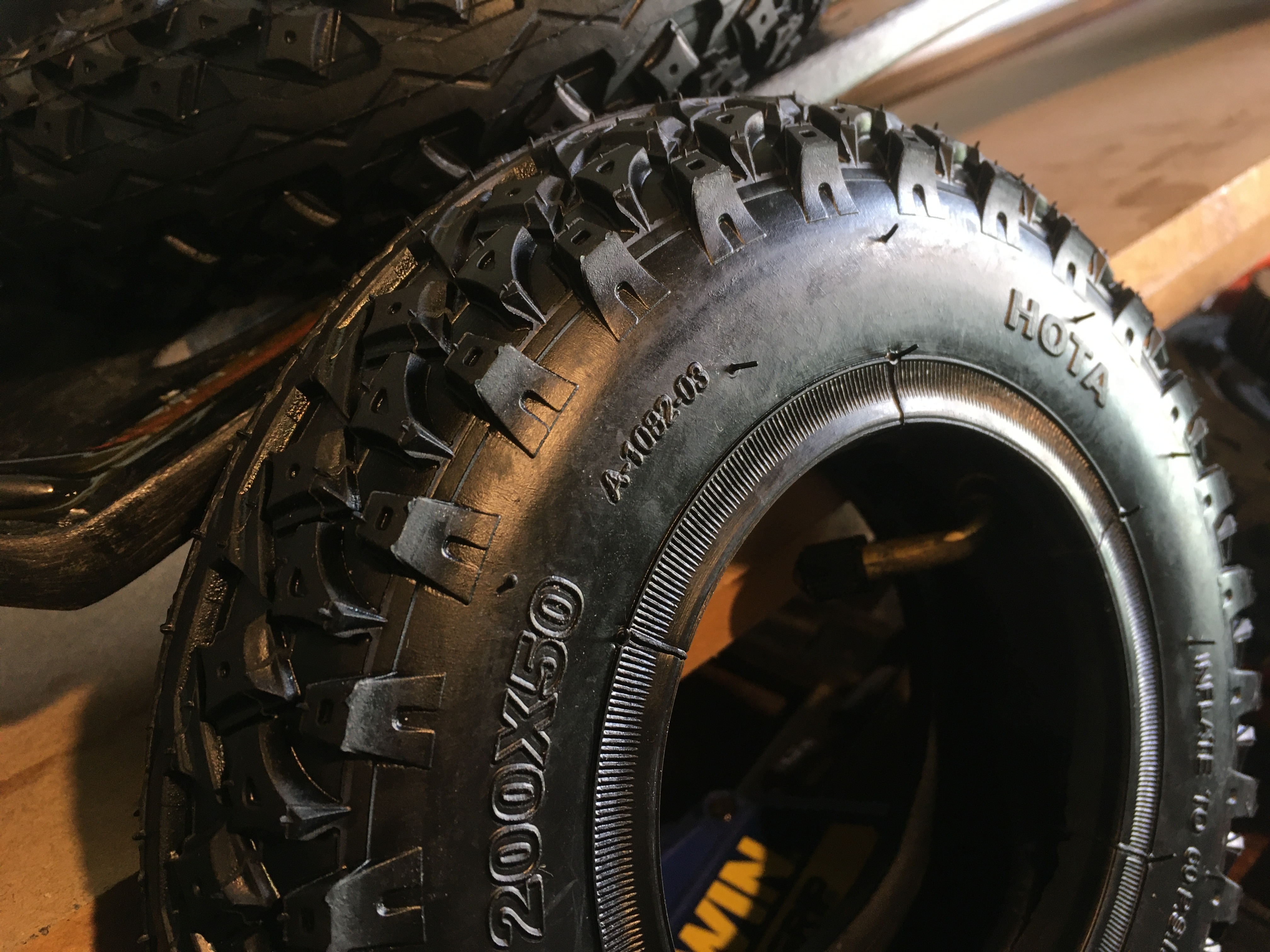

I just received this one yesterday, but I have no idea if they are the soft or hard version that lasts forever
@Venom121212 could you tell if I took some pictures?
Yeah, the shinier they are, the harder they are usually. The more matte, the more likely they are to wear down imo
What would you say? Middle one is Ali, right is Trampa and left wheel chair tire I bought around here that wore down half in less than 100 km
That one looks good to me visually.
I’d take the tubes out of it and the known soft one of similar size and squeeze them both laterally and towards the center of the wheel to see if it is a noticeable difference in firmness. Hopefully there should be.

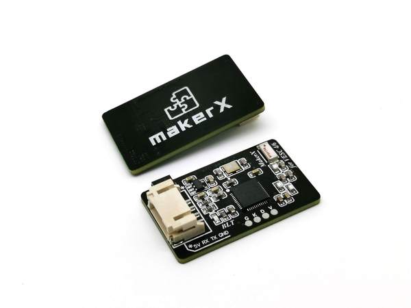

$170 Maker X Motors

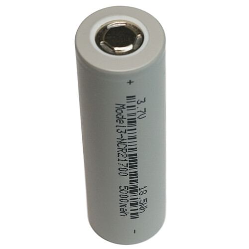

A 12s5p can be built for roughly $250 if you use these cells and this BMS ($15)

$22 BT Module
