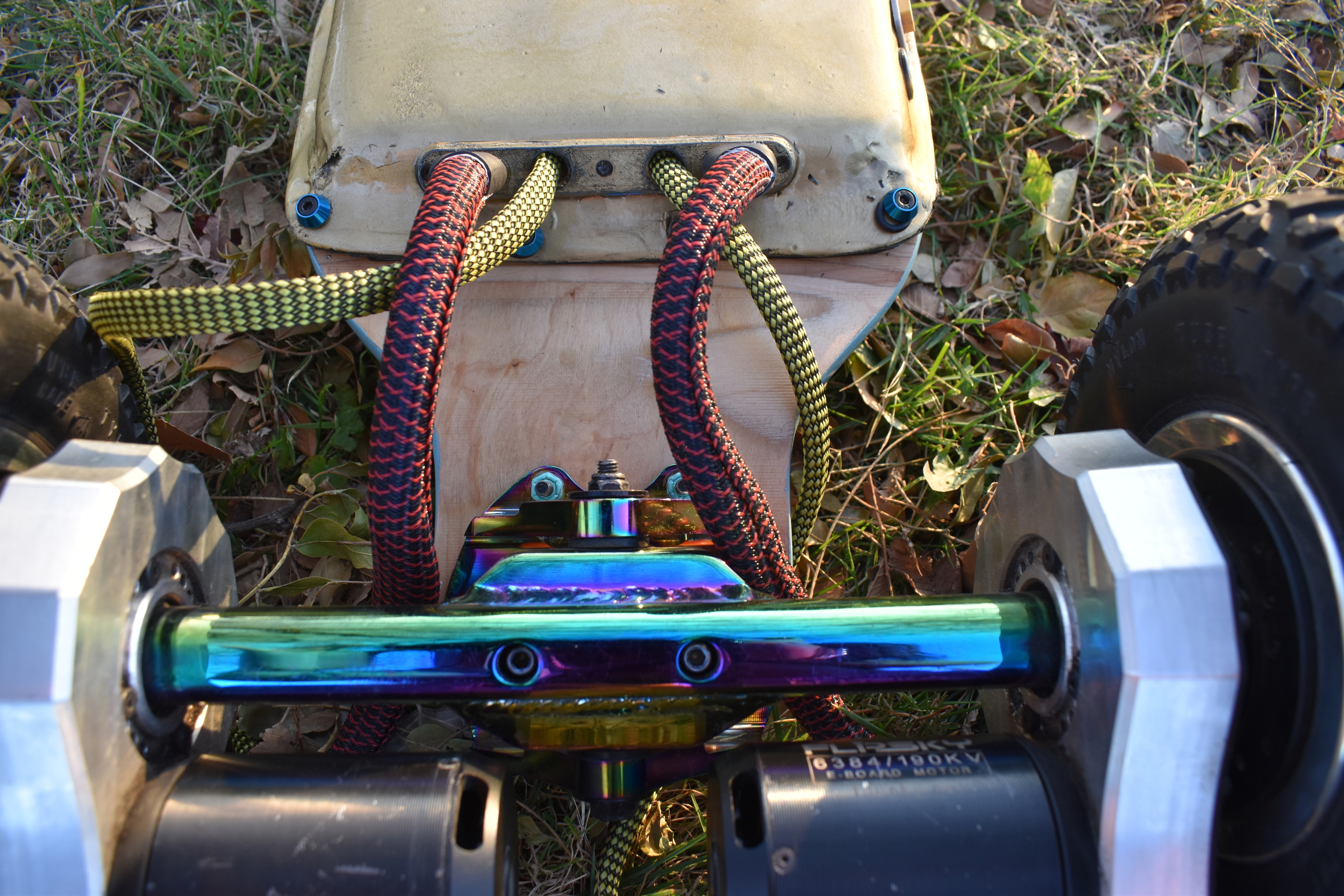

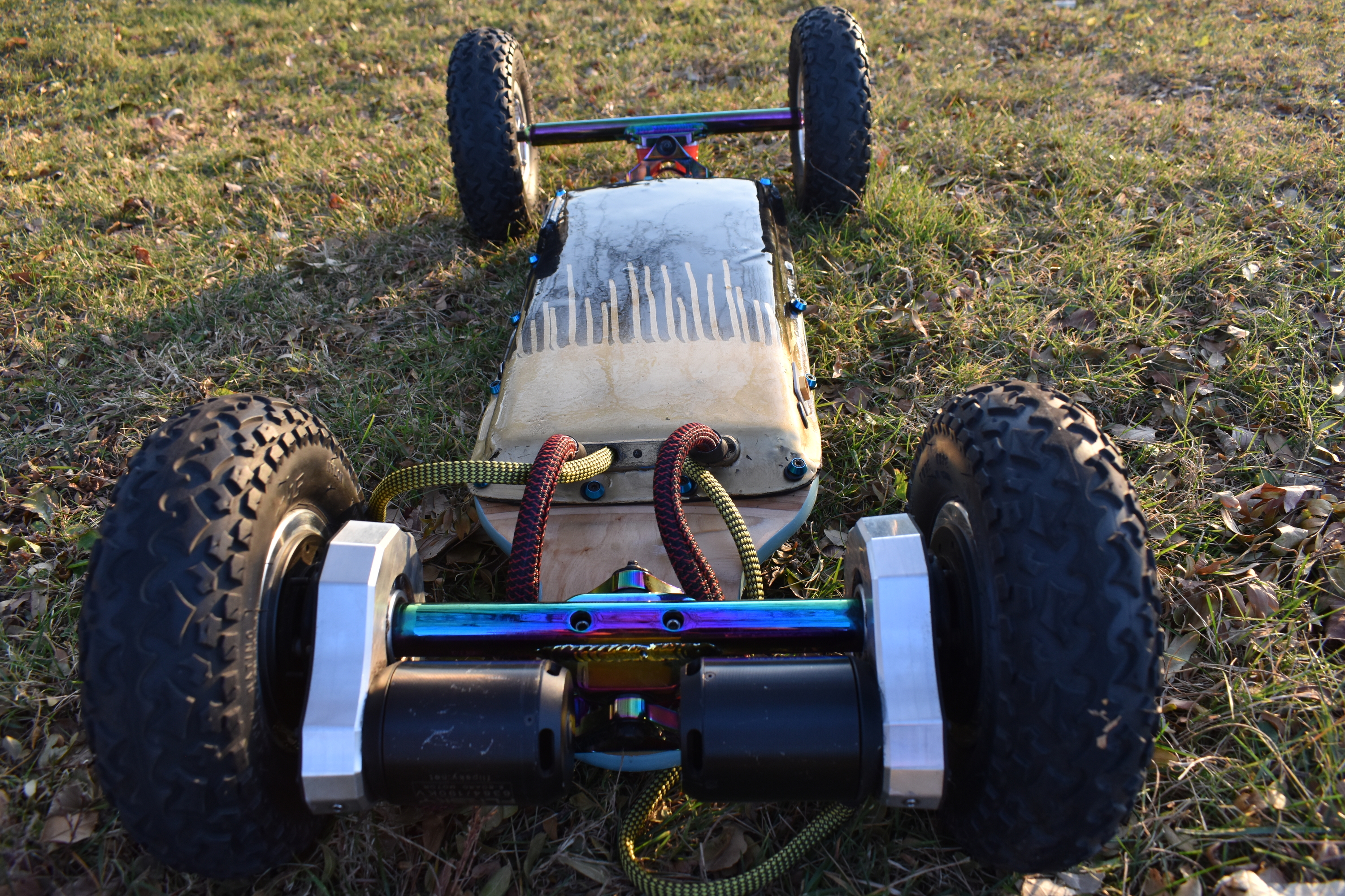

Hello there, I want to know if this budget build is reasonnable and if you guys had any recommendations to do.
It’s for a friend that I showed my board to and he wants one, but doesn’t want to invest/spend over 2000 - 2500 CAD(most likely wont be made any time soon tho BUT of course he wants a Trampa board with an enclosure (Eboosted / kalynyc ftw)

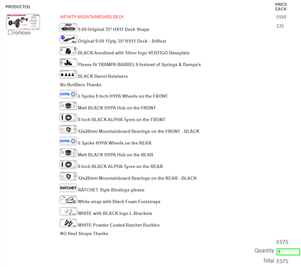

First is the most expensive wich is the board itself
-992 CAD
(half the budget went POOF magicaly disapeared)

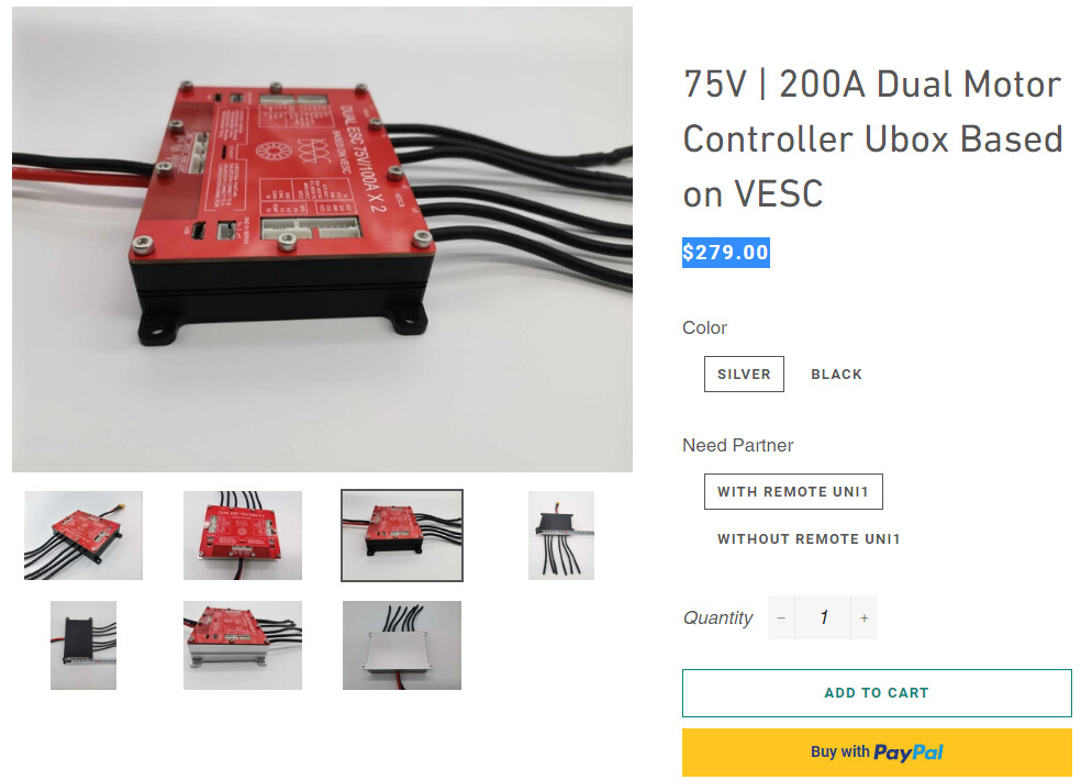

Third is the ESC/VESC + remote
it’s worth it since it includes the remote and a bluetooth modual and I of course want to support someone of the community!
-$279 (360 CAD)

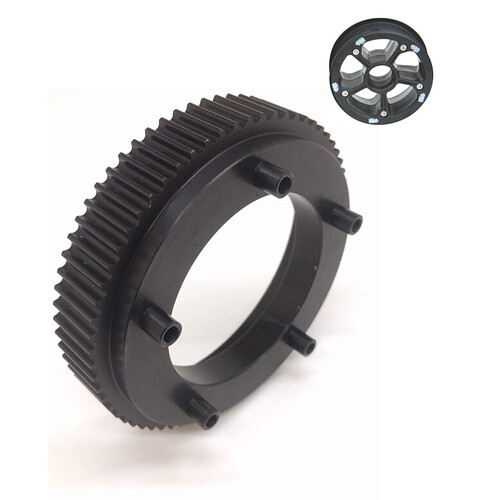

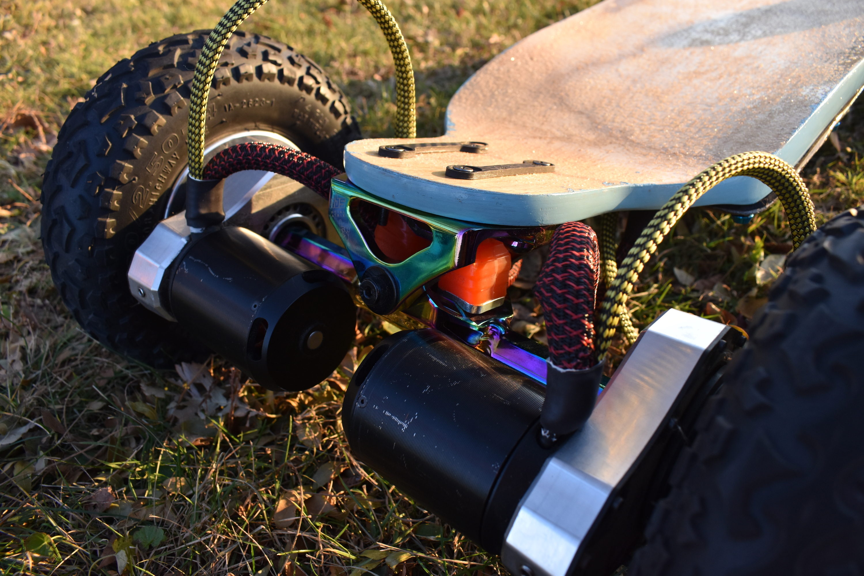

Motor, motor mount, pulley, ETC.
Flipsky 6374 battle hardened I don’t know what kv I should go with tho 140/190 kv $99(128CAD) with a steel pulley.
for the motor mount i’ll go with the Trampa single open belt drive at 130CAD
for the slave pulley I’ll probably 3D print it since I don’t really know what size of wheel he’d take and belts are peretty cheap so 20-40 bucks worth of belts should be enough
