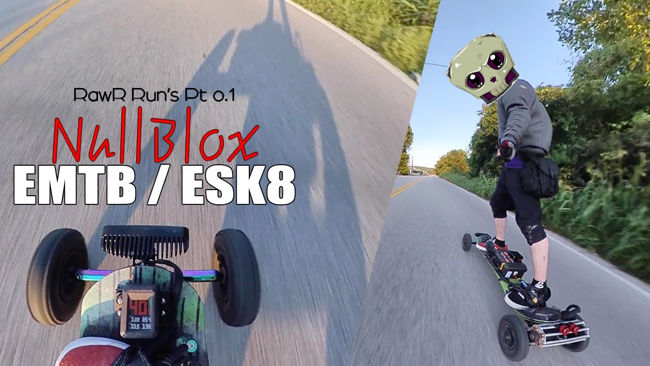

@NullBlox
I mean Yes of course but that may just be me that love them so much that I don’t find them sketchy at speed sure that’s something to get use to but I love them and TBH I ride fast most of the time between 30 - 50 mph (I only use one binding in the front and a S2)
