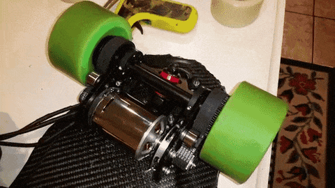

Is it possible to fabricate a differential for esk8, thus allowing for less motors but still getting 4WD?
Nice! Do you still have the STL for the bearing holder?
All 3d models for Dickyho mount here
As Bill said, Carvon did it many years ago that was meant to go on the AWD “REVO” build but Jerry decided not to go ahead with it. I think it was literally easier just to run another dual hub setup. Maybe he couldn’t work out how to get braking to work with the one way bearings??
Damn homie out here in 3005.
Can anybody list some true negatives to doing this…?
  • Less brake power than dual motors
  • No brakes if the single esc fails
  • Slightly more wear on the wheels and whole drivetrain
But that is all minor in my opinion.
Compared to 1WD there are no real disadvantages imho.

Custom motor shafts needed
Less tolerance acceptable on bracket setup
In my opinion if people soled kits to do this it would have been my first Esk8

I didn’t feel that. It’s all about motor power and wheels grip. My motor can easily lock two wheels . For example, most dual hub builds will have weaker brakes. Caliber trucks allow to fit single 6384 motor.

If someone were to make a 6374 single motor dual drive “kit” with all the stuff included, I bet it would sell very well.
1 motor and 1 esc cheaper than dual 6355 and 2 esc’s

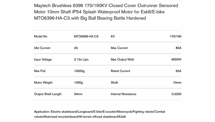

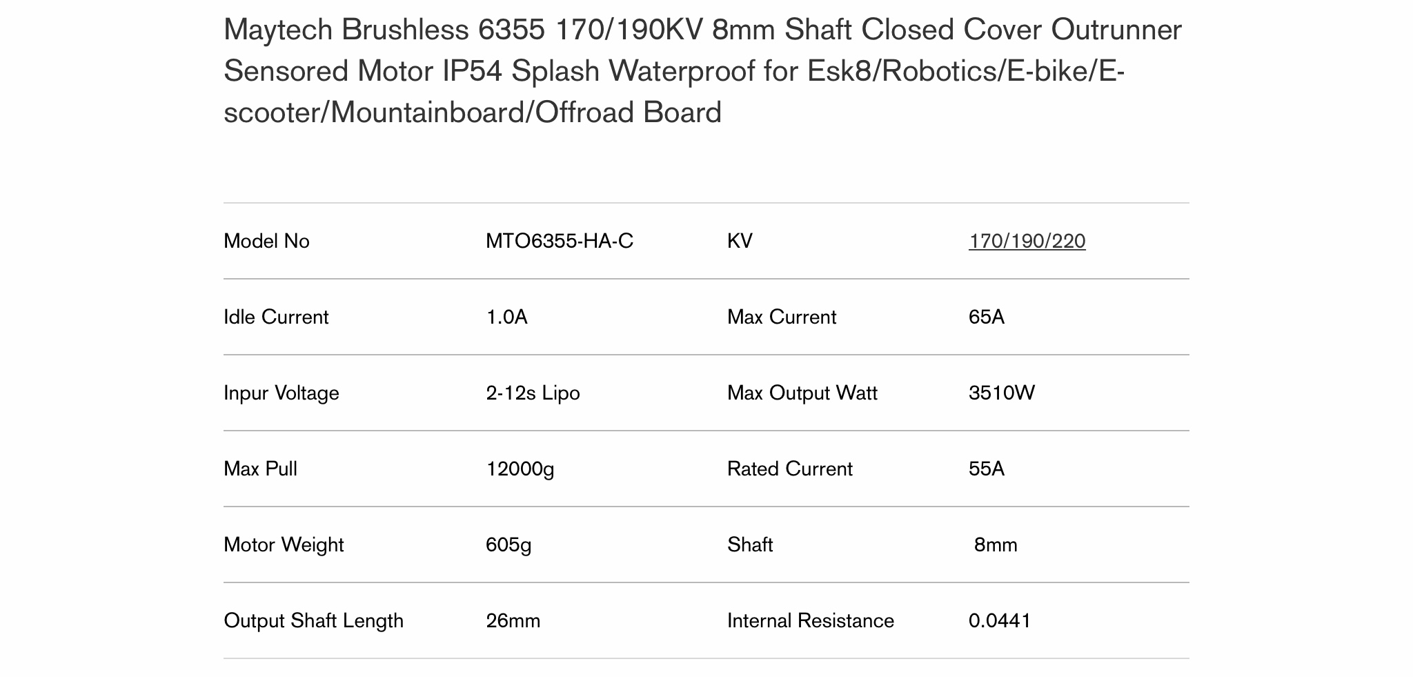

Single large motor 80A
Dule small motor 130A
Even if I took 15% off the small motors it’s still
96 vs 2*46.75 (93.5)
85A vs 105.5
96 1280
2* 55 605g x2 1210g
Take 15% of the small or motors again 1028g
So multiple small motors are stronger and lighter
Is a fundamental flaw with that. Those motors are not rated by stator size, but total can size. The 6396 is extra long with an additional support bearing, but the stator is almost equivalent to a 6374. It’s all wasted space imo. Compare 2 similar construction motors, the 6374 vs the 8085 (actually 8074 size).
