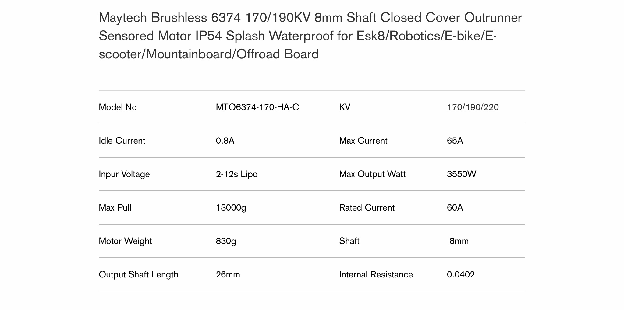

Yeah it’s annoying how they don’t state the stator size, just motor can size, and they can’t even get that right sometimes. The ratings are all over the place too, 1 rating for 3 different KV? how is that possible. Pretty sure they just pull numbers from a hat lol
