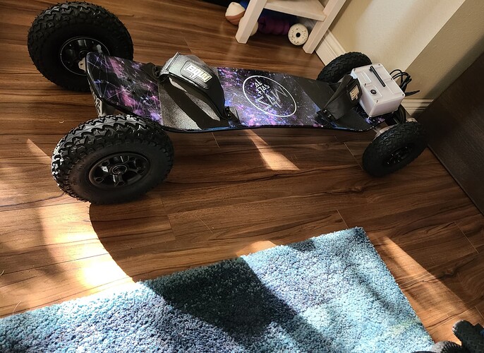

Another Eric here. Long time snowboarder, surfer, and skated way way back. Been lurking, reading, printing, spending too much money and building…
Got 2 MBS colt 90s with ATS.12 trucks for summer riding. Got speed wobbles down hill on a road, bailed, rolled my ankle, tucked and slid on my back. Other than my ankle only my shirt graphic was damaged not a bruise or scratch otherwise. Foolishly perhaps I thereafter decided on a whim I wanted to electrify them. Jumped on the internet and found this place.
The boards are the constellation graphic and all my printed parts are clear petg and tpu (comes out a translucent white) I’m building these for the spouse and I. They’ve now got @josdevos’ motor mounts modified for wires of TB 6374 190v to fit, stormcore60d+ mounted on an aluminum plate rased off the deck on m4 all thread and nuts with custom gasketed cases and lid sammiching that all together. The power button and antenna are mounted in the lid. Also picked up trampa wands and nrf dongles w said antenna. 14t motor gears with 72t on the 8" tire board
and 80t on the 9" tired board.
They’ll both be getting 12s6p molicel p42a top mount battery packs (which I am not building due to tools time and desire) with esc on charge only.
Still need to:
Figure out/decide how to mount the batterys (dont want to drill anymore holes in the deck) thinking the velcro/straps method…
Modify and print some foot pads I found on here with wire channels (whoever you are with the dragon board, i cant remember, credit is yours for designing those) I plant to half them with a interlock lip so they fit my printer.
Put anti-puncture tape in my tires and order slime to put in my tubes.
Get smarter on vesc settings because I DO NOT want to smoke my stormcores…recommendations welcome.
I do have access to lacroix’s app via appledevoce but I’m still hazy on what the best route to get everything I have interconnected and set up.
Figured photos I think?
Just be careful on those trucks man. I built my first real board on the same deck and trucks and had a really nasty spill when the front truck snapped underneath me (near the pivot cup).
Maybe it was a manufacturing defect, maybe not. I was riding that board for a month and loving every bit of it up until that point… I’d hate for you or the spouse to suffer the same fate.
Welcome to the fold!
Yeah, there will be some upgrades in the future. I read a few comments from multiple people bending them and some of your comments mentioning that incident, did you jump on the board, hop curbs or anything that may have contributed? or was it just a failure from cruising? I ask because if it’s the latter, that feels more imminently concerning to me and may make me advande my timelines for safetys sake.
