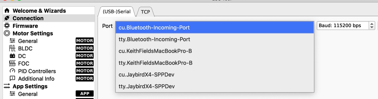

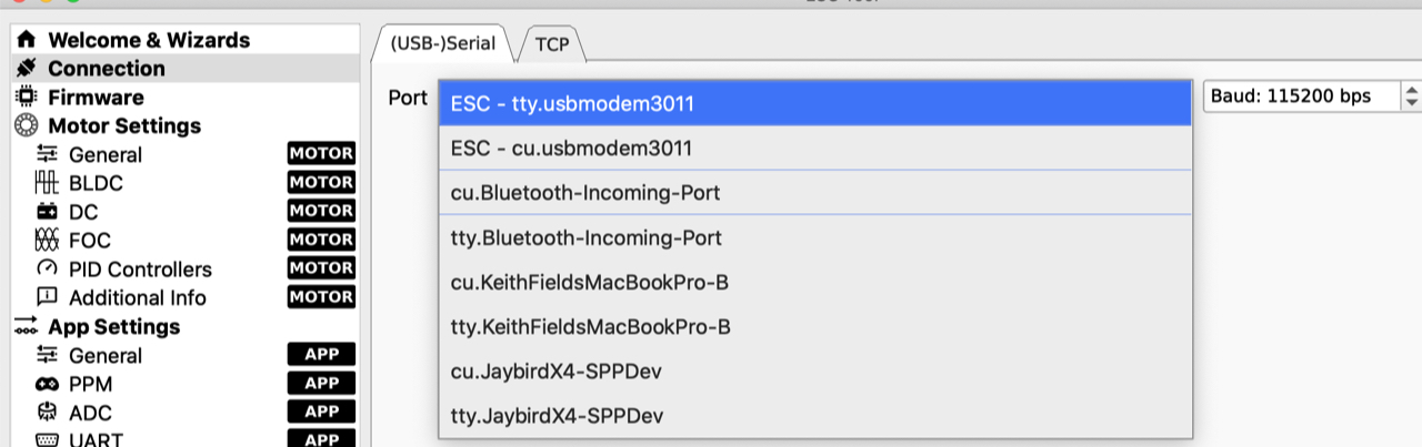

The latest issue with my son’s board is the Slave vesc is no longer connecting to my laptop. I’m using both the supplied USB cables from Maytech which worked originally and still work on my golf cart rig, but this one vesc just will NOT connect? Hopefully an image below will show the two situations of available connections when I access the connection tab on the vesc tool.

Pictures of the situation where the Master IS detected but the Slave is not. I am ordering the Bluetooth modules tonight and have some interesting communication going between me and the lovely Eileen at Maytech who has always been super helpful.
yeah. in the second osx isn’t seeing it as a usb serial device. so if you’re plugged into it with the same cable that worked for the first vesc. I’d guess the second vesc has an issue.
