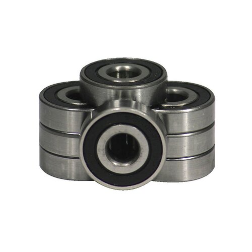

I’m thinking to order a few more of these and figure out if i can get the price down for myself and everyone else by ordering in bulk.
Materials available are aluminium, stainless steel and mild steel (ordered from expensive to cheap) and cost in the £7 to £4.50 range for ONE part machined.
I’m currently waiting for an answer on how much it would cost to machine 20-30 parts
I also ordered a lot more o-rings than i will ever need in my lifetime so i can just drop one or two on top of the spacers.
If someone can find 12mm id x 16mm od x 22.5mm length spacers for cheap just link it here please

It’s probably cheaper for someone to buy some tube stock and chop it into 22.5mm lengths on a bandsaw for everyone. 6’ of 5/8" mild steel tubing is only $7.52 on McMaster. Metric ones seem to be more expensive and hard to find, but I think 5/8" is only off by .02" or so.
I somewhat got the hint by the complete lack of availability for them
Mcmaster is us-based, they obviously sell imperial units 90% of the time. I will try to find uk based tubing but i’m really not in for cutting and sanding these at work as they’re more trouble than it’s worth
Would they really take that much work? I’d imagine that once you have a guide jig set up, you could probably do one every five seconds. Then take them to a sanding wheel for another few seconds, and they should be done. From what I gathered doing 3D printed spacers on mine, the bearing spacing isn’t even uniform from wheel to wheel, so they don’t have to be super precise.
I have spacers made like that for 6x2 hubs and they suck balls. One is so small it rattles inside, 2 are uneven/click around and the third i had to shave half a mm off. Those are presumably made by someone doing this all day long. I can’t imagine myself doing a much better job at it
How much of that is from the spacers, and how much of that is from the wheel bearing seats? I found on the four Rockstars I had, the spacers were the same length, but on some wheels the bearing would stick out by nearly a mm. With the printed ones I just found it easier to make it slightly long and crush it into position, since the tolerances were so bad on the bearing seats.
The 6x2 hub bearings were press fit. A hammer was needed to take them out so definitely no bearing seat rattling. On the fivestar hubs however it’s so bad i can shake the wheel and hear the bearings click inside the seat.

I used these boiiiiis
https://www.aluminumspacers.com/spacers-by-outer-diameter/5-8-16mm-outer-diameter/mas16-12-22-4
Do the spacers need to be made of steel, or would aluminum work? If so, www.aluminumspacers.com might be worth looking into

Electricboardsolutions also sells spacers which are for the rockstar 2 hubs:
What length spacer do you need for Rockstar II?
I believe it’s the same, 22.5mm
