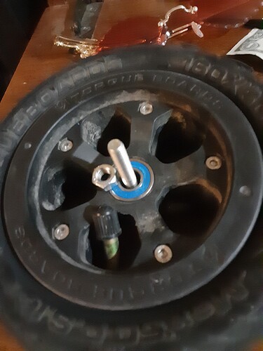

I just used R6 bearings on amazon and used a 1/4 inch bolt and nut to seat the bearings after using a blow dryer. Probs could have just used the hangar and blow dryer but bolt seemed to require less force
Is that hub aluminium or plastic ?
Oh, thank you, i had no idea what shim stock were
It’s plastic. No way you could fit a 22.225mm bearing in a 22mm hole if it was aluminum.
In fact, I’ll be interested to see if the plastic holds up without cracking over time.
No worries. It’s a kind of obscure thing unless you run across it - It’s pretty common in the industrial/maintenance/machining world.
Be careful, metal shim stock is thin enough to be very sharp, and will cut you badly if you’re not expecting it. Paper cuts have nothing on this stuff.
I think the degree to which I heated(f***ing hot but not to any melting point) it actually reformed the cavity to accommodate the larger bearing as it cooled, holds snug but removable by hand, old 608 bearings are easily slid into and out of the slot, much like my rockstar 2 hubs. Bearings fall out without the nut clamping it against the wheel hub, but these TBs aren’t that loose
Also very thankful I know know what shim stock is and can use this knowledge to solve future problems
