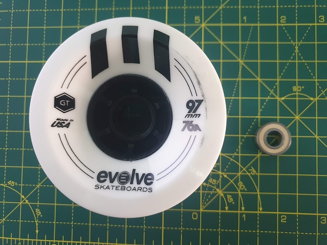

Hey Guys,
I’m trying to mount Evolve (Abec11) wheels on a 12Fifty’s Trampa 9.525mm trucks.
The problem is that the bearings won’t fit. Who makes bearings that are not 22mm in diameter ?!?
The bearings are Trampa bearings that fits their trucks, inside diameter=9.525mm, outside=22.225mm (i.e. 0.225mm wider).
It’s really really hard to push the bearings inside the wheel and I’m afraid to ruin the wheel and/or the bearings.
Any idea ?
It’s harder to get them out once you get them in! I just put the bearing on the axel place the wheel on it and give it a few love taps. She’ll loosen up and thank you later. :yum:

I can think of a couple options:
1: Wedge those suckers in there and hope for the best, (easiest and riskiest IMO),
2: If you have access to a machine shop, bore out the wheels to be a proper fit, (easy, but needs a shop with a lathe),
3: Get some 6900 bearings (10mm ID, 22mm OD) and use shim stock or make a spacer to take up the slack around the axle (needs more parts and maybe careful machining or shimming).

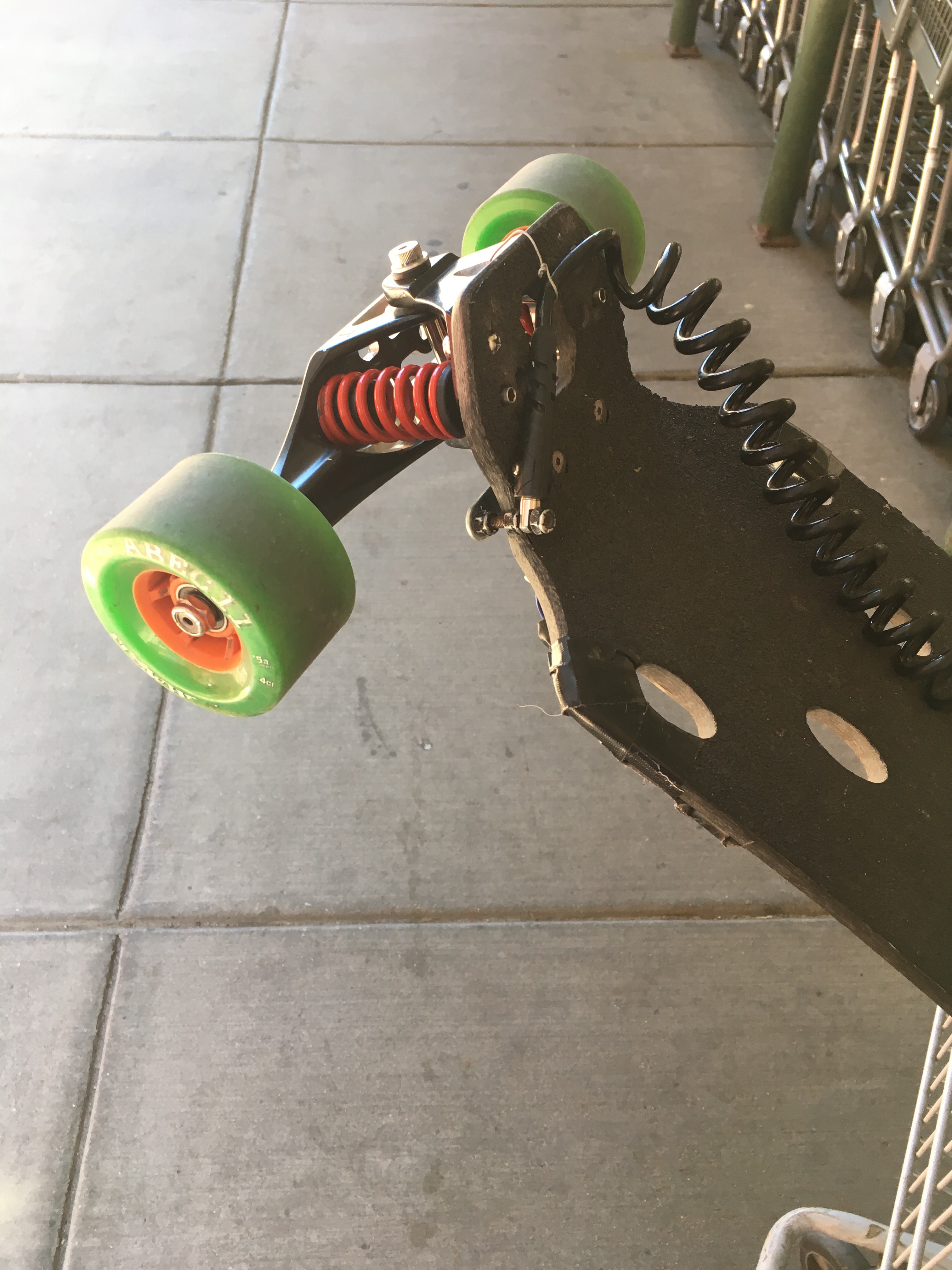

I skate real close to the water so I attached a surf leash to my board. That is where it connects to the bolt in my trucks. I ran a steal brace under the nut and off to the side to mount it.

I think your 2nd option will be a good direction, I will look for a machine shop with lathe and ask him if this can be done.
Or - 4th option, is to CNC/narrow the trucks axle to 8"" and go with standard bearings, WDYT? @MysticalDork
If you have access to a CNC mill or lathe, you can use it to widen the wheel holes. If you have access to a CNC lathe, you can turn down the axles to 8mm (or 9mm), then you need to re-cut the threads on the end. Also, it kind of defeats the purpose of fatter axles - strength.

So, probably the easiest way to go is to use the machine to widen the sockets of the wheels themselves.
.225mm doesn’t seem like a lot to me. I’d use an arbor press and just push them in, I dont know for real though. That’s a silly way to do bearing though, why not just use a standard size?

It’s not a lot, but to put it in, you really need to produce a lot of pressure, like a-lot , that can really damage and bearings …
Cause the axles are 9.525mm :frowning: and not 8mm or 10mm, unless u know of a bearing that has ID 9.525 and OD 22mm :frowning:

Yeah, your wheels are different than what I used. Mine were straight ABEC Flywheels, 97mm I think. An option is to use a heat gun and warm up the core, then use an arbor press to seat the bearings. You will have to be very careful though, it’s a fine line between a little soft and melted mes of garbage.
:slight_smile: ! Yup, thought about this as well. But I think I will go to a shop with lathe or similar tool and try to ask them to remove some thin piece of plastic in the core, I wonder if they can really do so and if it’s not complicated. I’ll update soon :slight_smile:
The right machine shop can I’m sure. It might be complicates since you cant chuck the wheels, prolly have to mount a shaft and chuck the shaft. Anyways, it’s doable just not sure if they will want to do it. Good luck though.
