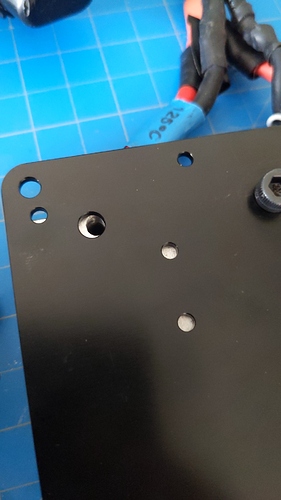

Alright friends, the plates are in my hand. Before I do a dance of joy, I need to make sure they made em correctly. Will test fit and update you guys shortly

The place did kind of an ass job making them (holes are kinda meh). But they fit properly and are correct!!!

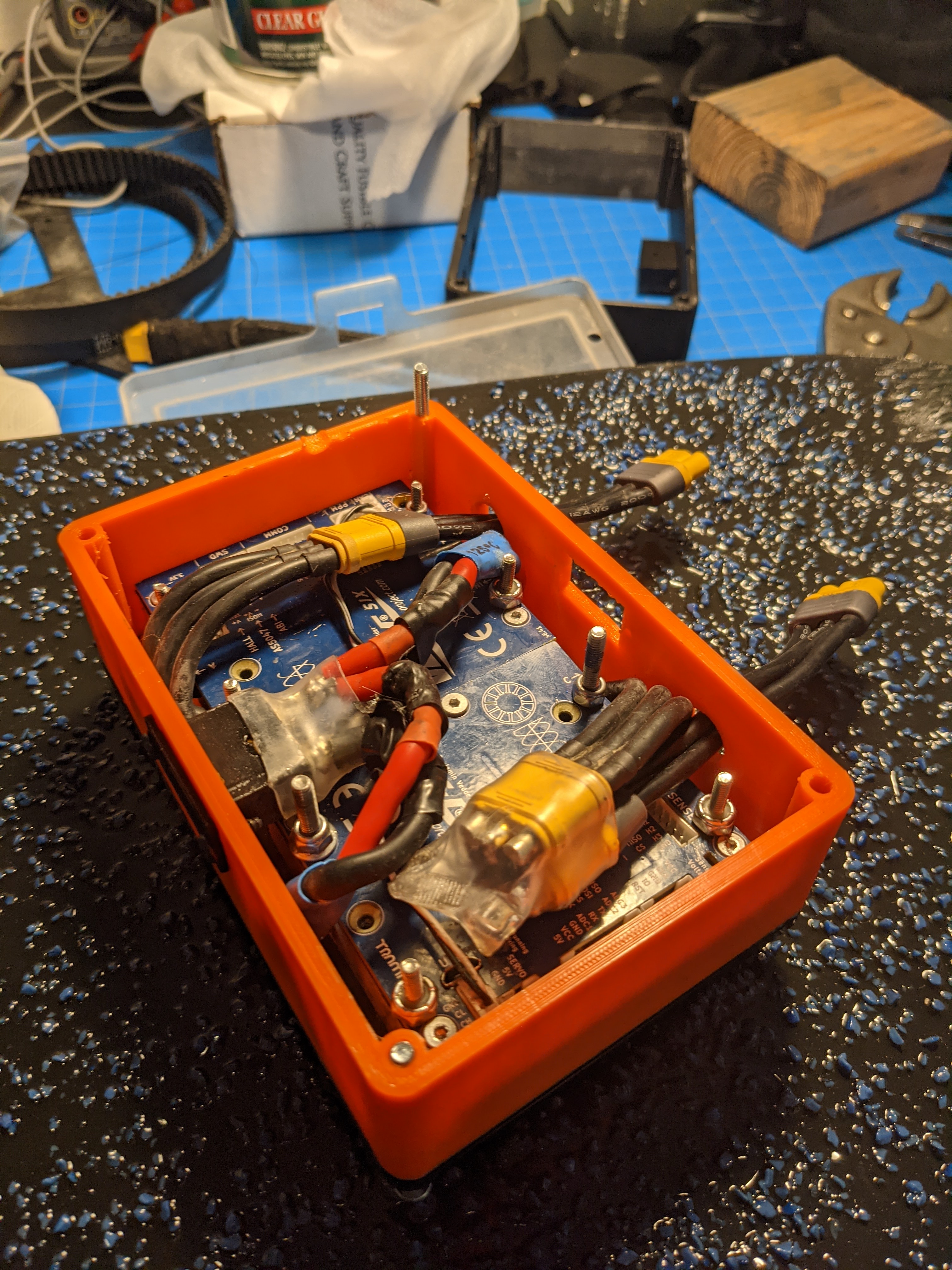

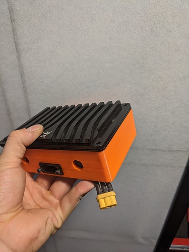

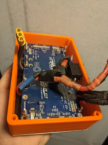

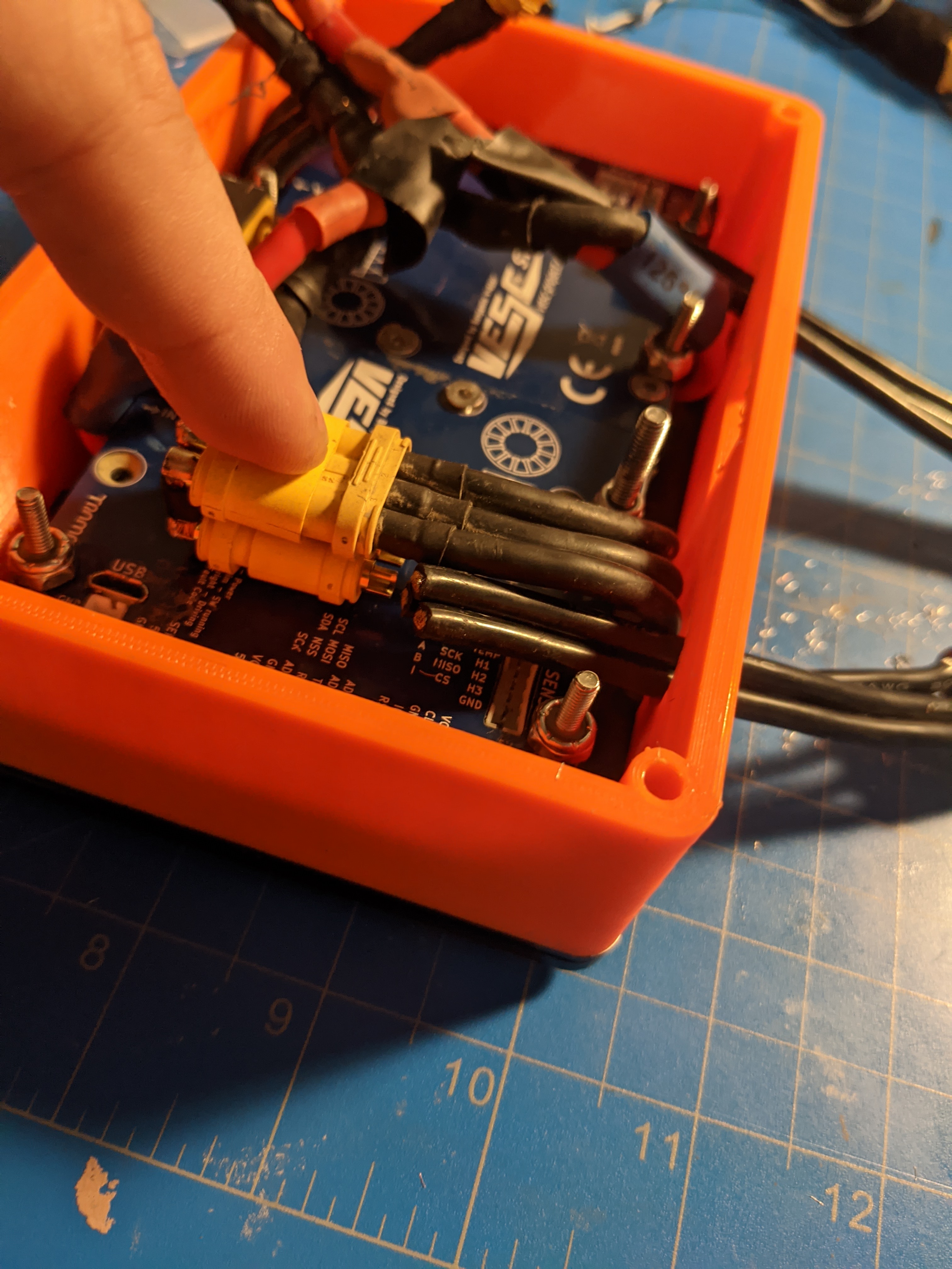

Gotta say I’m a big fan of the look so far. I did use thermal paste between both layers. Fitment was incredibly fiddly and required a diy job but Anshul assures me that that’s only for VESC6. only Trampa releases inaccurate schematics. :roll_eyes:

The plate change does.not address the Vesc6 issue afaik. We did work out a few simple fixes, but afaik, you’ll be asked to either using a smaller size bolts and nuts like I have, or only use two bolts per vesc.
I was looking for thermal efficiency so I went with bolts and nuts. I had to mount them opposing.so I could use the prototype case be gave me. This will absolutely NOT be the case that goes into retail since it’s the “fault” of the prototype case.
And that was only fiddly because it was the “developing” of a solution. The solution itself is very straightforward.
Trampa gave an incorrect diagram on their site. So the m5 bolts do not all fit properly. I think the best solution for this would be to use m3 or m4 bolts with nuts.
Exactly! The fiddlyness was figuring out the solution. Lol
Damn thats unfortunate :worried: fucking trampa…
@Agressivstreetlamp or @surfnacho do either of you have pictures of the suggested workaround for VESC6’s?
Robin will. Honestly very easy work around. Just instead of using the m5 screws, use m3 screws and some nuts.

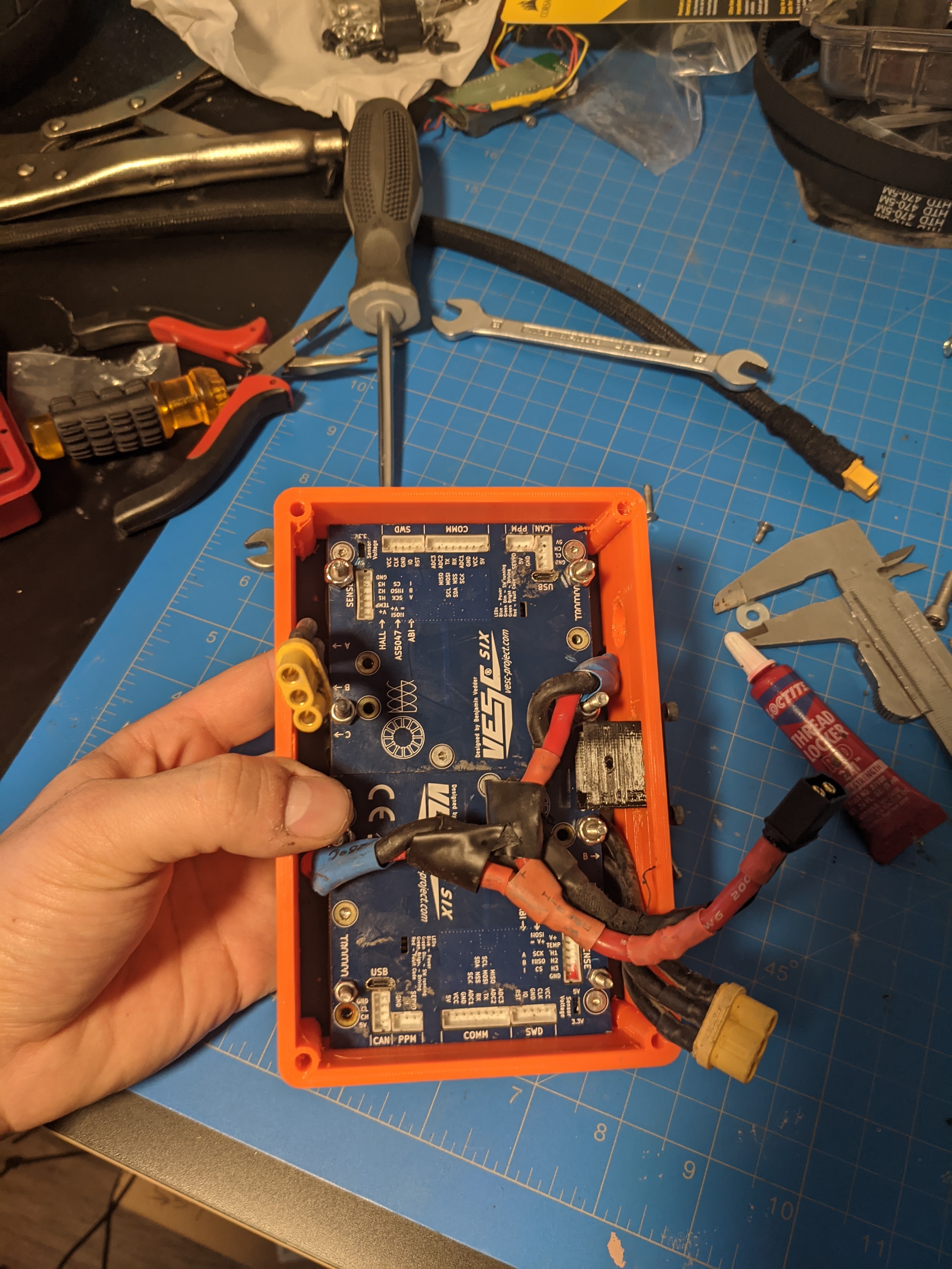

Here’s what I did. I mounted each vesc in opposite direction and used a mix of long 30mm or so m3 and M4 bolts so I could pass the bolts through the threaded heatsink holes. The mix of screws was only because it’s what I had on hand. Using a matching set.of 8 30mm screws with bolts will work fine. Look closely and you’ll see the long bolts stick out the top of the VESC
This is to attach the Vesc6 to the plate. The plate to the sink stays the exact same as before.
Opposite direction is only because I wanted to use the smaller orange box that Anshul prototyped. The box is very small and mounting the VESC in opposite directions allows me to mount the VESC so they are all the way together. If you mount them both in the same direction, then they will be slightly further apart. About a 5mm gap between them.

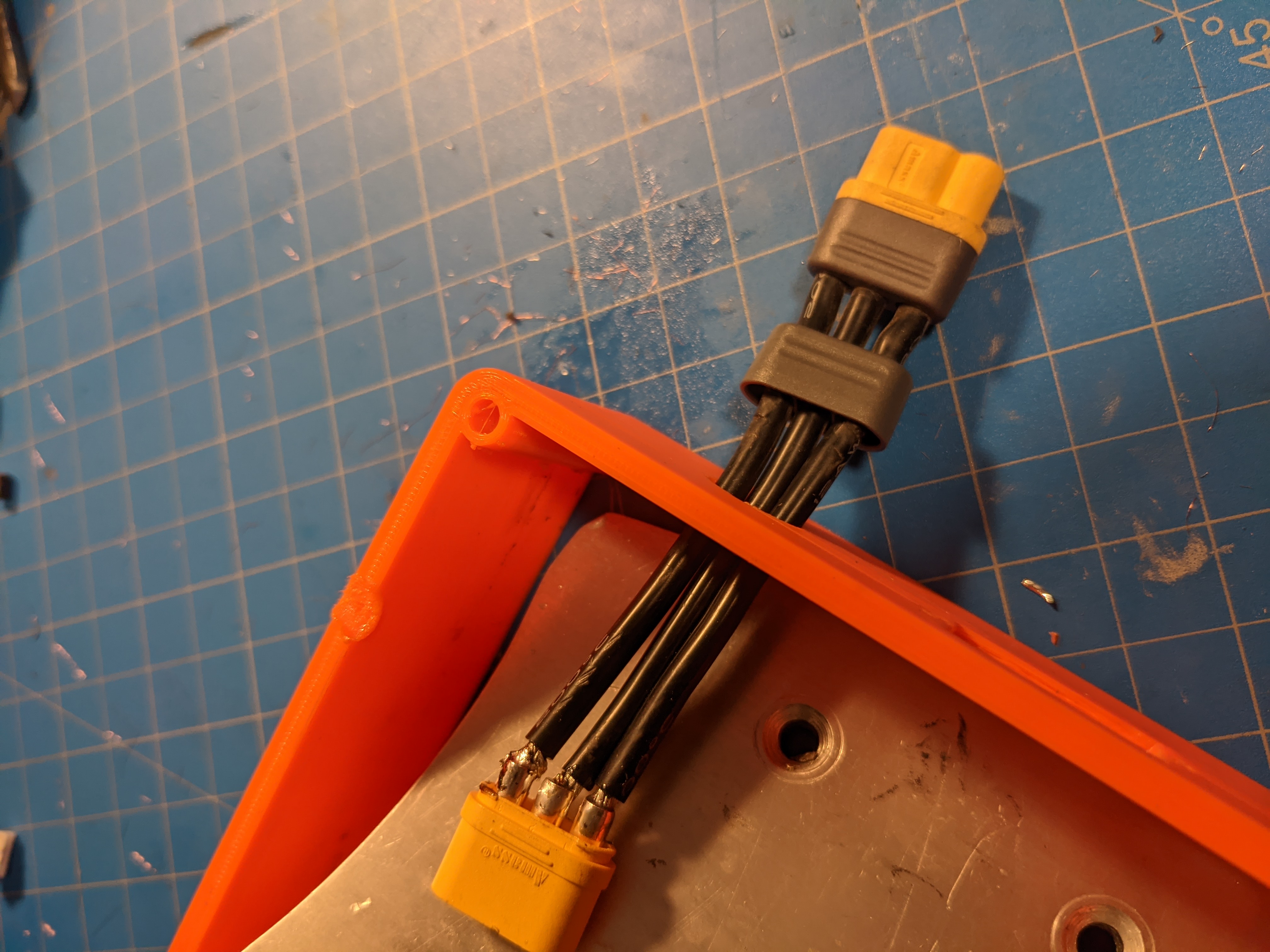

Some pictures of the issue, and one off the approximate size of the gap when mounted normally.
TO BE CLEAR
The smaller box in Robin’s photos is an older version. The final rev will not require rotating one of the vescs. The final will be larger and be easier to assemble in.
