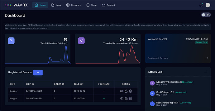

Btw I have added Paypal checkout option since many have asked me for it (@Bionic24 @NuRxG )

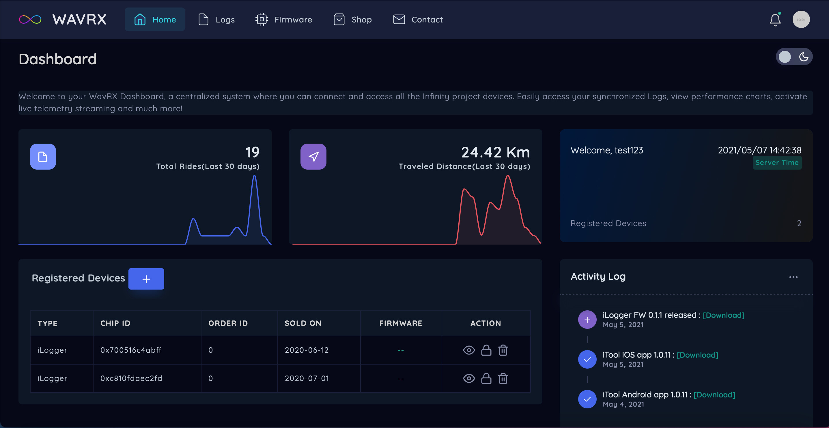

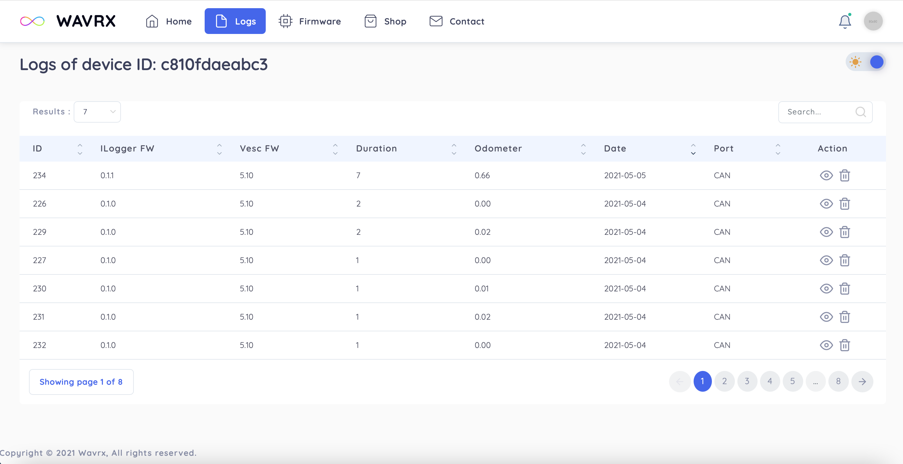

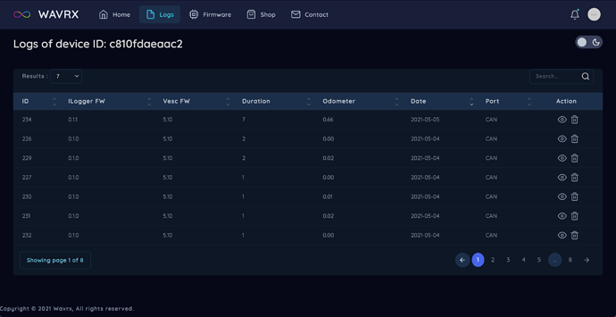

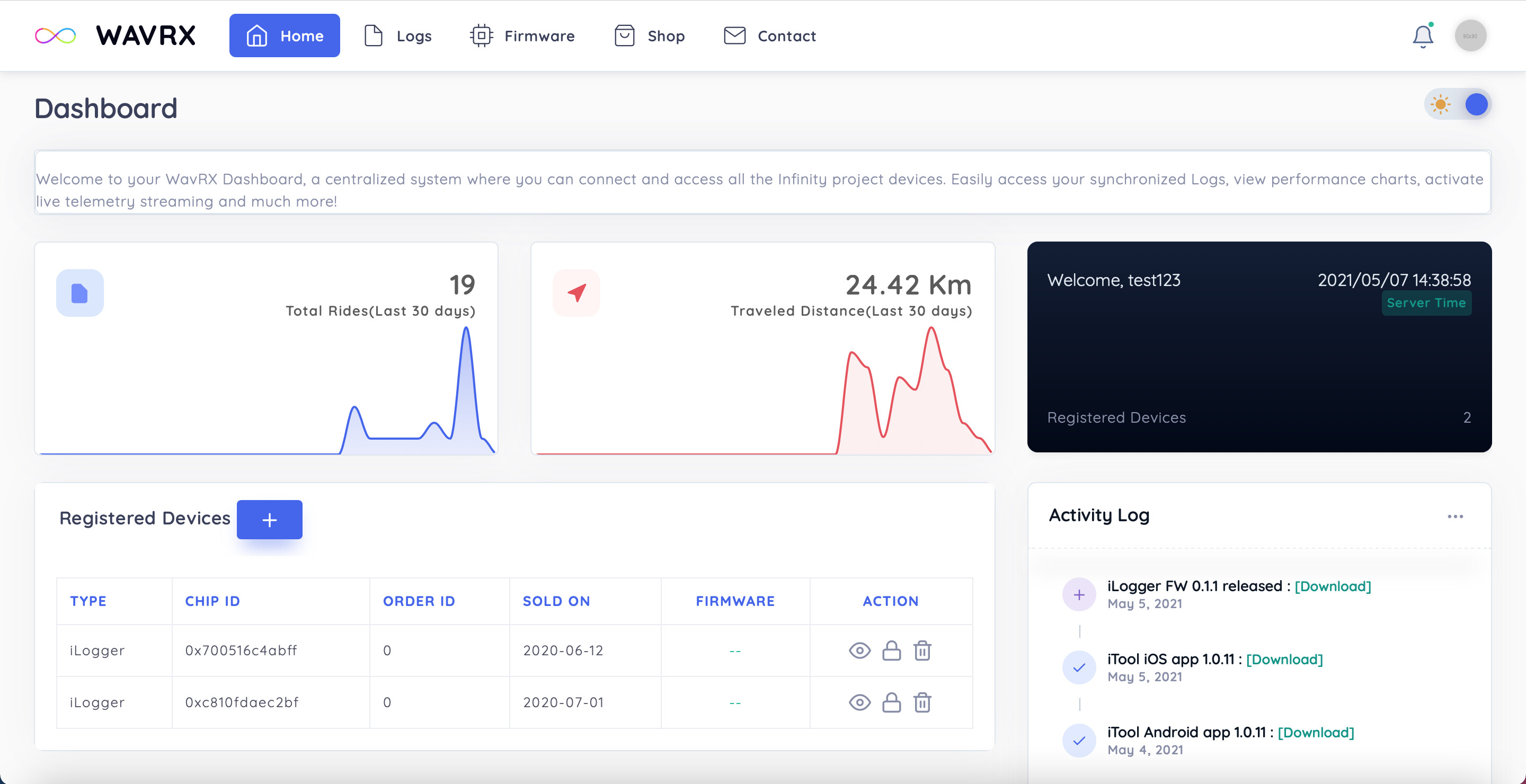

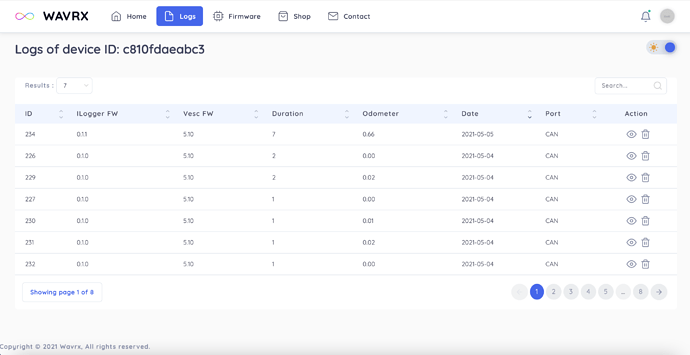

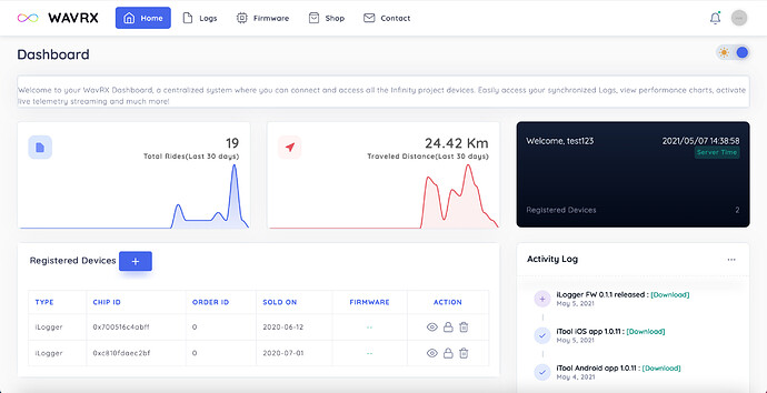

Also the online dashboard is now live for testing at
https://api.wavrx.com/dashboard/register.php

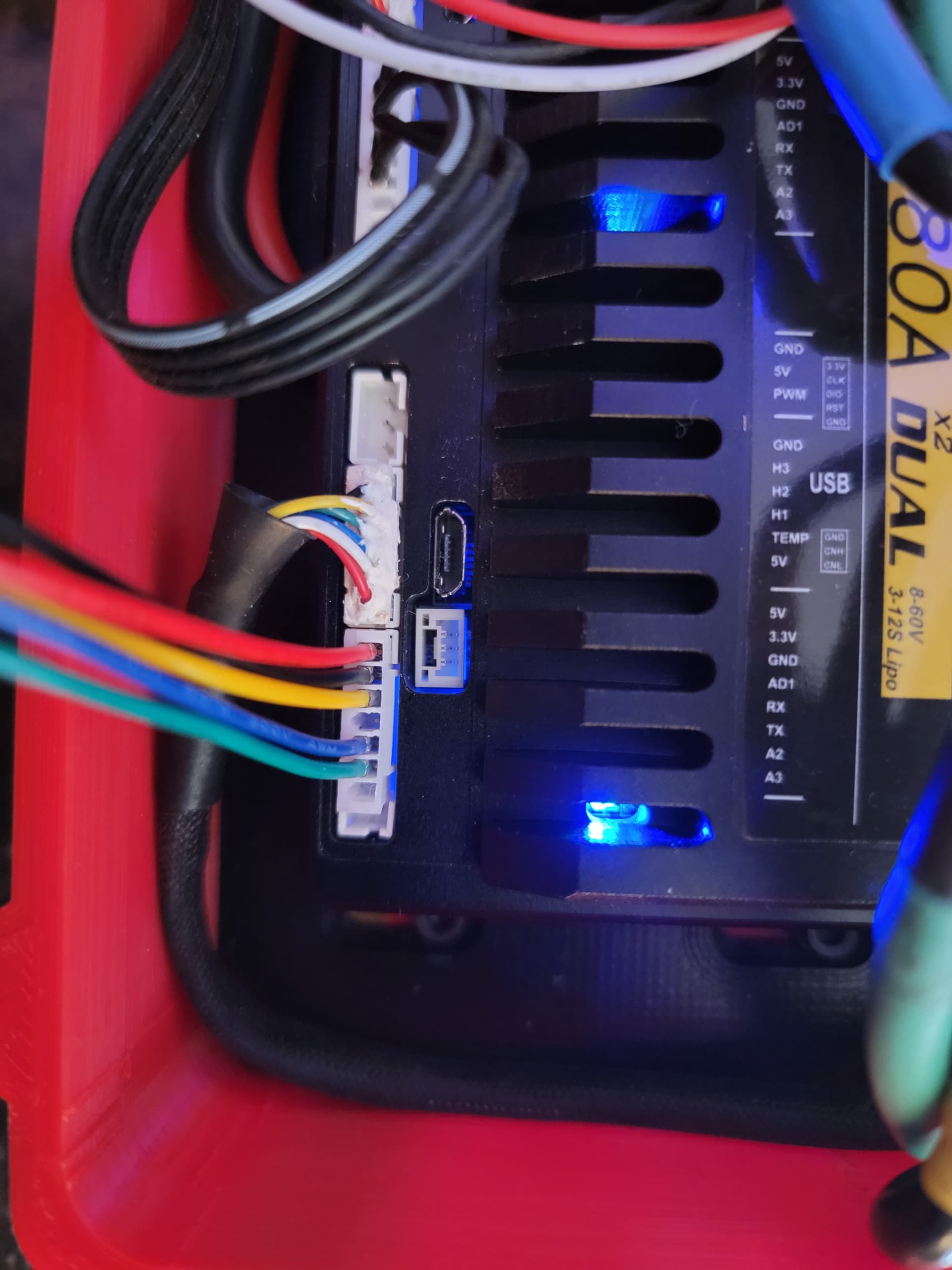

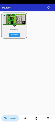

Can’t seem to get my iLogger to do anything. I’ve got it wired up to a DV6 vesc, and it won’t open the settings screen or anything for the module
Any ideas? iLogger has the orange light on, I connected to it and put in my pin, but I can’t select settings or do anything else with it. No idea what’s going on

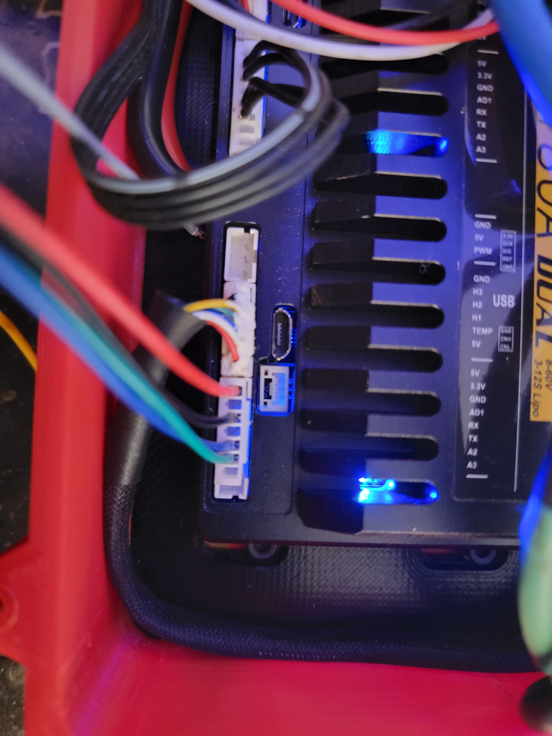

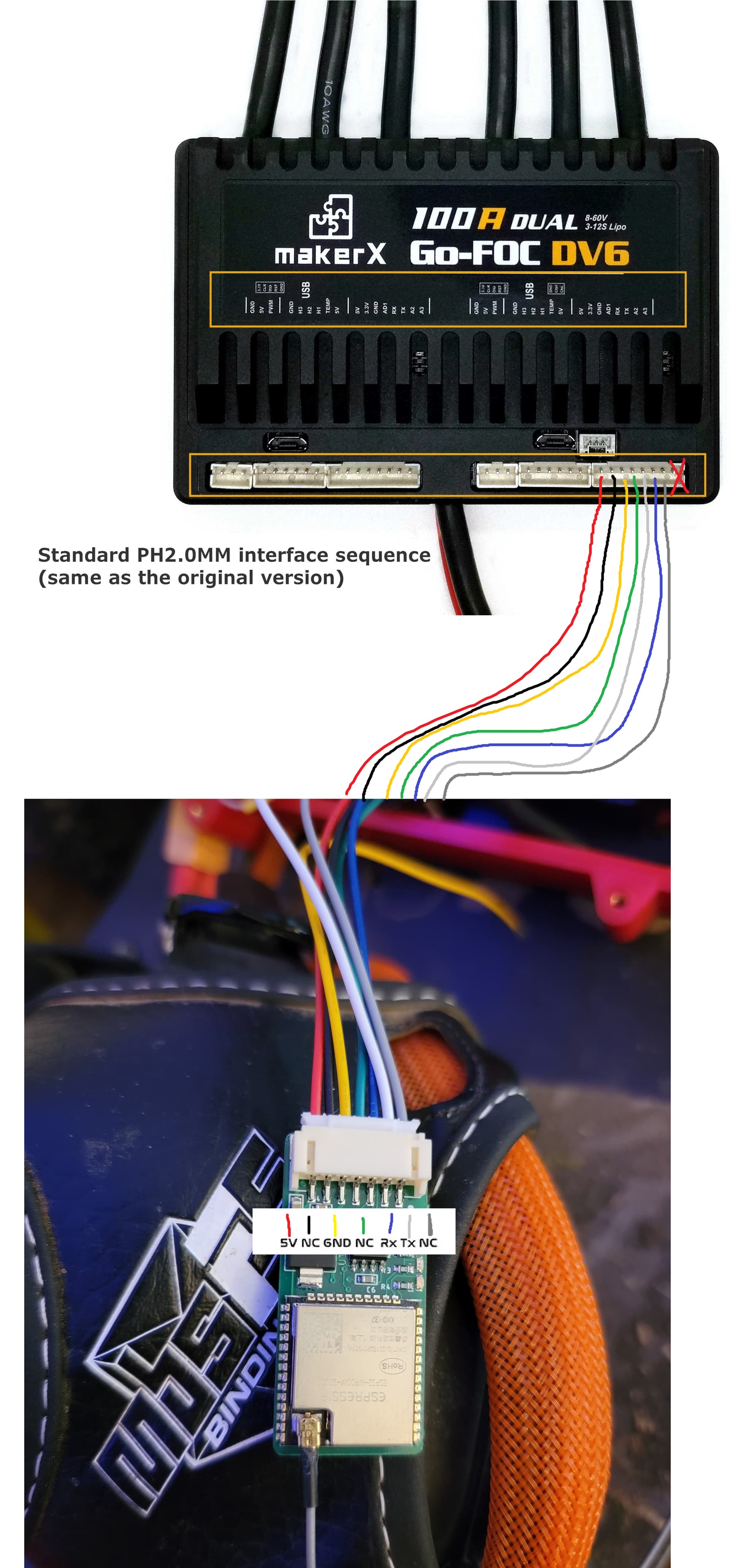

I was able to update it using the SD card, however, I still cannot manage to get any vesc data to show up, I tried doing the exact pinout as listed on the website, which did not work, then I tried just plugging it in with the default pinout, which turns on, but doesn’t transfer any vesc data, and then I tried swapping the rx and tx, which also did nothing, and then tried the other uart port, which also did nothing.
I’m not really sure what to try next. Both sides of the vesc have UART turned on, and the ilogger is set to receive in uart mode
Glad you got it updated. Which Vesc FW are you running?

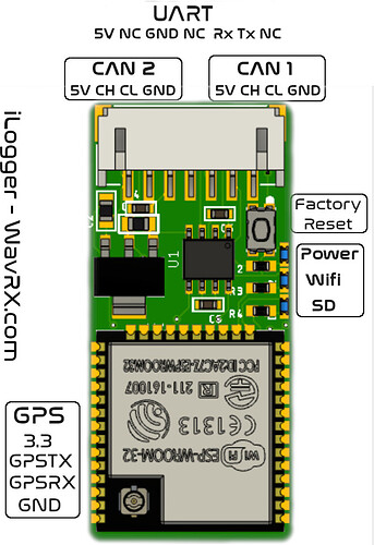

I checked the pinout of the DV6 and indeed Rx and TX pins are swapped. Rx pin on iLogger should go to Tx on Vesc and vice versa. Pinout can be found here Setup - WavRX
UART baud rate is 115200. If using Dual vesc, set slave vesc ID on the setting tab to enable Dual logging.
Whenever you change settings, press “Apply” button and wait for iLogger to reboot for settings to be set.

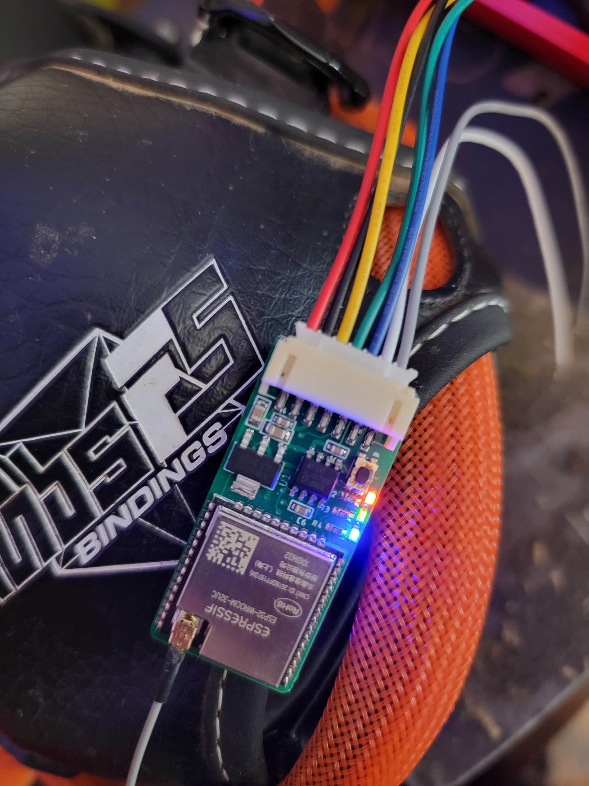

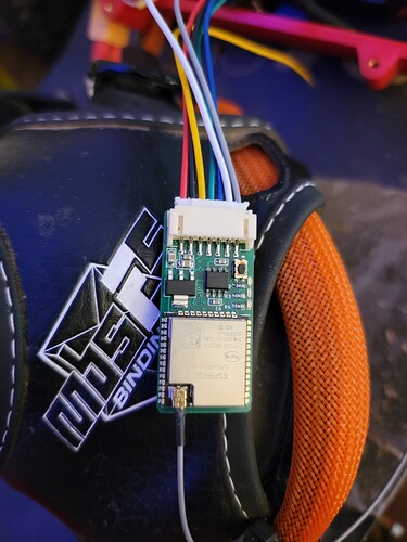

Still no luck for me unfortunately. Should the extra wires be disconnected from the VESC or be left connected in the spots that aren’t used
The way it is connected now is the only way it turns on. I tried putting the 5v and gnd wires in the spots I thought they should be according to the dv6 layout, but it’s not working. RX TX swapped or not. Master side or not
The wiring seems incorrect, please check the photo below, Red cable on your vesc photo is correct, goes to 5V on iLogger, so Pin 1 = 5V, Pin2 = NC, Pin3 = Gnd, Pin4 = NC, Pin5 = Rx on iLogger and Tx on Vesc, Pin6 = Tx on iLogger and Rx on Vesc, Pin7= NC.
Yeah so I tried that config first. In that “proper” configuration, it does not even turn on.
You can see why I am confused here, it turned on when it should not have, and does not work at all in the configuration taht it’s supposed to work in.

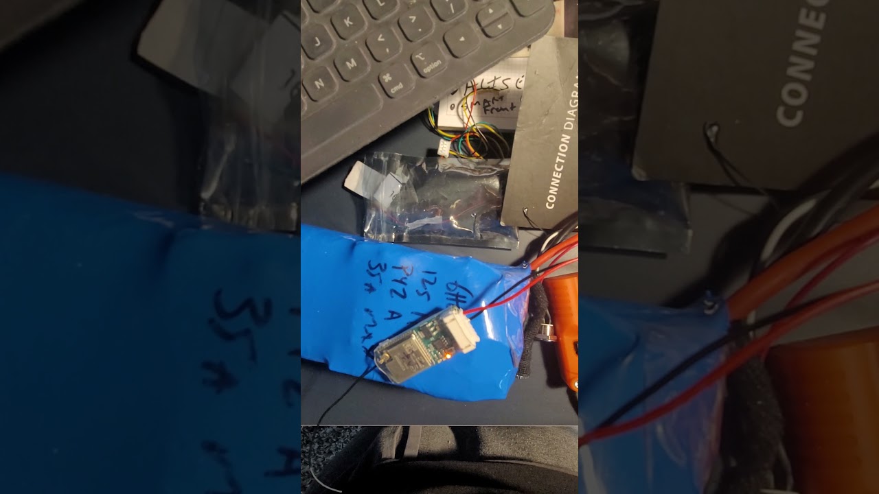

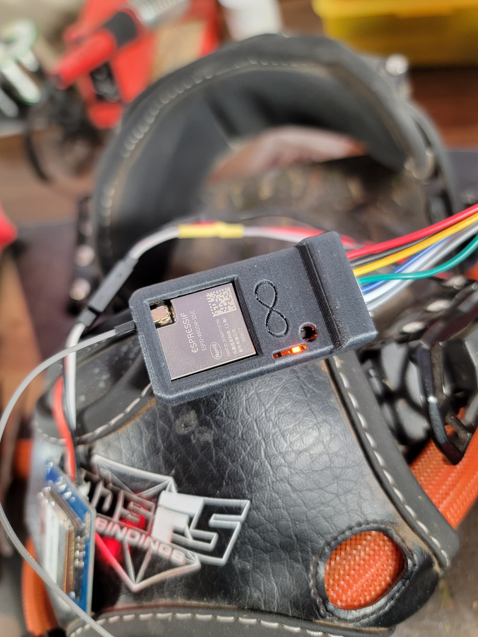

First pic is using green instead of white
Second pic is mixing up black and yellow, and not using white
This is the correct config. Yellow is ground, blue is RX and white is TX. Black, green and gray are not used.
Oh what the heck I didn’t realize TX was white. I have always seen tx and rx as blue and green
Yeah, the wiring colors are a bit confusing haha
yellow as GND yah very weird lol I’m thinking I should just re-pin both sides. For some reason I was thinking color = what they are, but nope.
Got it repinned, seems to be working now. Woot
