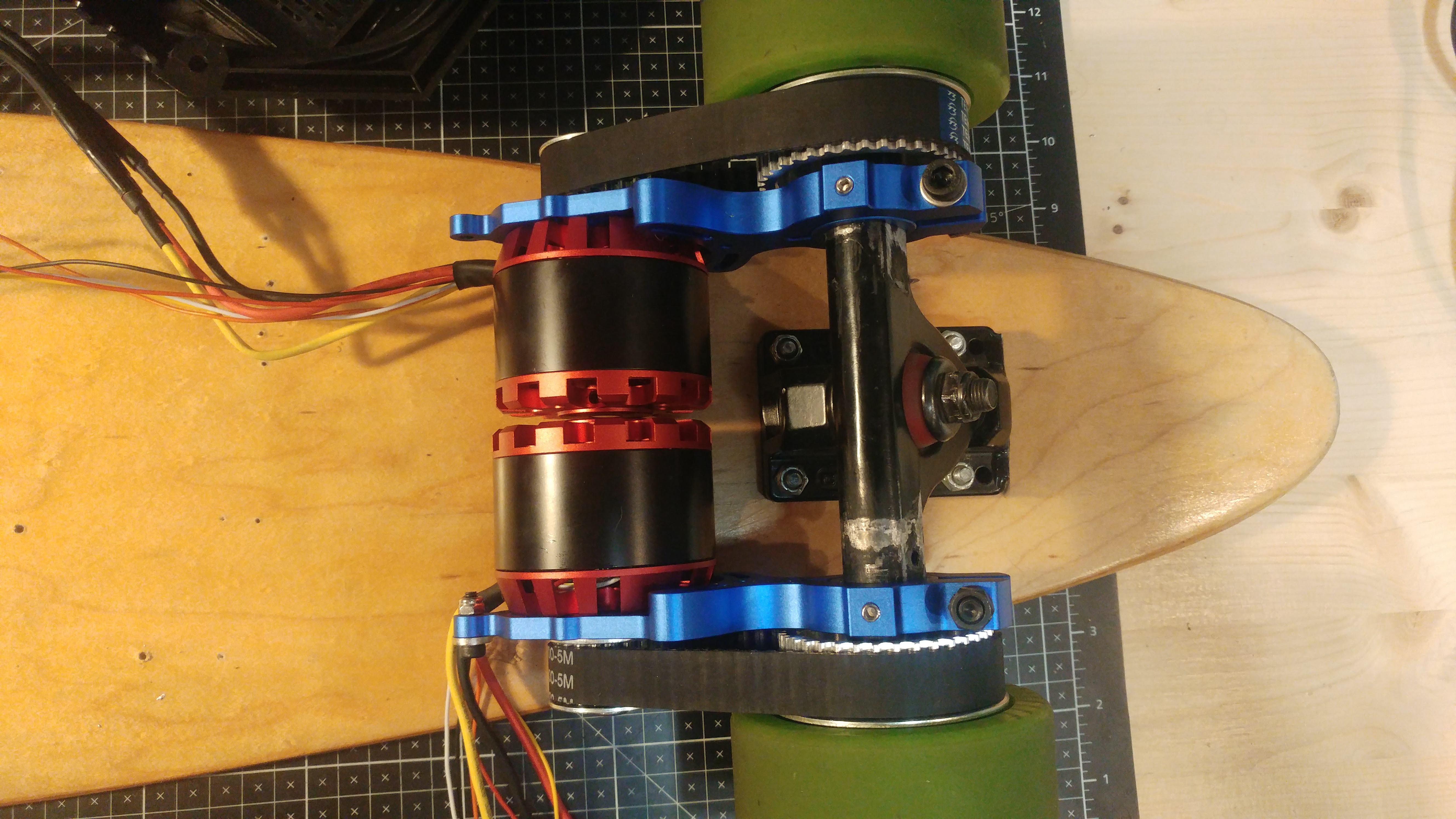

After years of struggling with non-esk8 parts ont his build I got all new hardware fro Dickyho and am looking forward to finally ride this thing like it’s supposed to.

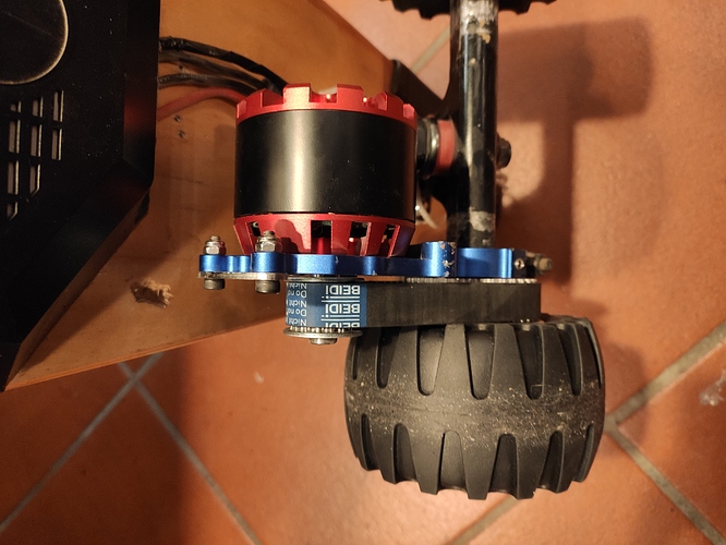

I mounted the motors but I’m a little unsure about the wire placement and on how to tighten the belt since the bolts are hidden behind the motor pulley

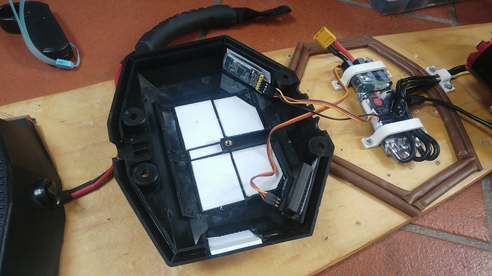

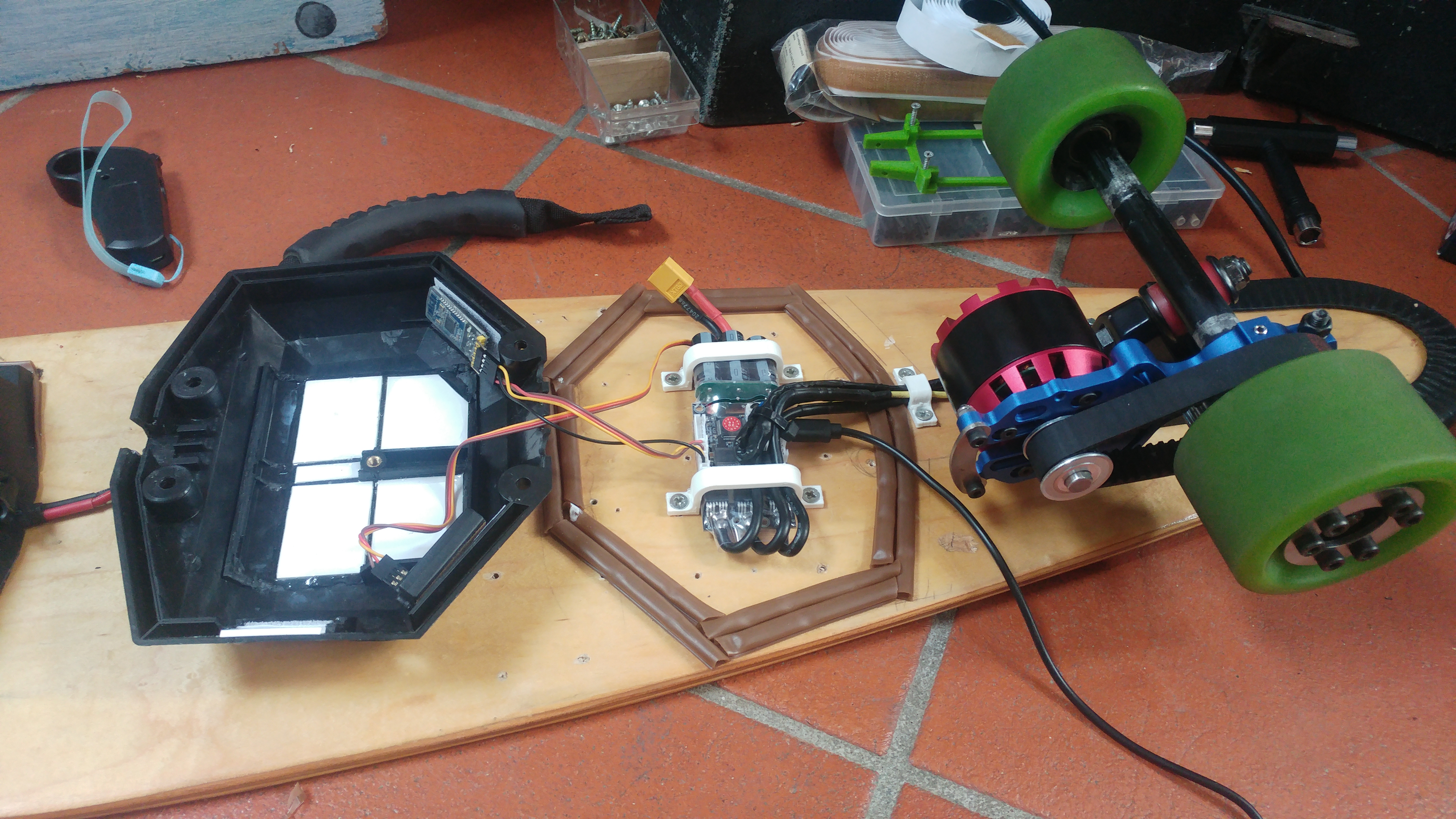

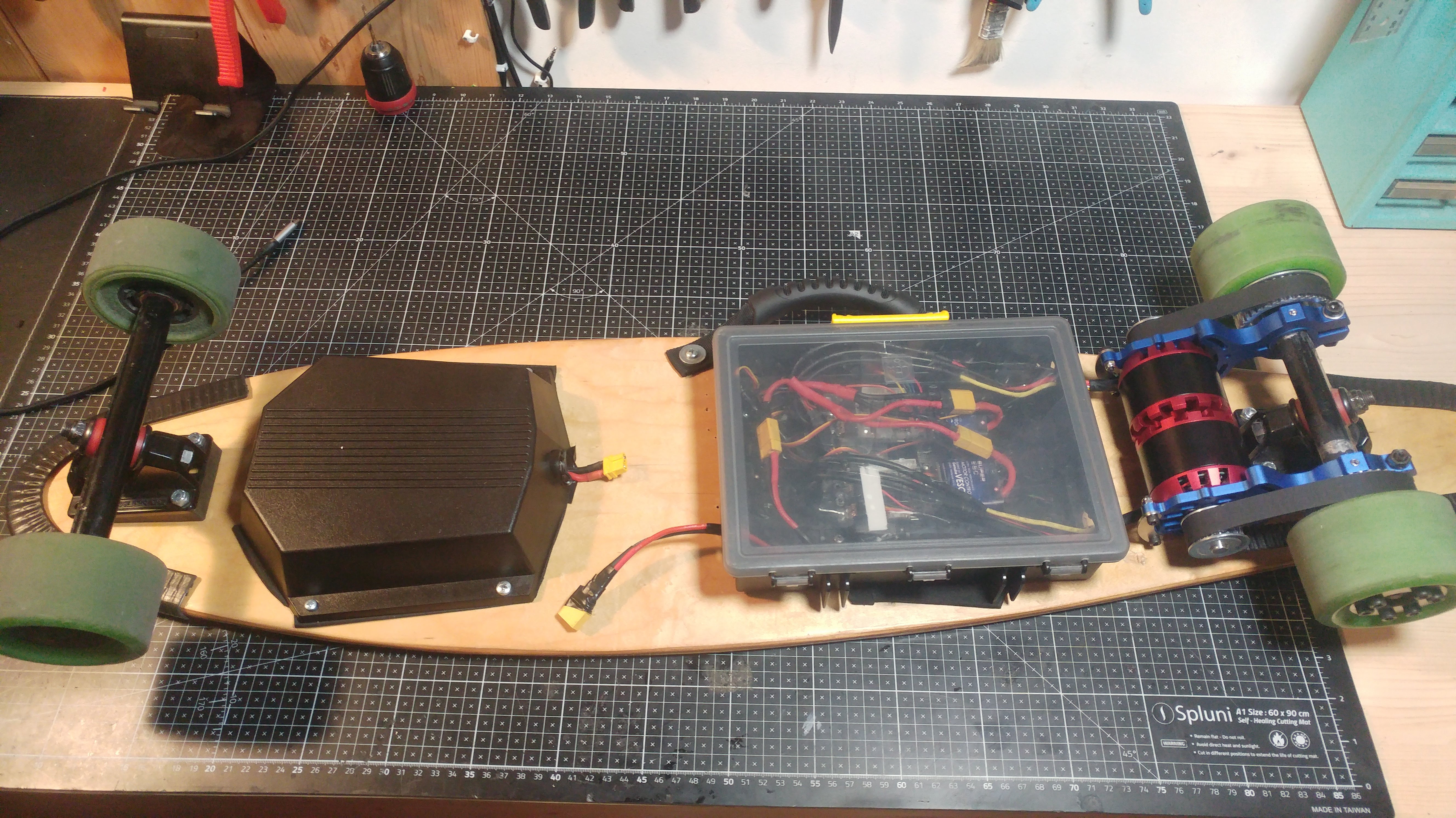

I’m currently having issues fitting the vesc’s inside the meepo style esc enclosure. The measurements would have made it seem they would fit but wire stiffness and connector size are making it a little difficult. I was thinking of using the aluminum heatsink plate, but it is a little tight so I took it out. Still I’m unsure on what to do with the motor wires and how to route them.
I was wondering if it was possible to hook up the battery indicator used by the chinese esc’s included with the enclosure to the vesc
I can’t say is a good solution but you can file small notches on either side of the ESC enclosure for the wires to come out from, that way they don’t bend as much. That indicator only works with the cheap ESCs
You can buy one of the ebay battery indicators that works for 6s batteries, then you solder it onto the positive and negative terminal of the xt-connector that goes to the battery.

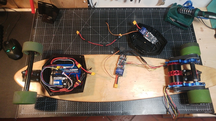

I’ve completed initial assembly, waiting on the can bus wire and the hm 10 bluetooth module connector. I couldn’t get the vesc’s to fit in the enclosure so I used the old tool box I used previously, not the best but I’ll replace it eventually, meanwhile I can tune the settings. First test ride was a success. I’m planning on building a volt meter I can plug into the charge port of the bms for testing voltage, as well as getting telemetry via bluetooth. I’m currently using a 20/36t pulley setup and it seems plenty tourquey and fast even for pretty steep slopes
I fit 2 vesc 4.12 with a loopkey in the Wowgo ESC enclosure by putting it diagonally a bit. Maybe that might work for yours! Nice build :smiley:
After losing my mind on this board, building a vacuum forming table and failing at making an enclosure I’ve decided to only use one motor, with a 15/36t belt drive.
I’ve also gotten a 25.4v charging brick so I’m able to charge to Max capacity.

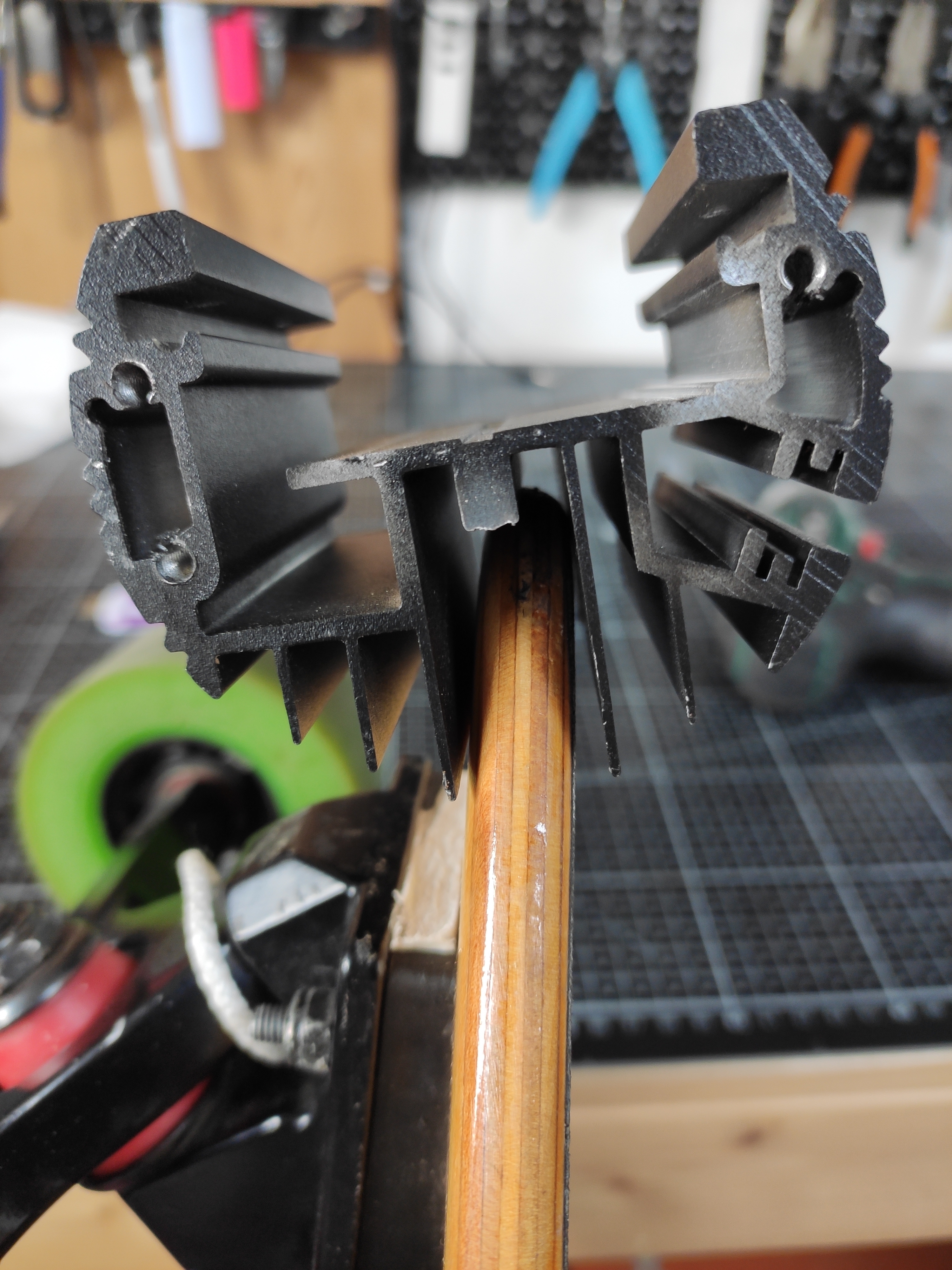

With one vesc and one motor everything fits in the meepo enclosure, after cutting out the aluminum block and closing the ventilation hole with abs sheets from the vacuum table.

Also tried fitting an ATV led light I still had by cutting away one of the fins with my table saw hence it’s aluminum.

Well this thing is a nightmare. The esc enclosure broke, the pulley rubs on the wheel and I can’t get it centered for the love of God. I thinking I either throw more money at it (wider trucks and large abec wheels for the pulleys, a new a shorter deck) or sell the parts and get a meepo mini v2.

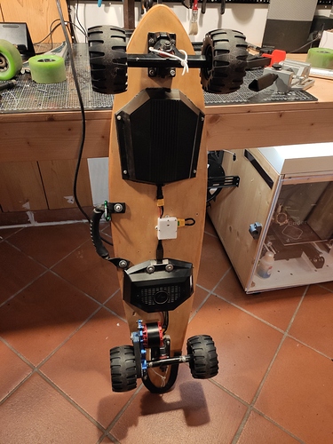

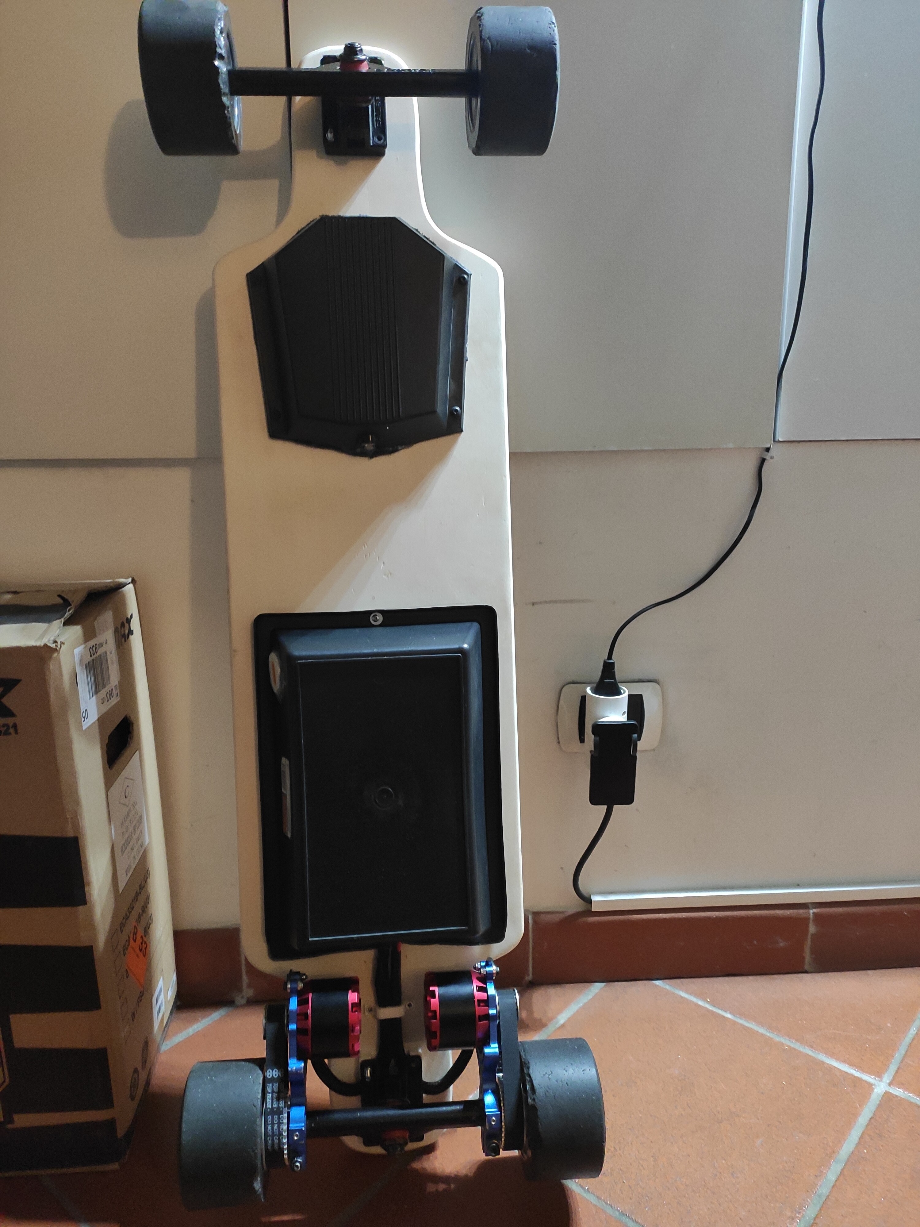

I got some extended hangers and larger wheels from a user here on the forum, and found a larger enclosure at a hardware store in which I could fit everything comfortably. I cut out a deck out of 20mm plywood and was able to mount motors and wheel pulleys how they are supposed to, with their own bearings. Finally i routed a slot on the top for the wire from battery to esc enclosure. Turning radius is much better now, and i feel confident I can now finish up the board in a decent manner. Still, battery is only a 6s and a little small on capacity. I also found the bluetooth module i got, so i can use the mobile vesc tool. Had to bypass the motor sensors because the wires are too short, i extended the phase wires with softer ones as well.
Looks like a lovely little build. Plywood deck is interesting. Make sure you inspect it occasionally for cracks or anything
