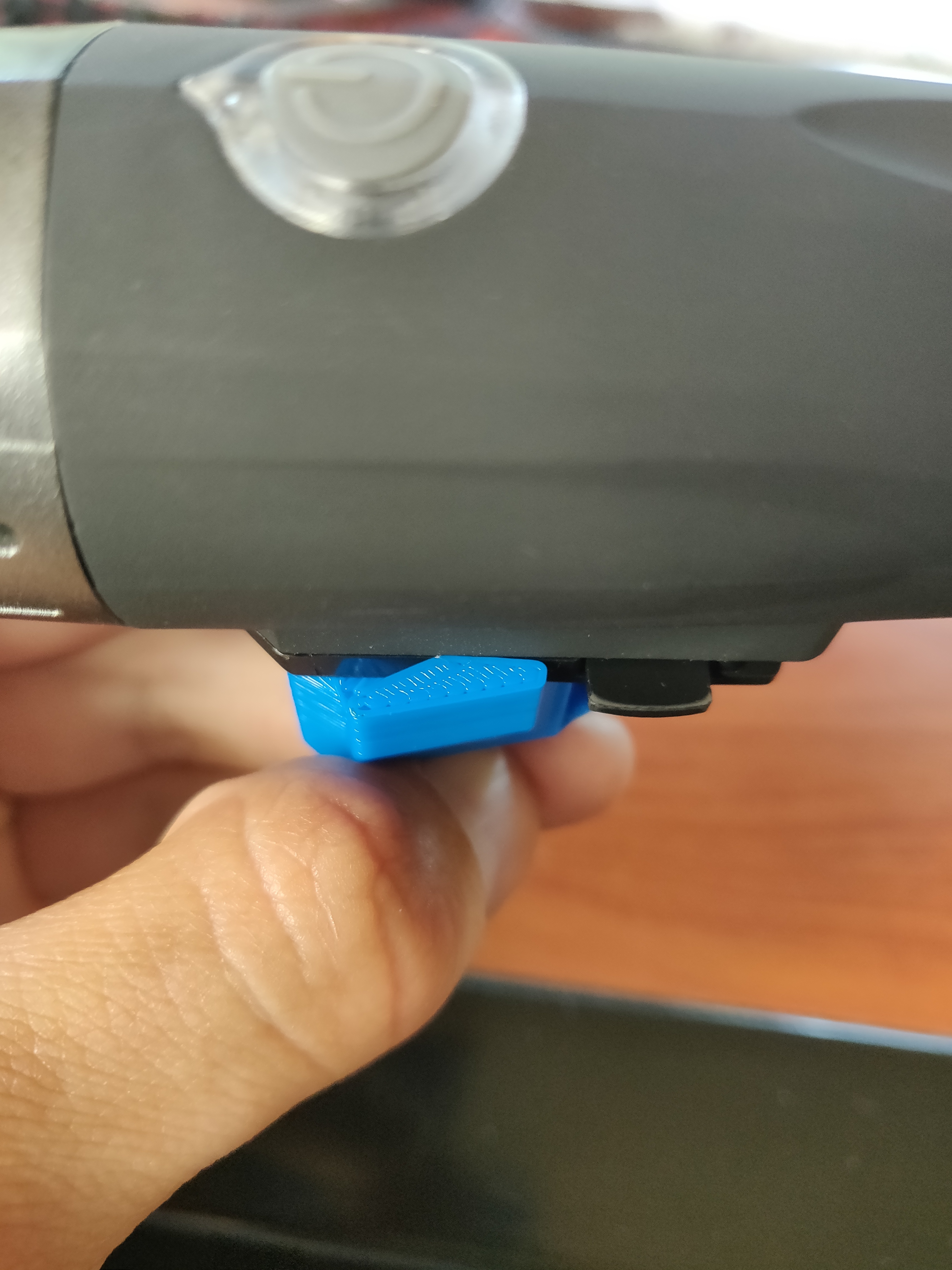

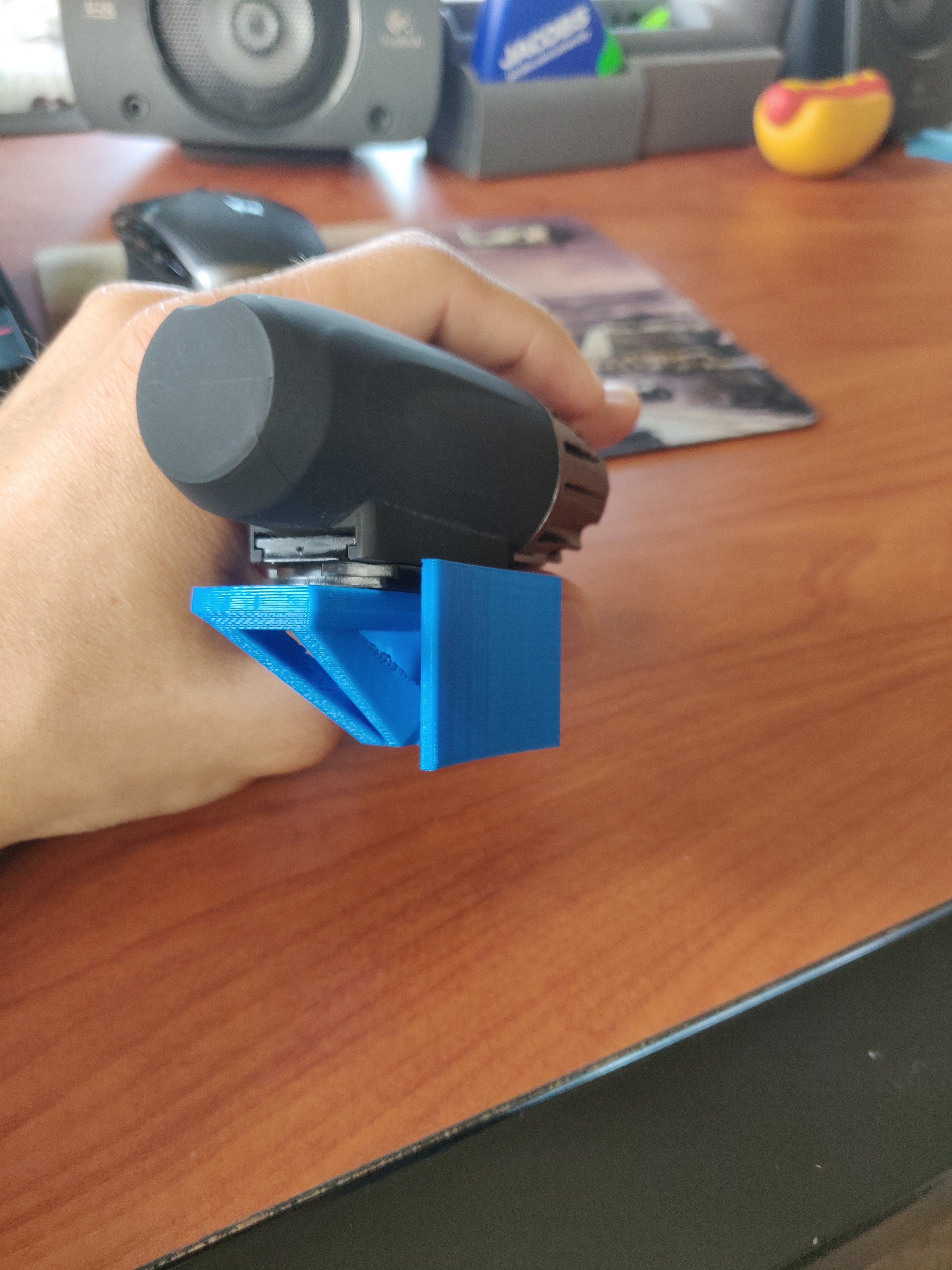

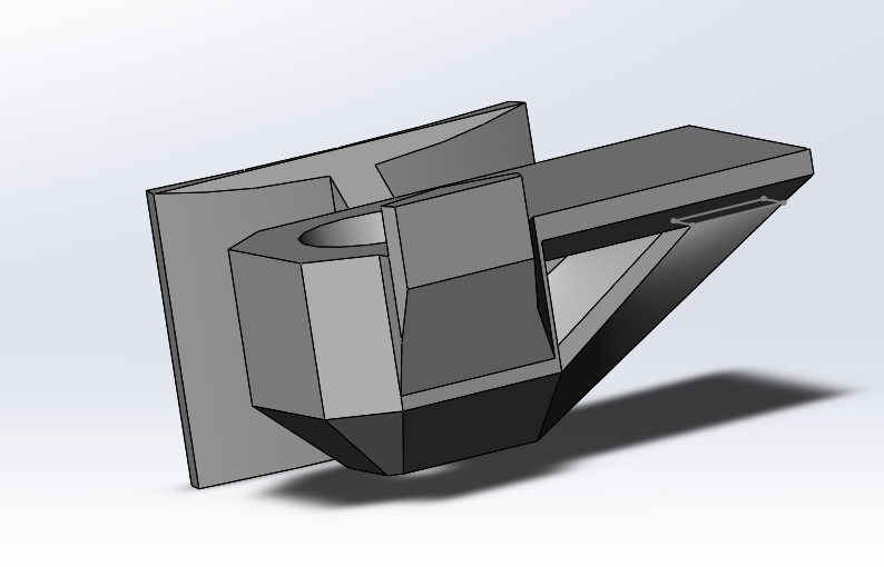

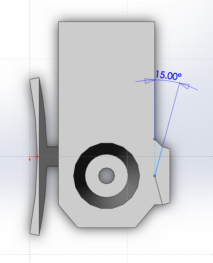

Here is an update; just whipped up this prototype. I am going to eventually make a new thread for this, but for now this is where it lives. It allows for angling horizontally 15 degrees either direction, but not over so you don’t have to worry about it moving out of any useful angle.
I realized something really neat about 3d printing these; the curved plate that would have VHB or command strips on it can be submurged in near boiling water for ~10 seconds, then pressed against wherever it would be mounted to get a Perfect conforming fit to the surface. It could essentially fit any helmet, ever. You’d get the VHB/command strips separately and attach them after you conformed it to the helmet and you’d be golden.

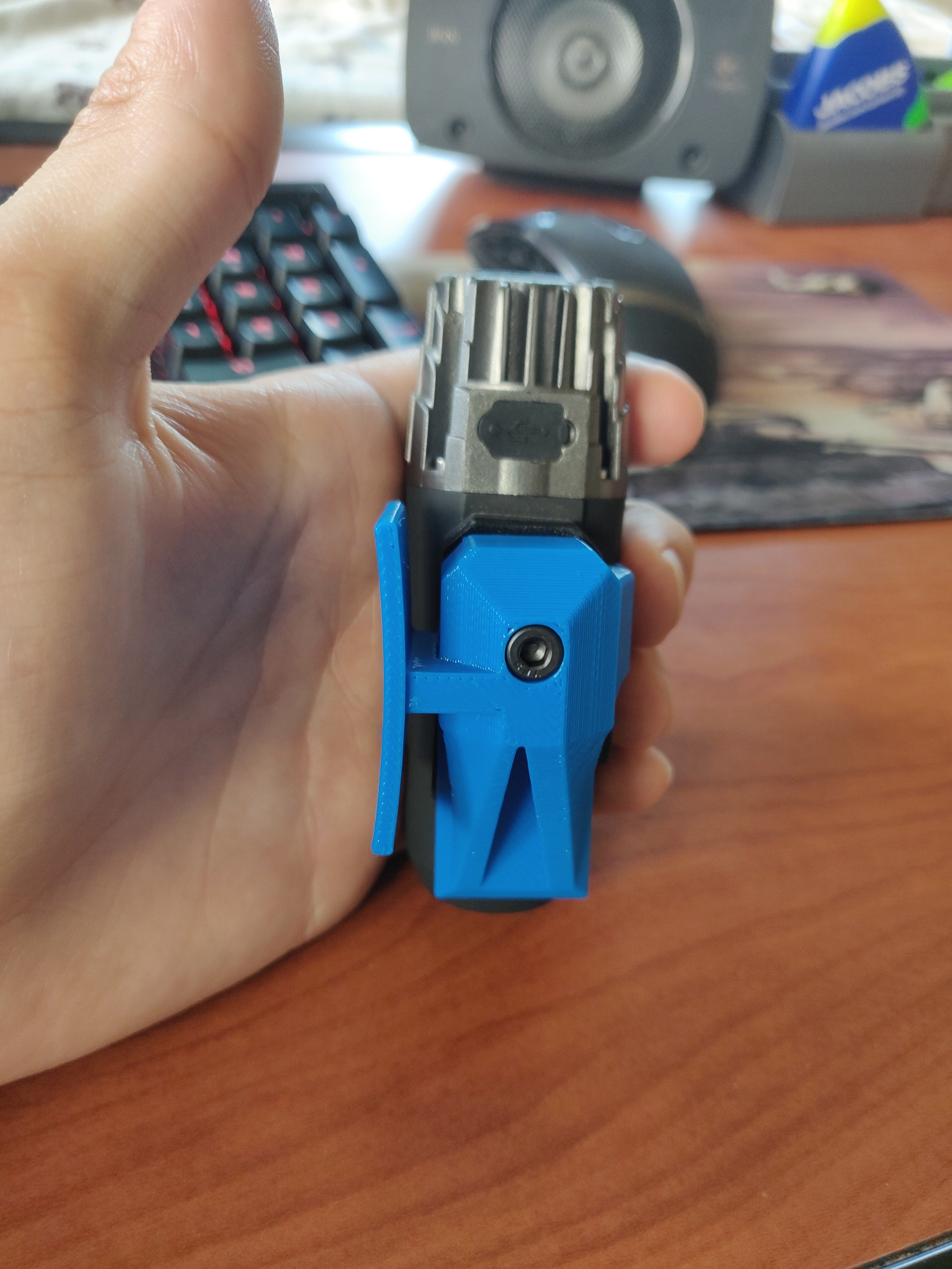

Ok, i’ve got a prototype printed. I adjusted a few things but its not there yet obviously. I need to reduce the angle from ~15 to like 5 degrees, its currently too much. The flexible mounting “pad” works well and I think it will have no problem with adjusting to different helmets, and the stress is being put into tension along the layer lines as opposed to perpendicularly to them (assuming you strike the light from the front) so it feels pretty strong.
I’ll PM you an stl to print and test. You can adhere it any way you want just to test fitment, but I wouldn’t do anything permanent for obvious reasons.
