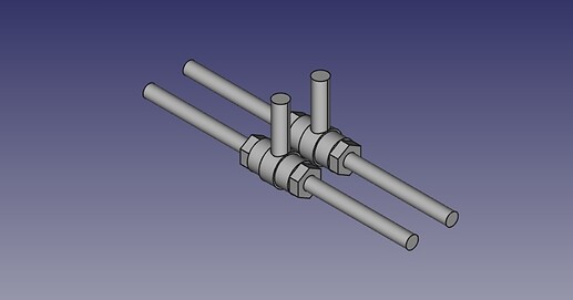

Idea for trucks with variable width and angle
forgive my CAD skills

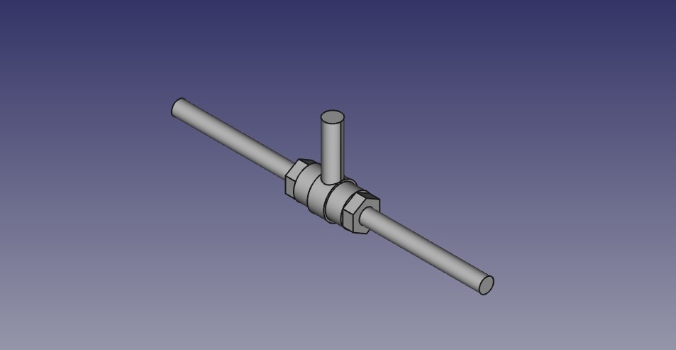

first we need a Heim Joint
then a fully threaded high tensile rod (dunno how to cad threads)
add a pair of bushings in each side (just like NKP system)
lock the bushings in place using nuts (yeah, idea stolen from NKP)

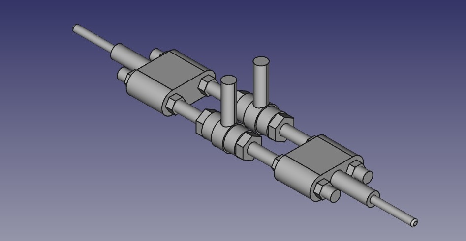

make that two
add the axle component in one end of the parallel rods then lock with nuts
do the same on the other end
add nuts to the heim joints

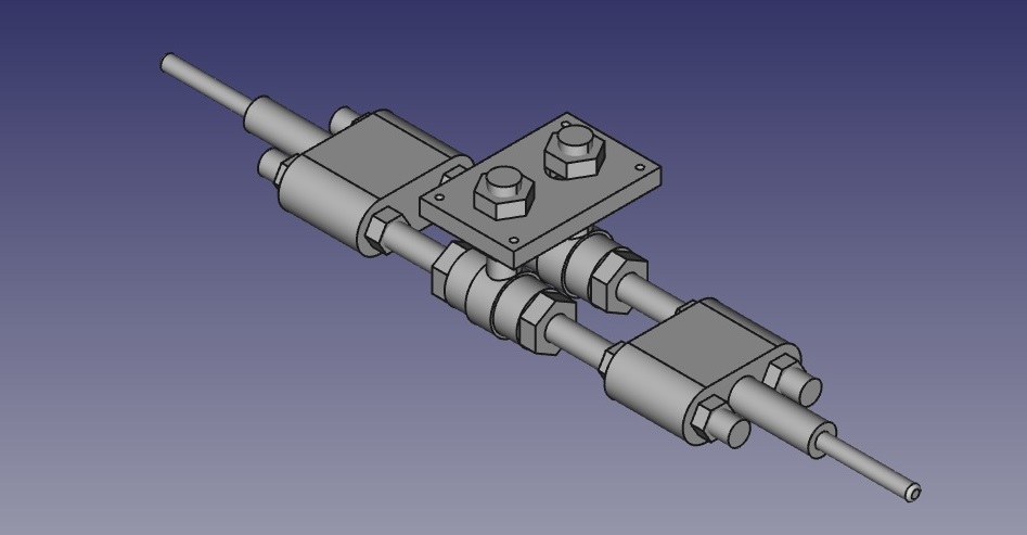

place in the baseplate
finish by locking the baseplate with another set of nuts
to adjust the axle width just slide the axle component along the threaded rods
to adjust the angle just adjust the mounting height of one or both heim joints

looks like it should work. i remember seeing someone else designing something similar here before, not sure they ever built one. my main concern would be that there could be some kind of twist in the parallel bars, im not sure how you would eliminate that.
my advice would be to try it out. most of what you have here should be easy to build with little more than hand tools.

Thanks! You got me with the oversight on the parallel bar twist. I think it could be eliminated/minimized by very tight tolerance between the rods and the axle components.
Would absolutely love to try it out. Can fabricate most of the components but a quality heim joint and custom bushings are out of my reach.
Nice! Love the simplicity and adjustabillity of your design. Nice pictures mentioning the design steps too. Wouldnt be too hard to make, you can start with simple hardware store parts with lower tolerances just to make a proof of concept. Can even 3D print the axle hub in nylon or so just to proof out the movement when you are standing on the board. That will already help you get a feel for things pretty quickly.
