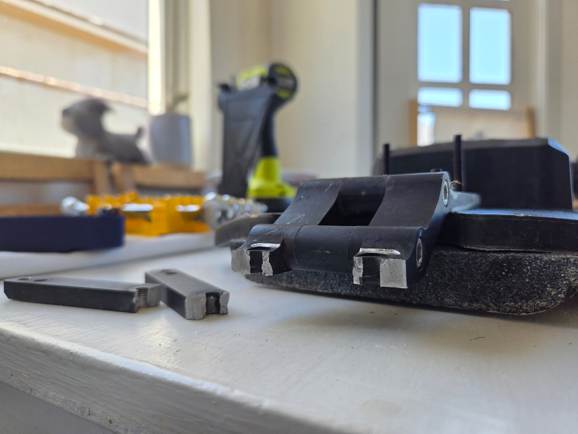

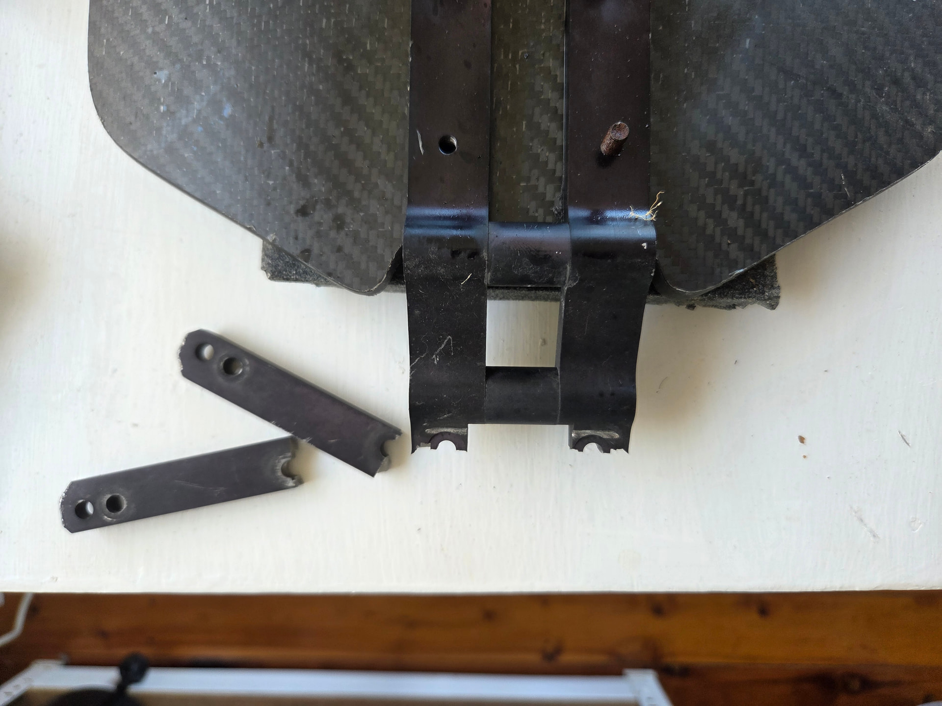

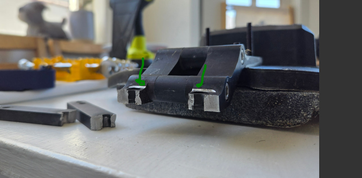

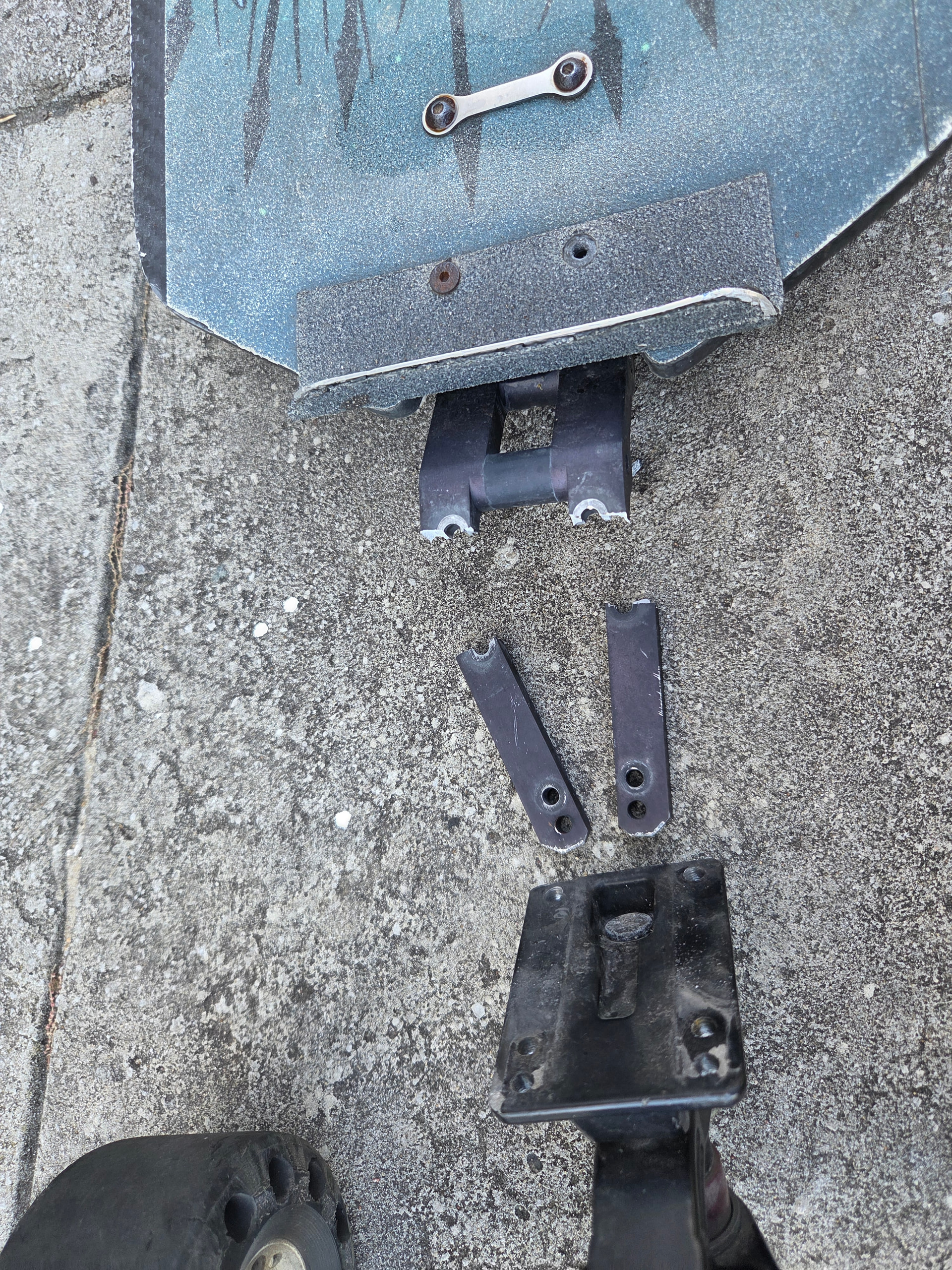

It looks like it failed because of the truck pressuring those points. I recommend to add small, shorter riser if you use bottom truck installation
Guy is right
I’ve never had any such reports when using a drop-through mounting setup.

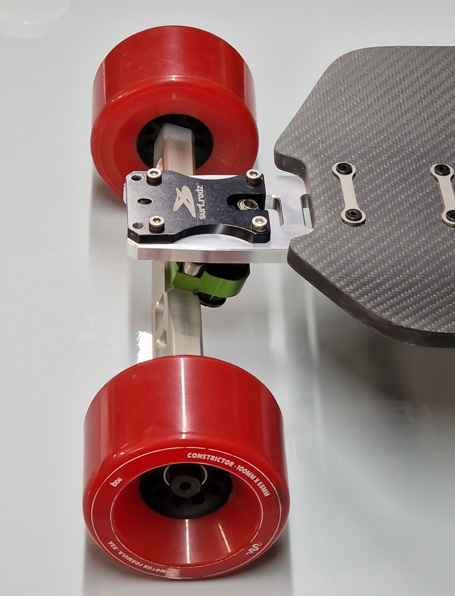

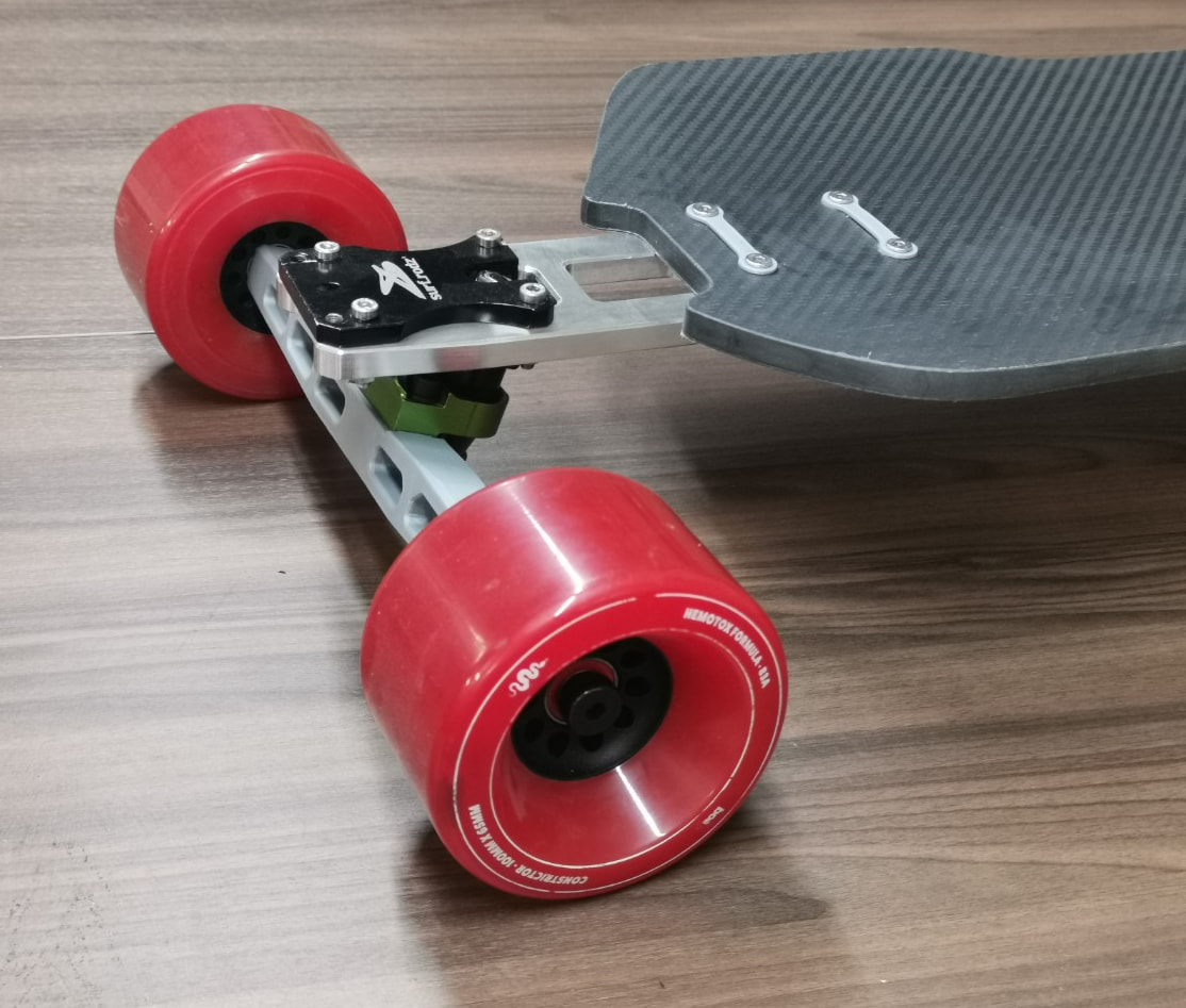

If you wanted to raise the deck, you could have ordered flat brackets (without depth) and mounted them in a drop-through configuration.
Here is the link to the flat brackets:
Flat bracket (M), depth 0, offset 103mm – eFreedom
Flat bracket (L), depth 0, offset 132.5-142mm – eFreedom

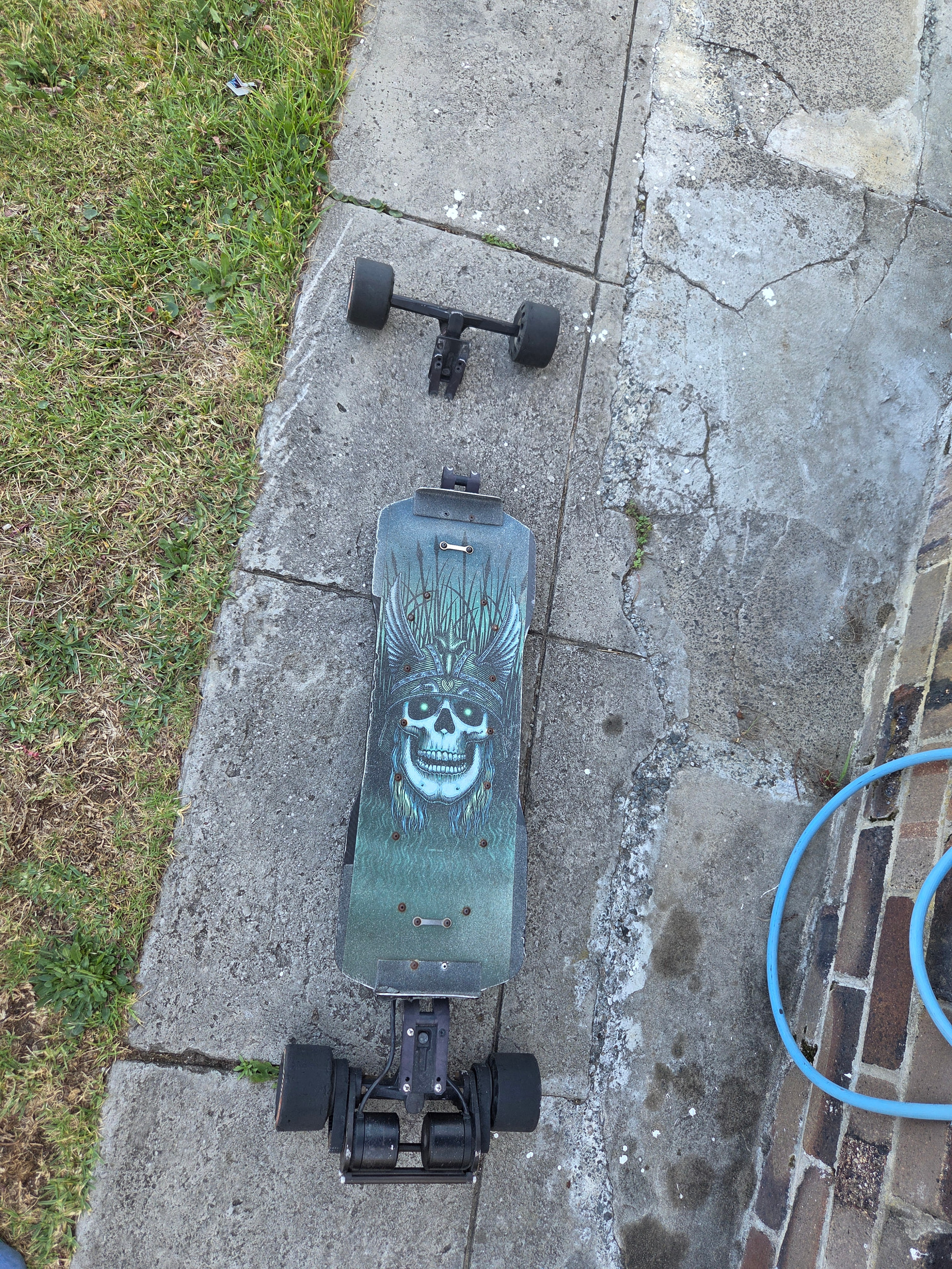

Hey off chance, deck still available?
Yes it is send me a message I can send you pics of it
This beast is the best!! I almost bought it, but I would have to bring it to Brazil and the food cost would be too high.
