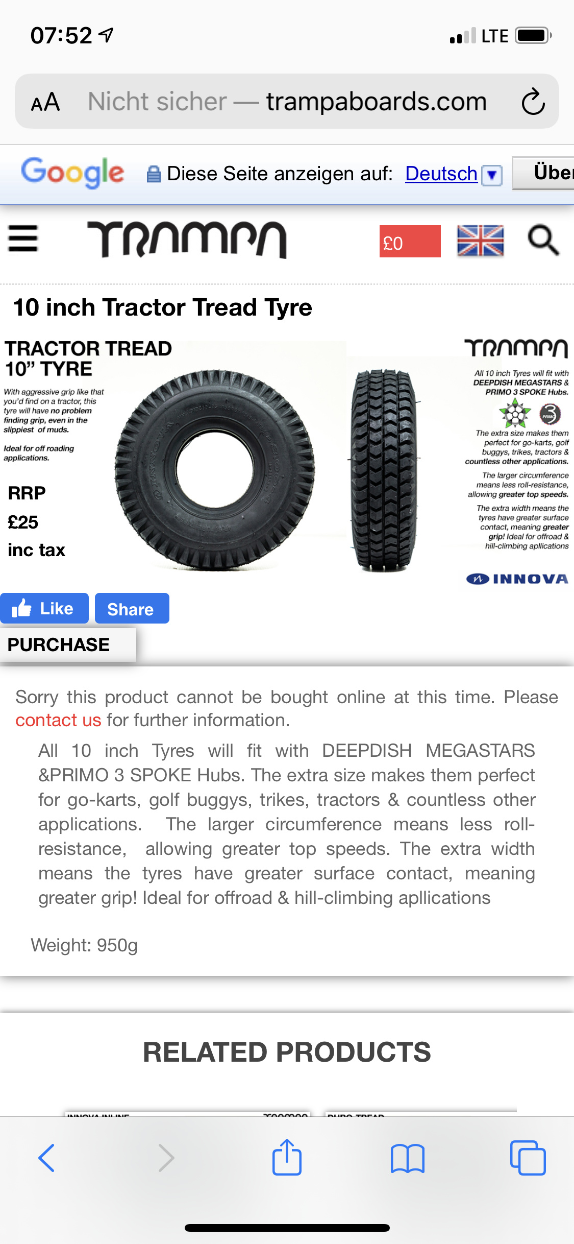

This morning I realized one interesting thing.
I was driving with a custom painted trampa deck for a while -> some month later, trampa offer custom painted decks
I upgraded my quad to 10“ wheels -> some weeks later, trampa sell this
It’s even the same profile :thinking:
I‘m sure it’s just a coincidence, but who knows… maybe I’m the @Trampa trendsetter and even don’t know it by my own :joy:
Are your tyres also made by innova?
You are being watched…

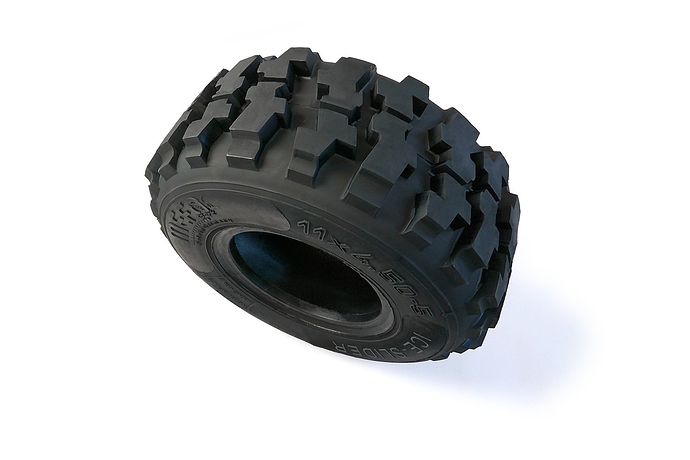

We ride them for quite a while now and thought we offer them as an upgrade. They are not in stock yet, but in production to our specification.

We also designed a new 9" Mud Plugger, which is also in production. Very aggressive profile!

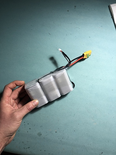

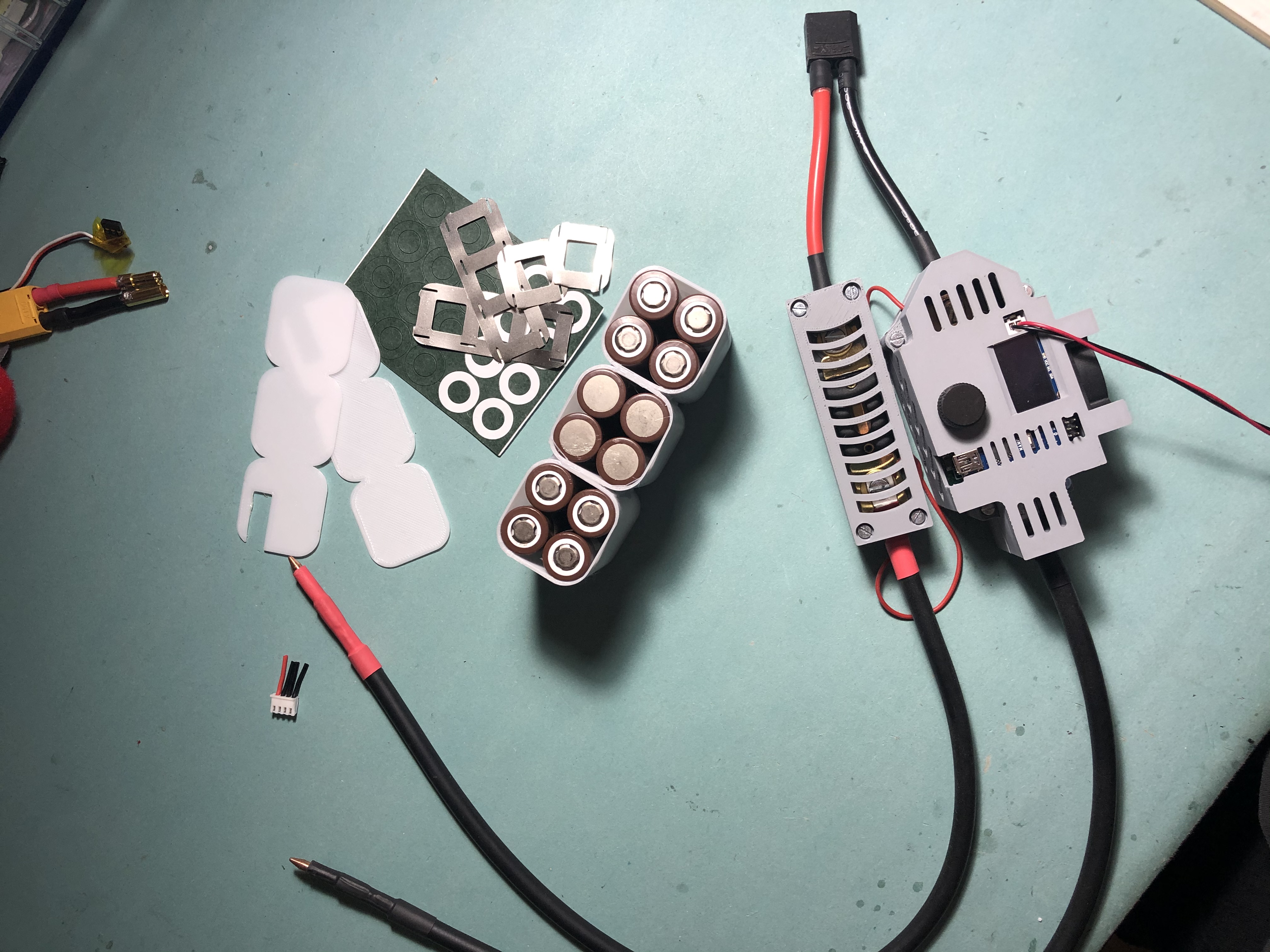

Original plan was to use my 3s 5Ah lipo i use for my spot welder to power the 12V lights and LEDs. All in all the lights need about 8A so about 45min of light with a bit luck which might be enough for deep winter rides, but than I realized I have 12x Chinese fake LG HG2 laying around I don’t really know what to do with.
So I decided to use them to make a 3s4p light power supply pack.
The fishpaper I have currently is kind a shit, so I went with 3D printed cases I glued together.
Terminals got a PETG cover as well
I have a small bms coming as well, but not sure if I will install it.
I will balance charge the pack with my hobby charger and 1.5h of light should be enough to last with the current main battery pack as well.
To be safe I will attach a lipo alarm while operating to not overdischarge accidentally.

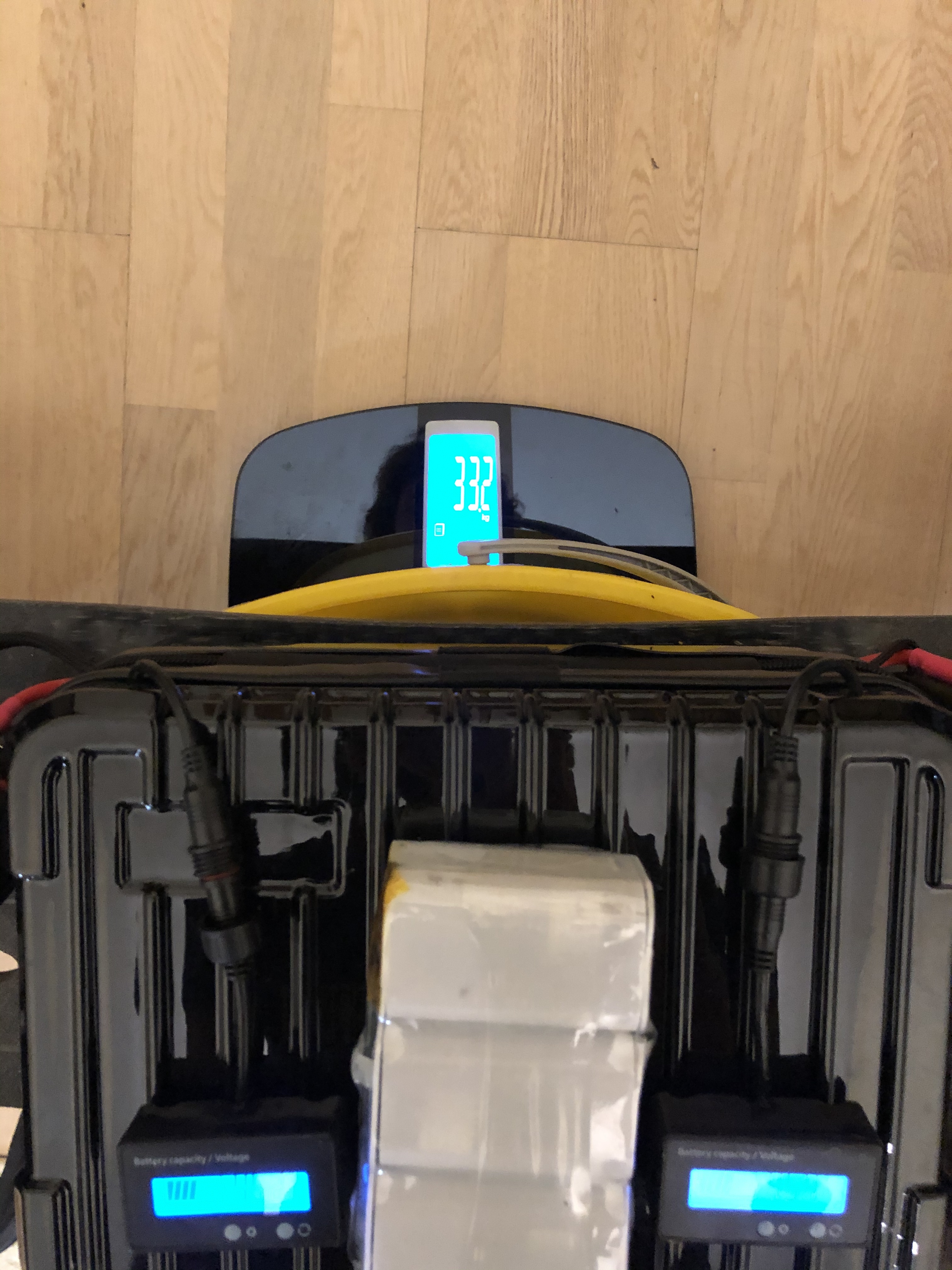

Time to check the final weight…
That’s it 33.2 kg with all batteries attached.
Might add like 500g with the other 10“ wheels I ordered plus spikes for winter.
I’d say, it’s a new record. :joy:
Not sure how I can compete with a baja board weight wise. Think they are around that as well?
Baja G4X = 25kg
Klaus Upgrade equals nearly 32kg.

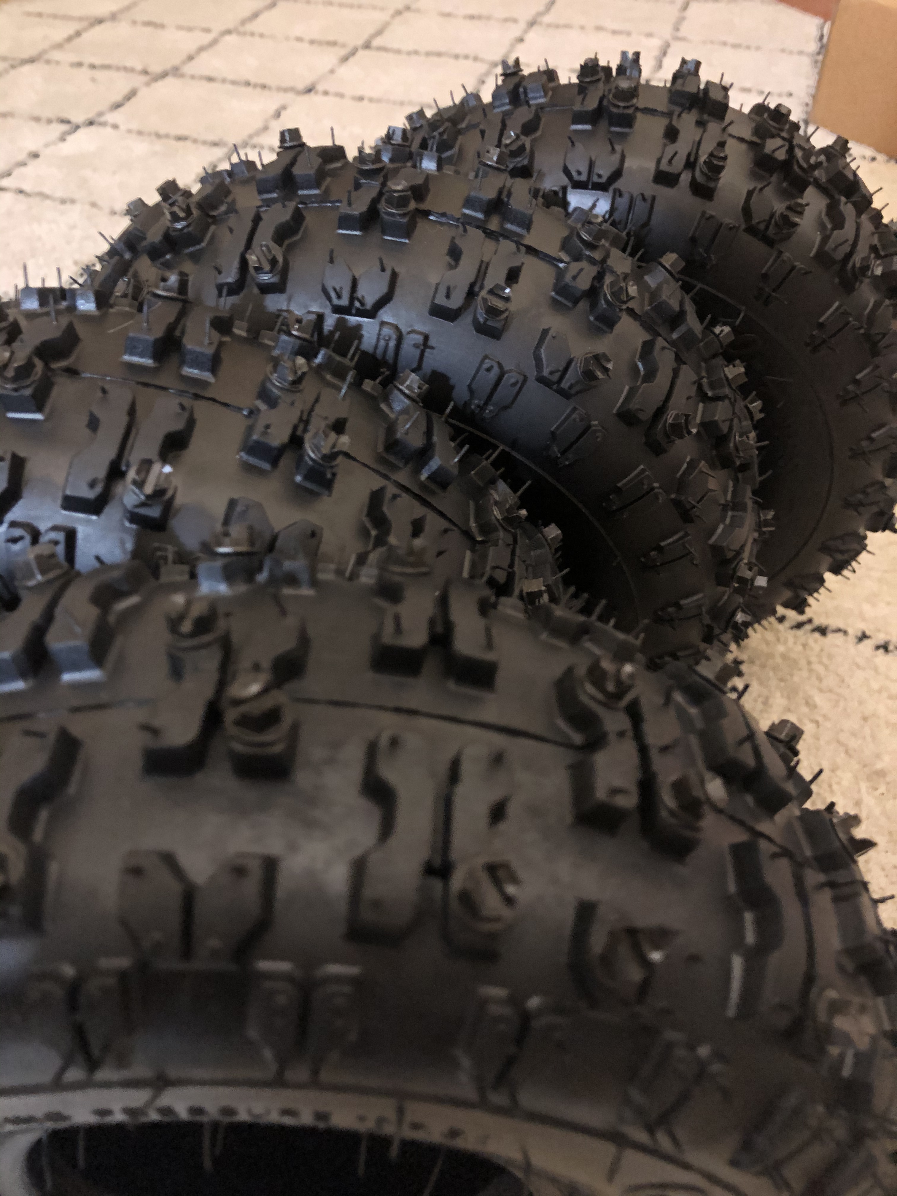

So I got this in today
(Left mbs 9“, right 10“)

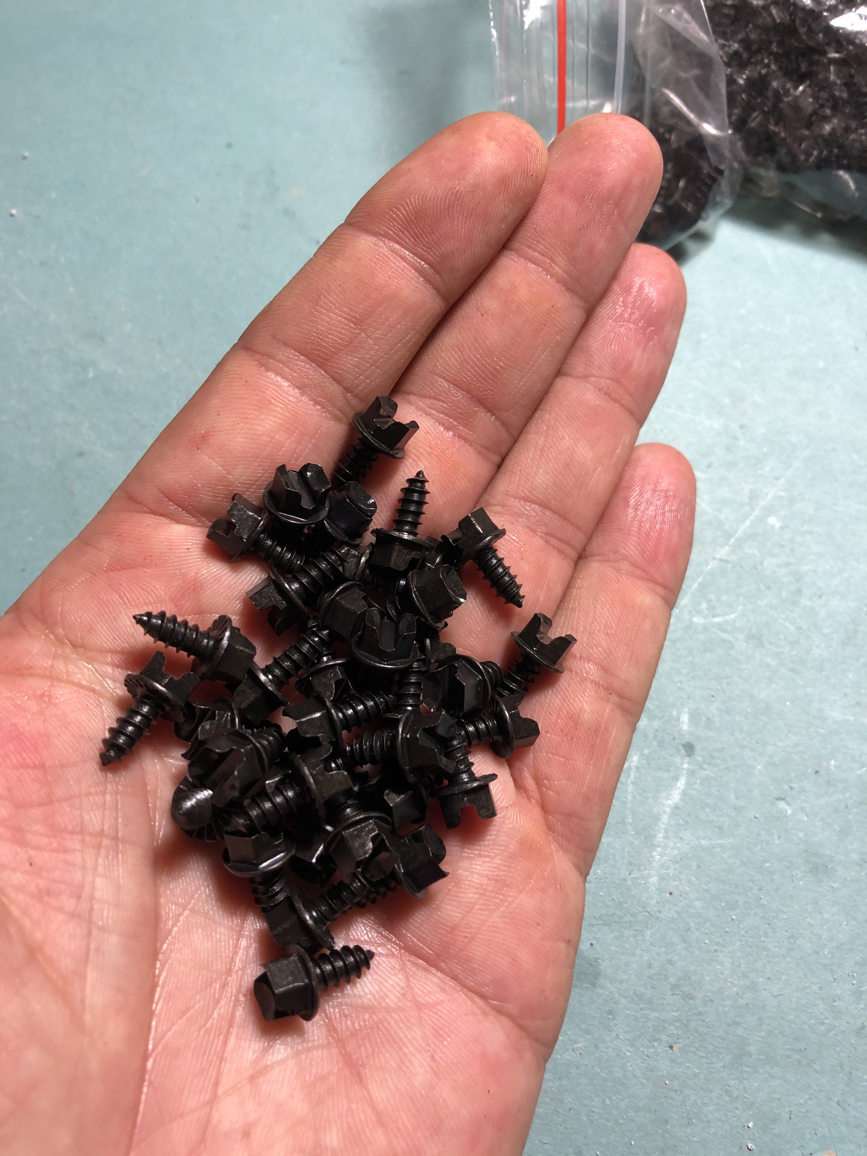

And some of this guys
65x of them in each tire looks like this in the end
Those tires are definitely wider than the other 10“ tires I actually have installed.
Unfortunately they also look not that good quality wise, but for those deep snow ride days it should be more than good.
We will see after the winter how everything turned out.

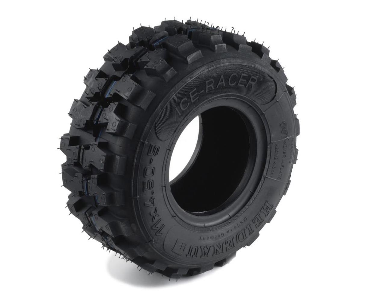

Me and duffman use these 11” go kart winter tires;
Abseloutely beast tires. Might be something to consider if your current 10” tires doesnt hold up.
4" standard hub size I’m guessing? Or better yet a link?
5” Rims
Yeah I was thinking about them as well.
My problem is just that the rims which fit those tires doesn’t fit to my sprockets (don’t have the tools and place to drill out my own sprockets) and I guess even with the etoxx truck extensions it’s not enough space as they seem to be pretty wide.
