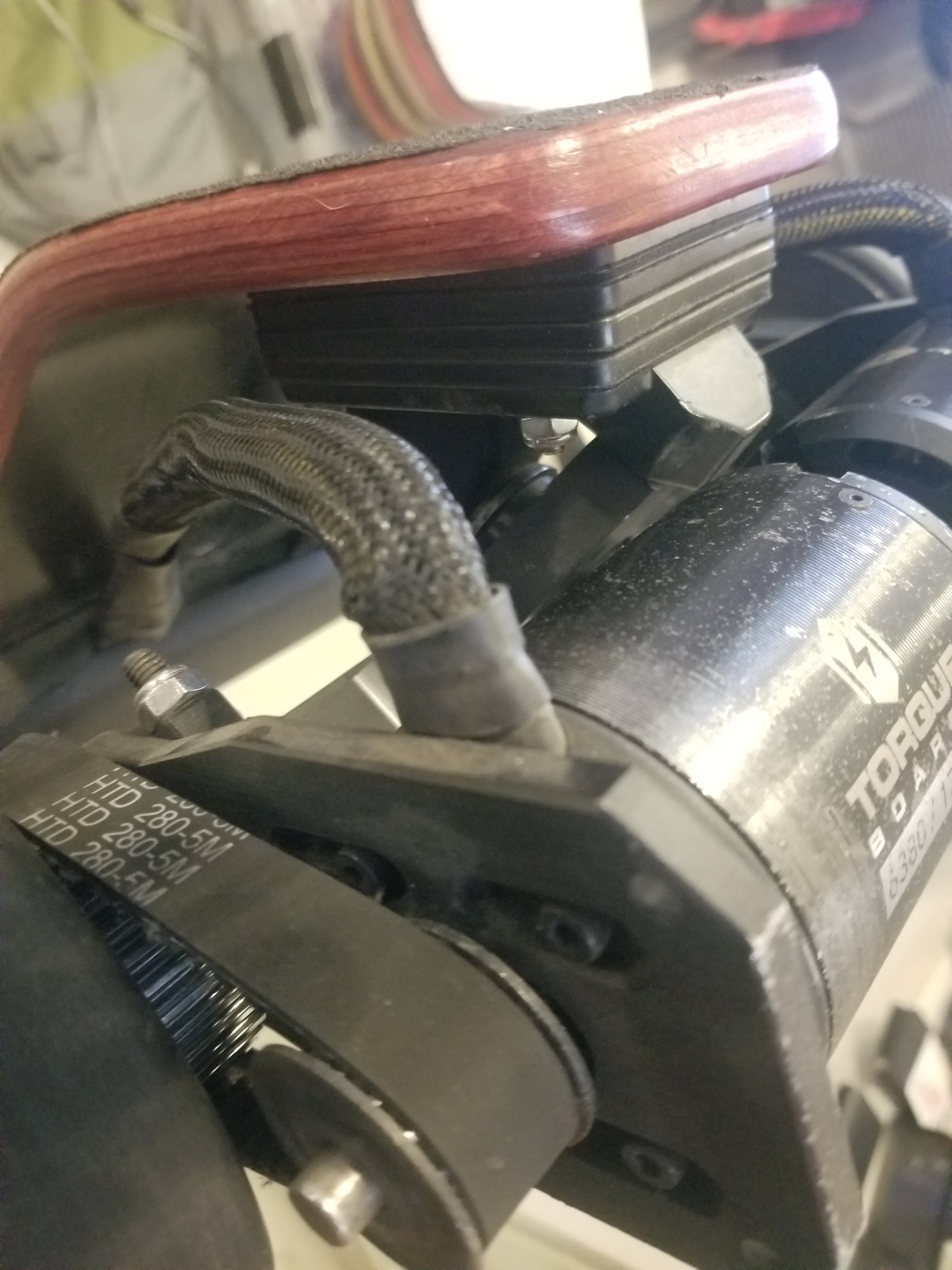

To clarify: The issue comes from lots of vibration + soft materials = ability to move. It’s that simple.
You do not want a major joint like your baseplate to have any wiggle, and putting soft materials in between or adjacent/supporting to that joint will cause them to deteriorate.
The riptide risers I’ve handled were pretty stiff duro IIRC, which is the right choice.
About soft rubber riser pads, I always thought that it also helped avoid the deck to split around the bolt holes.
Anywhoooos… thanks robot man :robot::doughnut:
FINE. You win. :kissing_heart:
Same answer, I don’t recommend using soft spacers on esk8. If you want to soften your ride, put foam under your grip tape or lower your PSI. Adding compliance/movement to your baseplate mounting hardpoints is a no-go over time in a high-vibration environment. You will eventually fail your baseplate bolts.

I have a hard time believing that a rubber riser has any ill effect on a normal 0 degree longboard. I can see the issues coming from using them on these 35 degree mounts though, there’s way more shear forces in the MTB area.
Why does anyone need risers on a pnummie board anyway though
I have bent cheap m5 bolts before with (wood riser or urethane riser, not sure) on RKP.
I imagine Ti bolts and air filled tires would handle the fatigue better but it’s bound to happen eventually especially if there’s more leverage on the bolts due to risers.

Big soft rubber risers make trucks “walk” under power.
They also make almost no difference in comfort.
