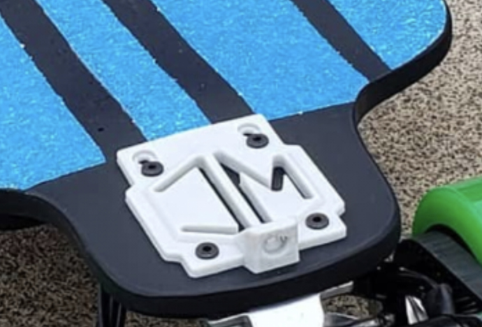

Remember when people were trying to defend this, stupidly?

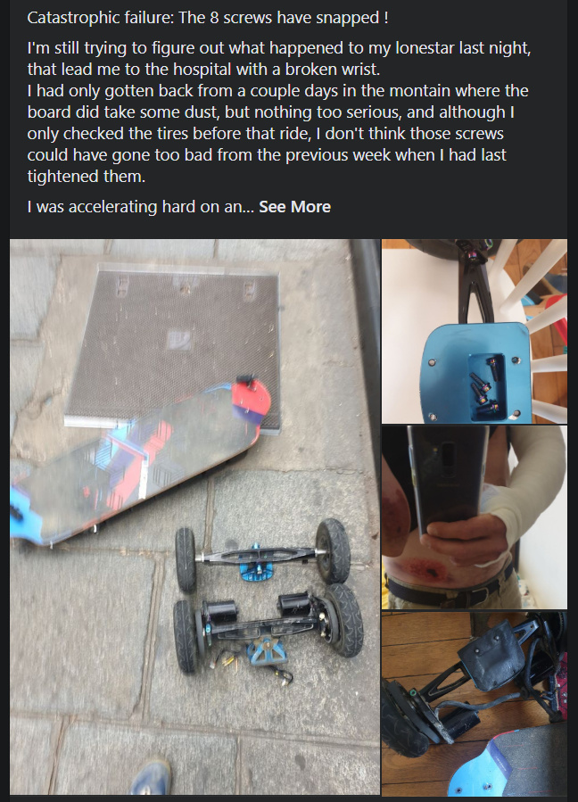

Here’s a great example of exactly why this is a dumb idea:
The user put a soft riser pad in, gave just enough wiggle for vibrations to occur and eventually caused a catastrophic failure. The same exact thing can happen if you put a soft riser pad on top, which is exactly what this is. Also, stupid.
Oof I was about to put a washer on my board’s deck screws, what do you advise instead?
A metal washer is fine- soft plastic or rubber is not, which is what both instances here are doing.
I don’t get it aren’t riser pads commonly made with soft material? What good would it do if it’s too hard?
(softer) Riser pads are made for skateboards, not electric boards that get 1000s of miles and a much greater magnitude of vibration.
Putting a printed riser-plate on top of your trucks is what I would call ‘pants on head retarded’. It places a soft piece of plastic that will undoubtedly disintegrate when a metal bolt that shakes from road vibration is constantly pressed into it. As soon as it gets loose (when, not if), the bolts start to move, and will suffer from fatigue damage from lateral shifting/movement. Snap goes the bolts.

Harder would be better. I’m talking specifically about soft plastics/rubber.
