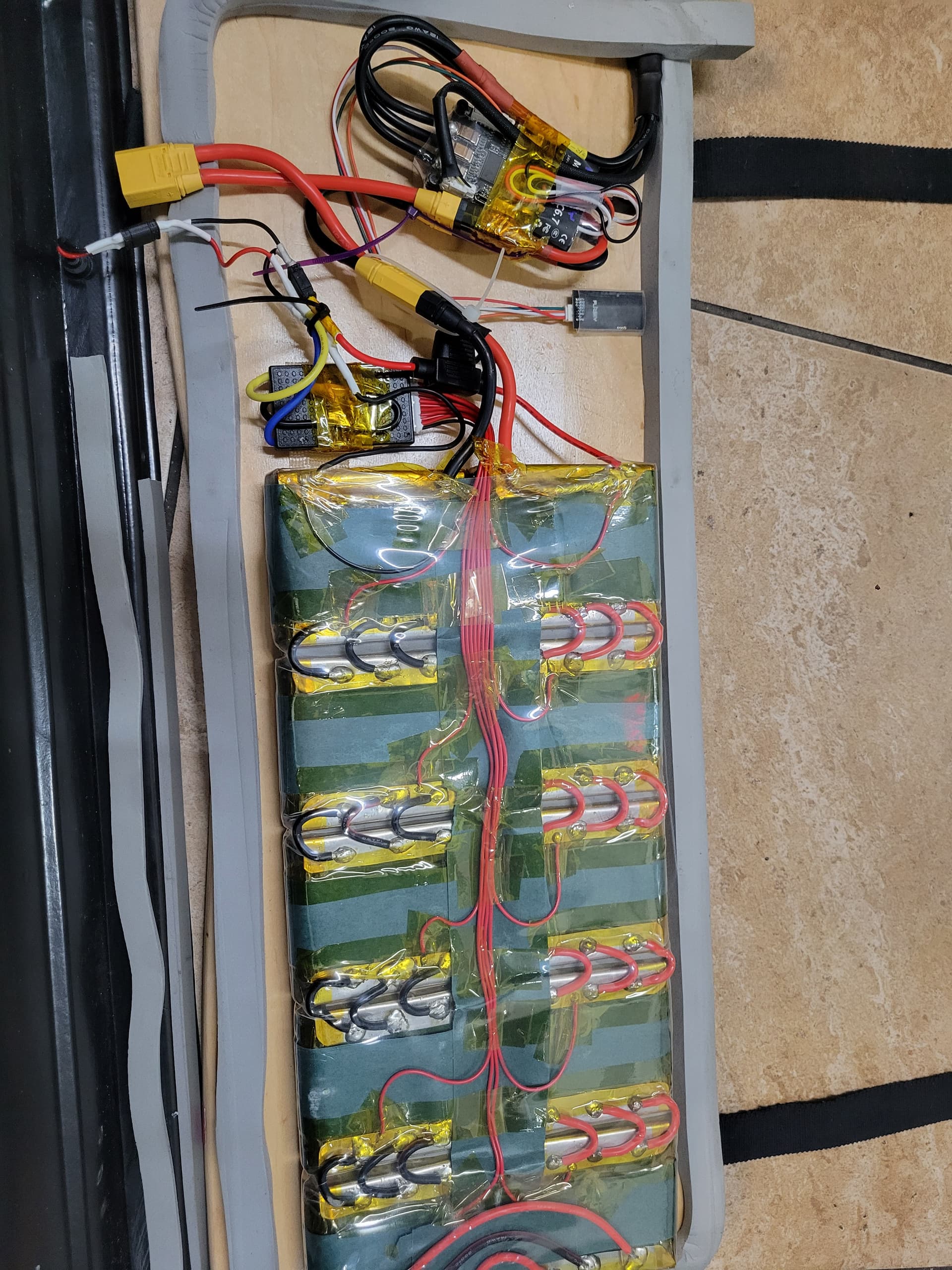

I plan on closing up my enclosure does everything look good? I took it for a few test rides and everything seem great.
Also is there any vesc setting / cool features I should know about?
Maybe a blob of hotglue on that flipsky JST plug.
Looks fine, I’ve done worse
Wouldn’t ride this through the rain though
Definitely don’t take this in any water or puddle. The seal will keep sticks out, but not much else. It’s more expensive to find this out the hard way.
