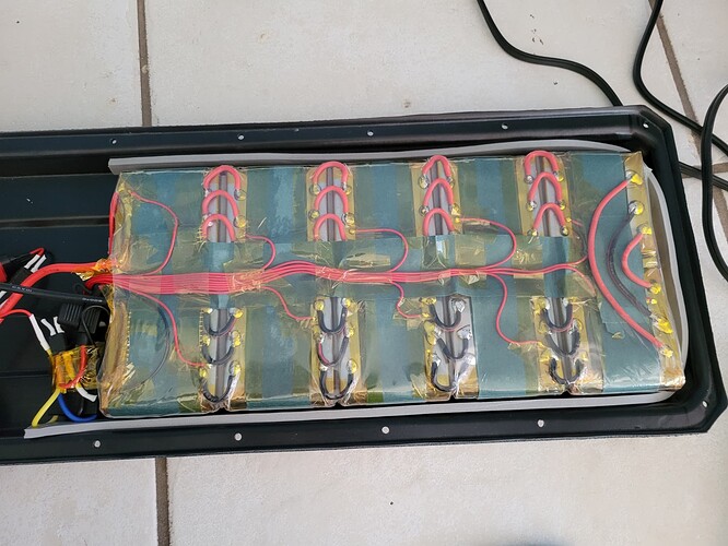

I finished my battery :grin:
Looks pretty
I am thinking about using velcro straps to secure the battery to my deck, where should I put them?
Between the battery and the deck.
Dual lock is some great stuff to secure things down with, it will not move.
I meant to strap around the battery to hold it to a deck.
If you have the space that’s a viable option
That’s what I mean to use it as, it’s for real stuff.
I like the regular velcro, it gives it some play so vibration isn’t transferred into the pack and welds. Dual Lock will transmit more vibration
Fiberglass enclosure with foam for the win; no Velcro :tm: IMHO.
If you have a thin ABS enclosure though, and a heavy battery, then it might not work so well.
