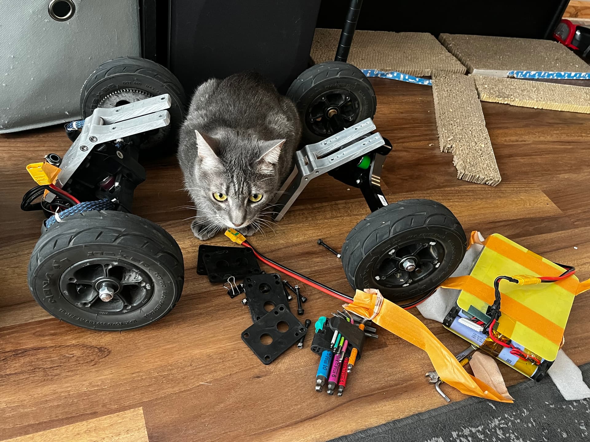

I got an IDEA (brackets)

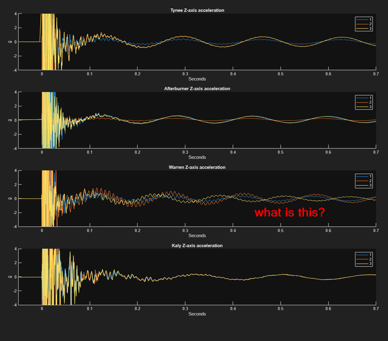

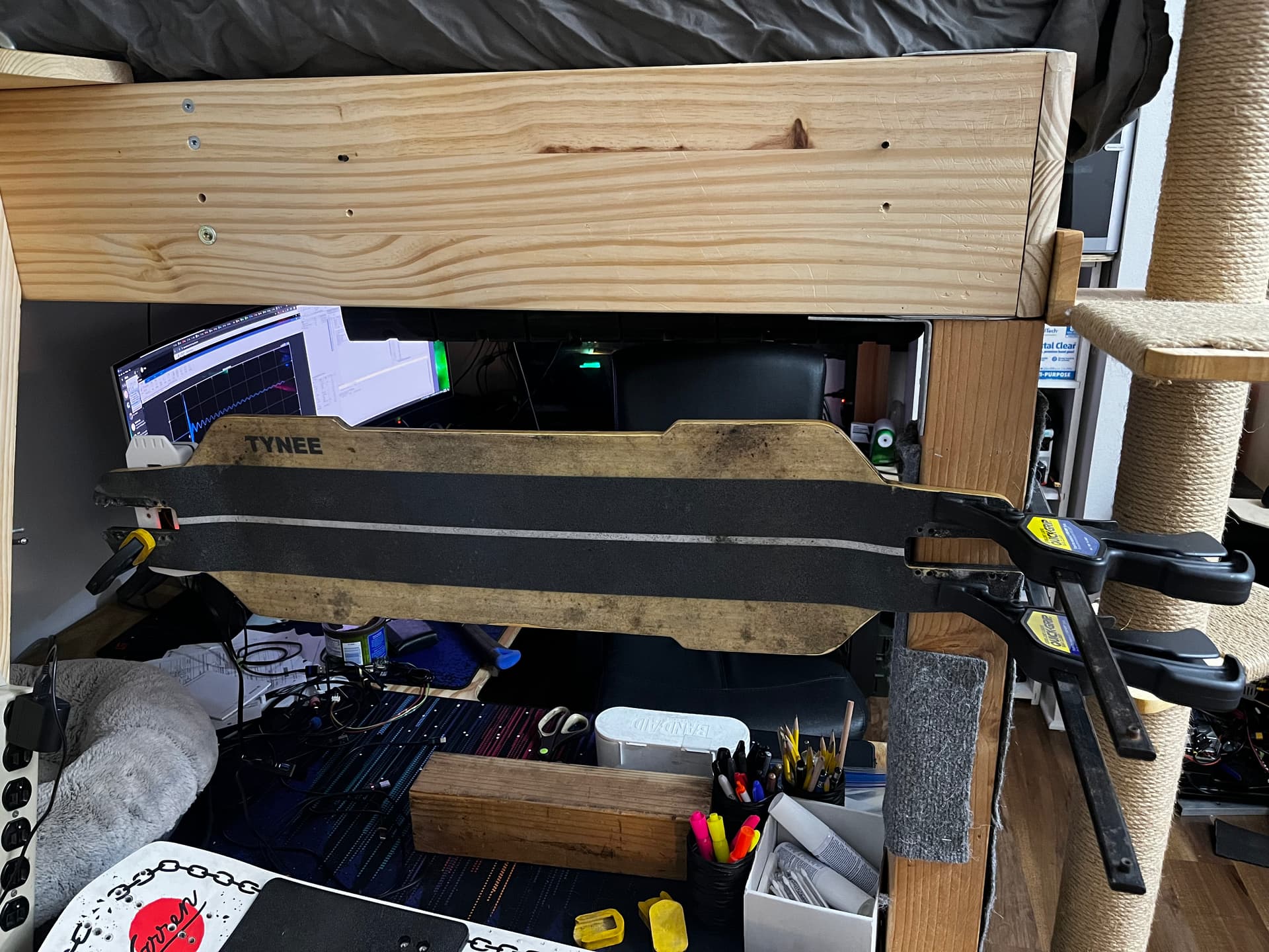

I tried a science.
I clamped each deck to my lofted bed, and an accelerometer onto the end.
then gave them each three highly scientific calibrated thwacks

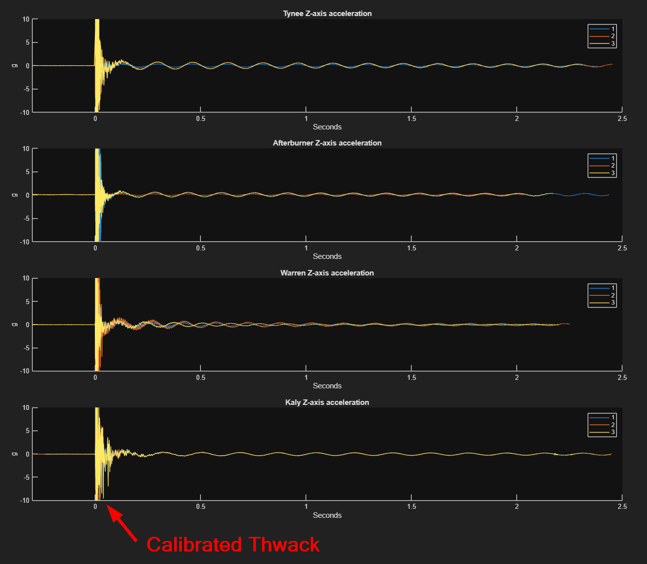

Some Matlab code later, graphs!

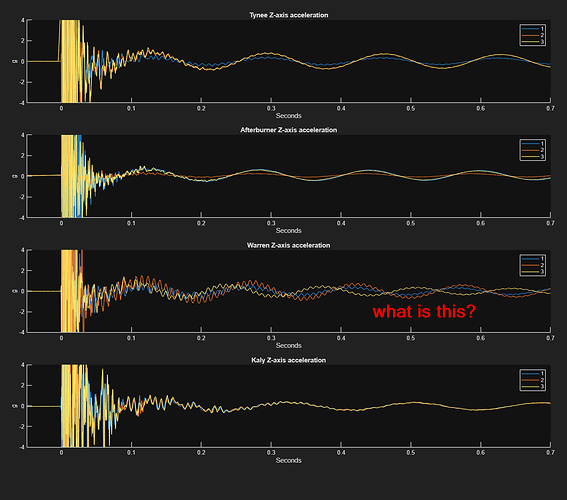

Raw data, the measured accelerations (single axis, ~18 kHz)
halfway through writing this post, I went back and improved my data recording scripts (primarily accelerometer filtering settings) to increase it from ~1kHz :grin:
Thwack at t=0s, then the acceleration decreases as energy dissipates.
  • High-frequency vibration that quickly gets attenuated in <0.2 seconds
  • Low-frequency vibration “primary” frequency is very repeatable
Zooming in, they have secondary frequencies that persist after the initial thwack… especially the warren deck!

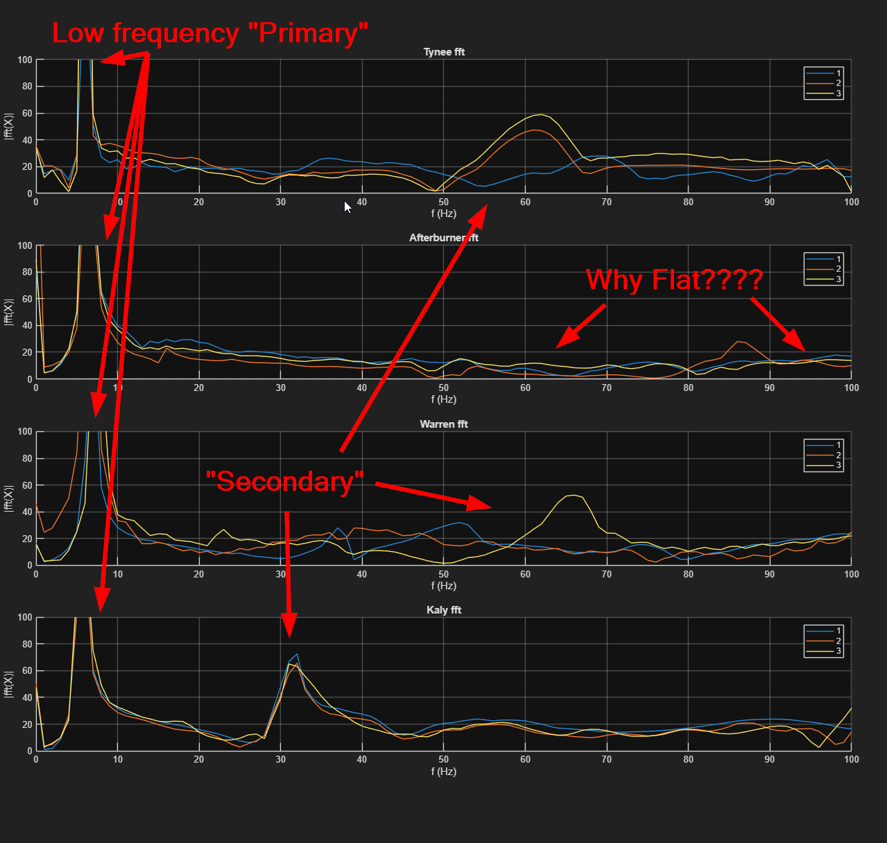

A FFT (Fast Fourier Transform) shows the signals in the “frequency domain”, basically showing us where the deck likes to resonate.
I did this over the first second after the initial whack to capture the high frequency vibrations. I’m not putting importance on the specific frequencies, as I expect that’s mostly a function of deck stiffness and sprung mass. Instead, I’m paying attention to how the decks compare to each other, and if some decks handle vibrational frequencies differently
The afterburner was the least good feeling deck, by far. So the conclusion might be we want these secondary modes of vibration?? idk, doesn’t make sense to me.

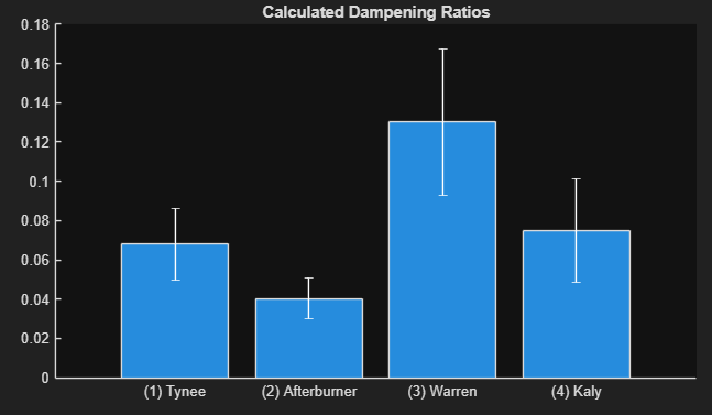

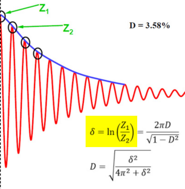

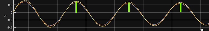

Wrote some code that analyzes the ringdown of the deck, calculating the difference between each successive peak of vibration, then taking the natural log.
This is what came out the other end of 120+ dampening calculations.
This graph lines up precisely with my subjective, qualitative experience on the track. In other words, I’ve found a positive correlation between deck dampening and track feel
Fuck yeah.
If you’re curious, the error bars are the standard deviation of calculated dampened ratios
