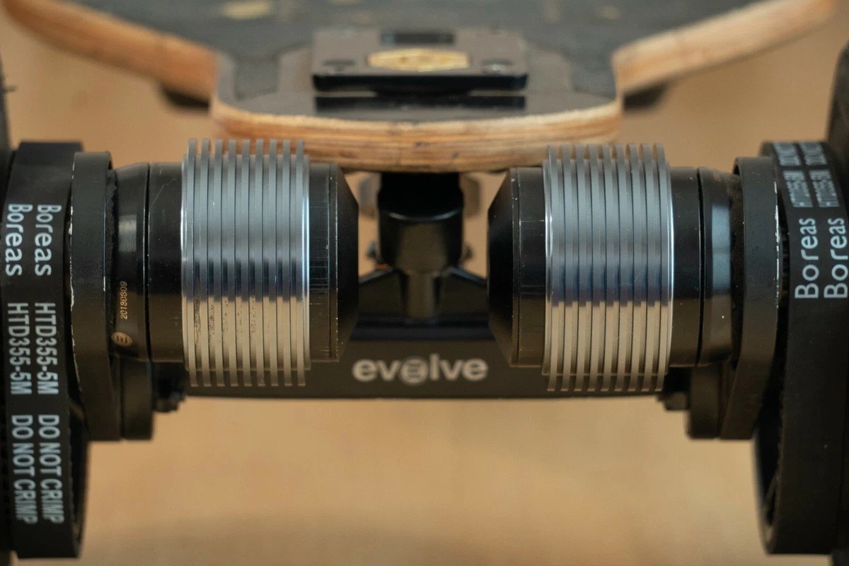

Why only contact 14 points and not the entire can? Like what these do:
That way they wouldn’t be optimized only for 14 pole motors.
HXHD is a heat extractor. What you are showing is a heat sink. The heat sink in the photo will work until it is the same temp as the motor bell. Then it loses efficiency.
The HXHD works continuously conducting and radiating heat.
HXHD fits and functions on any 63mm dia x 60mm length motor. The number of motor poles is usually 7 for this size.
For 64mm motors (reacher) i am working on a modification.
My design is to give the heat a direct exit route. The hot points spread out from above the magnets so thats where the conductive material goes. Also balance, inertia, contact pressure, replacement, manufacturing all come into consideration.
