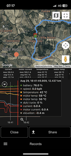

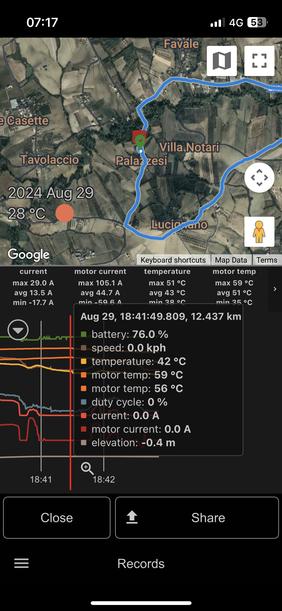

To establish a baseline temperature difference between the motors, start with a run without the HXHD installed. Mid-ride, install the HXHD on one motor and continue. In the logs, separate the graph lines to display individual component stats like the temperature of each motor.
Tap this to open a window displaying all parameters.
Tap a parameter to hide it from the graph. Tap the arrow to split the graph and display each recorded side separately.
Thats almost what i did. The time stamps show one hour of cooling between each run, and the temps are actually warmer when starting with HXHD in both cases.
One motor on, one off is not the right way because my temps often vary between motors. I ride heavy on the toe side so that motor works harder is always warmer.
