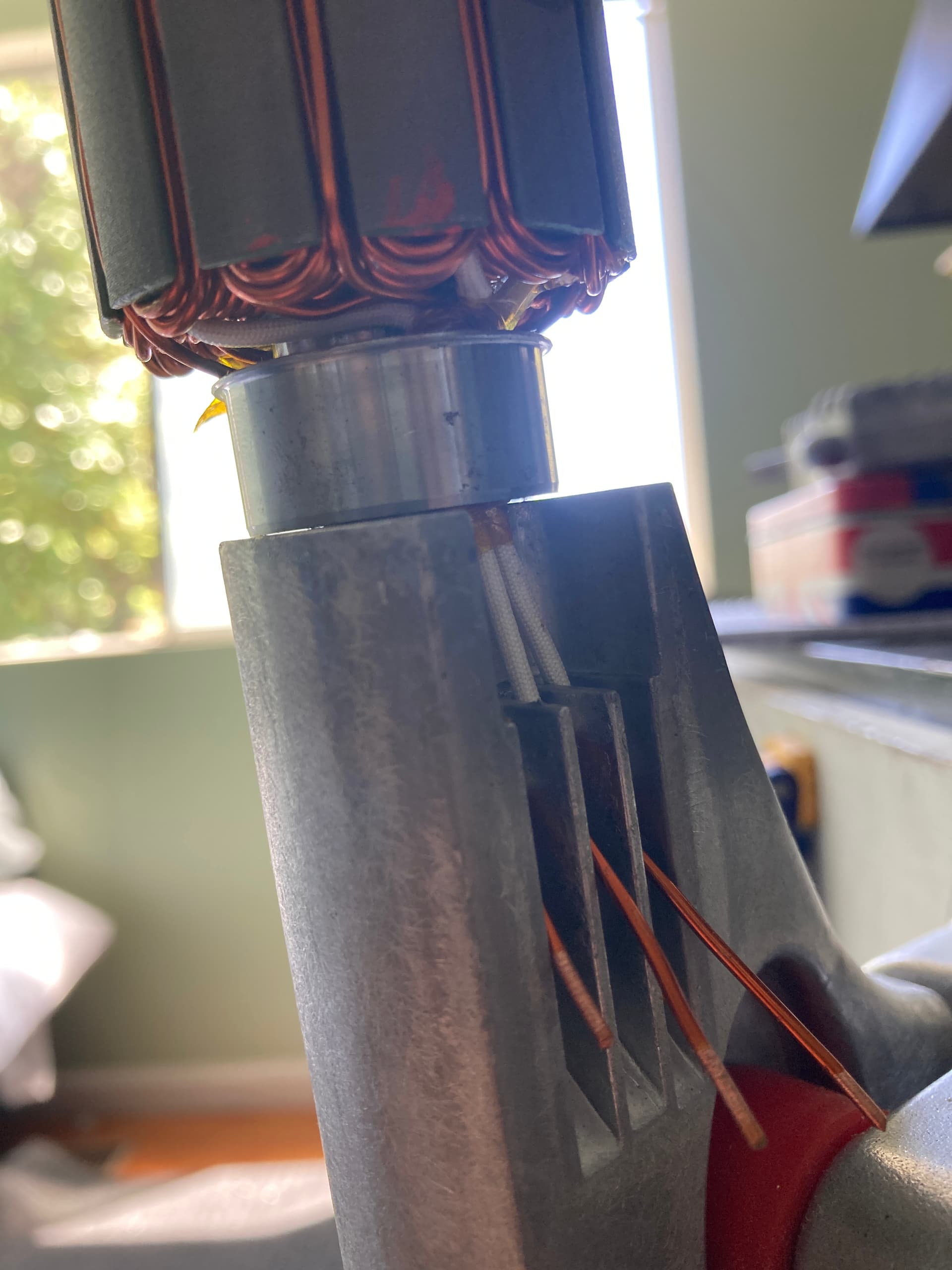

these two faces aren’t flush. I think its worth casting some low-melt temp indium metal and making a thin wedge to go between or even a bunch of machined aluminum shims. I wonder how it effects the strength as it is now without the larger aluminum face leveraging. It’s 11mm splined rod from Grob. I don’t think when cast in the hanger it gets hot enough to soften the steel hardness. The axles are perfectly straight as far as I can tell
As it is now it still is a boss or whatever with the inner steel circle they added to the ends of the axle. I’ve seen good results with transferring heat through big hangers made for the enertion hubs long ago and worth making that shim maybe for strength and definitely for heat.

Could you add a piece of super thin thermal pad?
Maybe that’s good enough. The circle around the axle still is a solid face on face. Probably strong enough but I wonder.
If you desired those faces be super close why not machine them flat together?
There’s the axle in the way.
can be machined with a lathe if you really need them to be flushed.
It’s a splined rod
doesn´t matter :slight_smile: well you can´t go all the way down to the splines. but that can be cleaned up with other tools
the idea of cleaning it up with other tools getting inside all those grooves… sounds very time consuming if possible and it’s a steel insert on the end
Bore out the opposite side a tiny bit. The stator side. That way you don’t have to clean up the splines.
