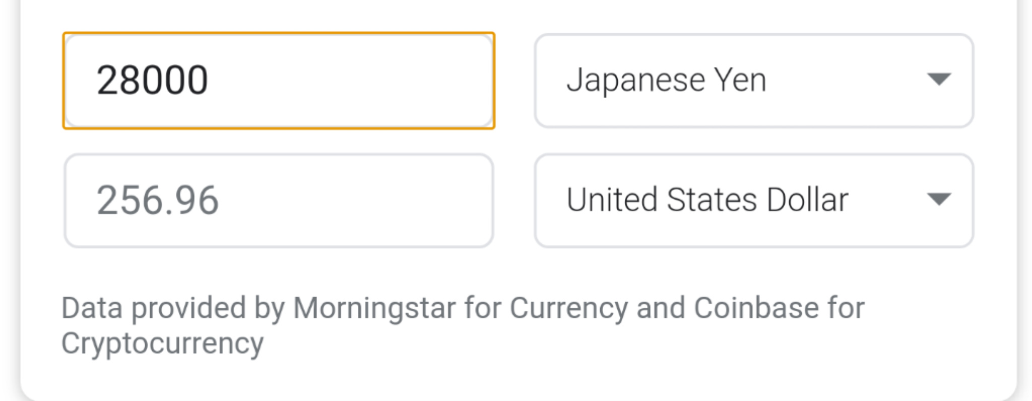

Thanks for the price @sesat. so 2000 bucks for the bearings for a complete board.
strangely if the bearing is literally three times as big it costs as much as the skate 608 size. As if theyre trying to get ahold of that super rich skater who has to have it all.
