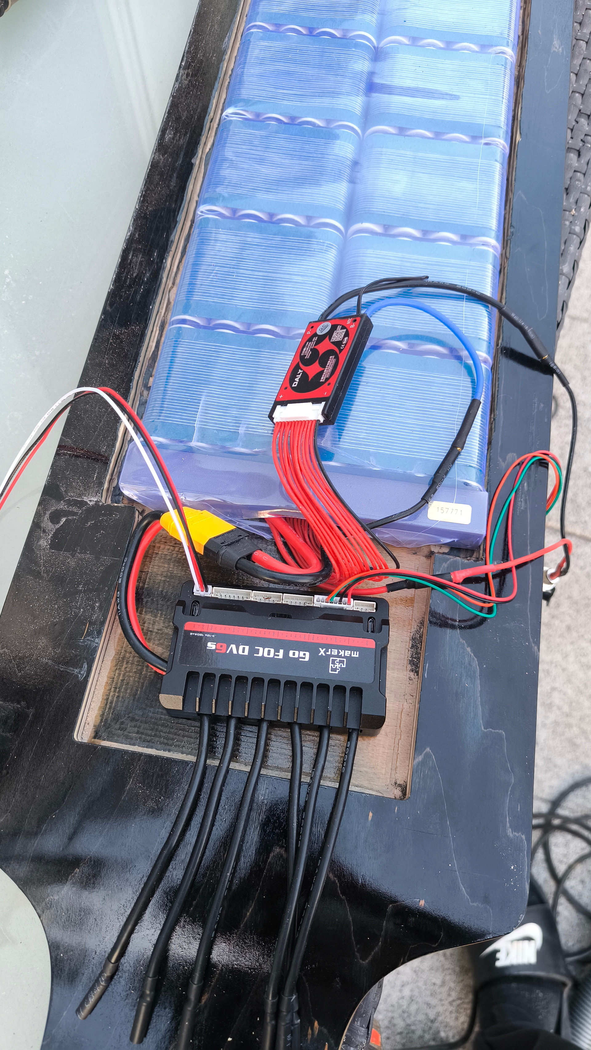

Hey Guys,
I’m starting this thread and my build, BC there’s a lack of people posting their Hummie builds.
It’s my First full DIY build so feel free to raise concerns of you See them.
Setup:
Hummie Hubs 2WD
Hummie Deck
MakerX DV6S

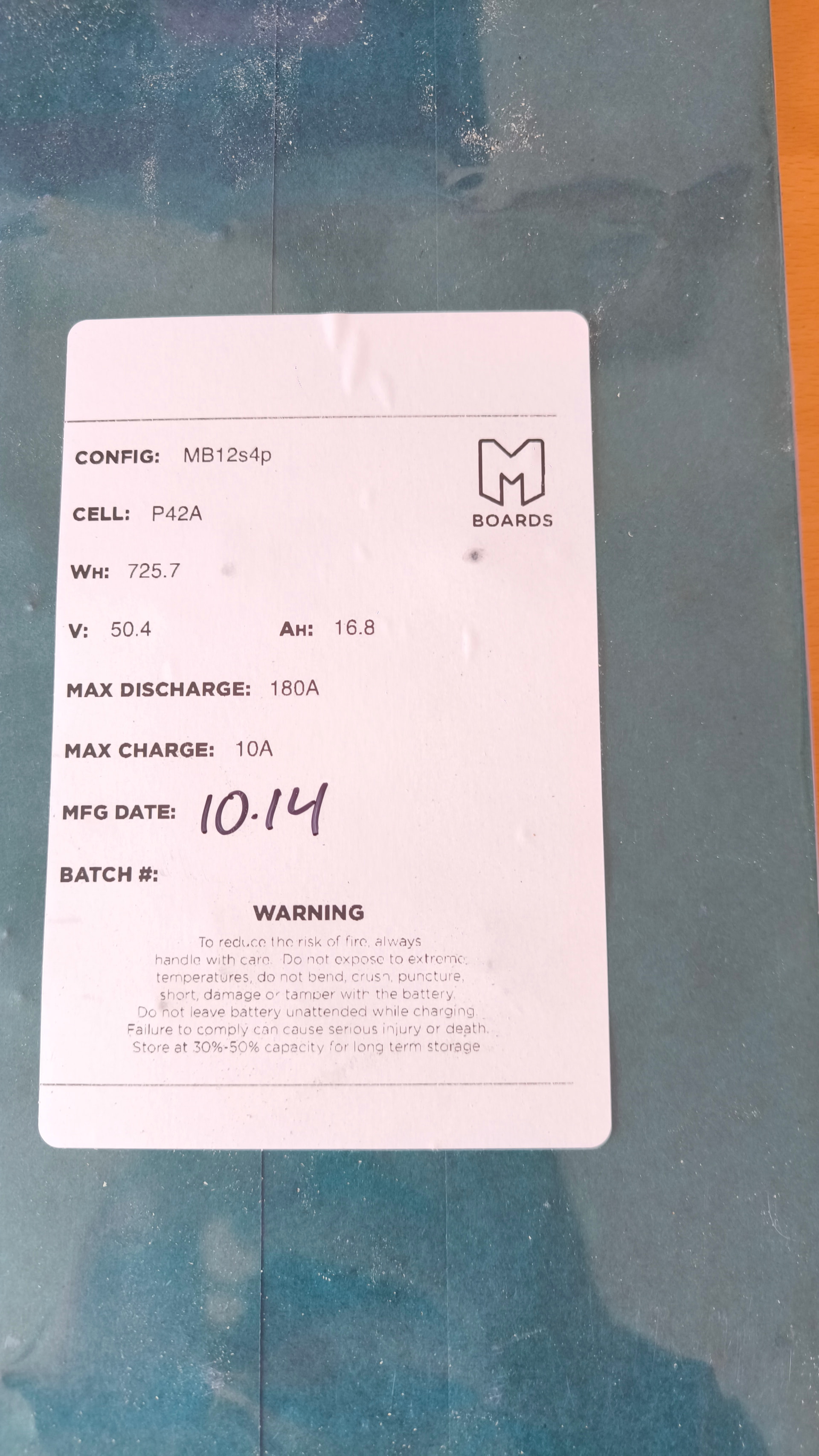

MBoards P42A 12S4P Battery+BMS
Flipsky VX4 Remote
Interstellar 2.0 enclosure (might use it for my MaxfindFF Street on Hummie Deck Deck Switch BC of Clearance with the Hummie Hubs) mounted with sunk Threads (Glued with epoxy 2C)
Might Just carve Out more space on the Deck to fully fit the Battery and build a simple Aluminium Cover.
Pictures will follow once i unpacked everything.
Wish me Luck and let me know what you think

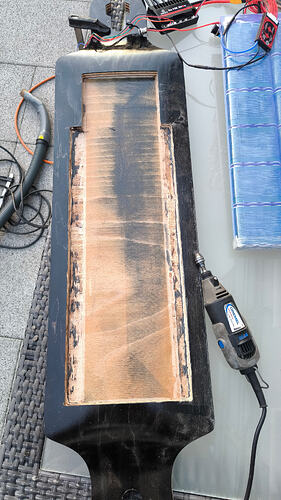

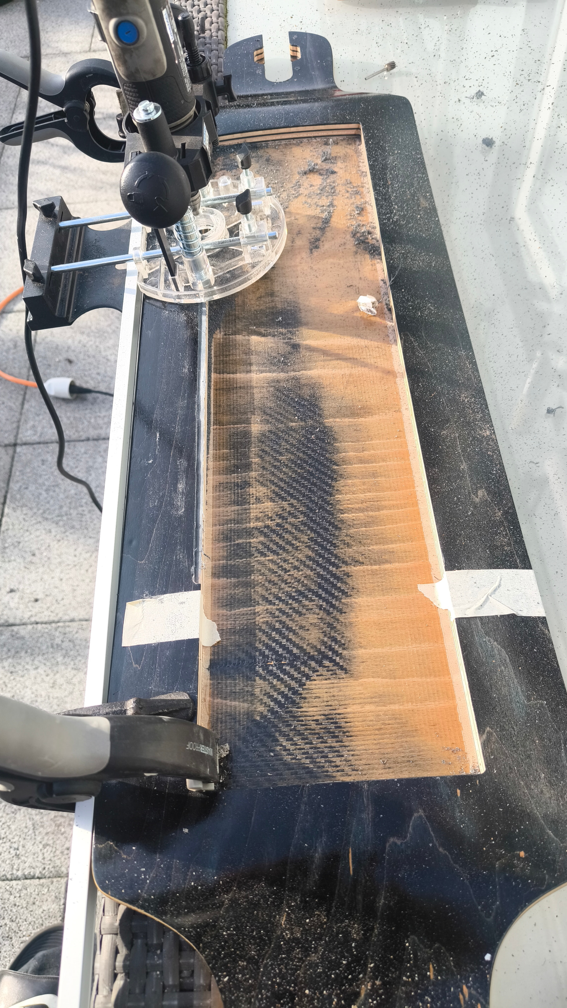

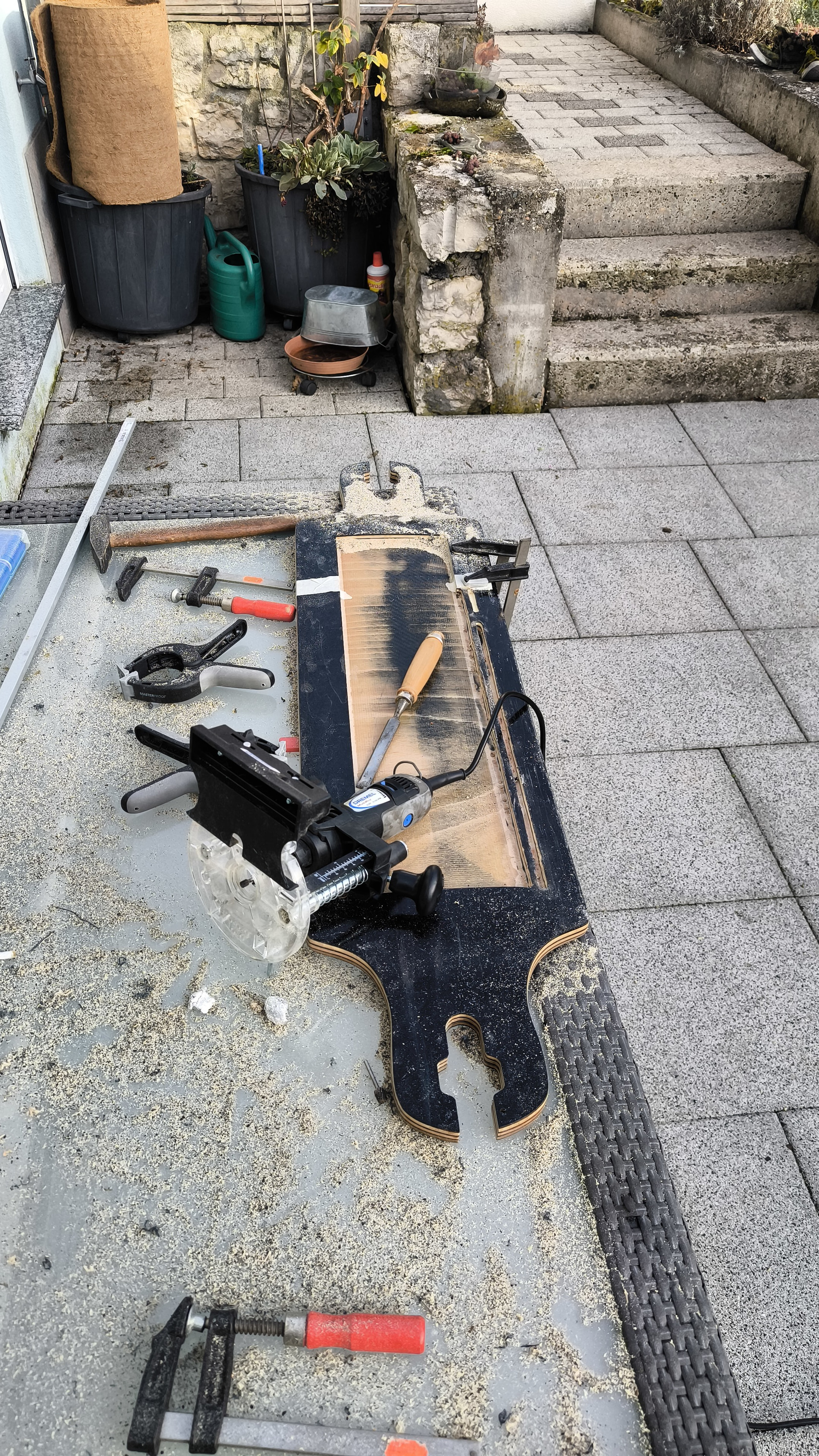

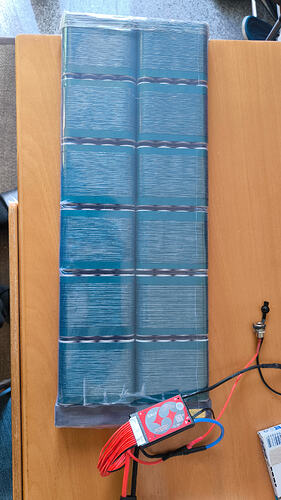

So rn I’m routing the Battery compartment bigger to fit my 12s4p.
Routing skills are Not really existent but i Put the cause on the tool.

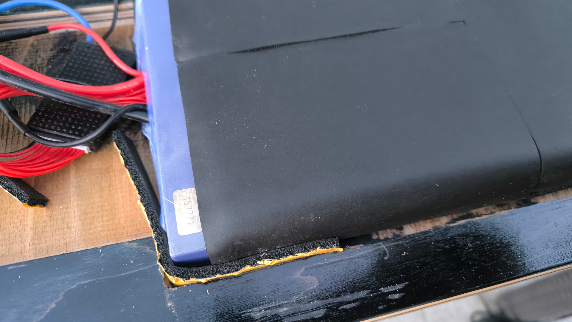

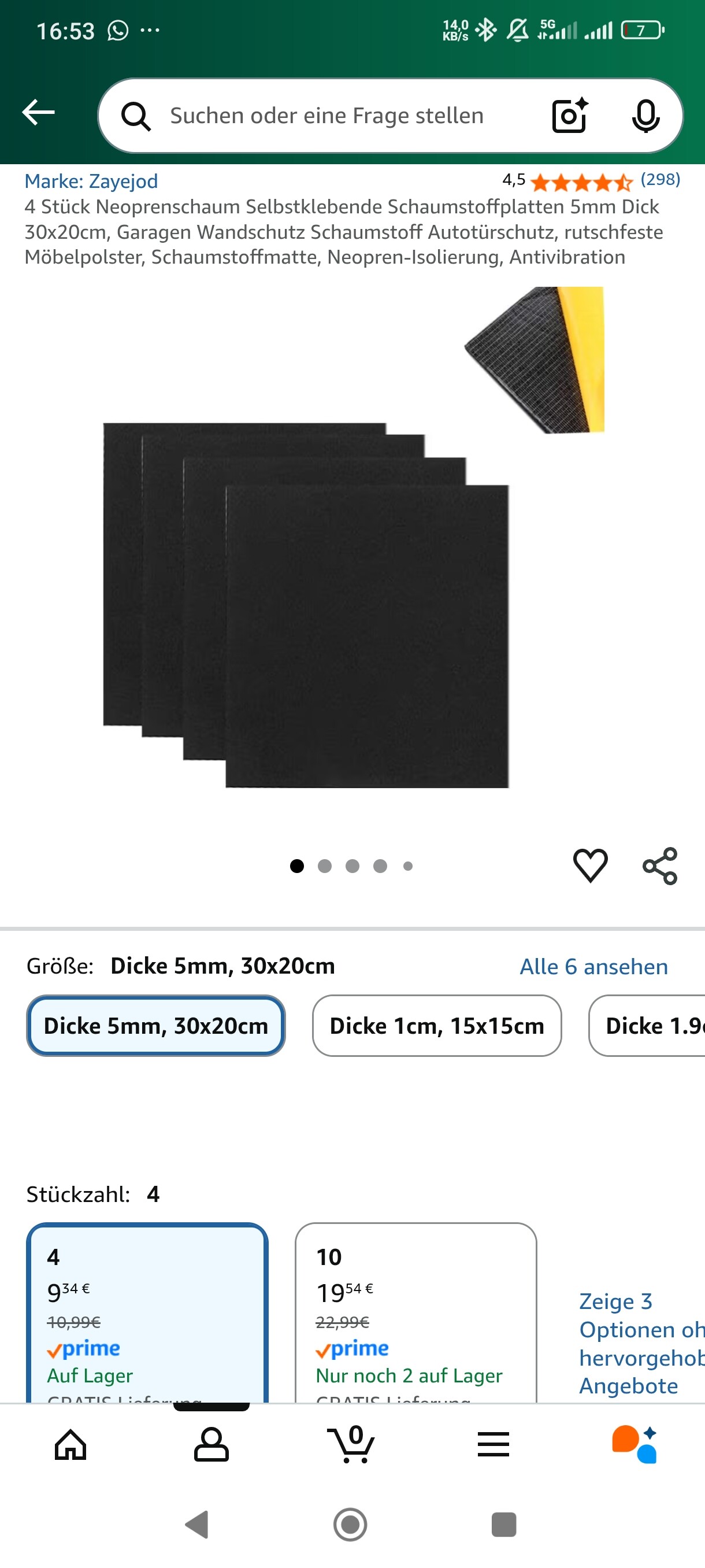

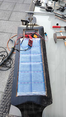

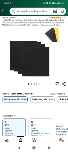

Battery is covered in shockabsorbent self adhesive sheets, i was thinking If it might cause overheating but i thought ill Monitor and should be fine. Raise concerns of you have any.
Also using them for fitting Out the gaps i created with Bad Router skills
first fit
Your routing turned out much better than I was expecting, great job!
Only took half day xD

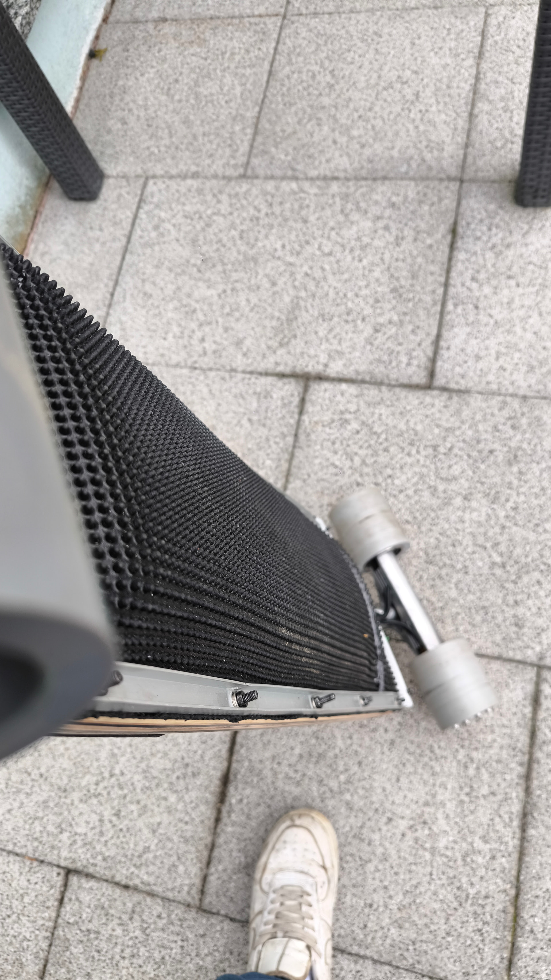

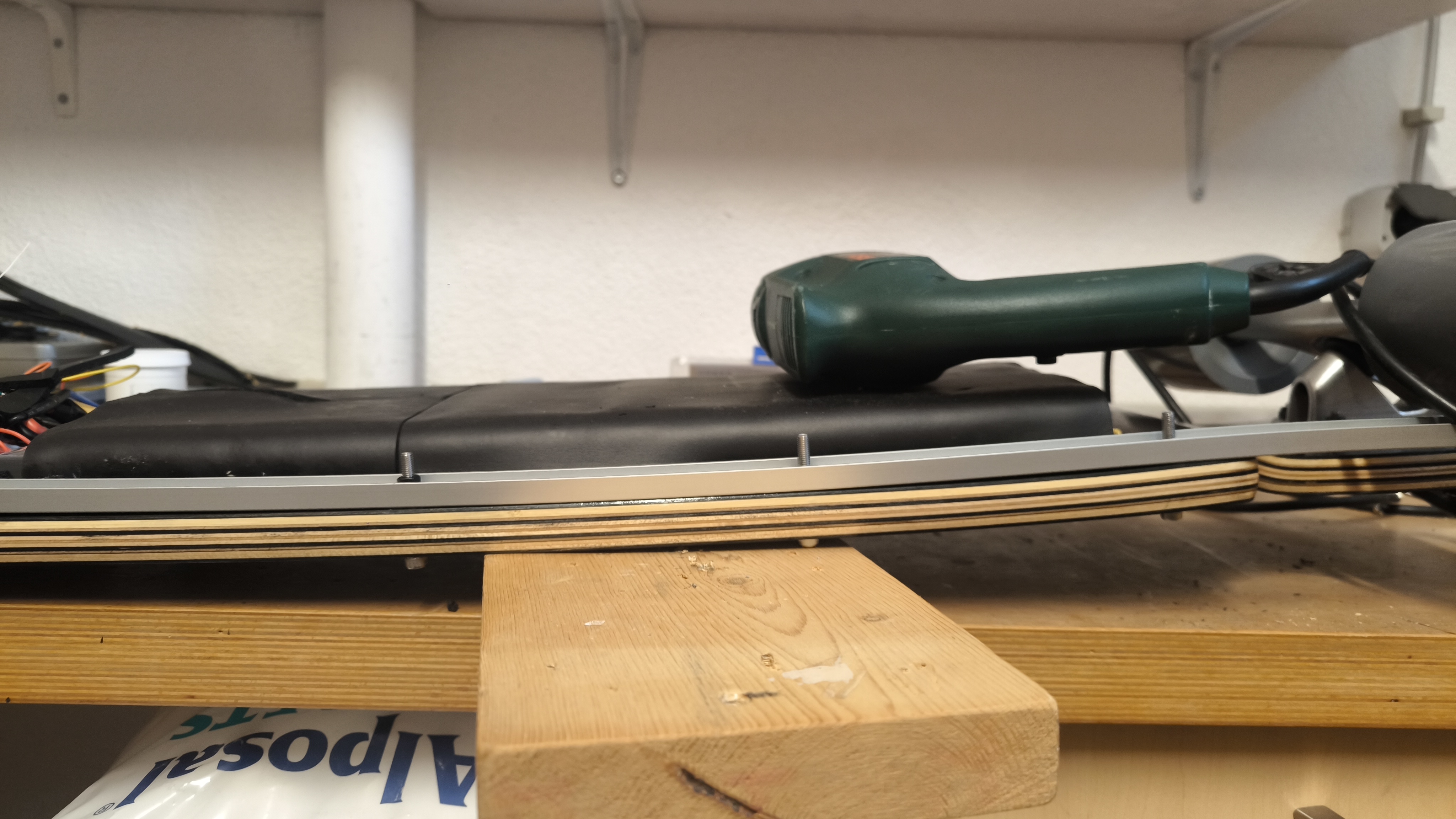

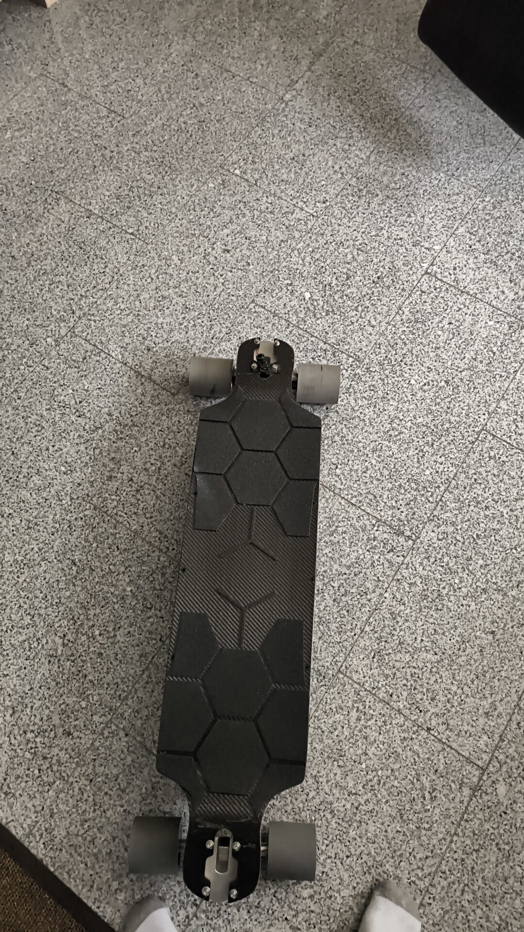

Since the build is on a tight Budget and i’m unemployed, the battery enclosure ist a diy Out of a thick rubber mat, which will BE Held together by Aluminium frames.
Long Term Plan ist to try Out fiberglass to build the final enclosure, but for now this is it.
cost
4,99€ Rubbermat
2,49 Aluminium profile
Im Not worried to much about impacts, since the rubber mat got those “sexy” knobs. Hopefully the pressure from the Aluminium profiles ist enough to Seal the space water tight

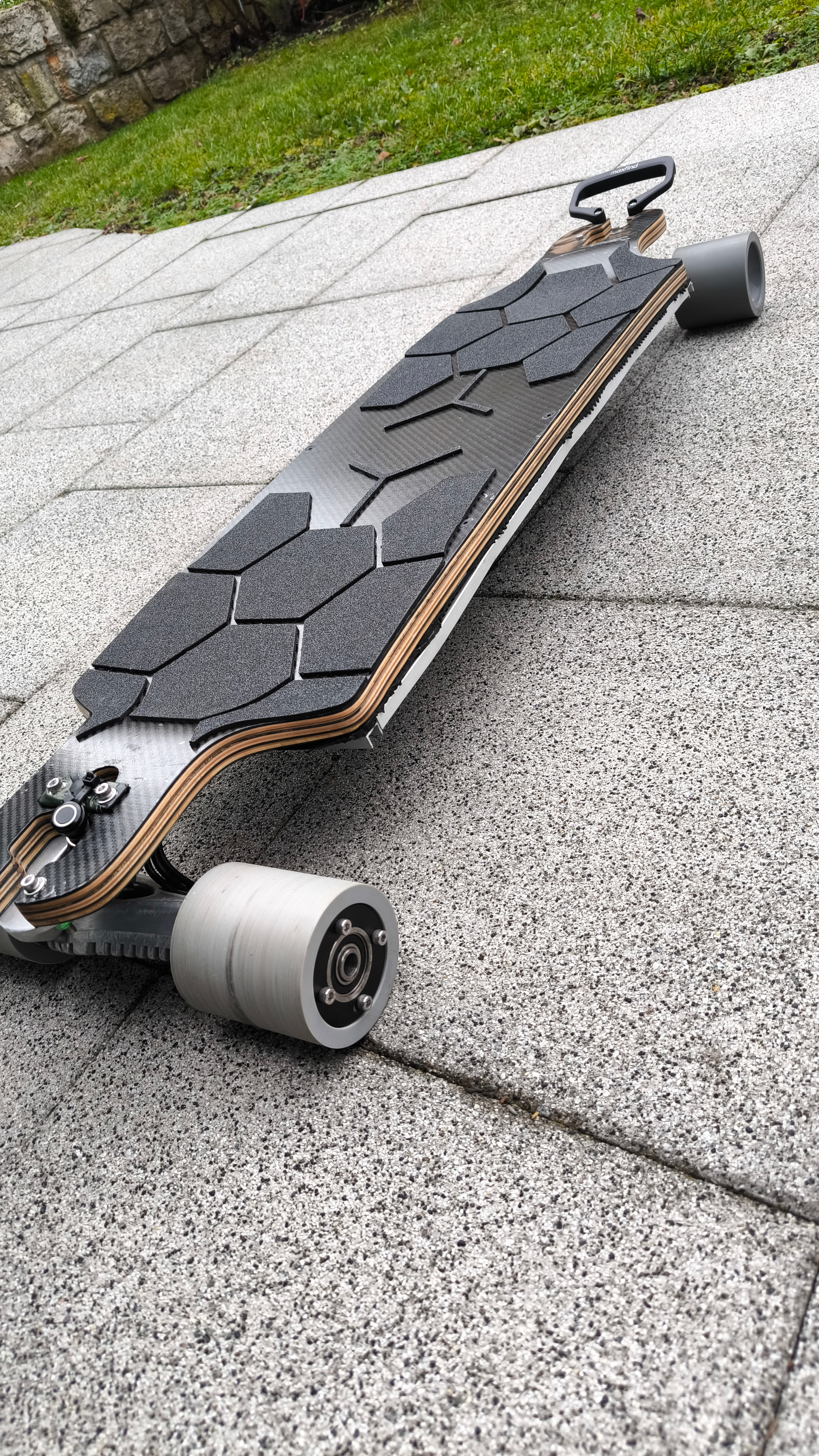

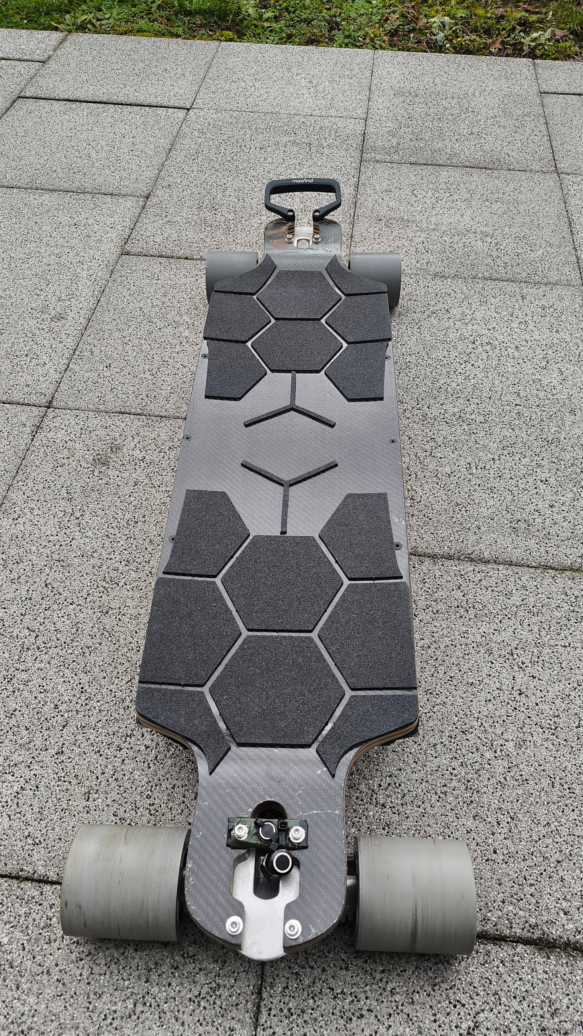

It’s finished for now.
First Test Drive was amazing but also pretty scary, the hummies got enough Power to Go into Burnout Mode once i Hit the Gas a little bit too hard. Even with 30kmh. Good fun tho!

Nice choice of components for a first DIY. Main concern would be battery clearance and enclosure strength with hub motors have you checked flex under load and heat dissipation, especially if you carve the deck and run an aluminum cover?

It’s full on Winter here, so i didnt do real driving / carving. Battery Clearance is about 60-70mm, If only Sticks about about 1cm over the Deck.
