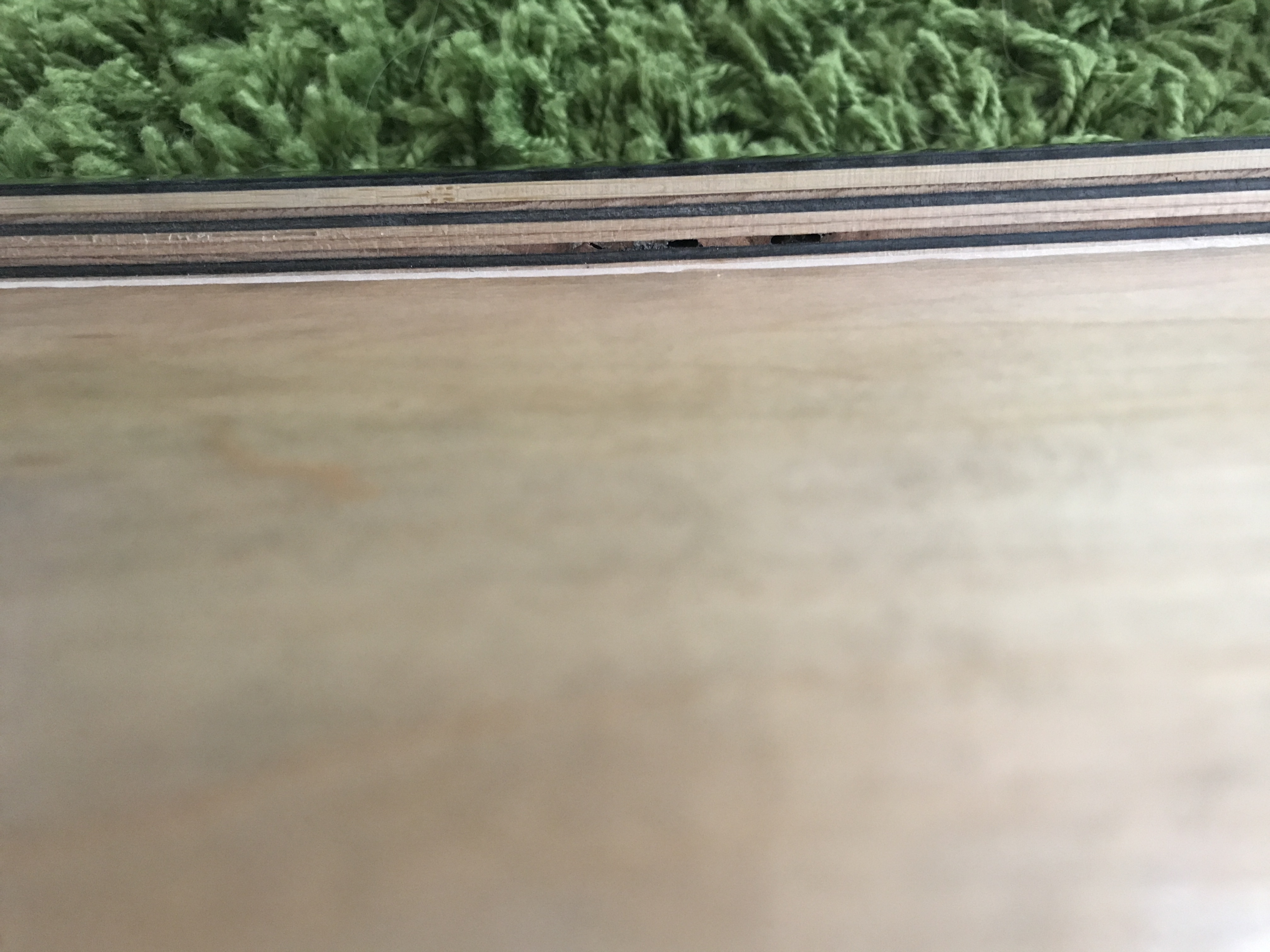

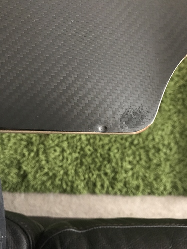

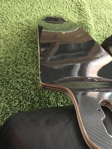

So is this classed as a blem or perfect deck @hummieee ?
I first thought it was sanding at first but it follows the patten of the fabrics not the curve of the deck Also there’s a 4mm deep dent in the resin in opasit corners I can only presume from stacking wet in construction

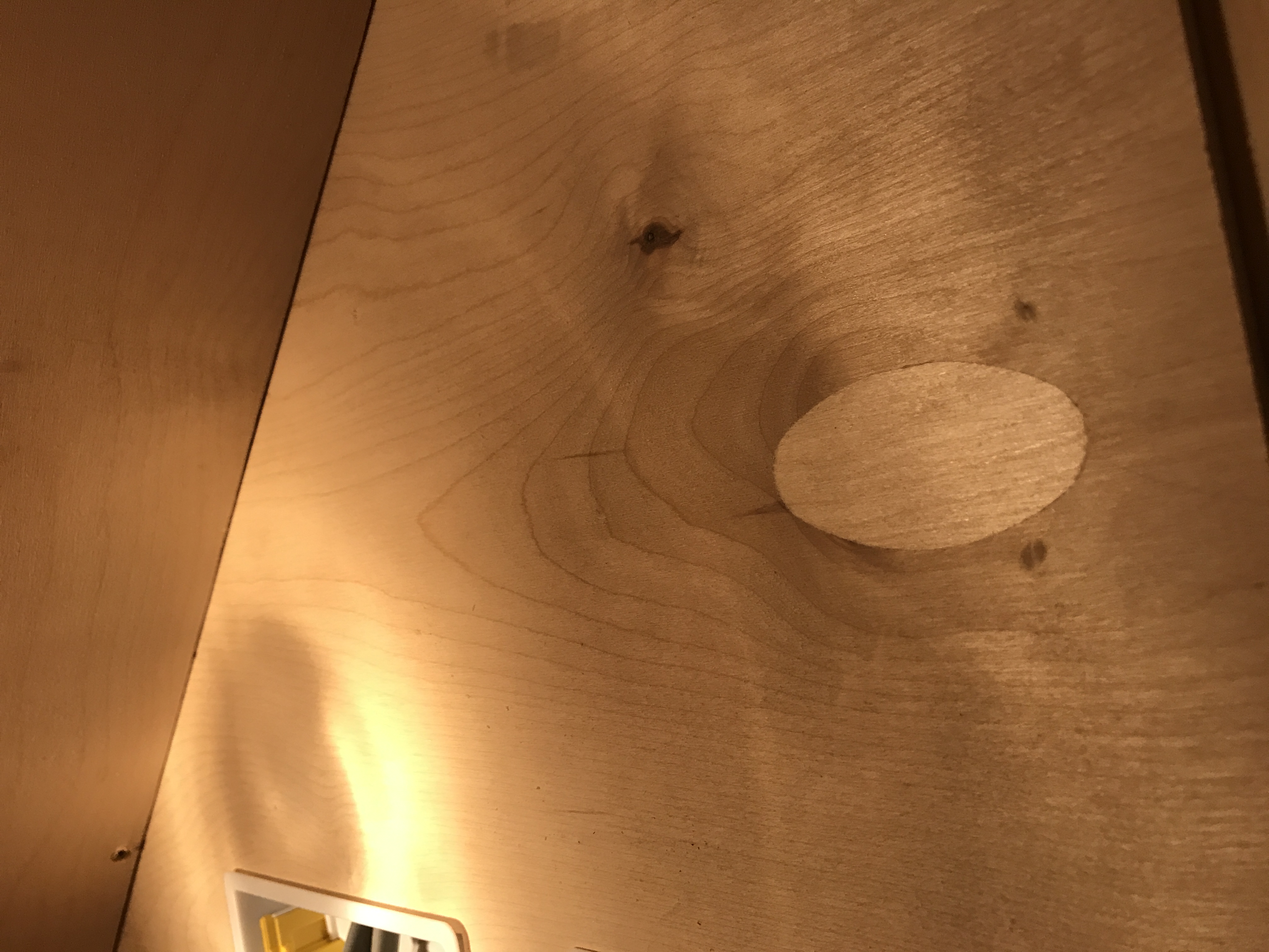

See the laminate layers have evidence of knots with holes in them showing lower quality wood. Iv cut up thousands of sheets of struchal grade birch wood ply for building theatre sets in this wouldn’t pass.
Just for reference this is how knots are delt with on struchal ply the knot is drilled out and then a dowl is glued in before the log it turned in to sheets for making ply.

Think they all have those dents
All have the dimples. I see DIYElectricSkateboard with what seems almost an exact copy now that he shrunk down the hole in the bottom has the same dimples. From when they clamp it down in the mill.
Blem vs non-blem is pretty close call. If u aren’t happy w it write me and we can work something out.
I still don’t think it is an exact copy. But I haven’t been able to get rid of those dimples either. :sob:
I think it’s due to the deck being a lot wider than normal.
dimples are because of the moulds? If you both have dimples it probably comes from the same mould :sweat_smile:
