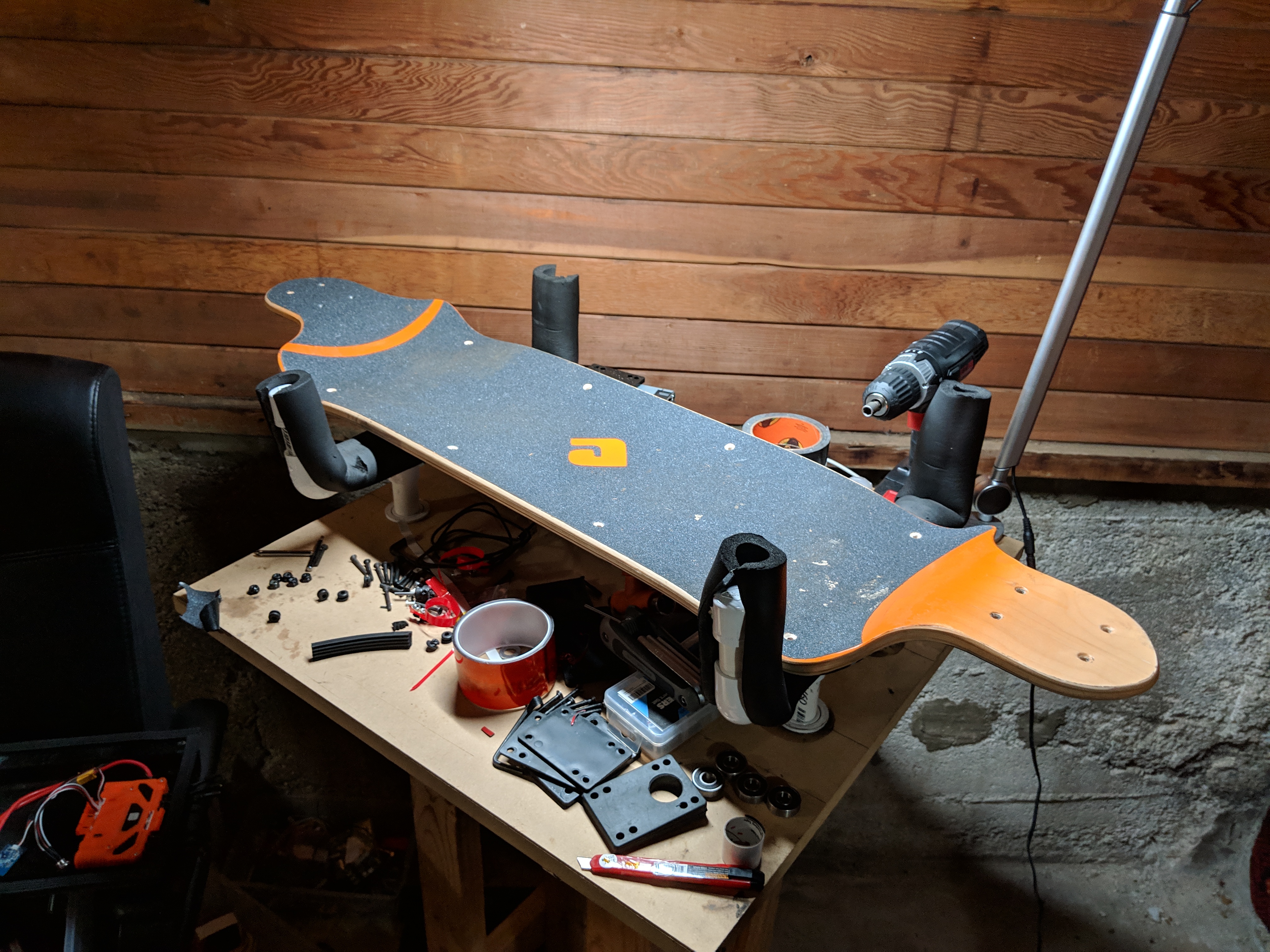

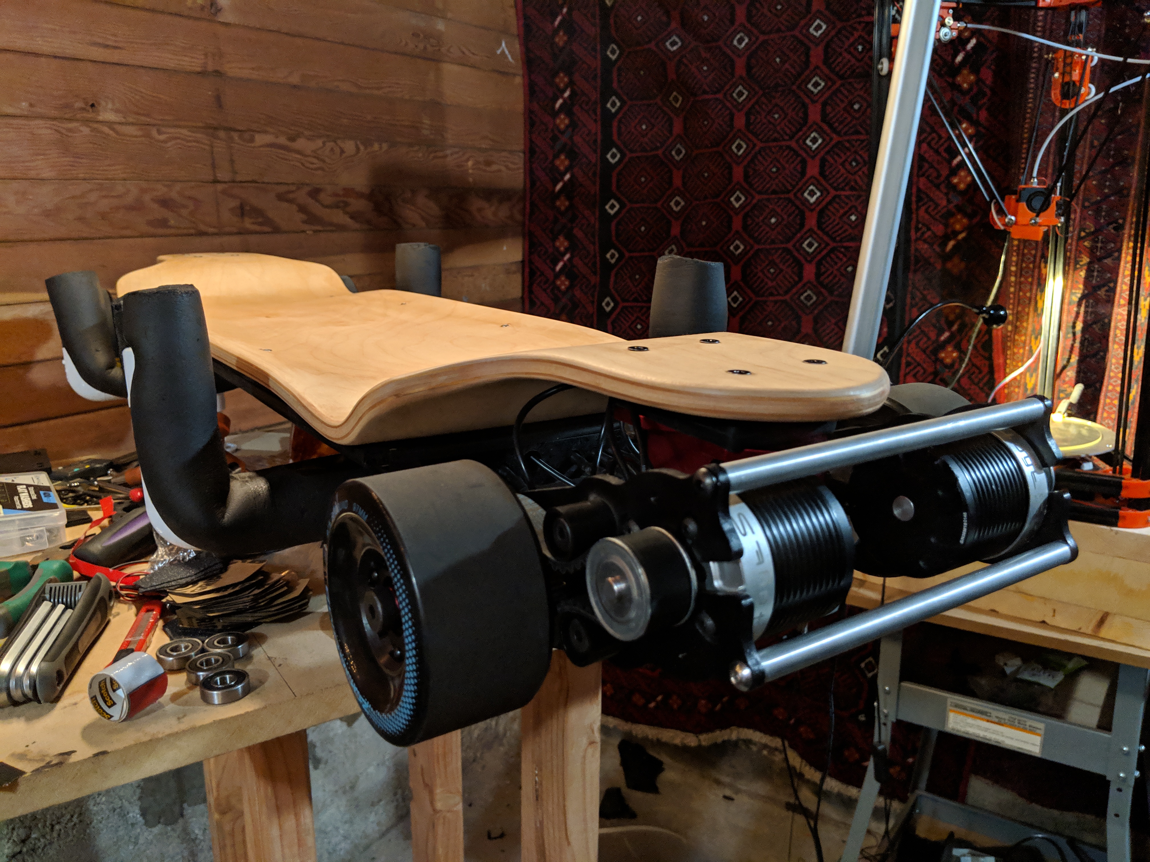

This is a board I built up while I wait for my 44 Remember. I’ll expand a bit more in the build once I’ve slept.
It rowdy.

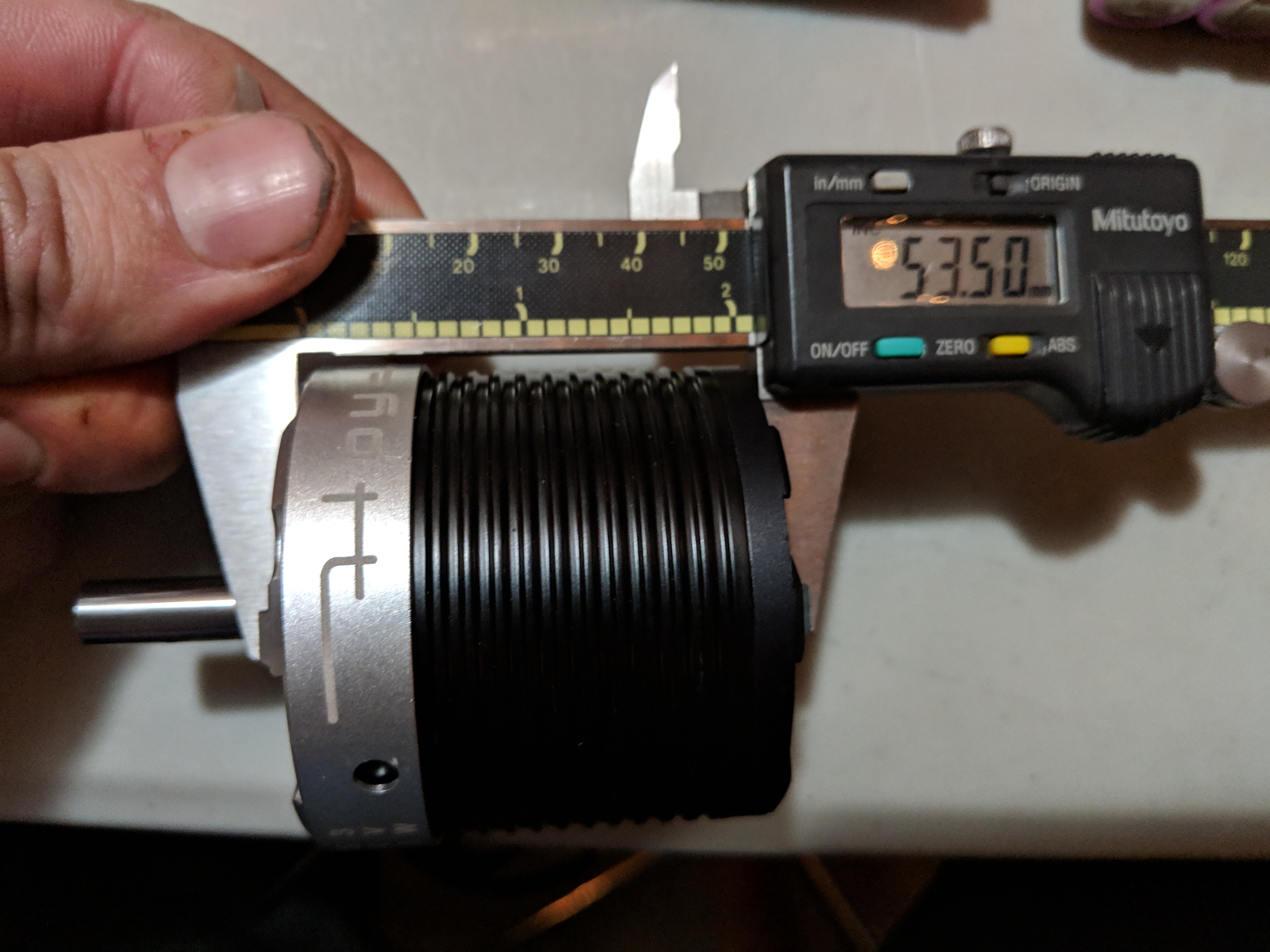

Tell us more about those motors if you please? Build looks great, nice stablemate to the LaC
She’s only a half sibling of an LaC!

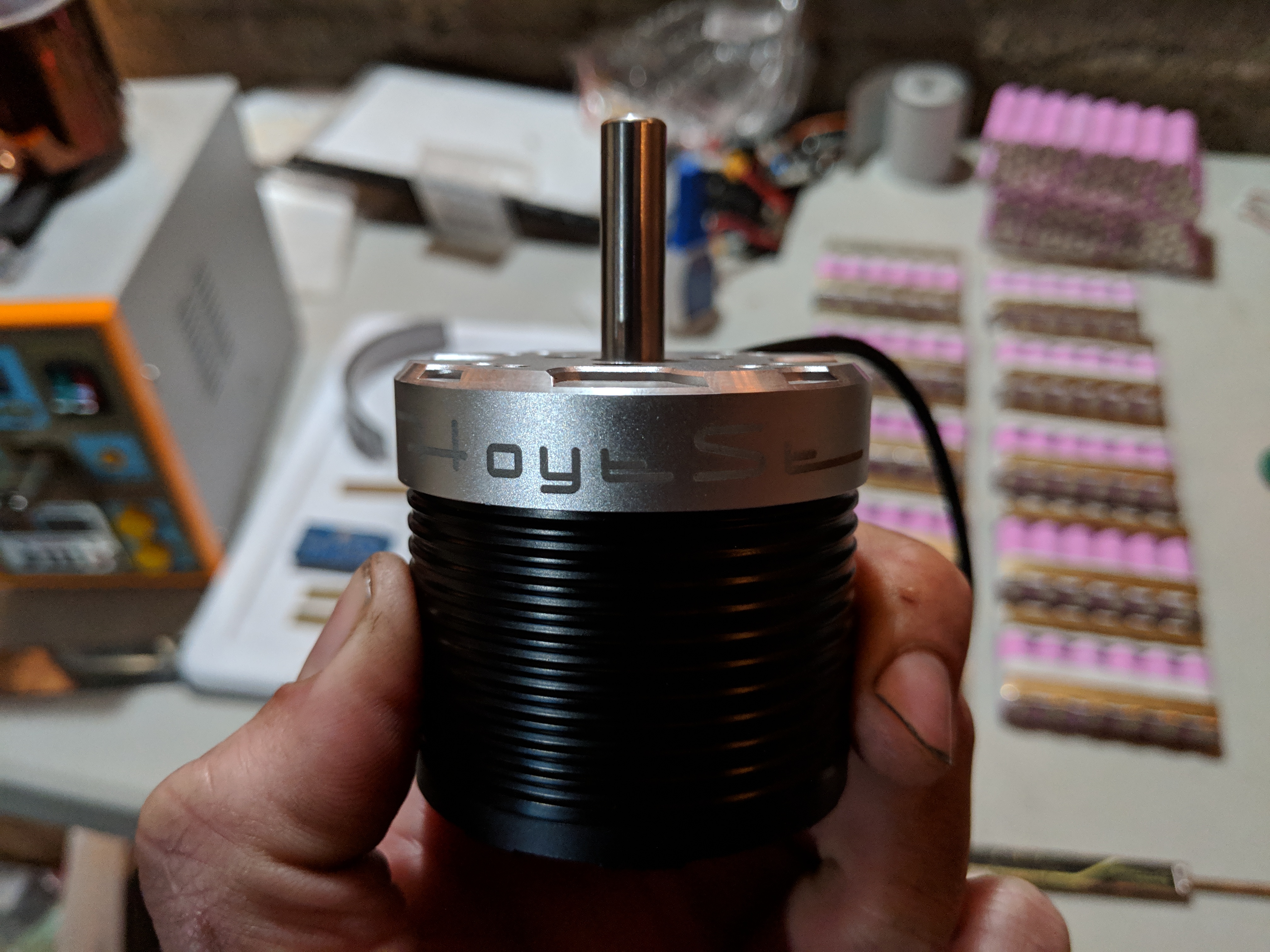

The Hoyt Pocket Rockets are genuinely quality. If I’m to be honest I’m not sure I could ever justify the retail price tag on a part I consider a consumable, but they are fuckin solid.
I tore one of them down out of curiosity- they show up fully battle hardened, I’m not sure the magnets will come loose anytime soon like so many motors have without aftermarket hardening processes.
They’ve got plenty of power and are very compact, but that does result in them running a bit hotter than I’m used to with my larger can motors. With that said it’s never been an issue in play, they don’t exhibit any thermal runaway.

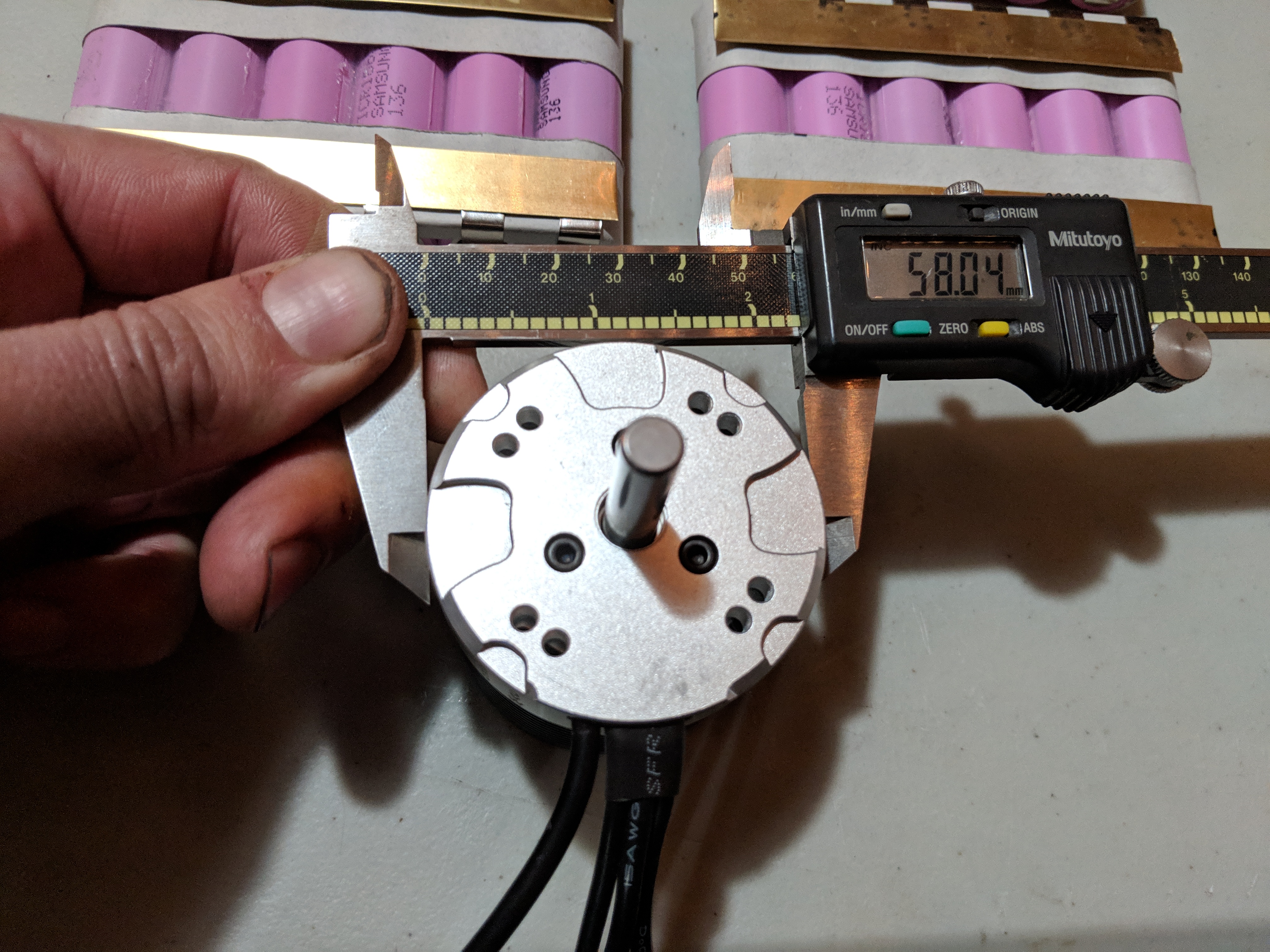

My biggest complaint would be the nonstandard mounting dimensions. If you use a universal style mount its a non-issue though.
Ah those are the Hoyt motors they look tough as hell, explains the military pricing but you pay for quality
Funny size, presumably put out 6355 power
56x53mm, 530g, 2200w, 180kv, 8mm shaft, voltage 8S-12S (set of 2)
Yep, that’s about right, they’re essentially compacted 6355s. I’ll dig up some better photos, if you’ll excuse the filthy workshop hands.

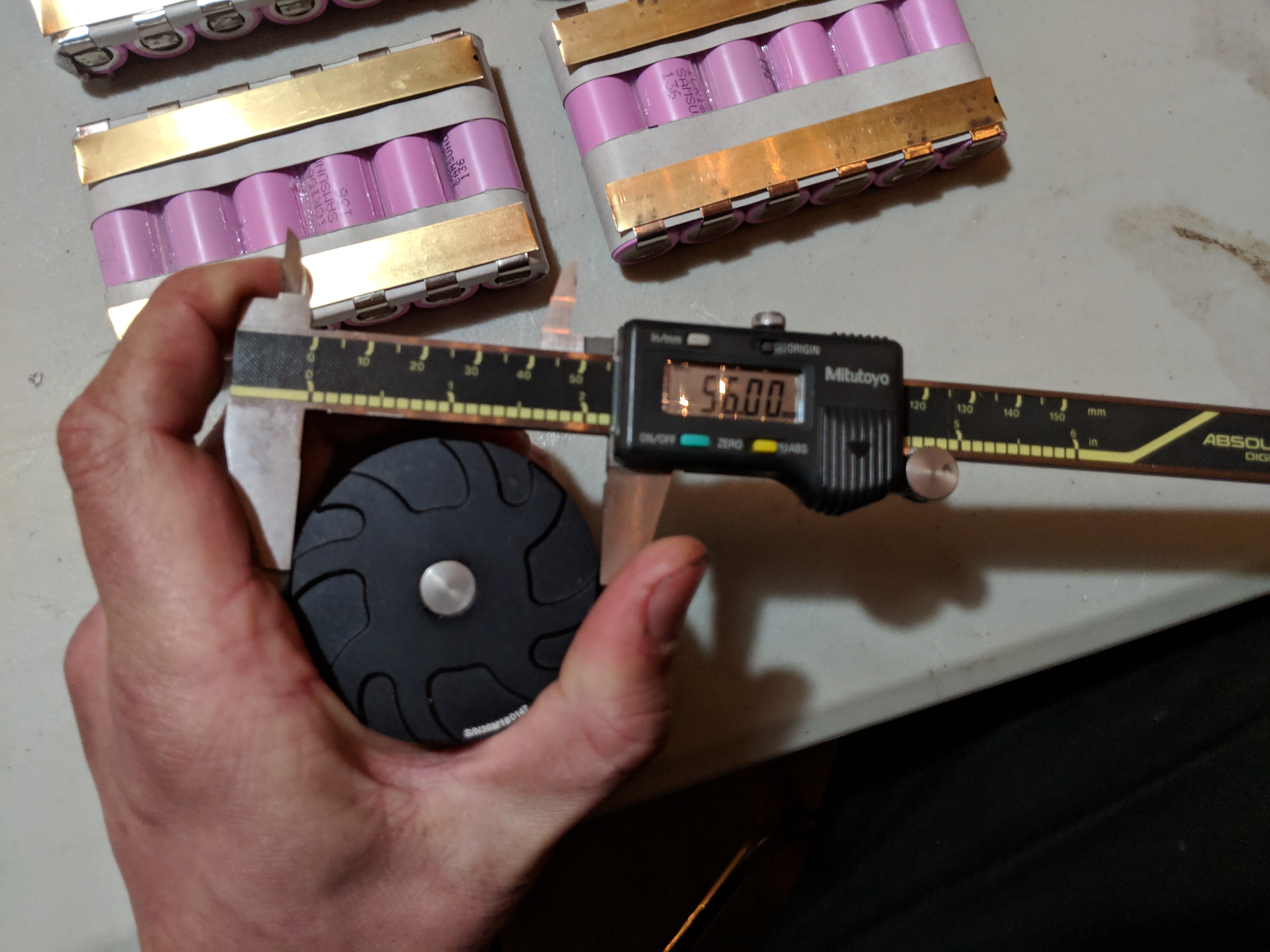

@DerelictRobot these are sweet. so they are smaller and you say they feel like a 6355 in power and already battle hardened. great news so what’s the weight compared to a 6355 …and I’m curious what’s that motor gear tooth size
I didn’t bother to toss them on a scale. They’re somewhere between a 5065 & a 6365 I’d guess? Hah. They’re already on my board and will hopefully not be coming off for awhile. You might ask Hoyt if you’re looking for specifics.
Do you mean shaft diameter? 8mm
