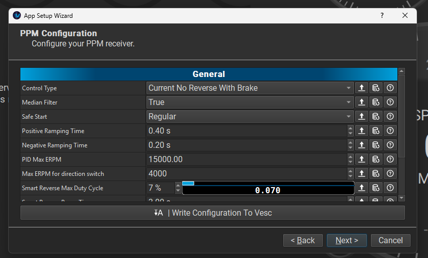

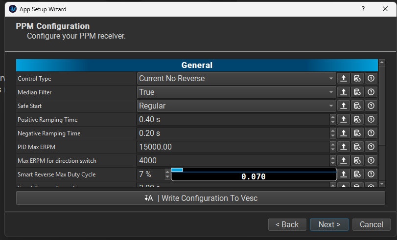

While running the wizard, I usually select the “Current No Reverse” option.
This time, I ran the wizard and selected “Current No Reverse With Brake” and the damn thing connected perfectly!
After it worked, I went back to “Current No Reverse” with the wizard and it went right back to freaking out. Does anyone have any idea why this would be? I chose this same option with the UART remote without an issue.
After I pair the remote with the wizard, selecting the “Current No Reverse With Brake”, it seems fully functional.
If I change that Control Type to “Current No Reverse” manually in the App settings, the same thing happens. One motor spins up to 100% instantly…

When I use Mode 1 — Current No Reverse, the motor on the secondary CAN bus spins up to full throttle immediately.
When I switch to Mode 2 — Current No Reverse With Brake, everything works perfectly.
From my understanding, Current No Reverse should work normally, which makes me think this behavior is a bug or glitch. I’m just not sure if this ESC is something I should trust anymore — especially with that Maker X sale you posted about.

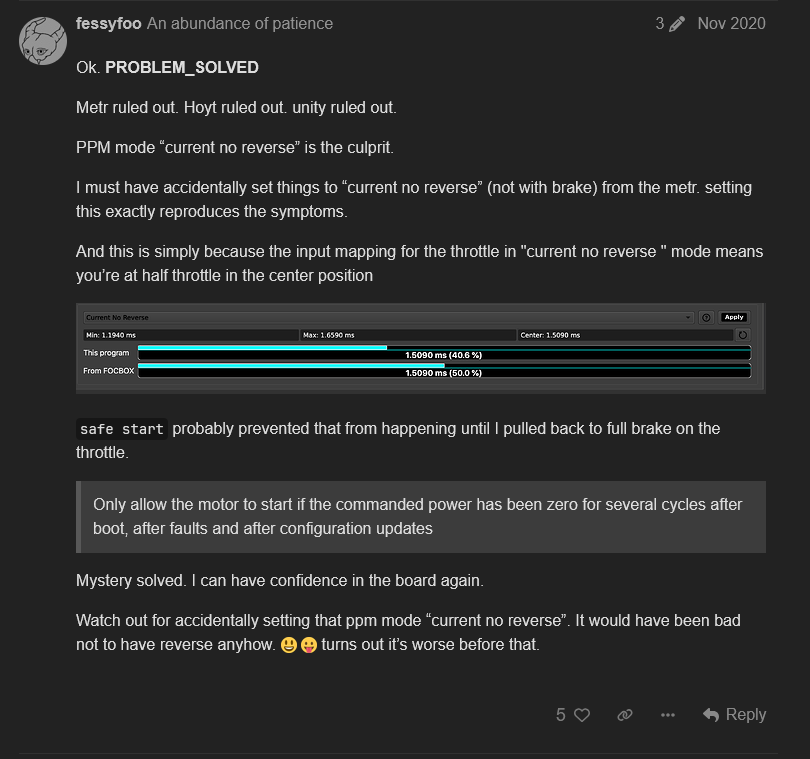

This old thread about current no reverse sounds like a similar situation, might have some relevance
To spoil the end post, in that case it was how Current No Reverse works causing throttle to default on, since it seems the middle position of a bidirectonal thumbwheel is half throttle in that mode.
Seems like a mode that wouldn’t be super useful for eskate if I’m understanding correctly - since it’s completely unipolar you’d need a separate brake mechanism of some kind even if you don’t want reverse.

For anyone reading this later, here’s the confirmation: PPM mode is the cause. It’s not a bug.
