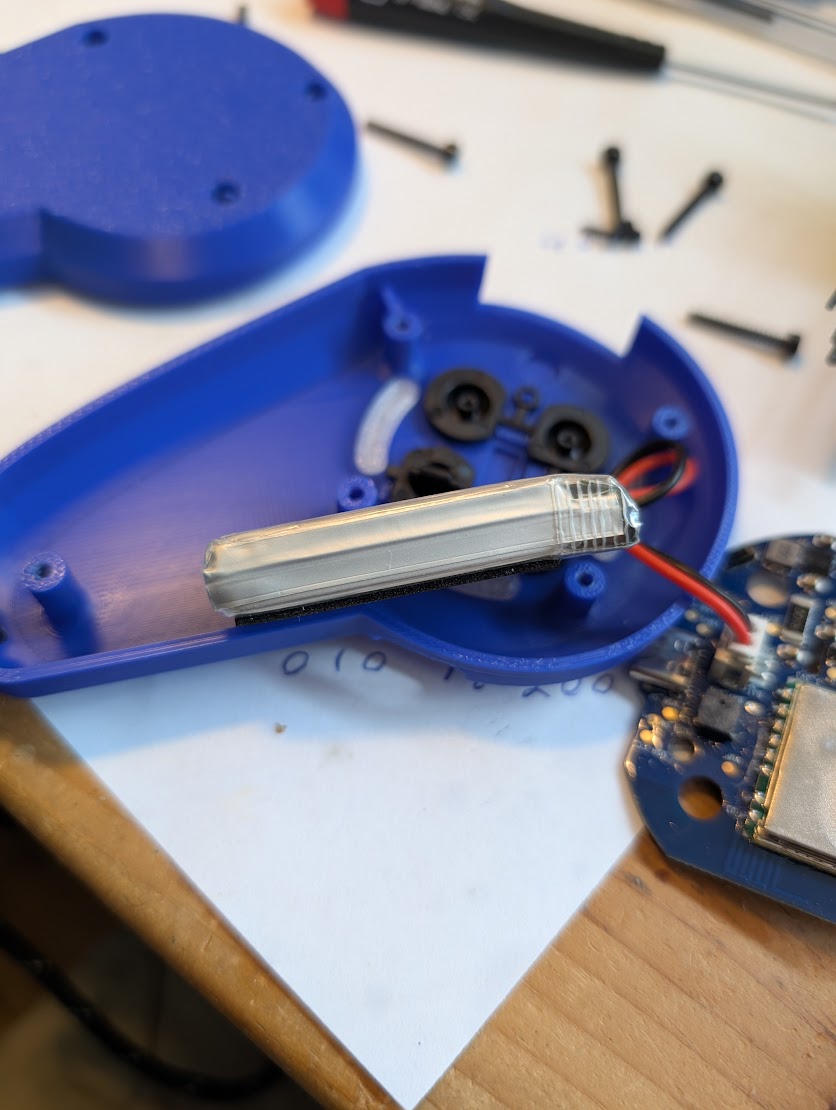

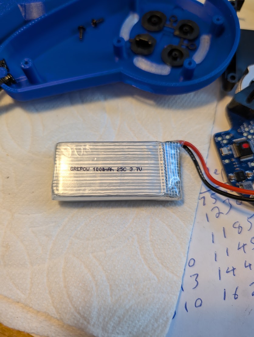

Can anyone who has a production Puck2 open it up and post a pic of their battery cell?
Hang on a mo . . .
Here

This looks like what we used. Mboards purchased all the old Hoyt stock so it would make sense to me that those are genuine.
hmm that battery (from puck 2 right?)
looks like the same grepow puck 1 battery.
can you add a shot from the side?
if ti’s the same battery, that would suggest puck 2 uses more power?
From puck 2, correct.
yeah that looks the same as puck 1 to me. as far as I can tell from pics.
